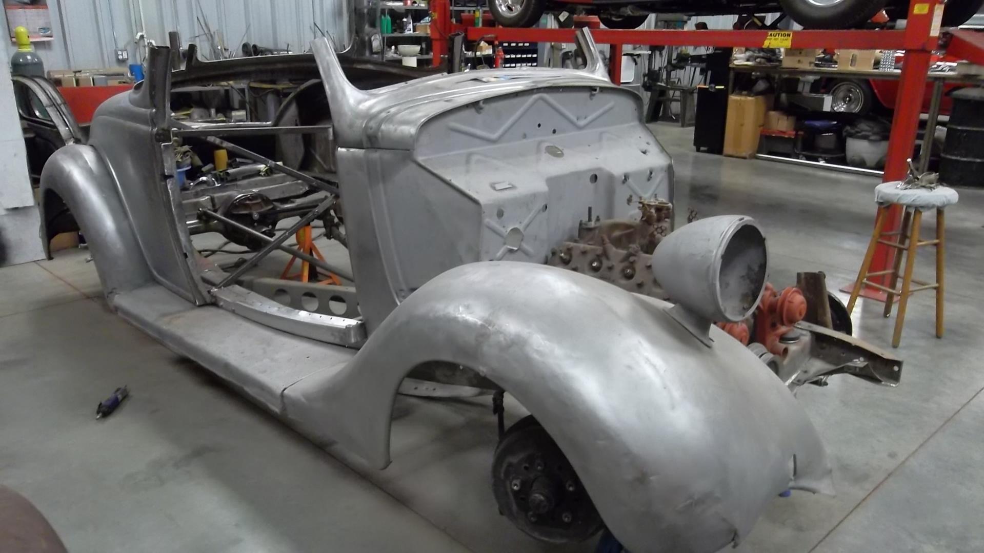

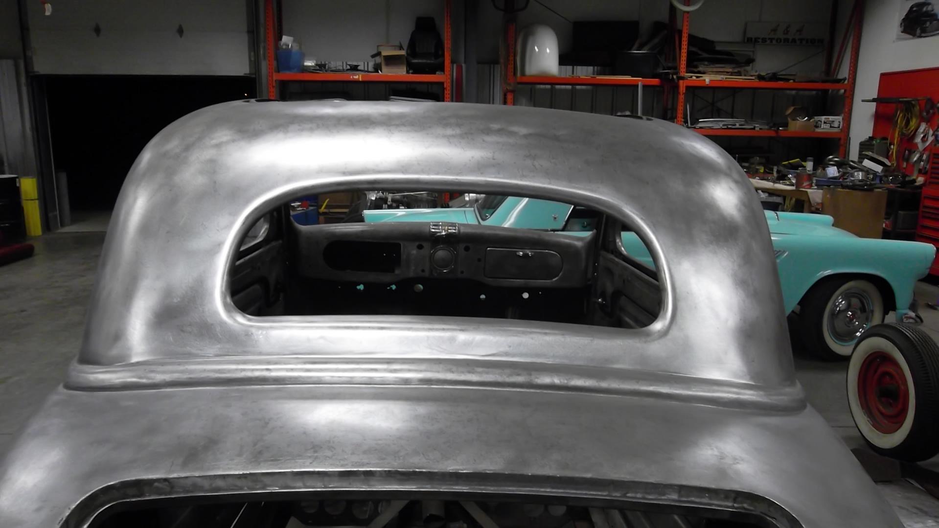

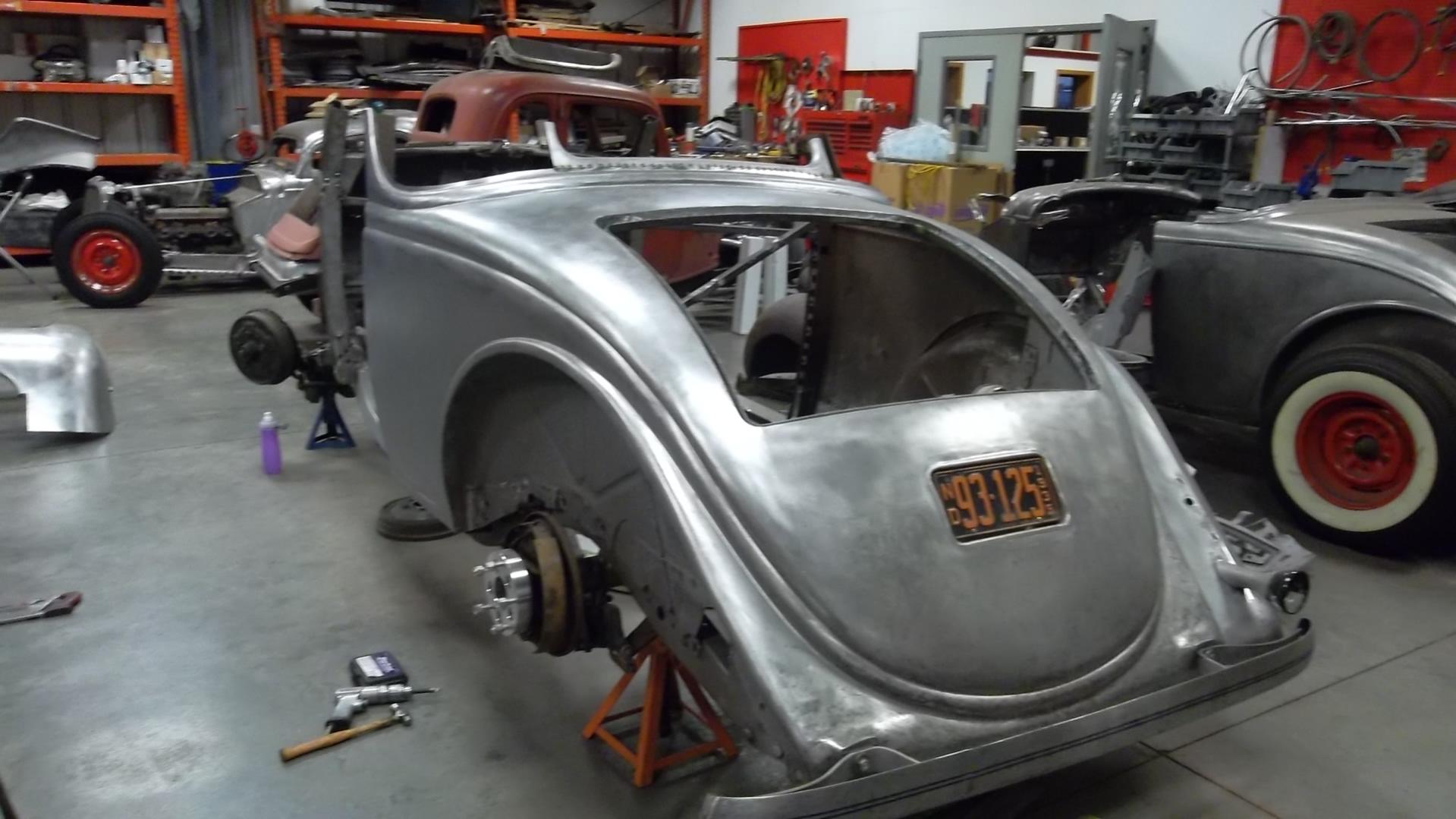

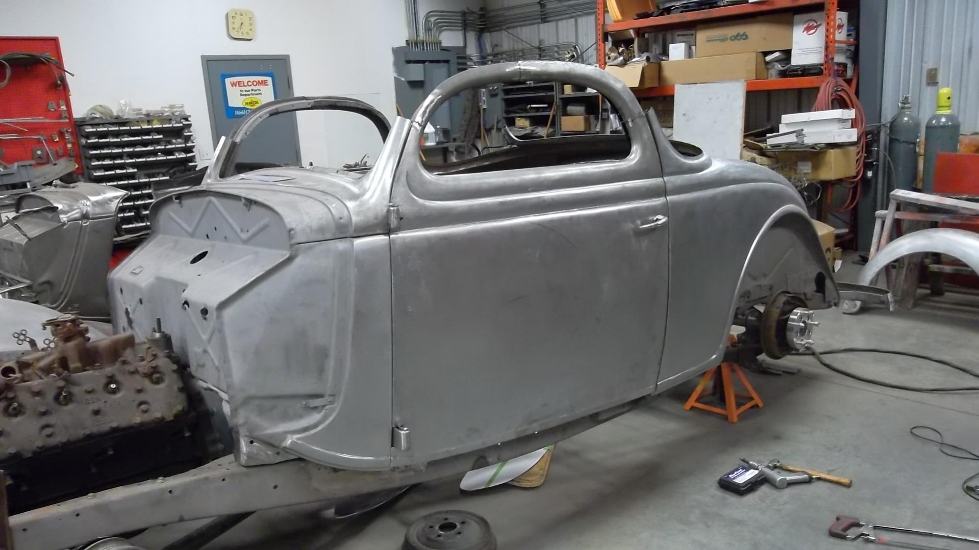

    I finished straightening the back of the roof tonight. I also fixed the 2 bulet holes in the roof

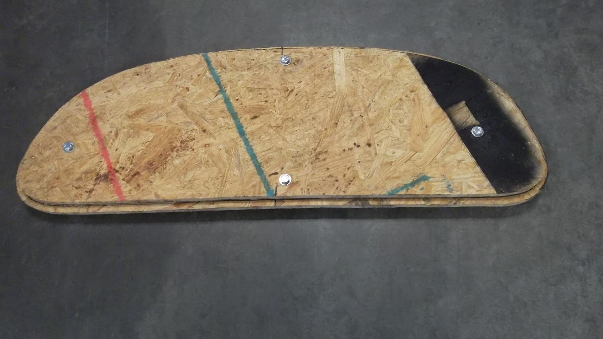

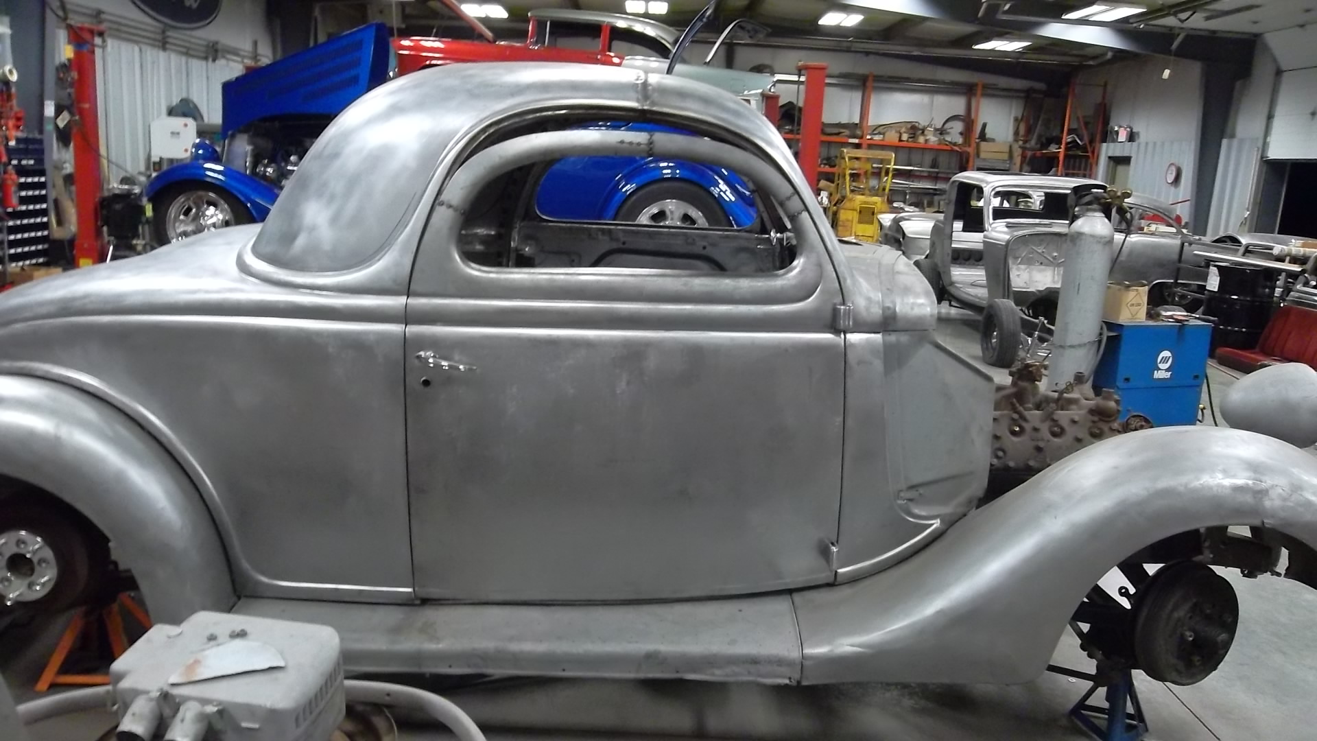

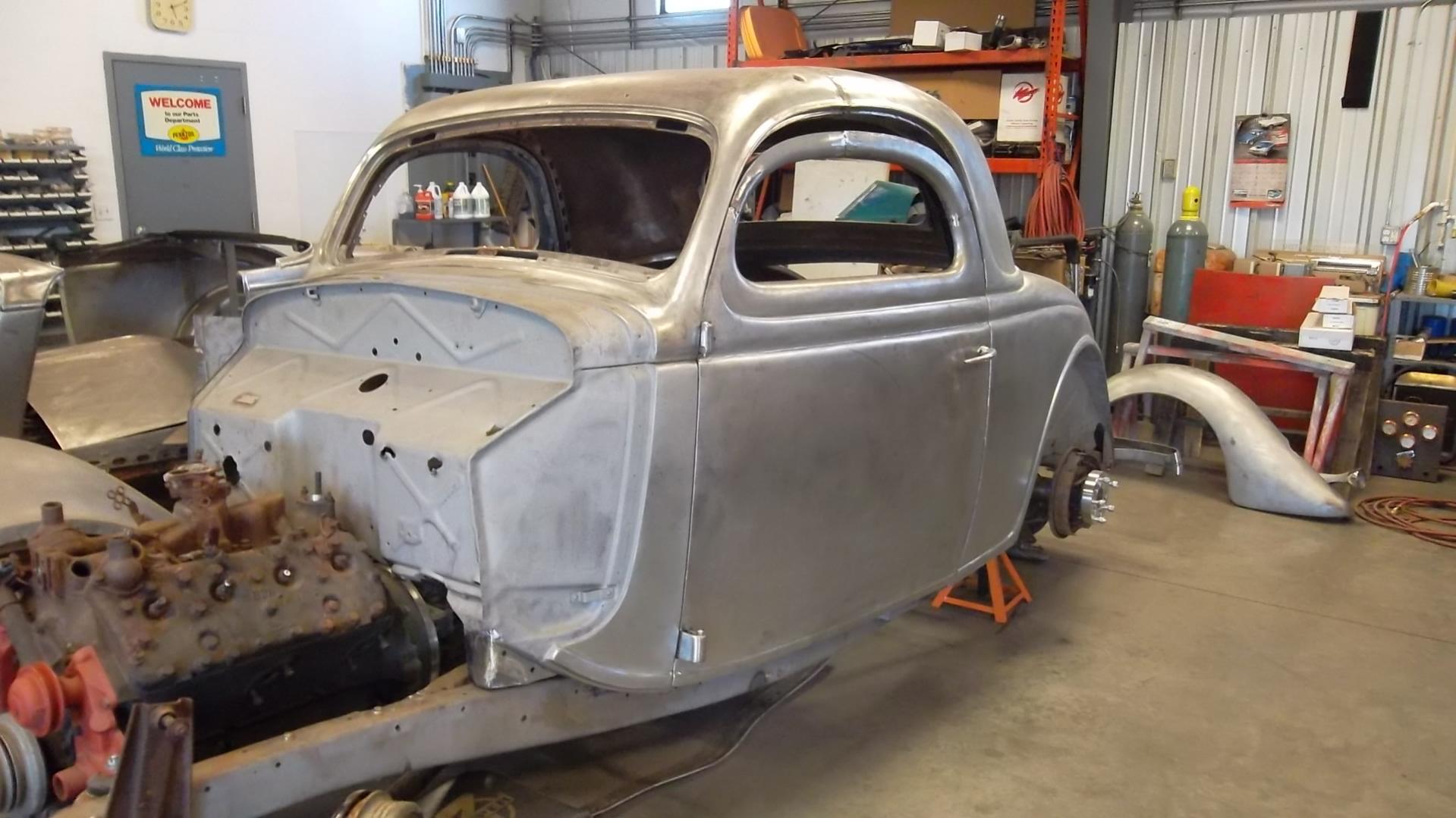

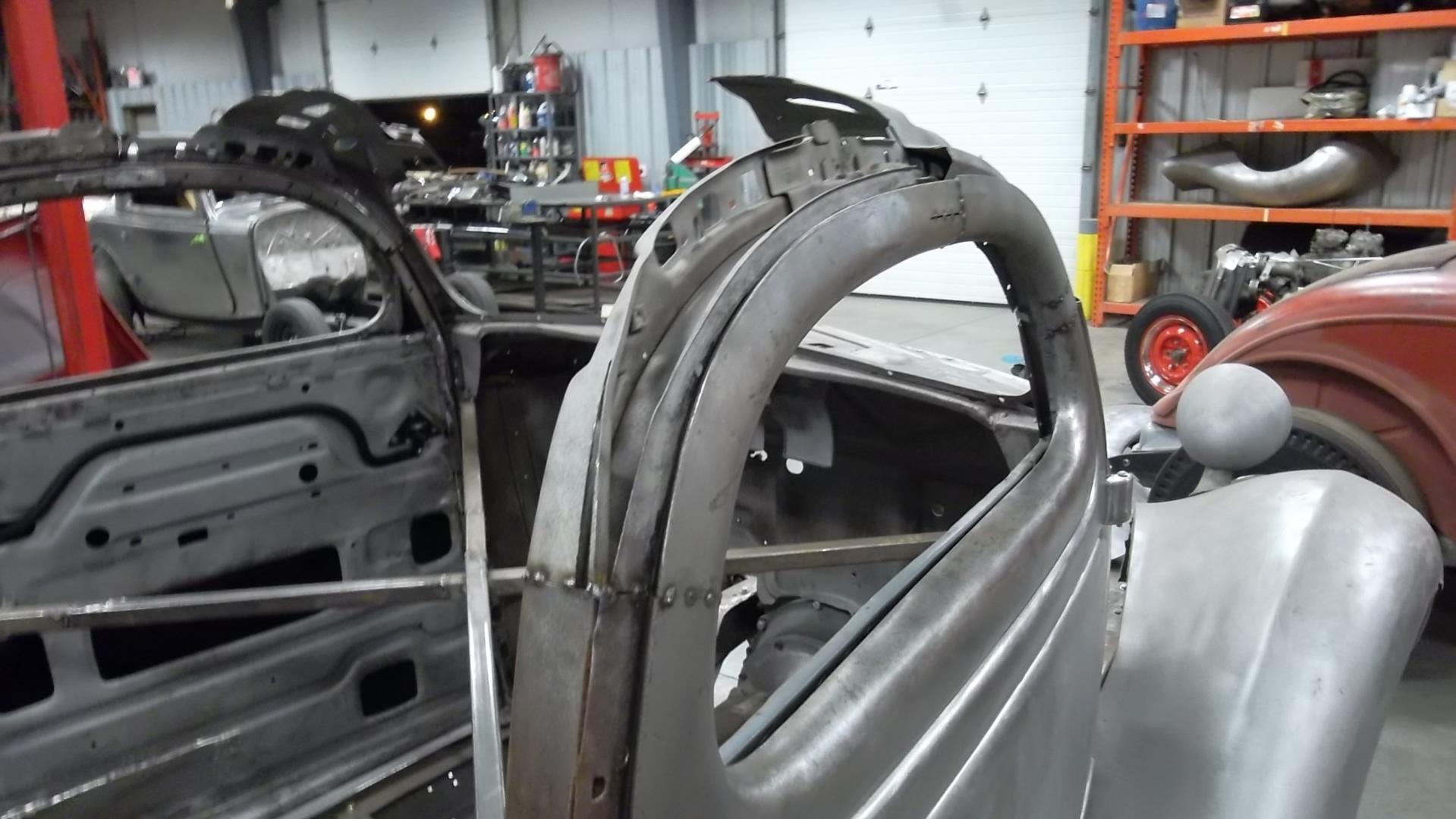

    Its time to chop the top! We decided that we are going to chop the doors first and then the roof. So we made some patterns and then I made a wood buck so that I have something to chop the doors to. I then marked out my cuts. I made the cuts using a hack saw for a precise cut. I then made the back piece fit and tacked it on. I then used the extra door tops from my parts car for the front so that I didnt have to lengthen anything and there is 1 less seam.

    Very nice using the buck on the doors, so what will the actual chop be 2" or ????...Jim

    Yes it is a 2" vertical drop

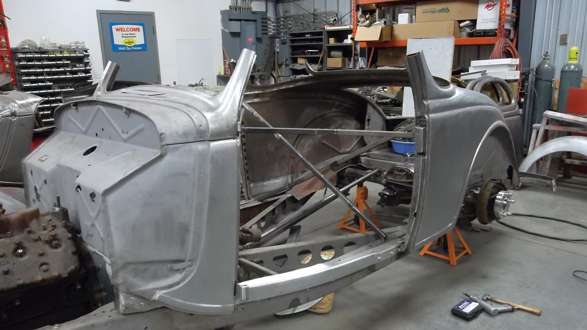

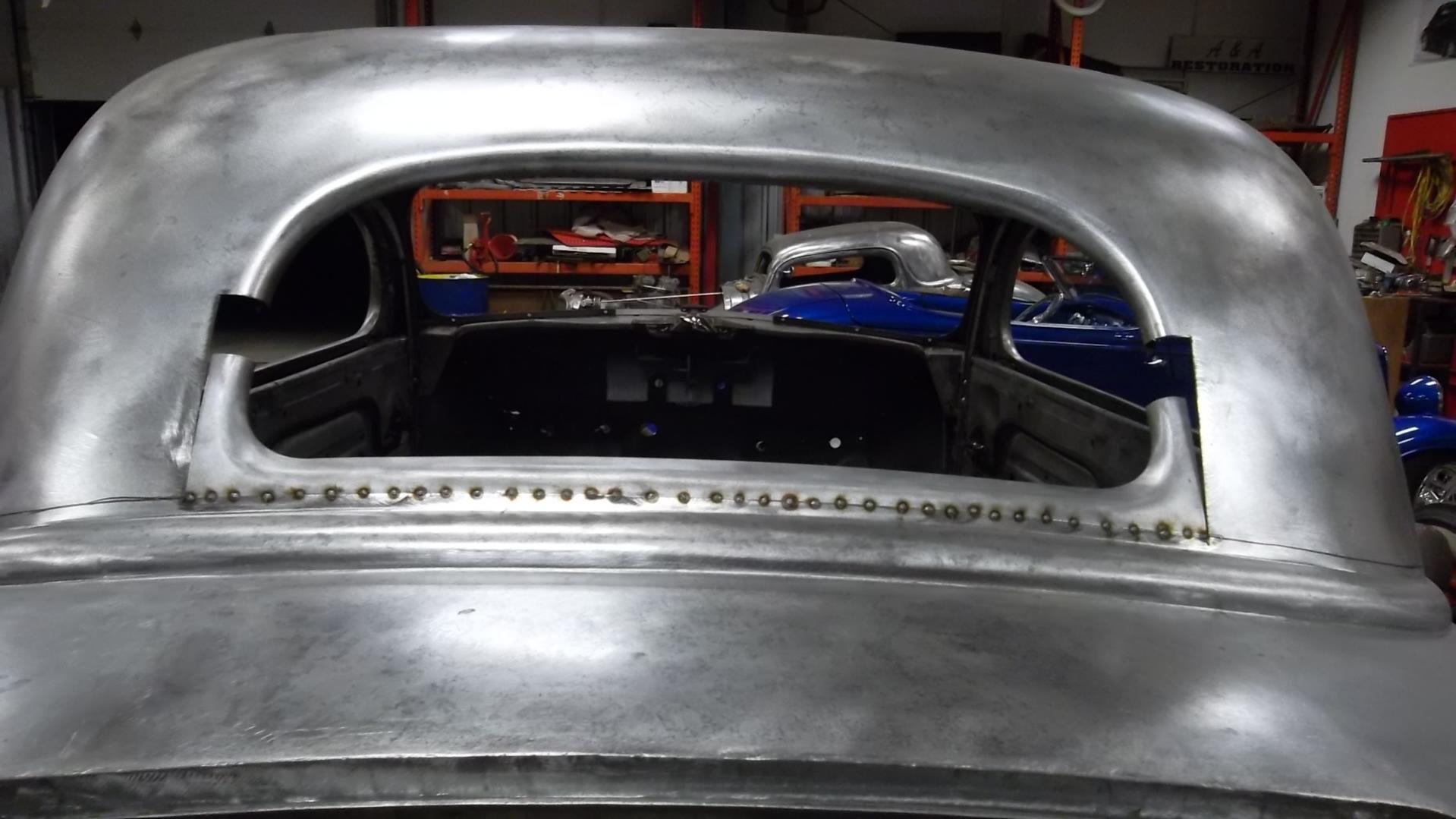

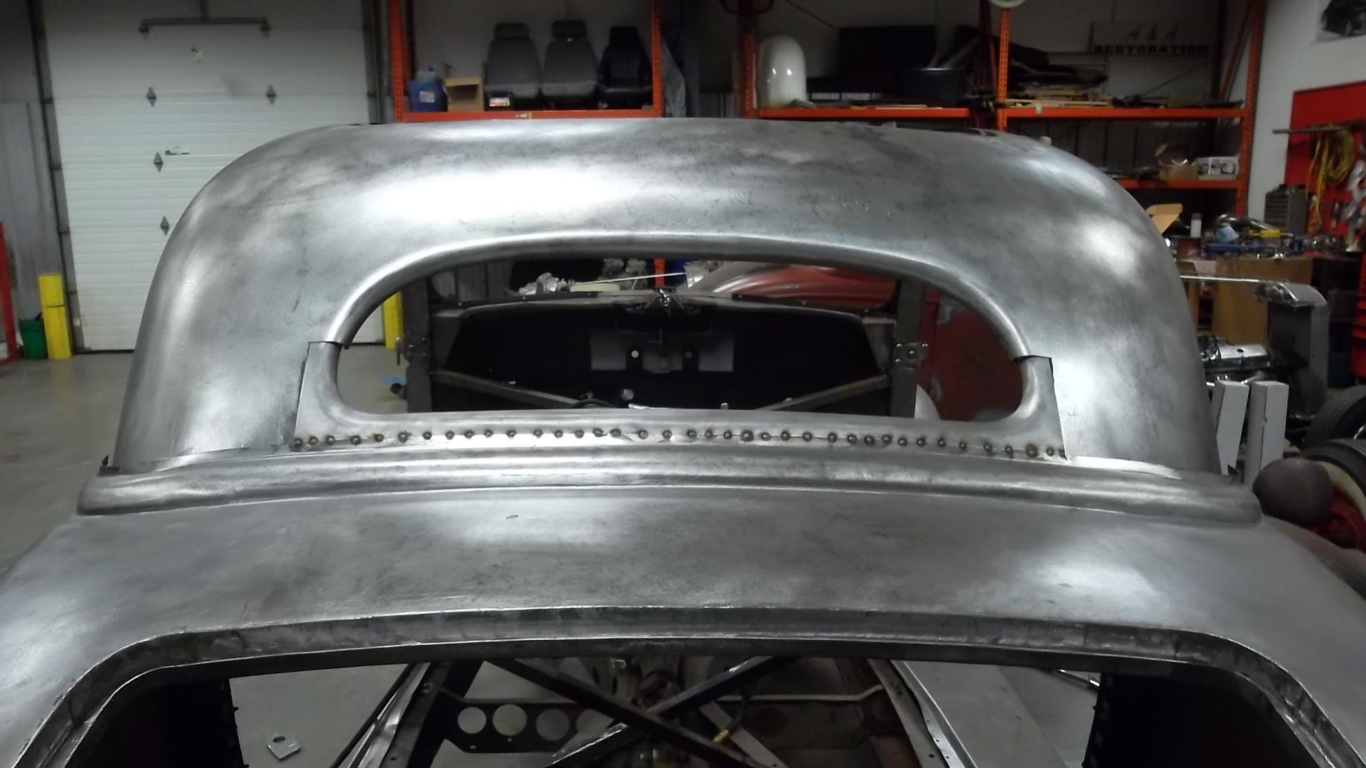

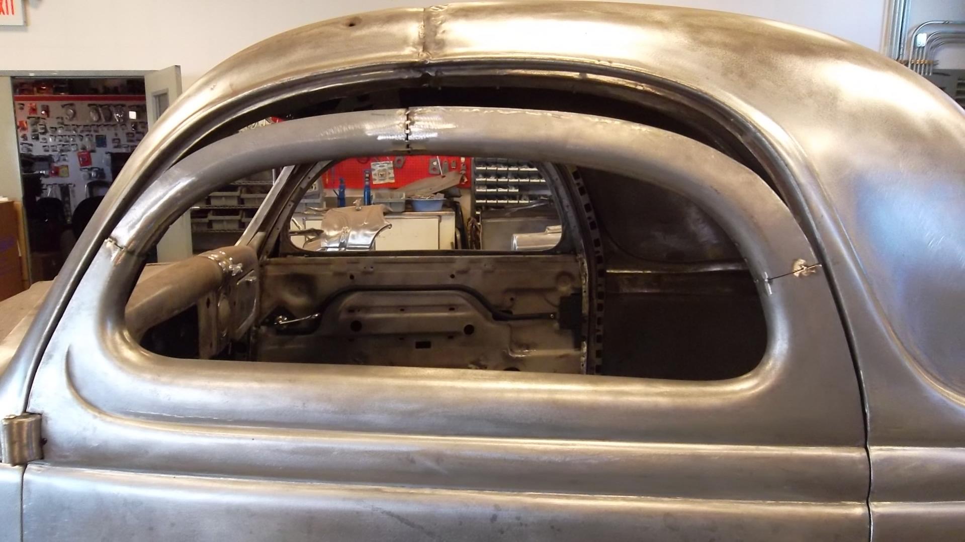

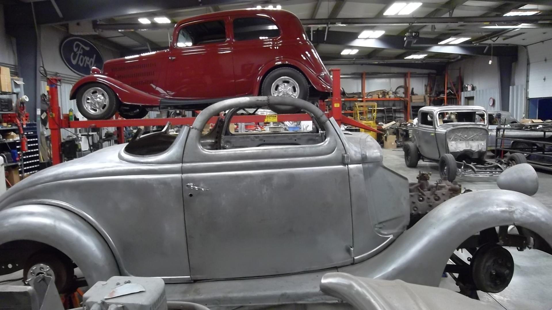

    monday i cut the back window. I took 1 inch out below the window and the rest will come out of the window when I chop the top. last night I got the p***enger door tacked together. Going to Hunnert Car pileup so there will be a break in the action for a little bit

    Hey Kellan, I see an extra seam to weld up on the p***enger door that you didn't have on the driver's side, tops from the 4 door aren't long enough?

    that isnt a seam it was a slice I had to make to bring the curve around on the 4 door piece. The slice doesnt go all the way through. It is on the drivers door too, I just welded it up right away.

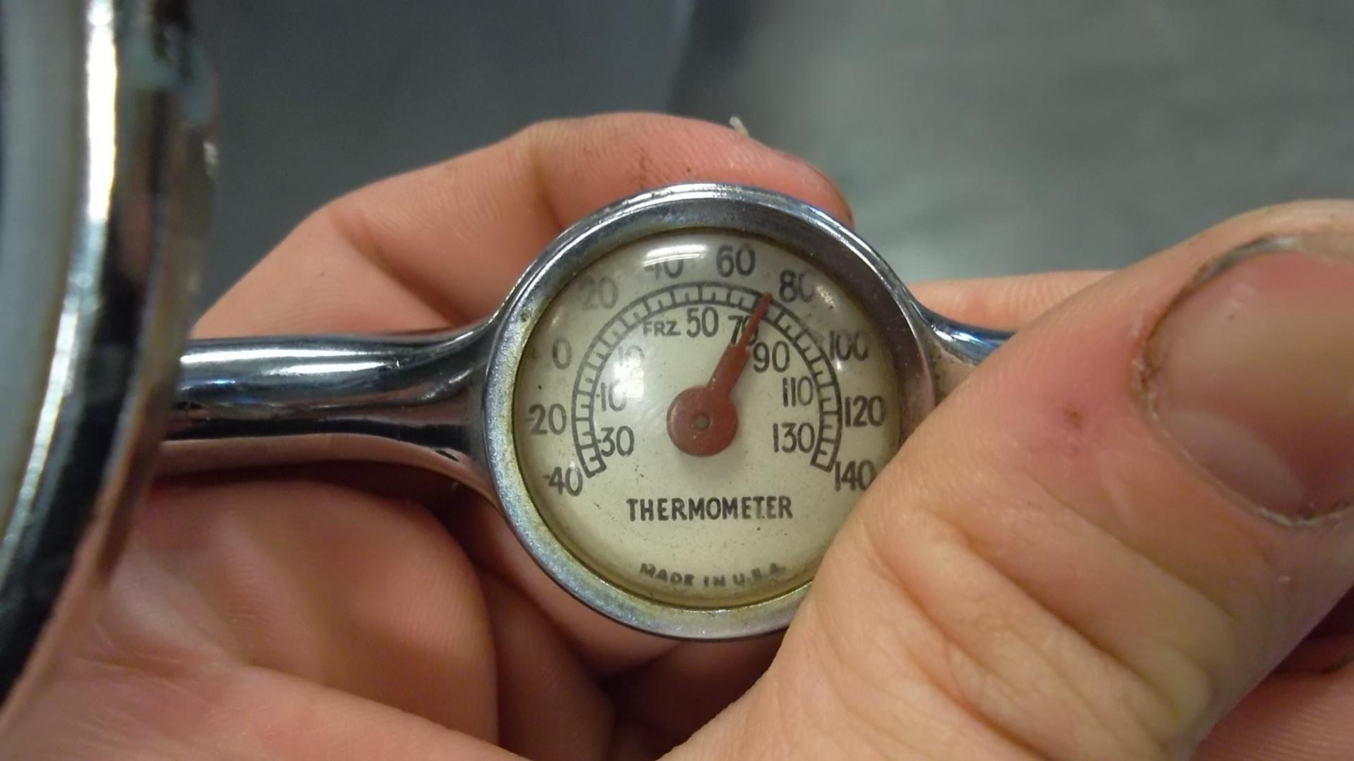

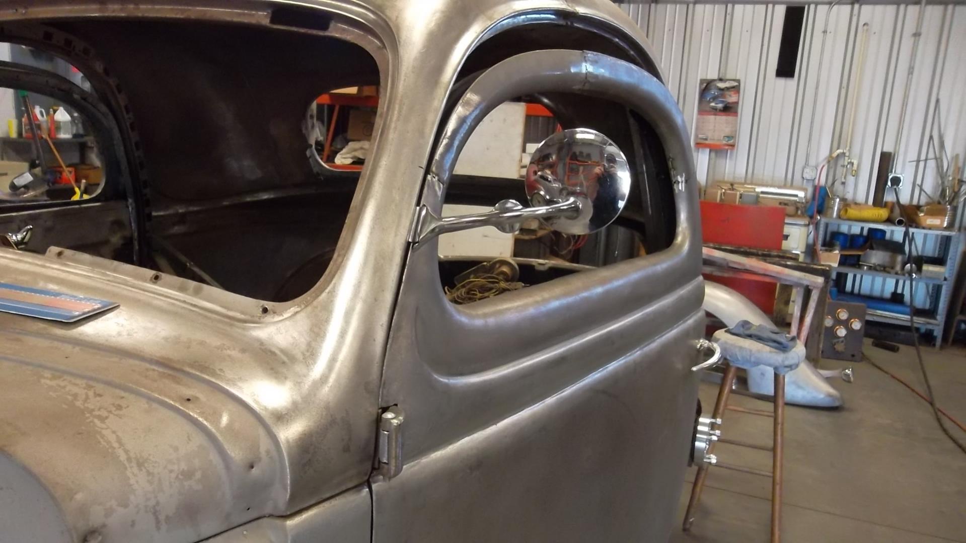

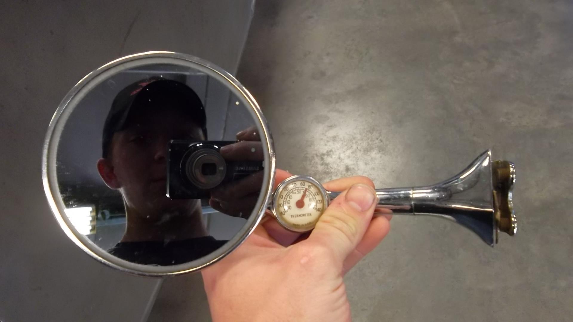

    Picked up a mirror at the Hunnert swap meet.

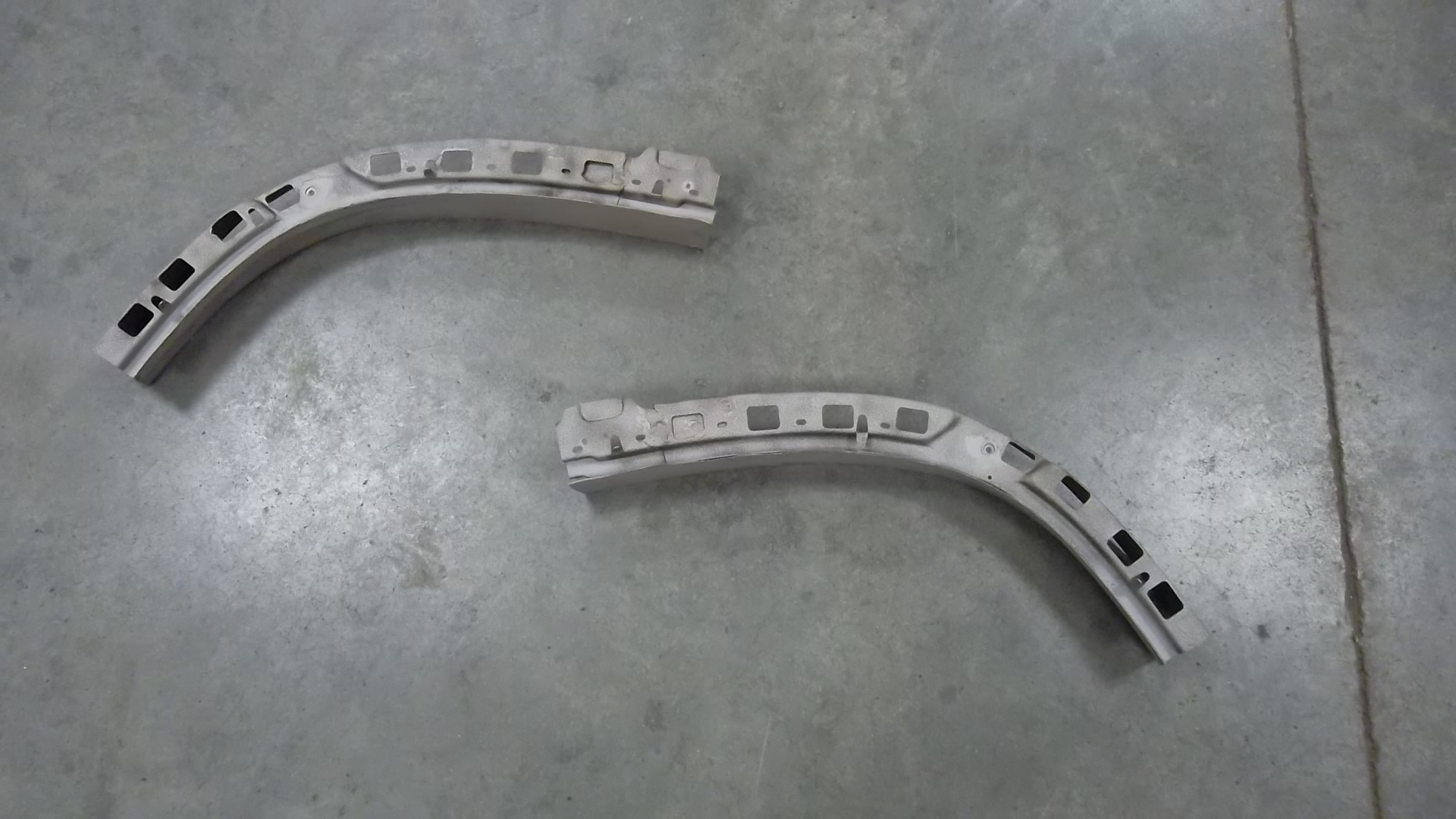

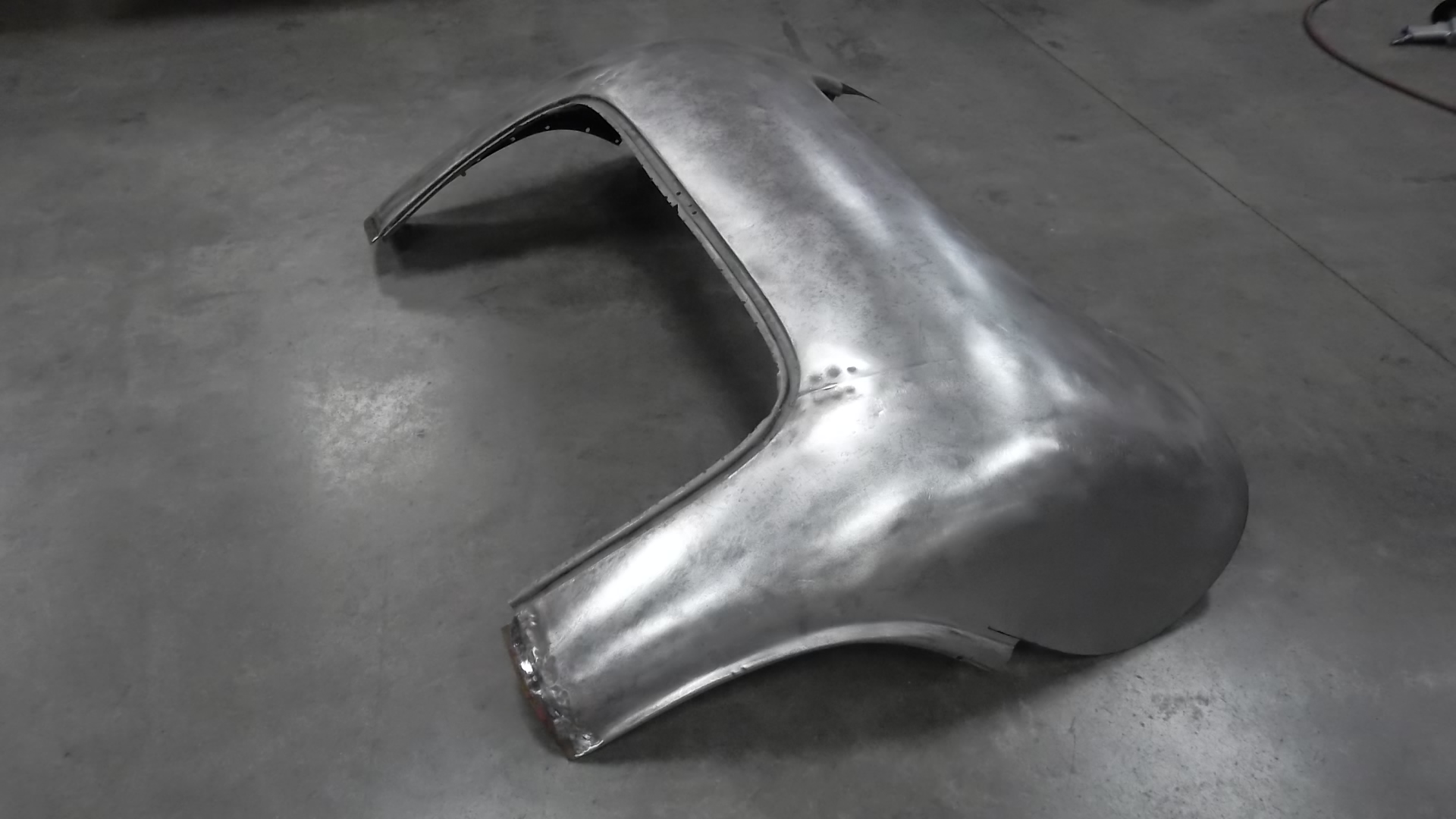

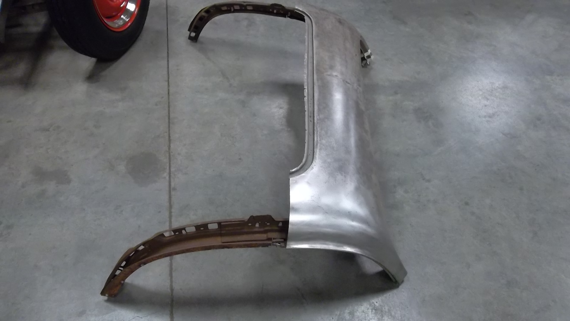

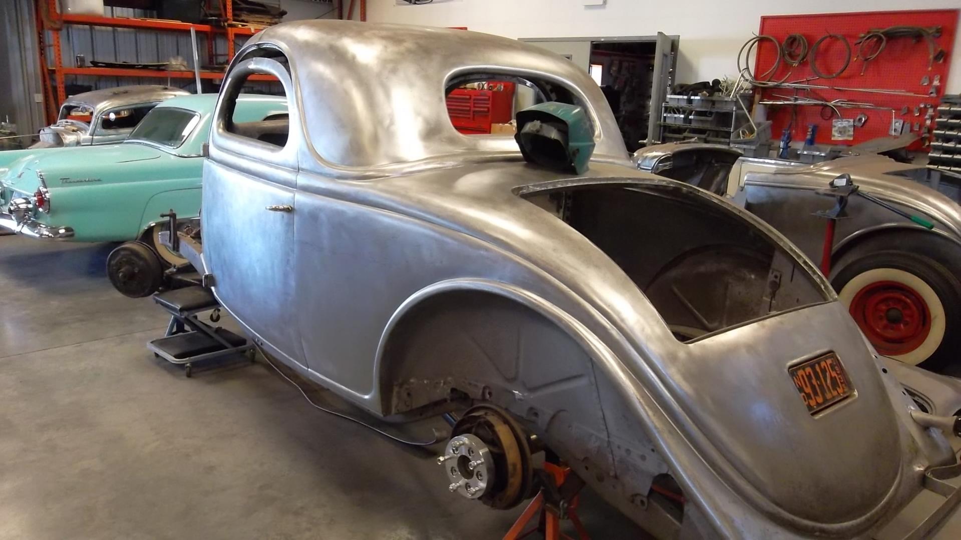

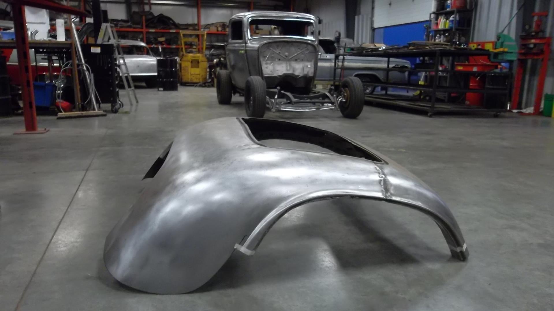

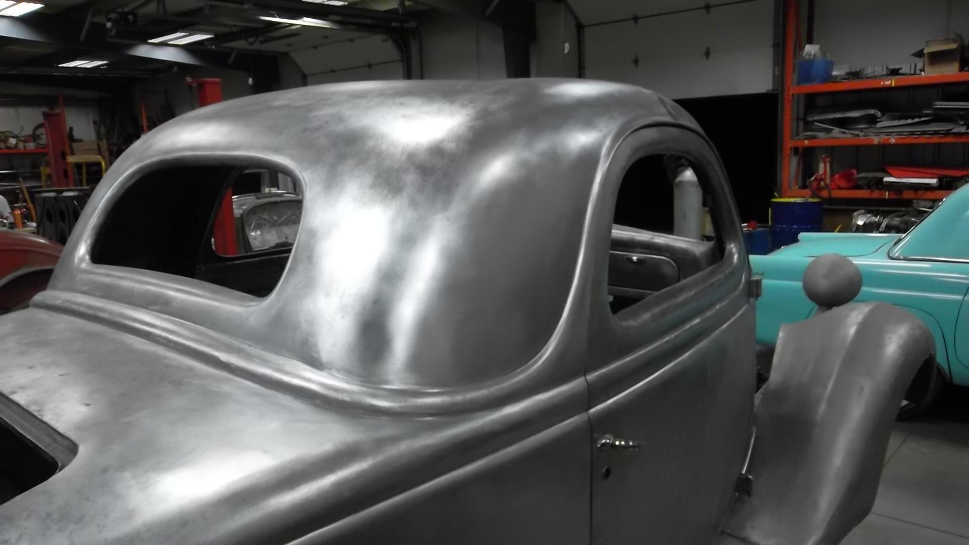

    Tonight I cut the roof off. I then split the sheep metal at the ugly factory seam. I then took the inner frame work out of the skin and blasted it. I also cleaned the rest of the rust off of the inside of the skin.

    Lookin' good as always! I can't wait to see the finished top chop. And the side view mirror you purchased is fantastic! Love the thermometer!

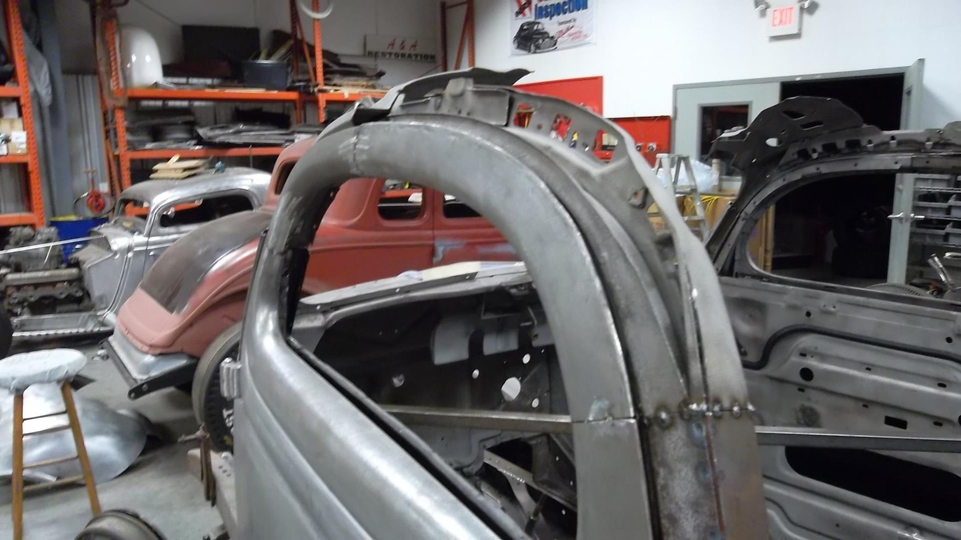

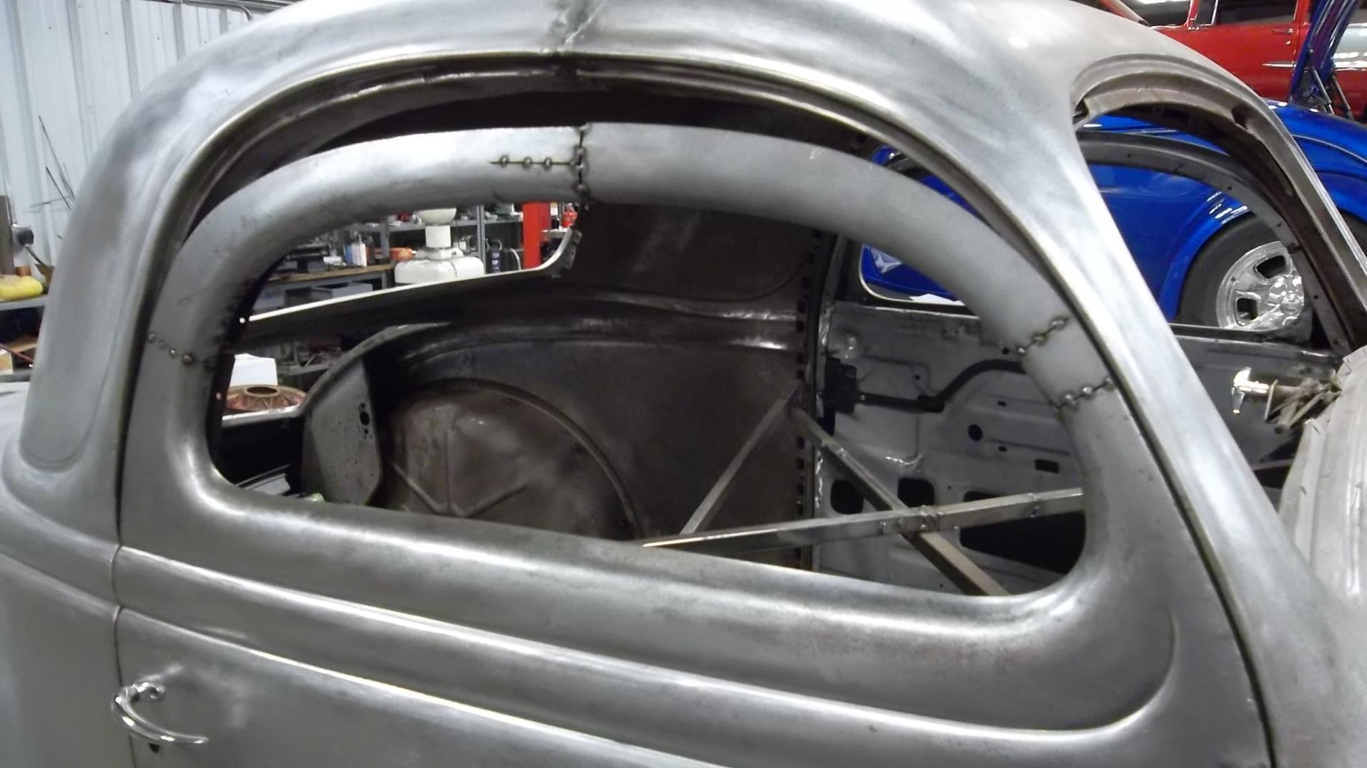

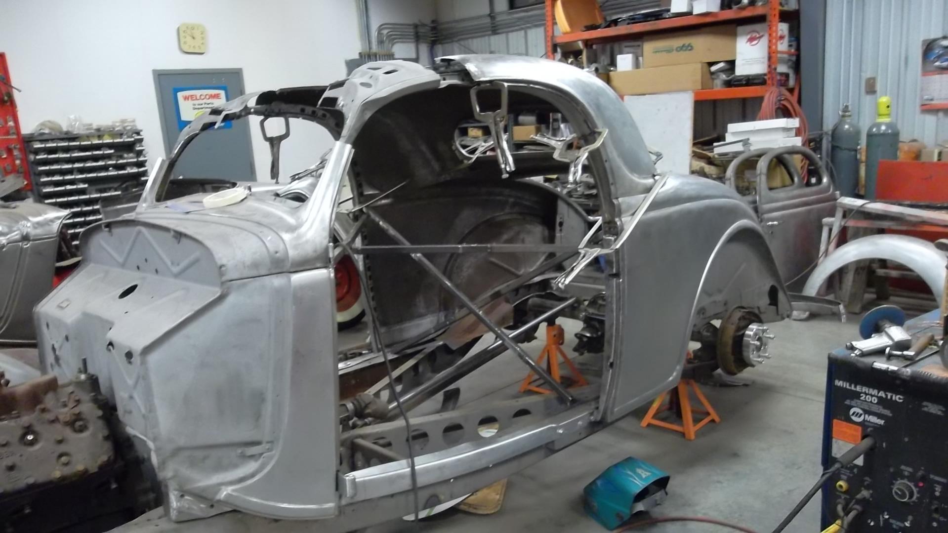

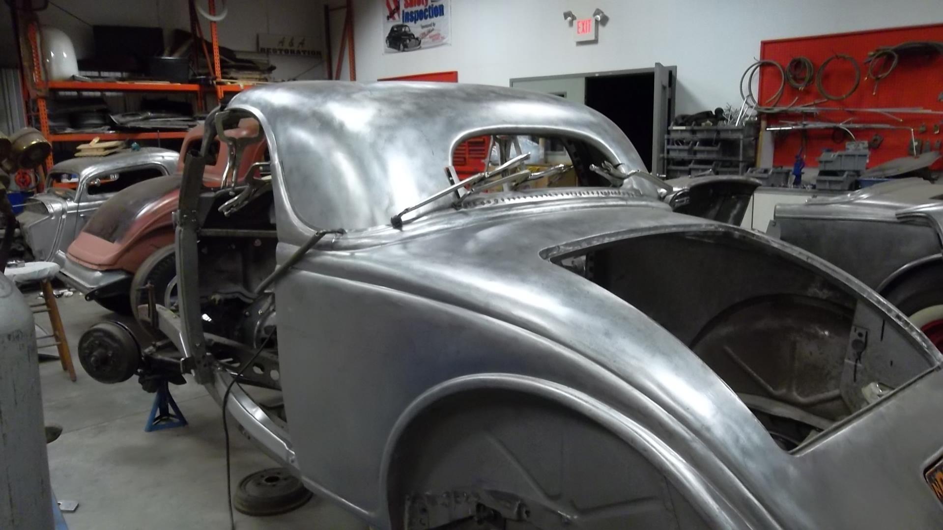

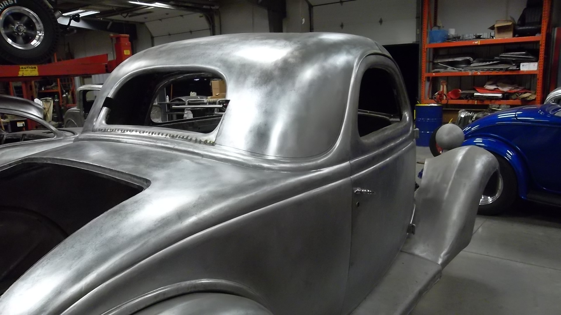

    tonight I got the inner frame work all chopped and tacked together. I then set the back of the roof on to see what it is going to look like

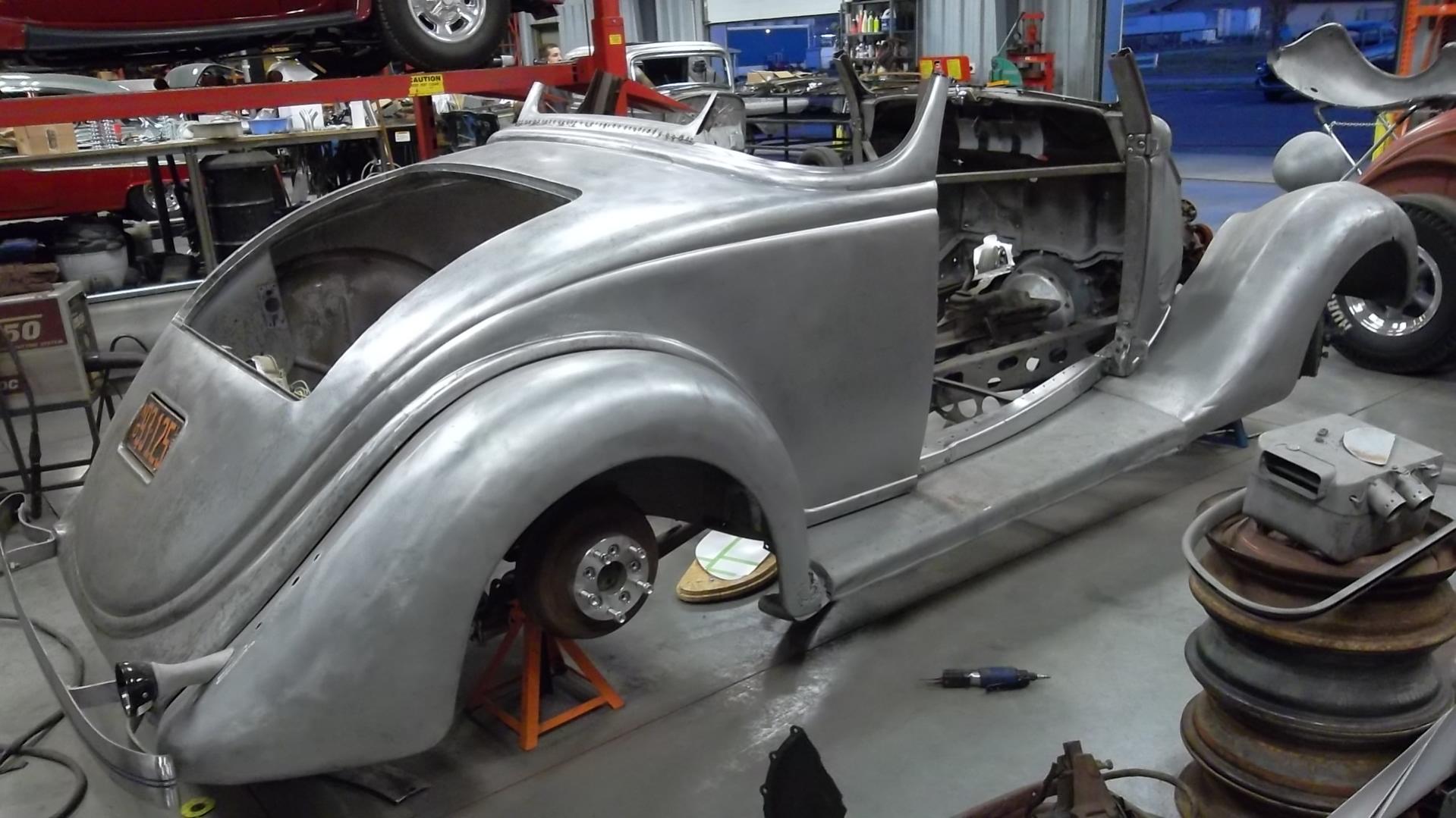

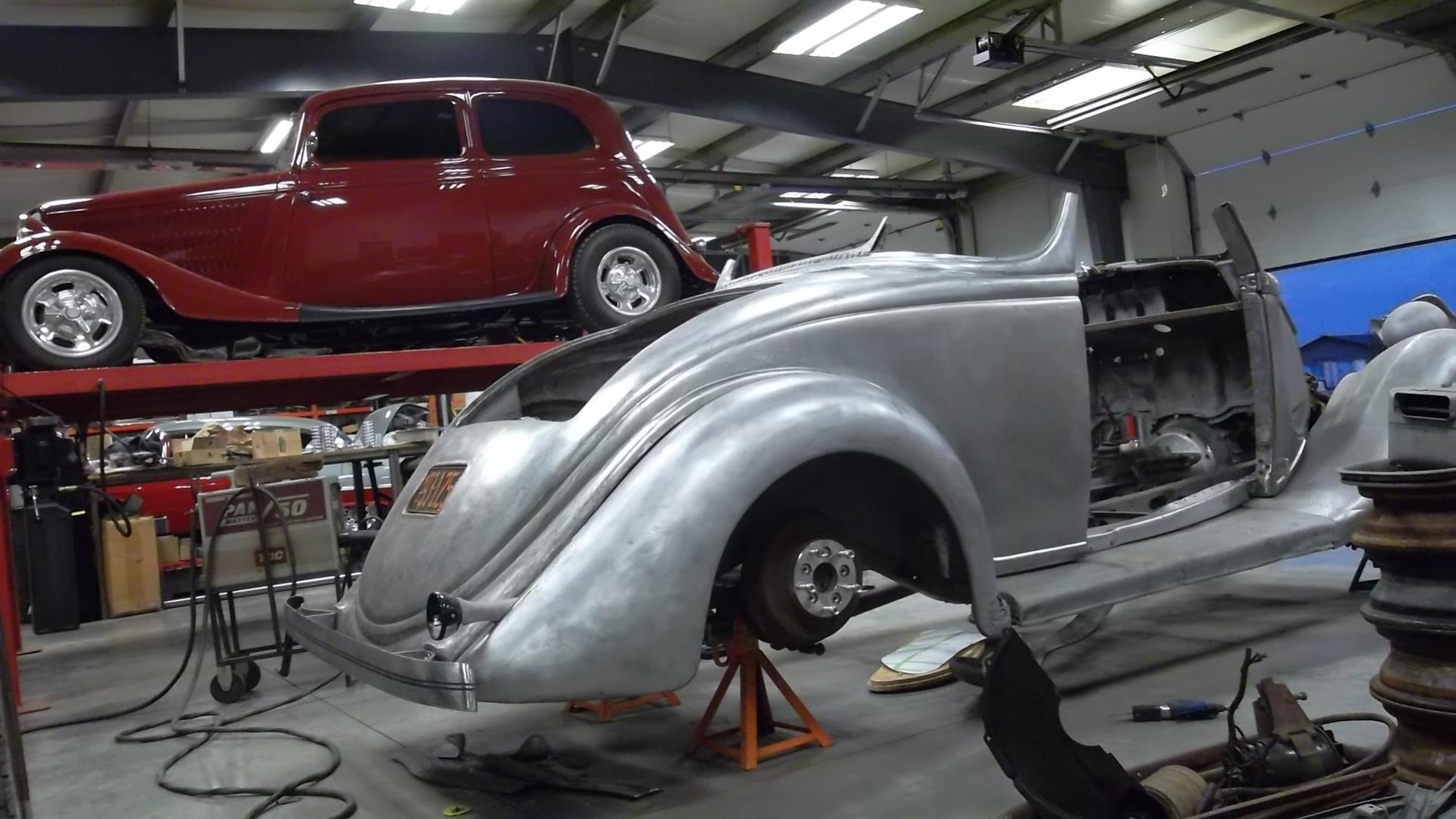

    A little slow here but love the taillights!
