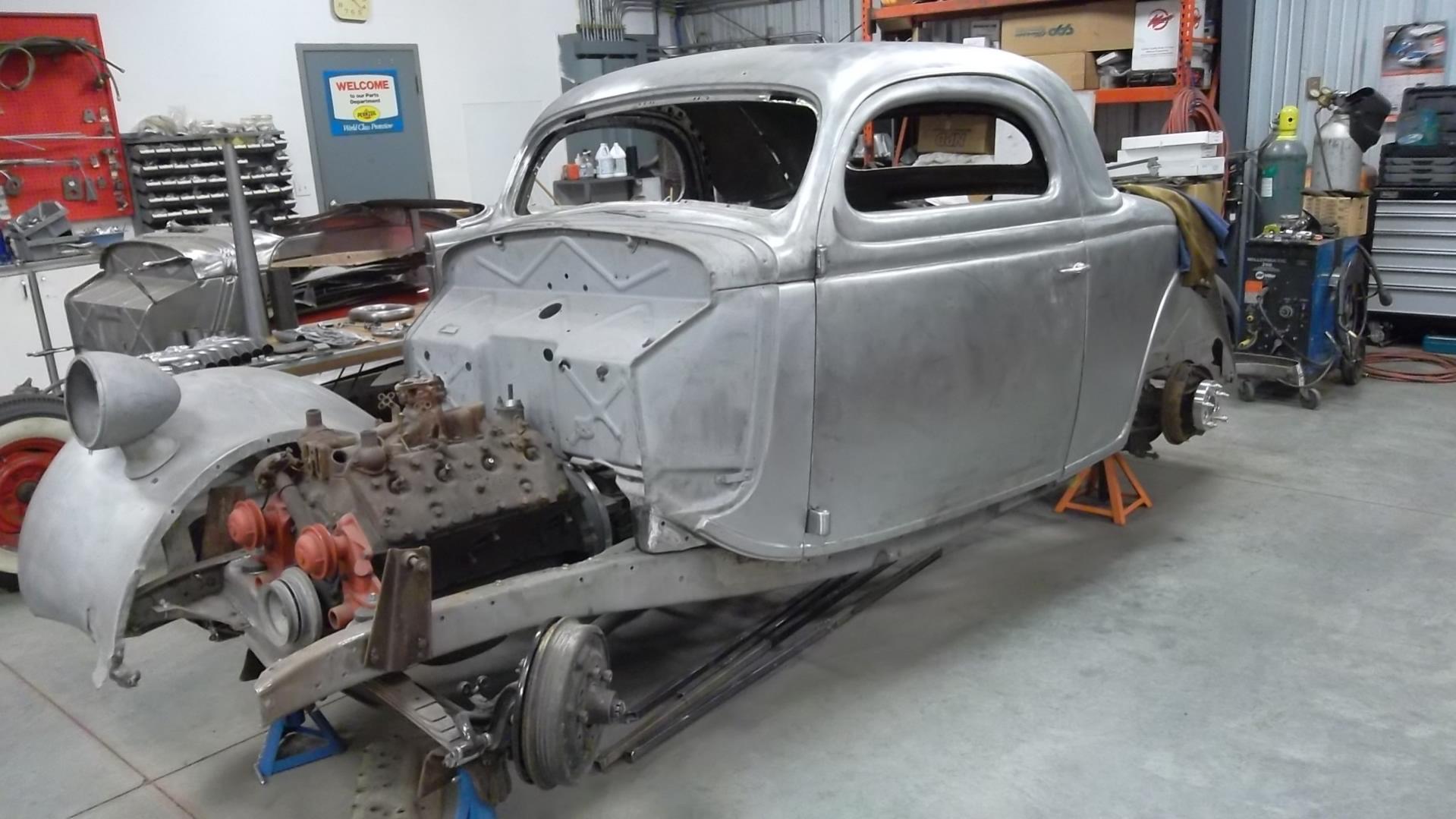

  5. Fomocokid
    Joined: Aug 1, 2009
    Posts: 573
    Fomocokid
    from Rapid City

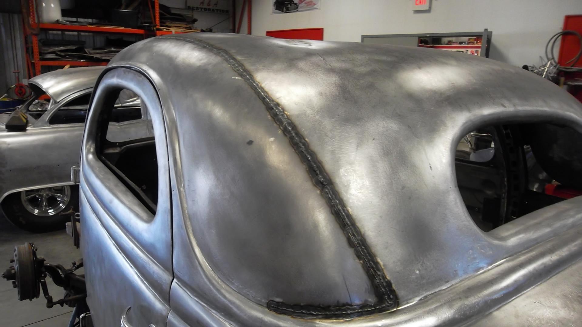

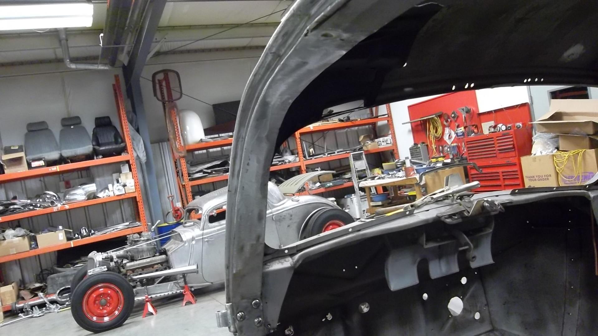

    I had to split the roof to relieve some things. The roof skin pulled the inner frame in at the top. Making this split fixed it. I just have to do the other side now.

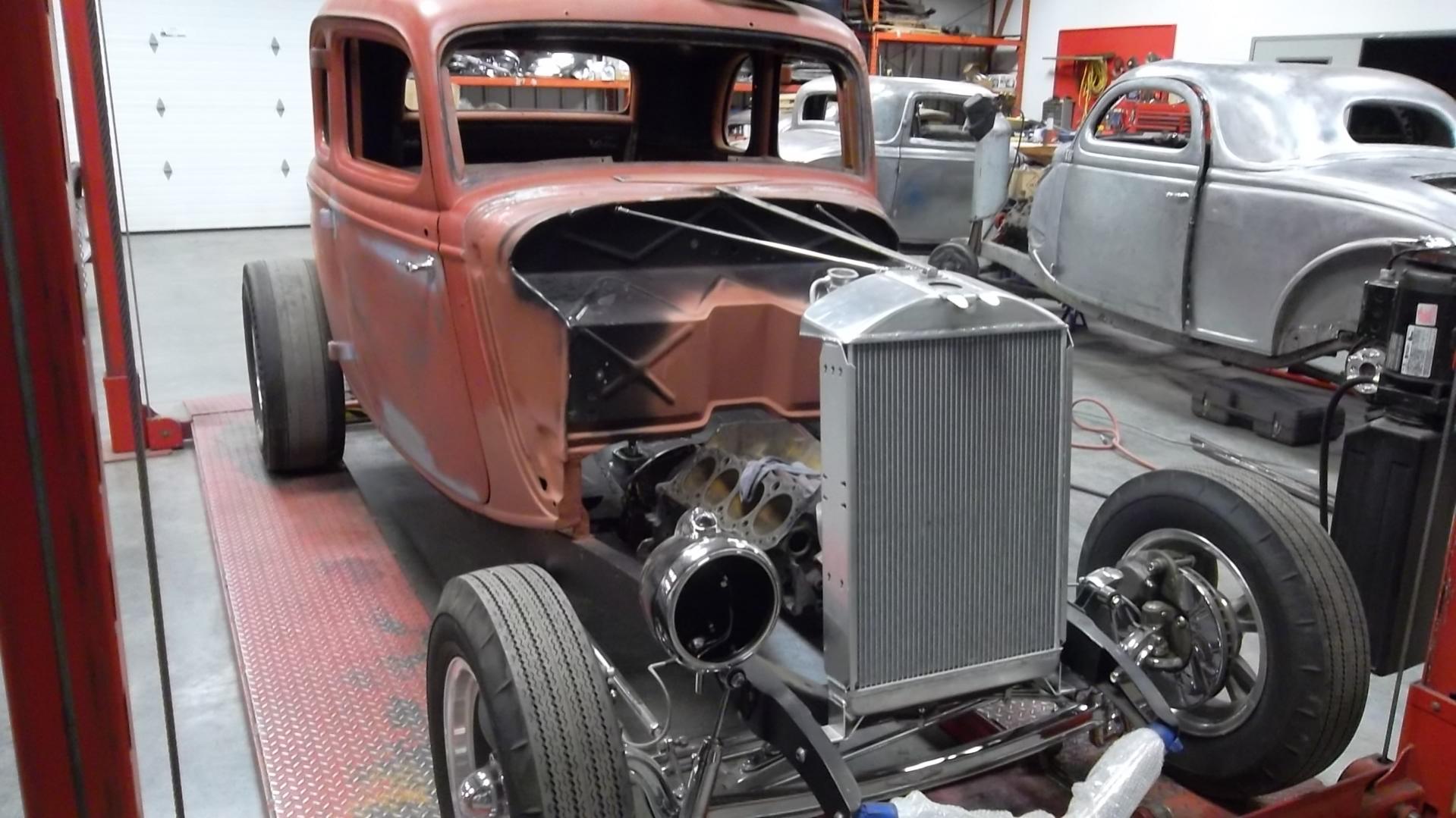

  6. Fomocokid
    Joined: Aug 1, 2009
    Posts: 573
    Fomocokid
    from Rapid City

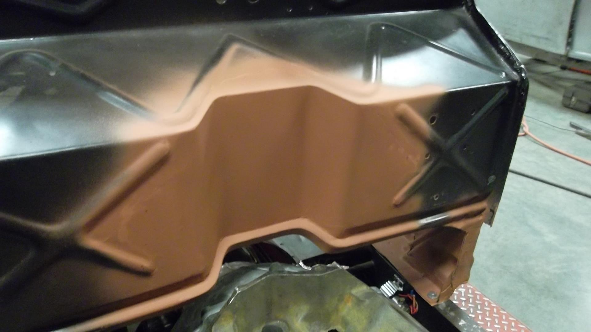

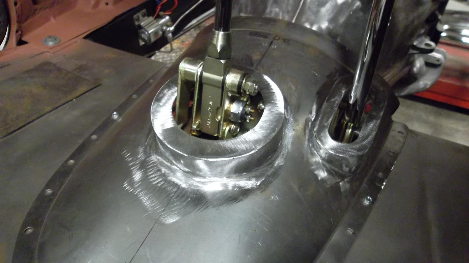

    Here is the '34 you asked to see Tom. Gene put quarter and cowl patches in it. We also put a *****in Products floor in it. I recessed the firewall for the sbc. I also made the rings around the shifter and parking brake. Once I finish Mike's '55 chevy I will be back on this and put toe boards in and mock up the steering column. The '32 3-window you see in the background once in awhile belongs to this guys brother-in-law.

    If you are the future of metal fabricators, we are all in good shape!
    That is some stellar fab work on the tunnel and firewall of the 34 for sure. Been stalking your thread since the beginning, it's refreshing to see our youth still has some ambition!!!

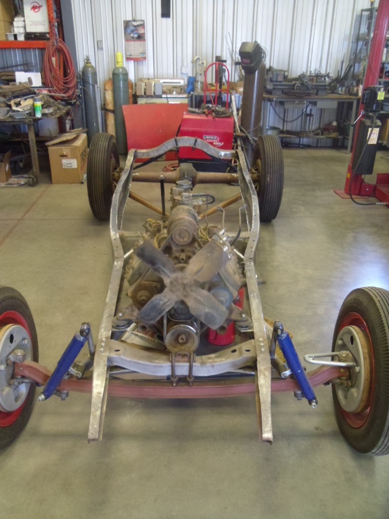

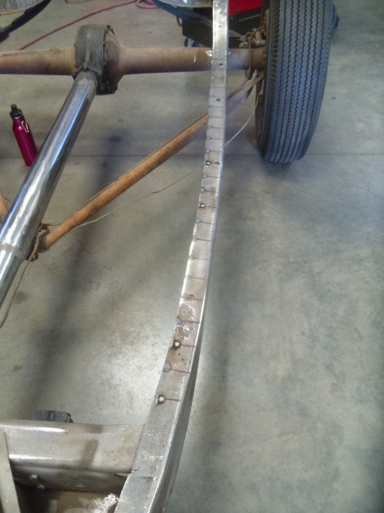

  15. Fomocokid
    Joined: Aug 1, 2009
    Posts: 573
    Fomocokid
    from Rapid City

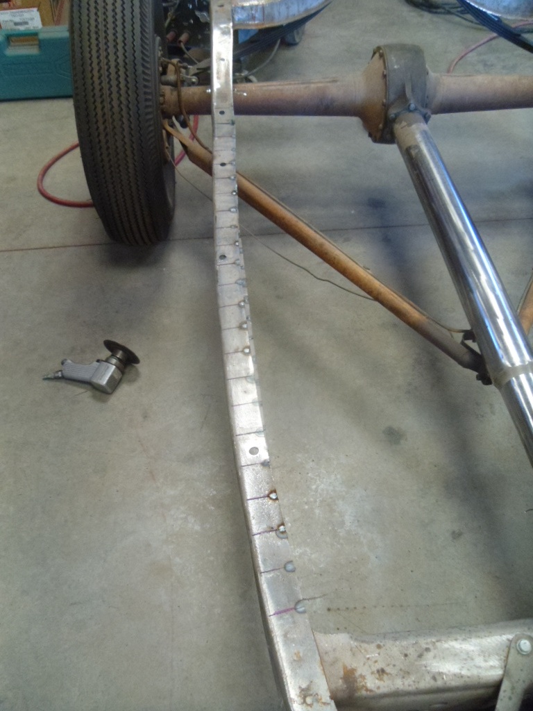

    Here is a model A roadster I worked on awhile back. It is an original '32 frame. When I started on it the front was already pinched but the frame stuck out from the body about half an inch still. I cut the top and bottom of the rails every 2 inches and moved them around to follow the body.

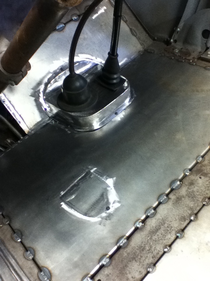

  16. Fomocokid
    Joined: Aug 1, 2009
    Posts: 573
    Fomocokid
    from Rapid City
    I made the front floor pan and ****** hump and I mounted '39 tail lights in it.

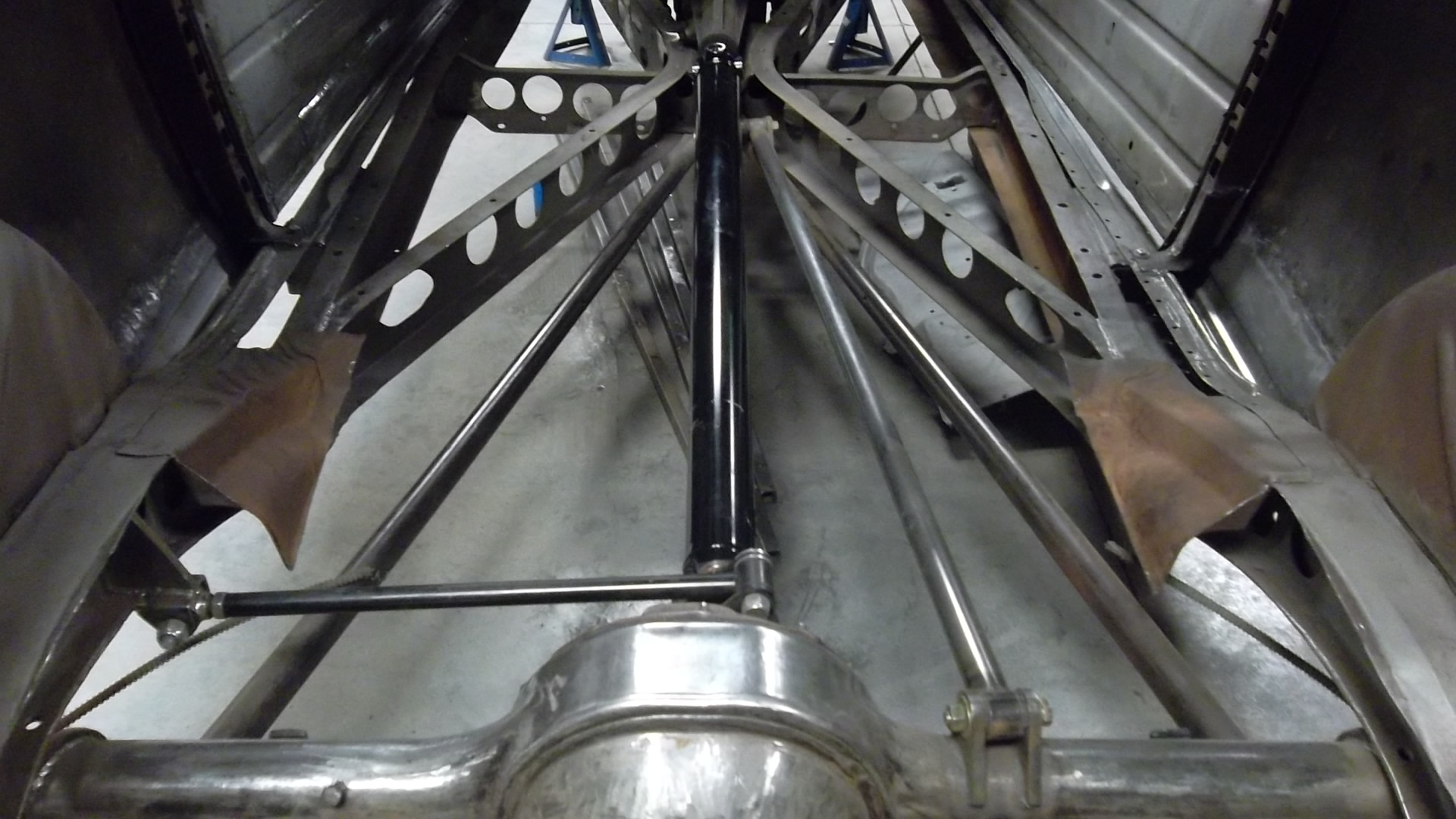

  17. Fomocokid
    Joined: Aug 1, 2009
    Posts: 573
    Fomocokid
    from Rapid City
    I made the rear subrails to follow the frame. I welded the rear floor pan in. I made a cover to go over the model A spring. I also had to shorten the trunk filler panel to match the new floor.

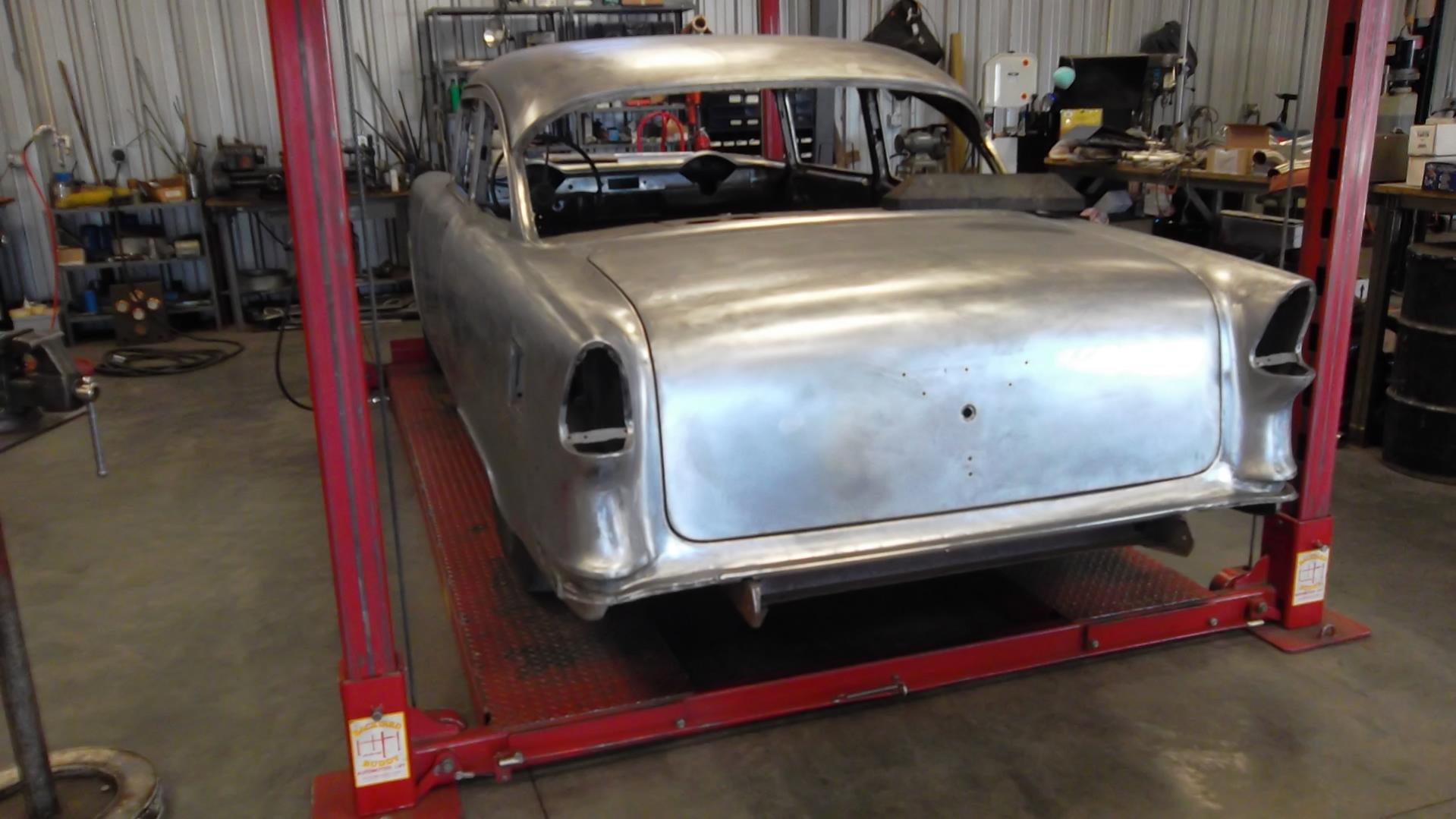

    Here's the '55. Gene did the front of the hood with nothing more than a hammer and a dolly, the only welding was filling the trim holes.
    mgtstumpy likes this.

    Last night I plug welded the front of the inner frame to the sheet metal. I made the last piece of door jamb, which I cut out so that I could get the skin onto the frame work. I then gapped the top of the door

    Got my drive shaft today. i got the roof tacked together on the p***enger side now.

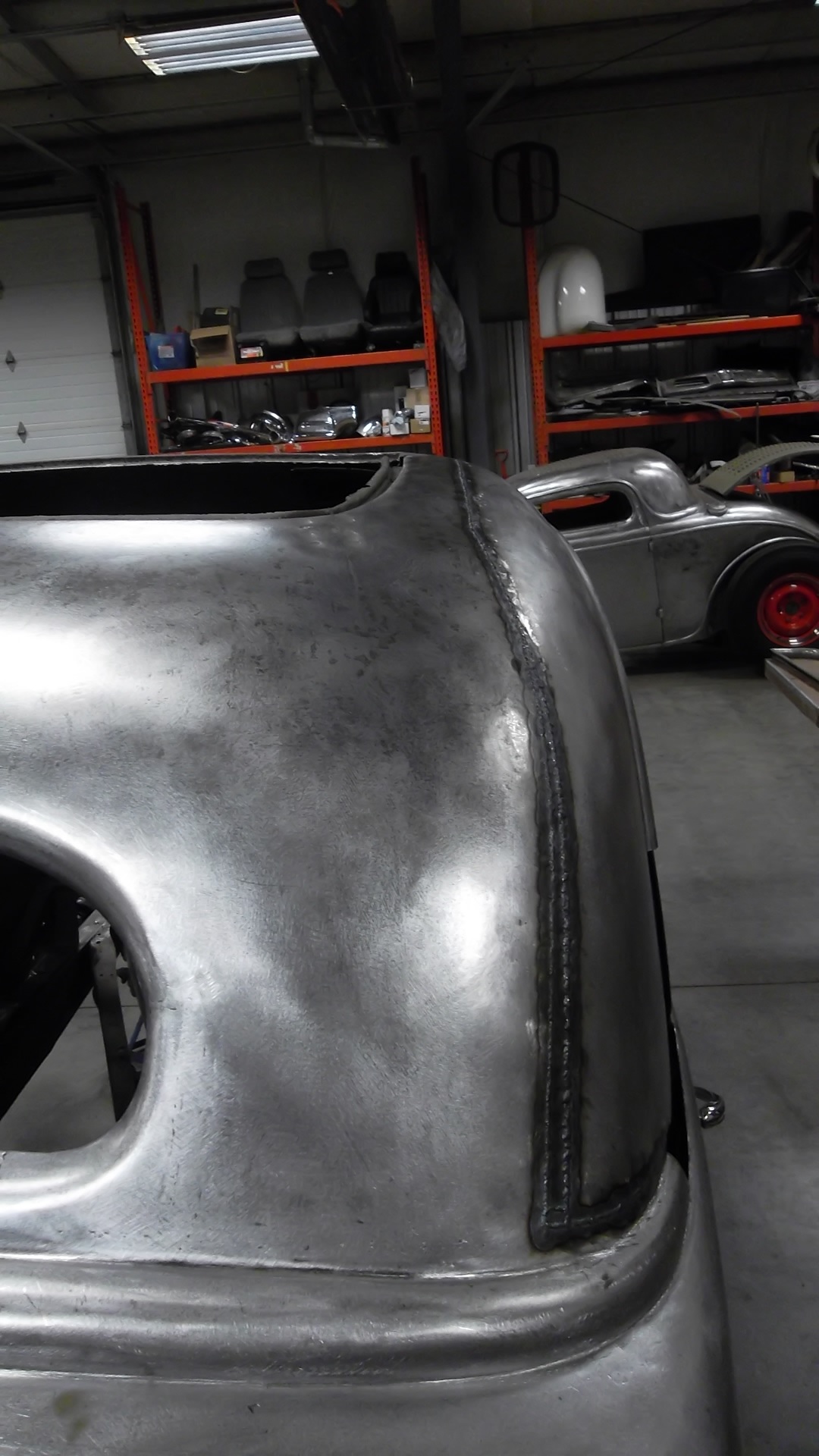

    Welded up the back corner of p***enger side roof last night
