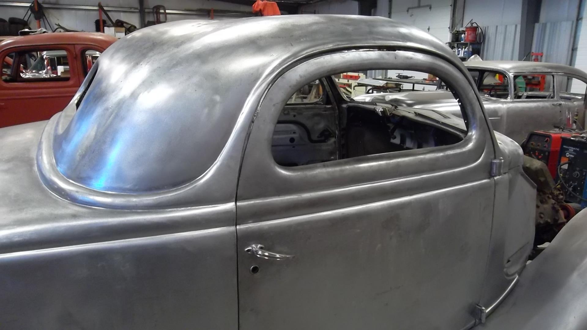

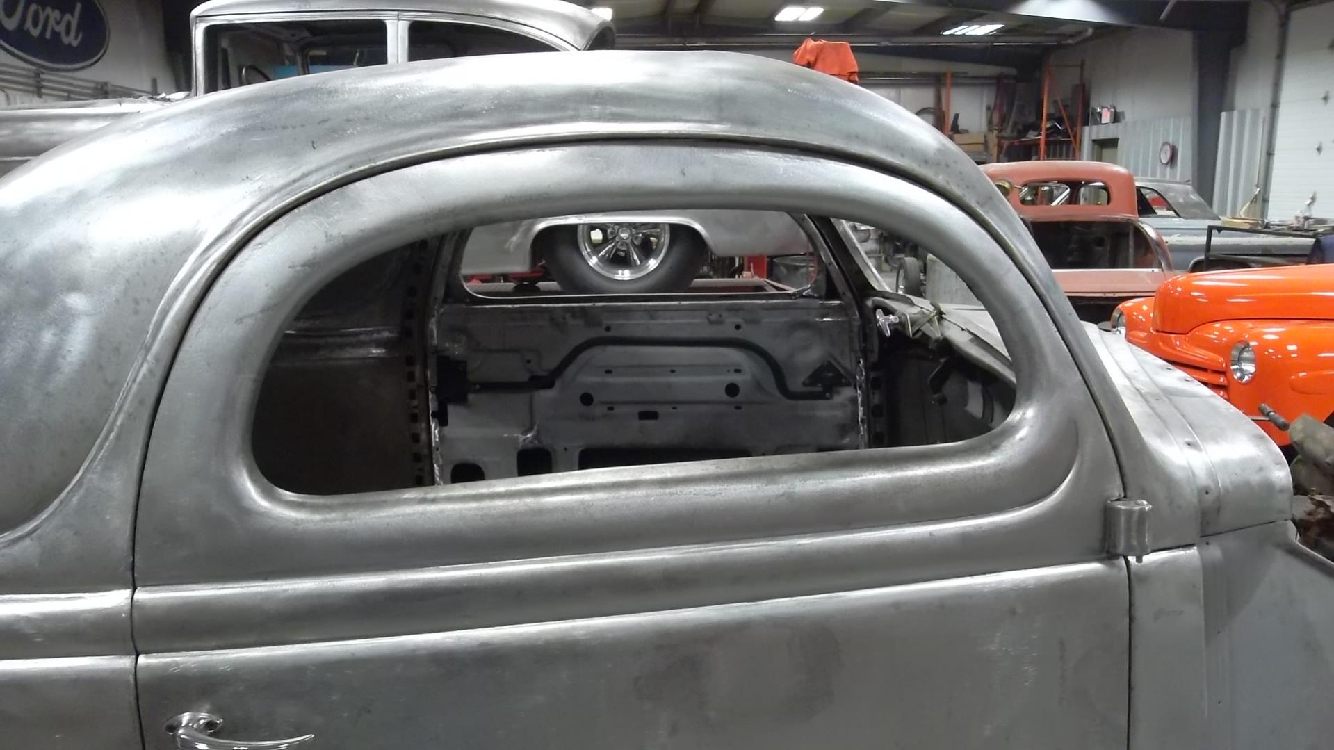

    Some more pics. Got the door jamb piece tacked in. Just have to weld that up and gap the top of the door.

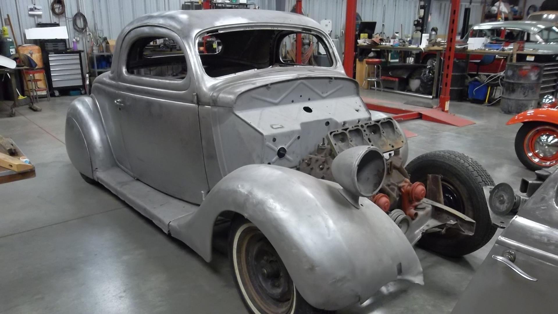

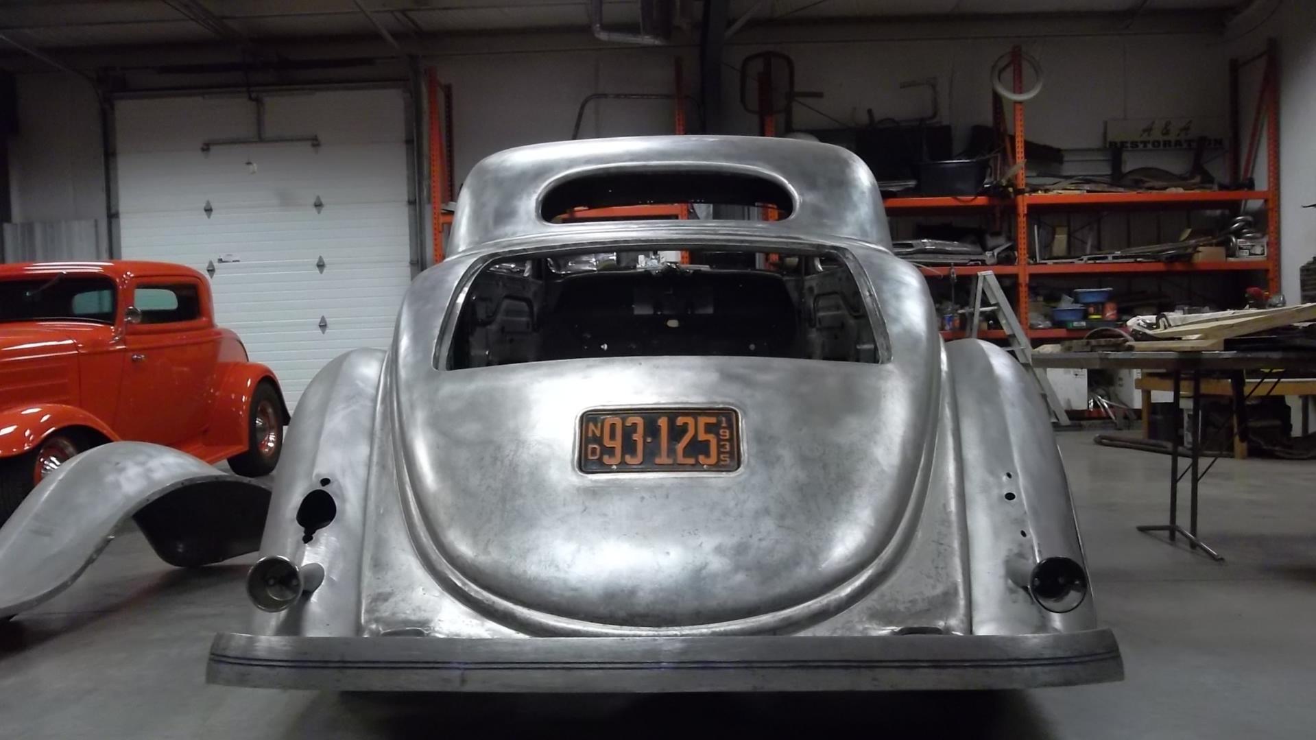

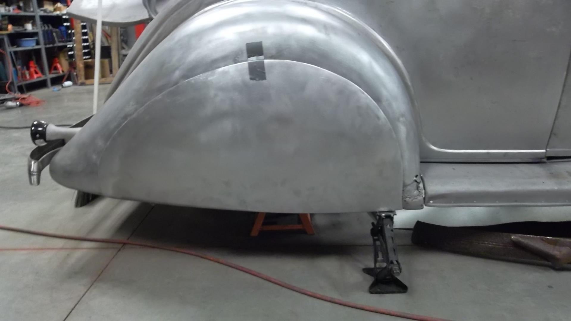

    I made a piece and welded it into the door jamb just like the other side. I gapped the top of the door. I got some fender skirts, just set one up against the fender to see how it will look

    41 buick skirts?

    The car looks amazing! Not reall digging the skirts.

    Ok about the skirts. The bottom needs to come down to meet the lower edge of the front part of the fender, is that what you were telling me on the phone? It's hard to tell on the blurry picture, on the back edge dose that go forward as it goes down?? If it does I think you need to fix that too, but I sure with your eye for perfection you already knew that.

    Looks like you might have the same problem as I had with the tudor. Get the bottom where you like it and the top is too short. I originally pie cut from the center out to front and rear on the top arch of the fender opening and made them 1/2" lower in the opening (if that makes any sense). I finally gave up trying to make them fit and made my own from scratch. 35/36 openings are pretty unique. Jake

    The back is fine its just the front that needs to come down. Im going to do a few other little modifications while Im at it. Going to get a solid plan laid out in my head over the weekend.

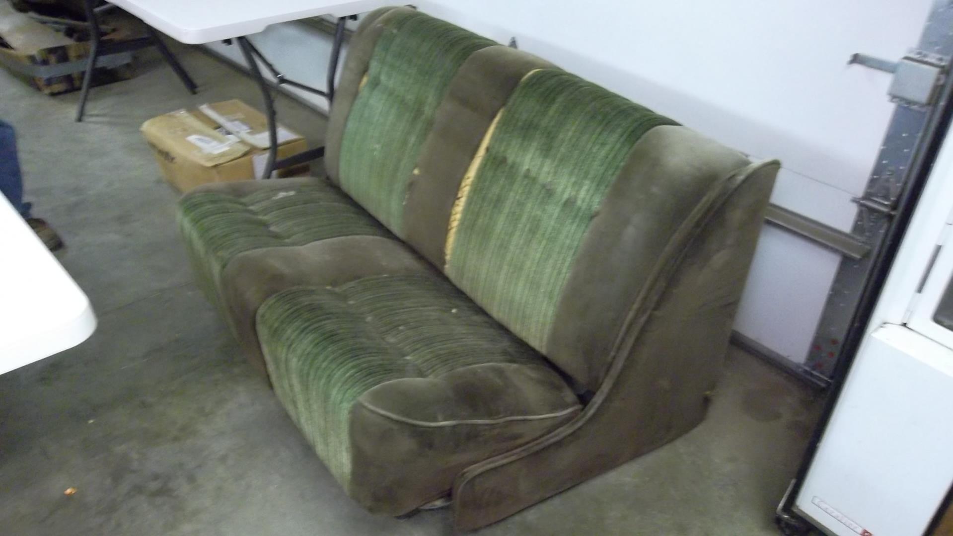

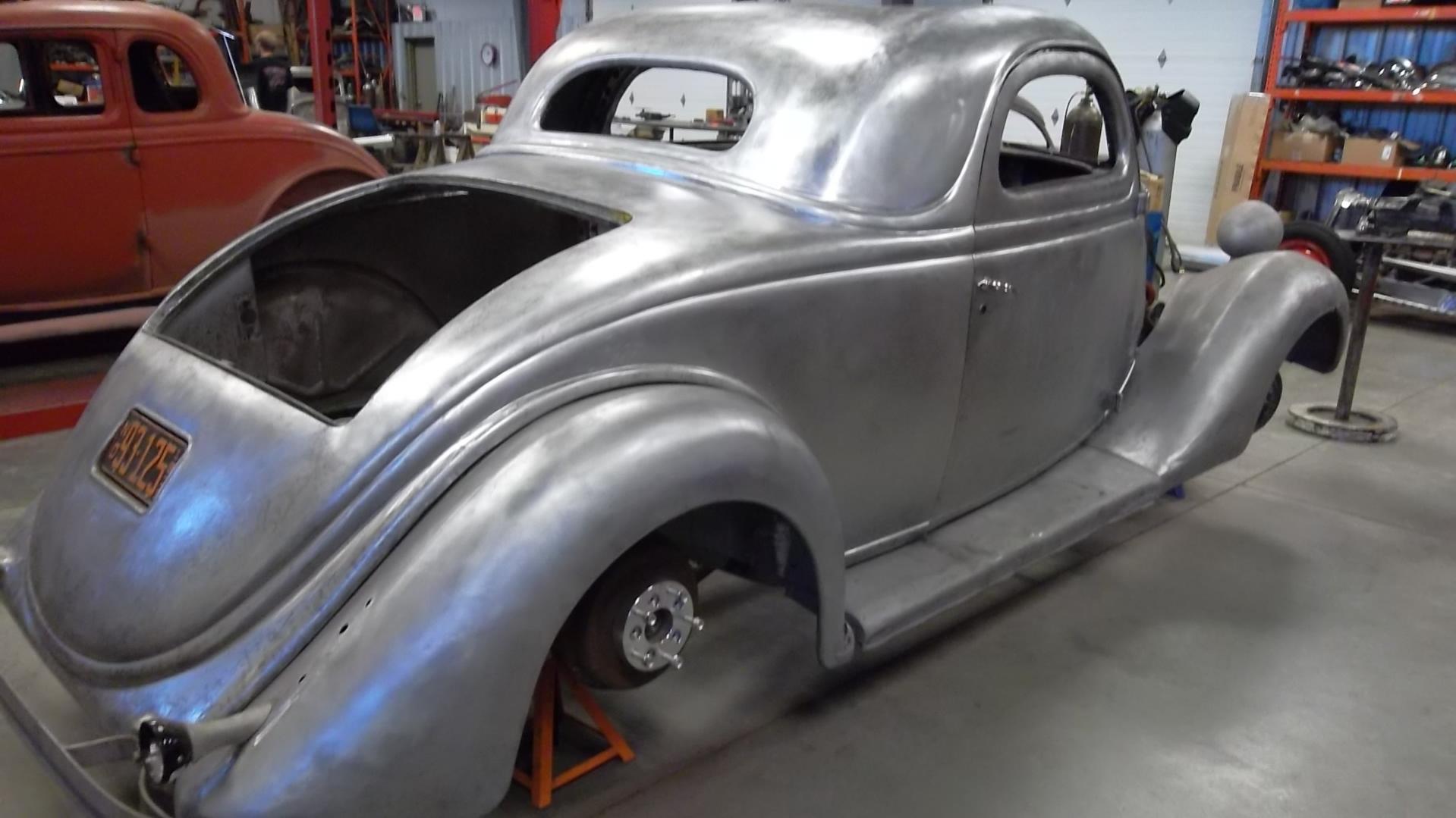

    I picked up a seat over the weekend

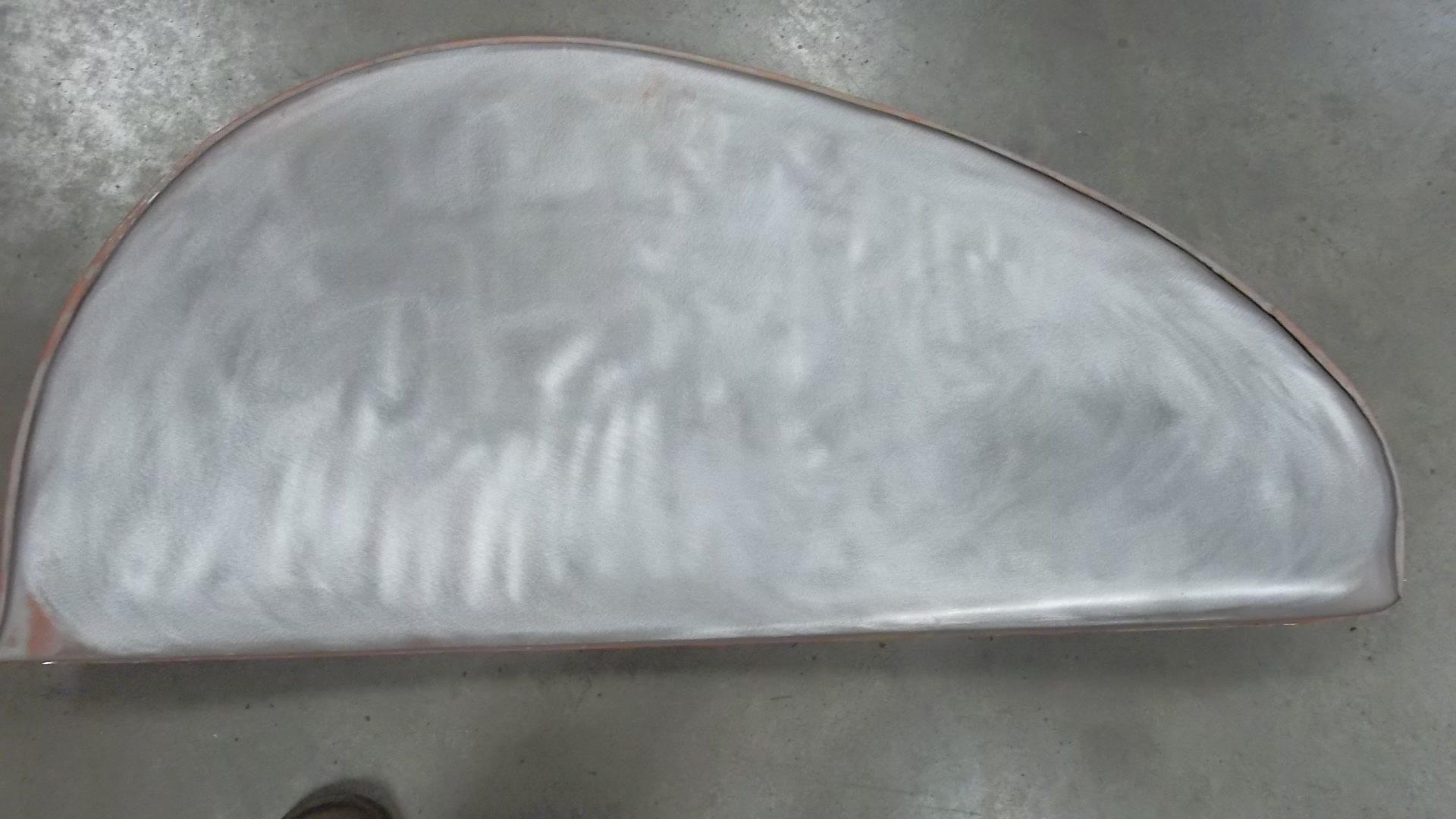

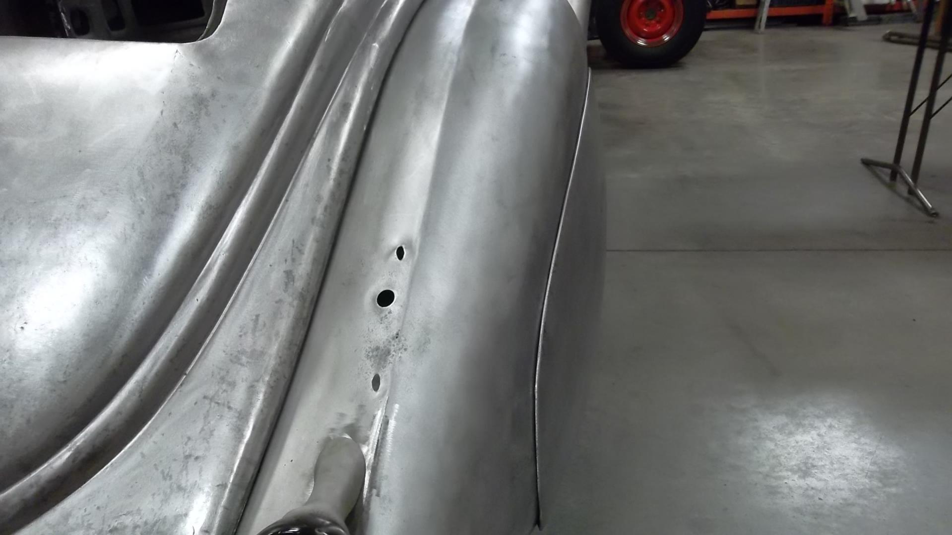

    I drilled all of the rivets out and took all of the structure off of the fenderskirt. I then took all of the primer off. I decided to redo the top radius instead of splitting the bottom. I think it worked quite well

    Nice job on the skirt redo....Jim

    Yeah, the skirts look great!!

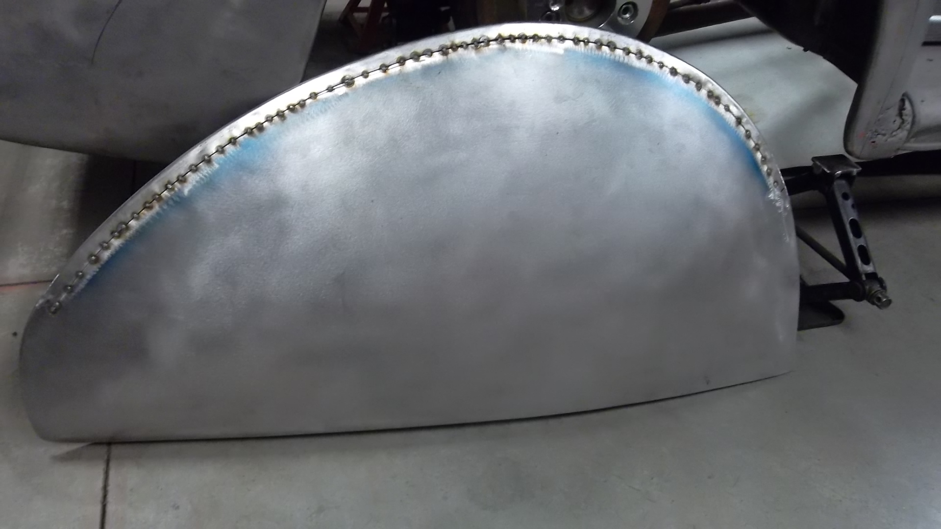

    I made a clamping system last night for the skirt. I think I am going to redo the back part because it isnt pulling it as tight as I would like.

    The interior I plan on using the original seat. It will most likely be black and cream tuck and roll

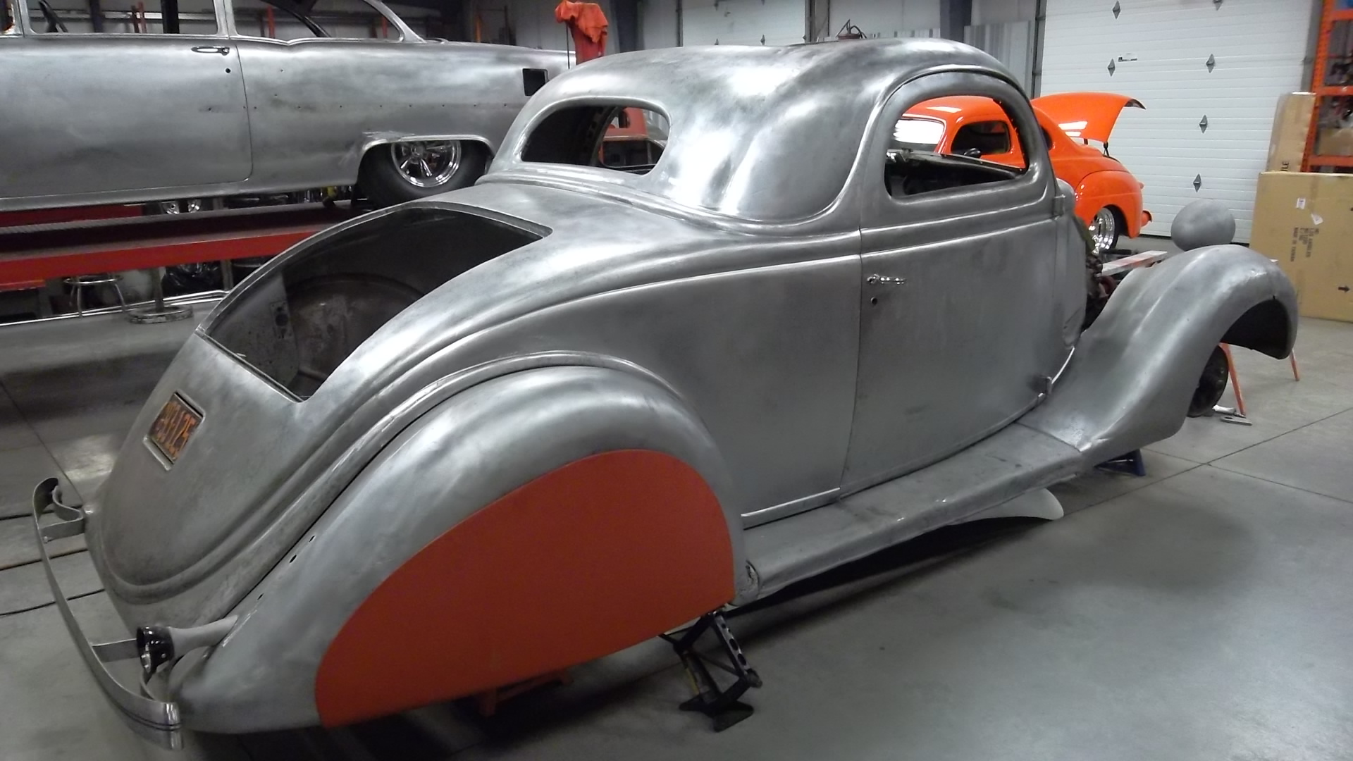

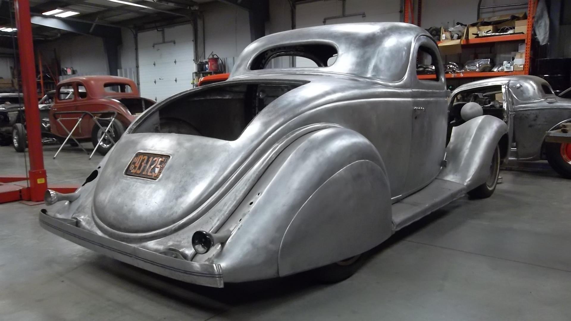

    I redid my mounting system. I am now satisfied. I put some wheels and tires on that we had around the shop. It looks much better now that it is on the ground.
