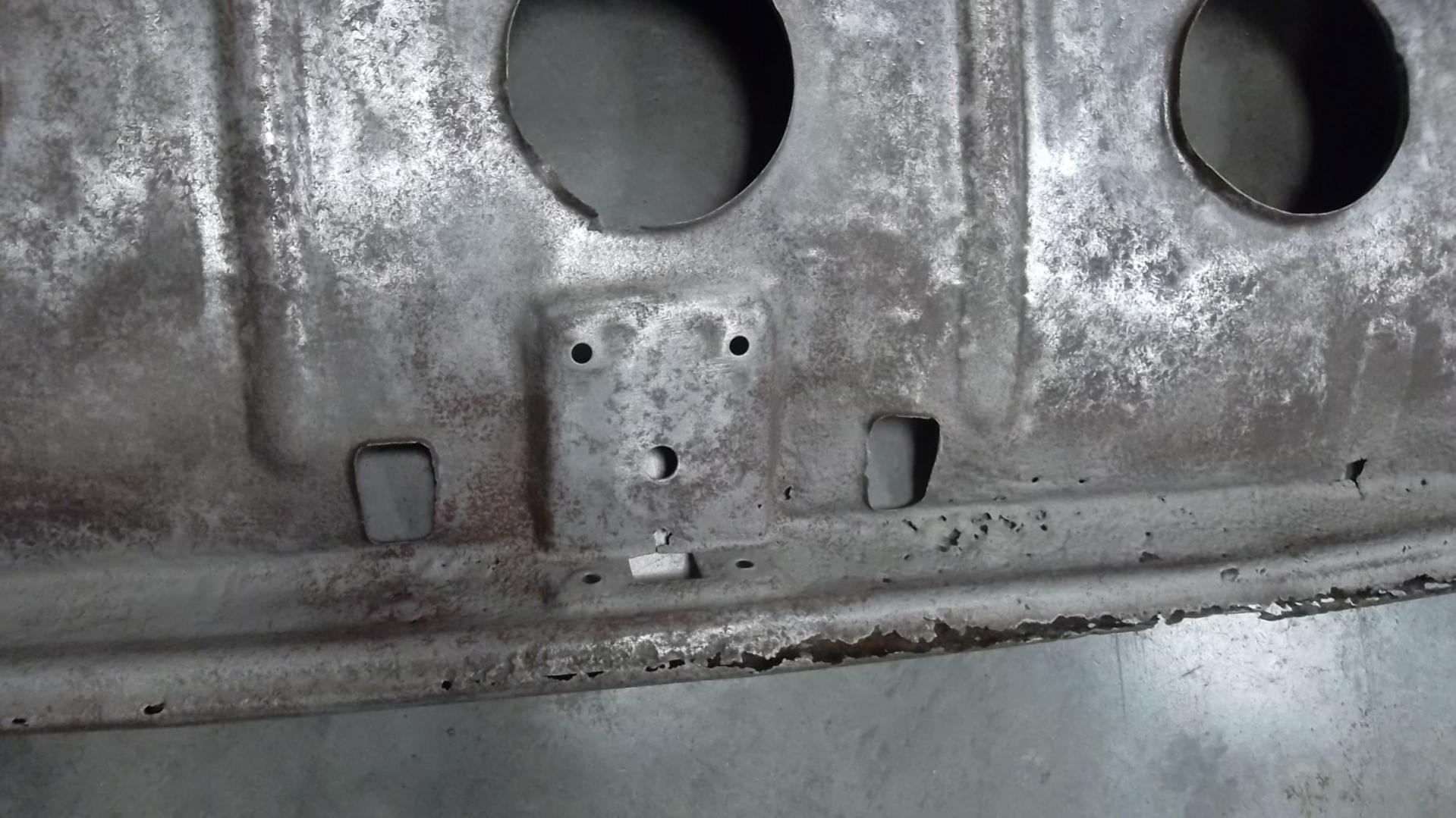

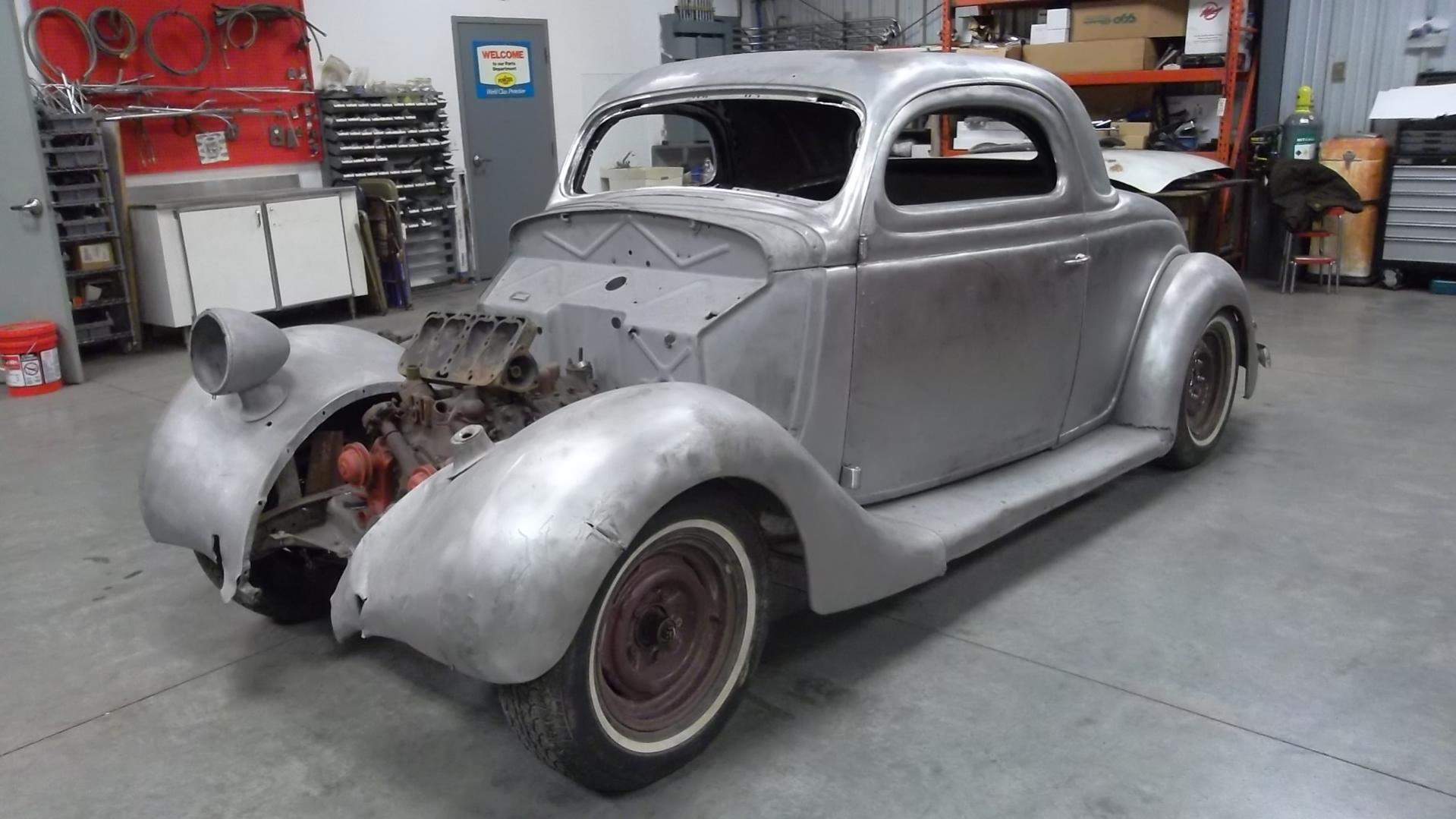

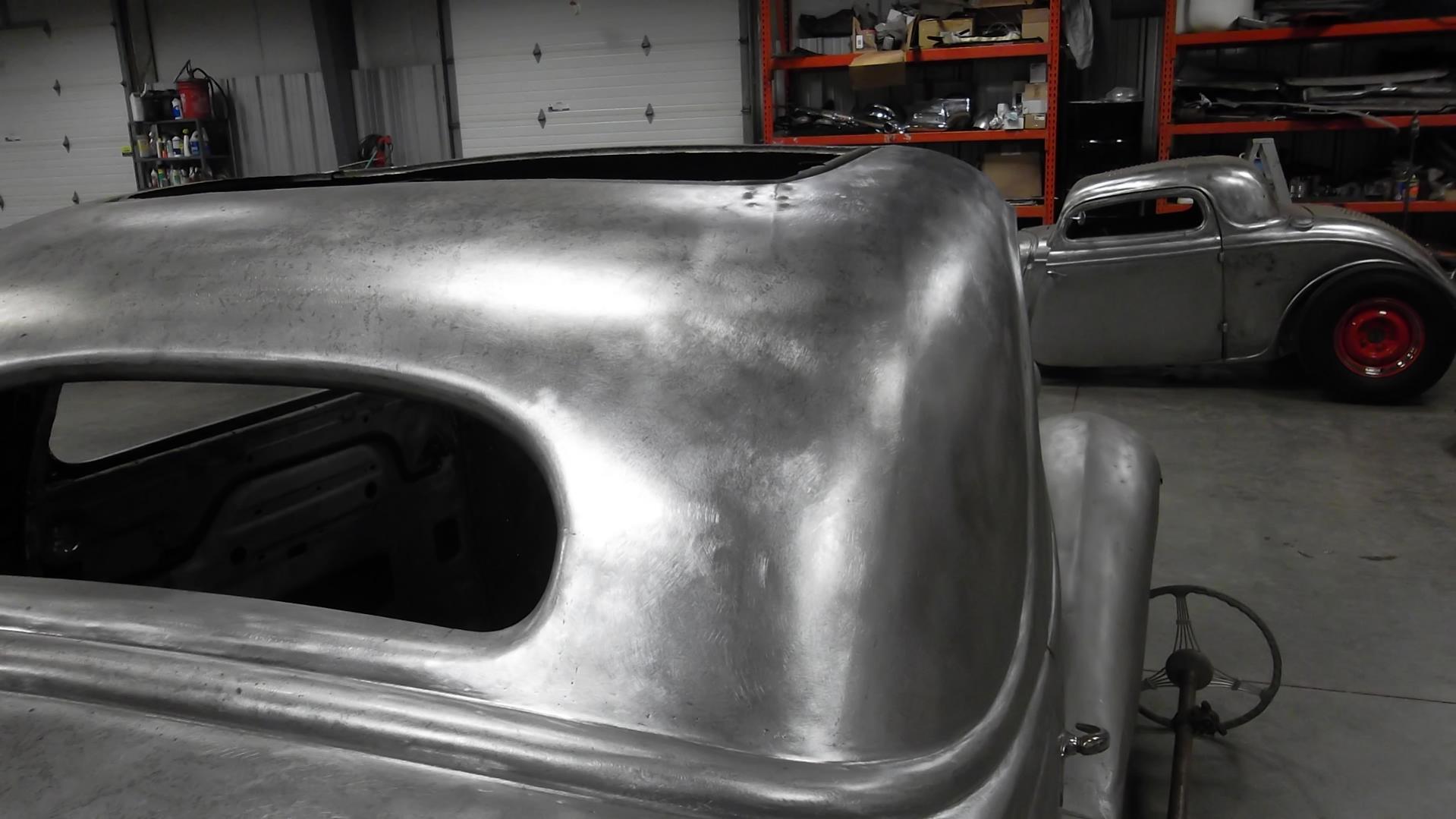

    I did some straightening on my weld on the p***enger side. I also set the decklid skin in the hole just to see what it looks like with the hole filled

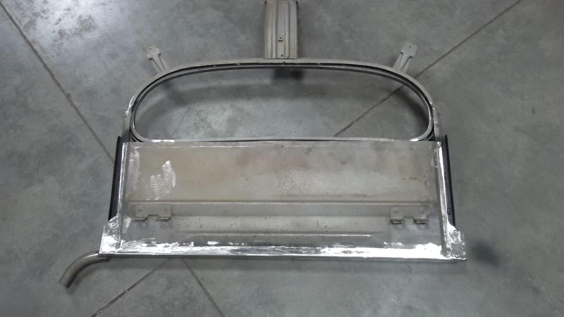

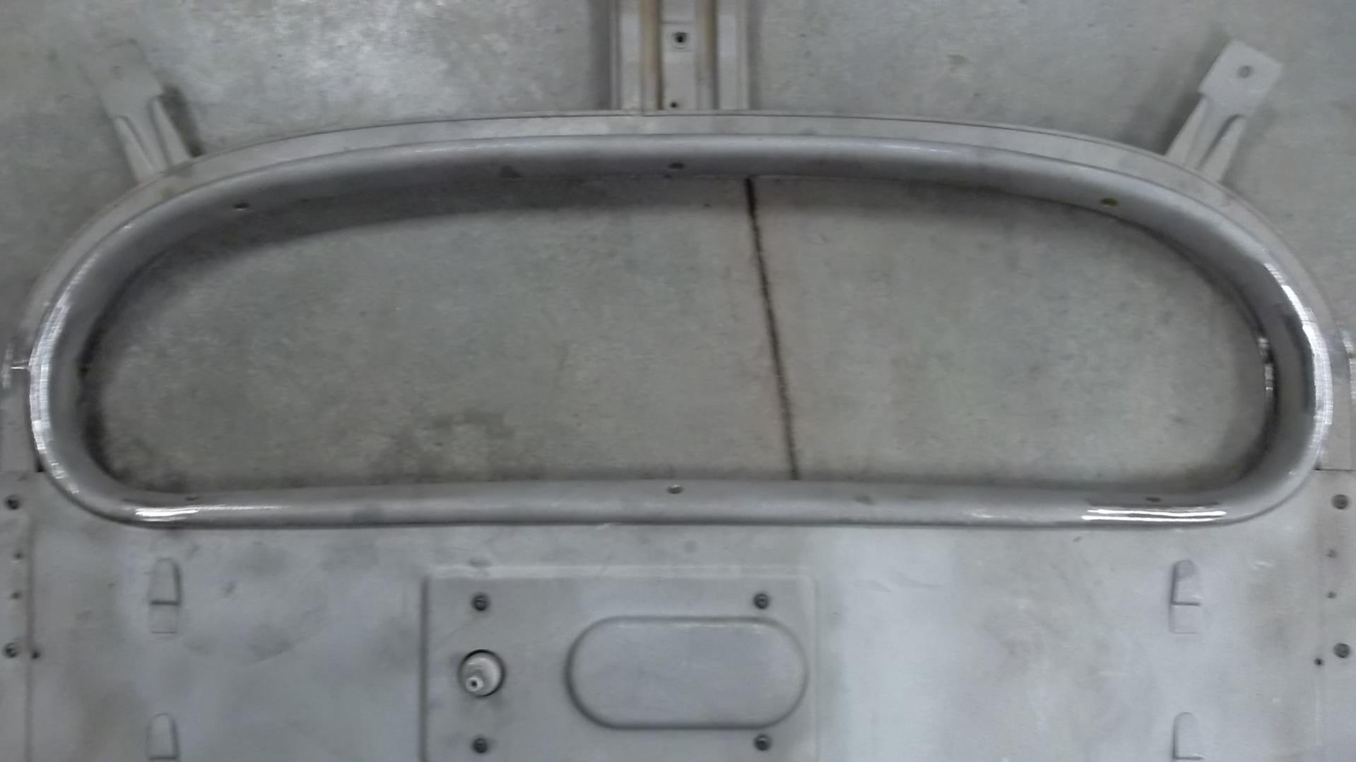

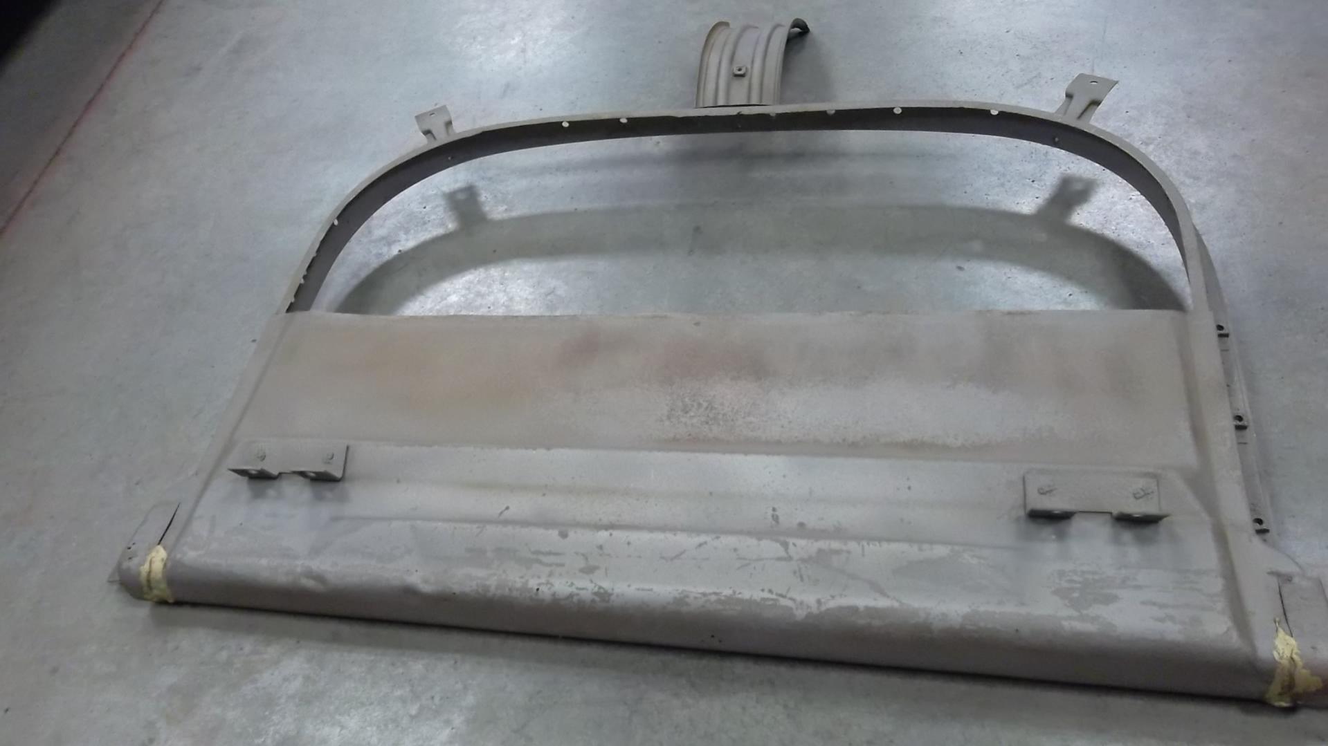

    I started on the back window surround tonight. I drilled the plug welds and took the bottom drain pan off. I chopped the frame work. I then had to narrow the bolt on panel on the front. Ill finish it up tomorrow night

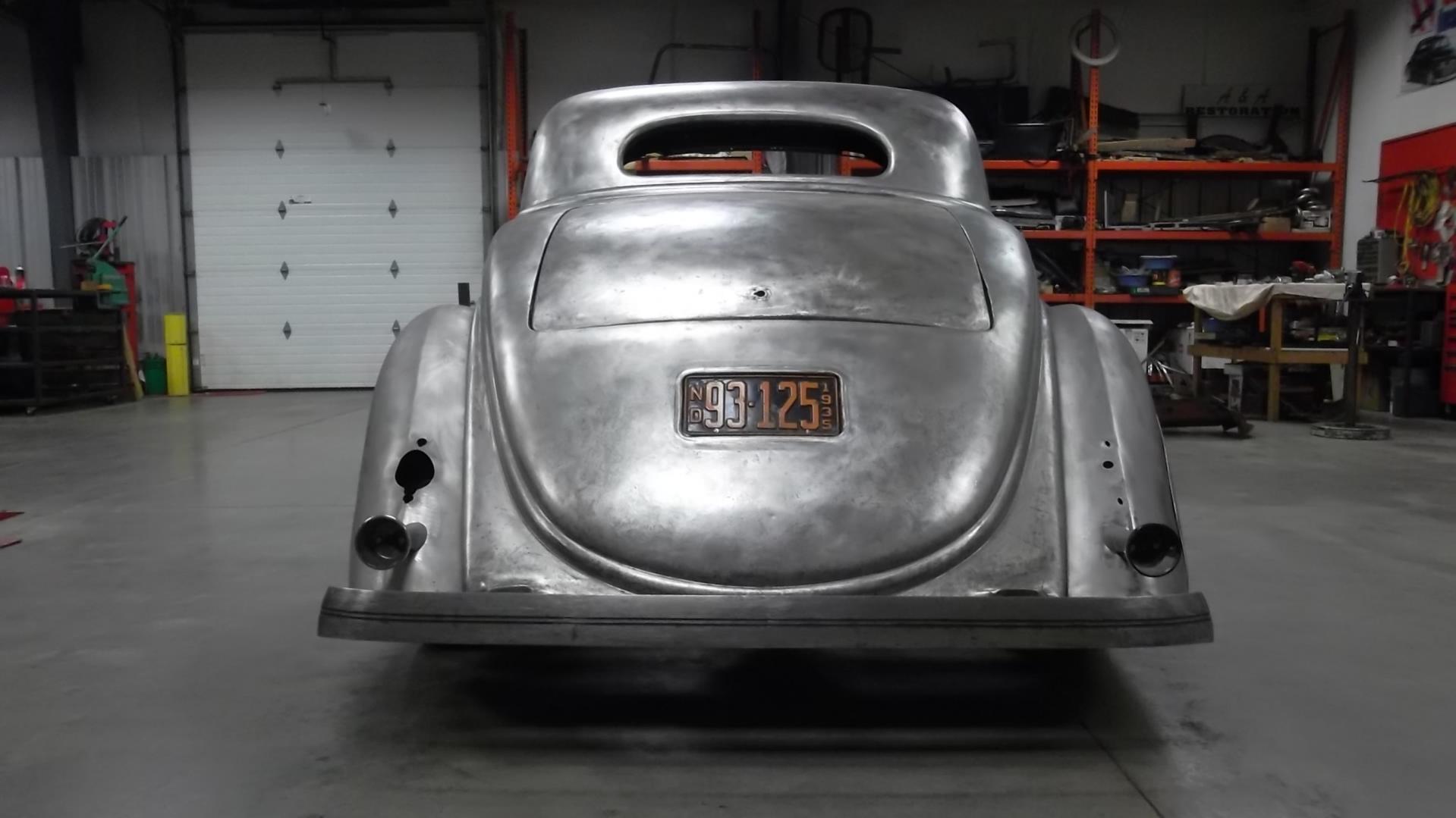

    welded up the rear window panel tonight. I also chopped the back window garnish molding. I used a sedan molding.

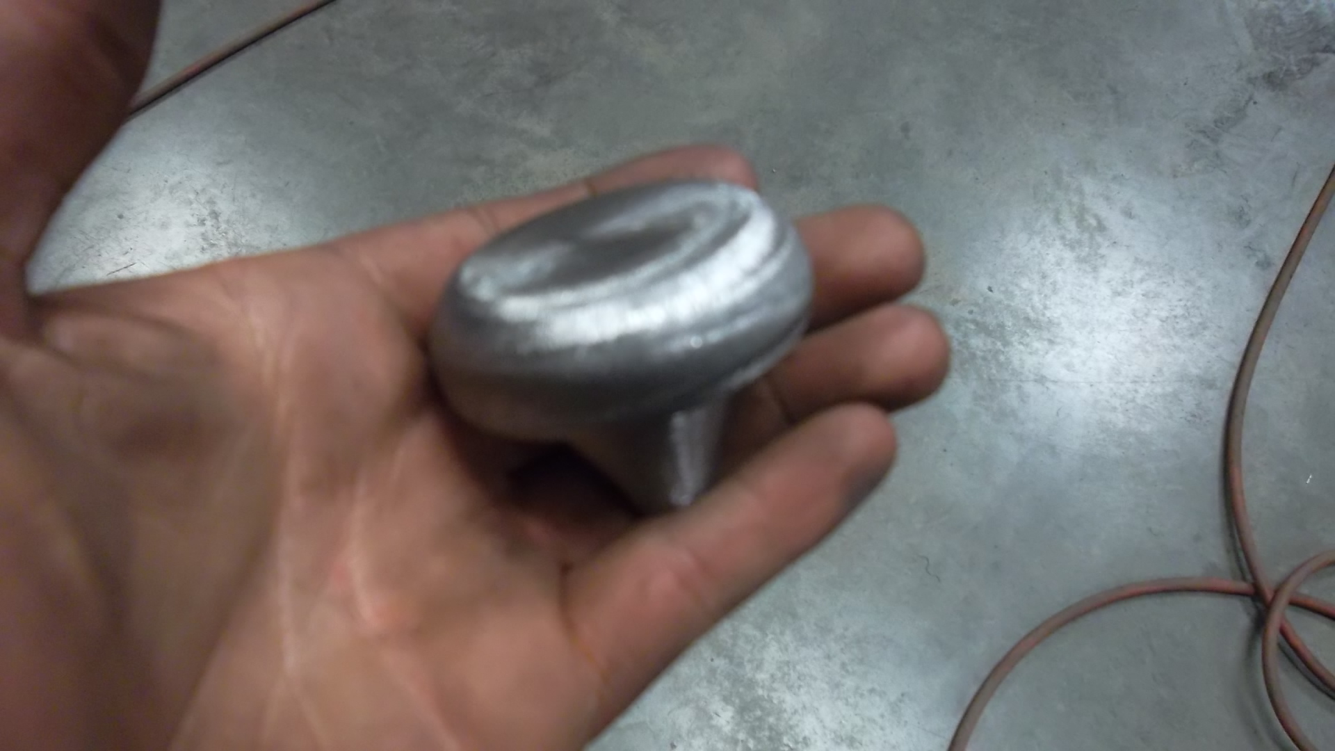

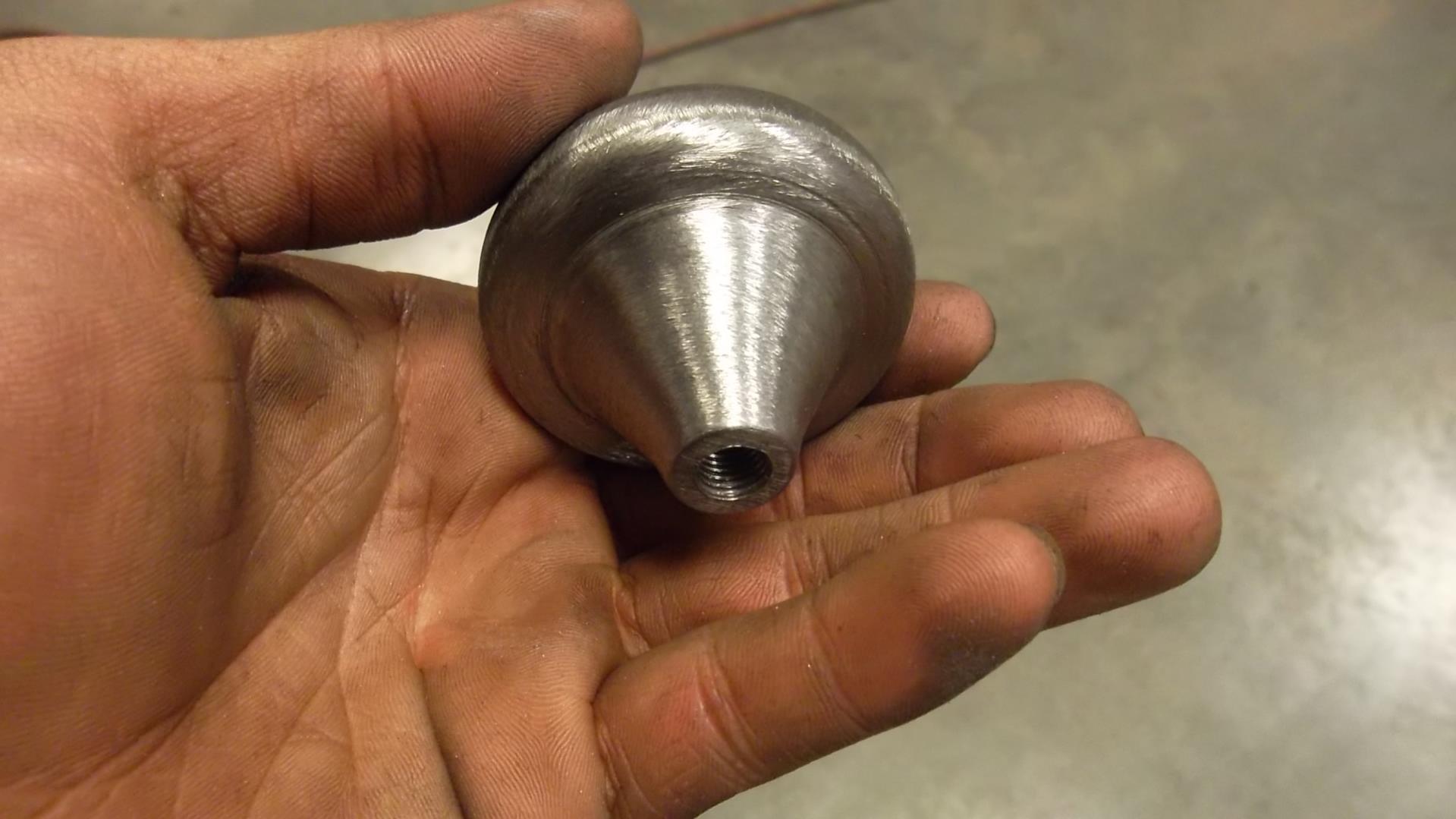

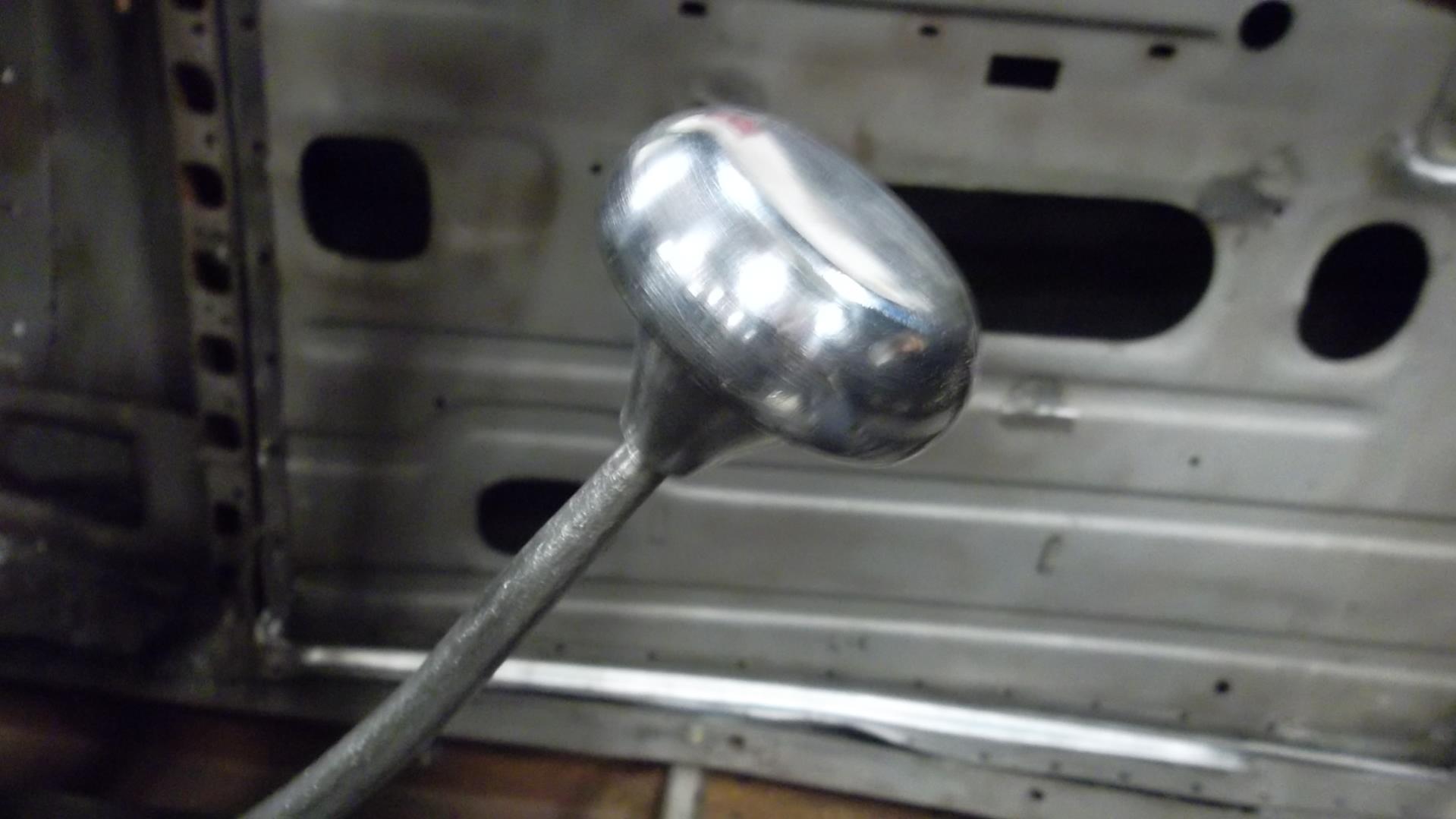

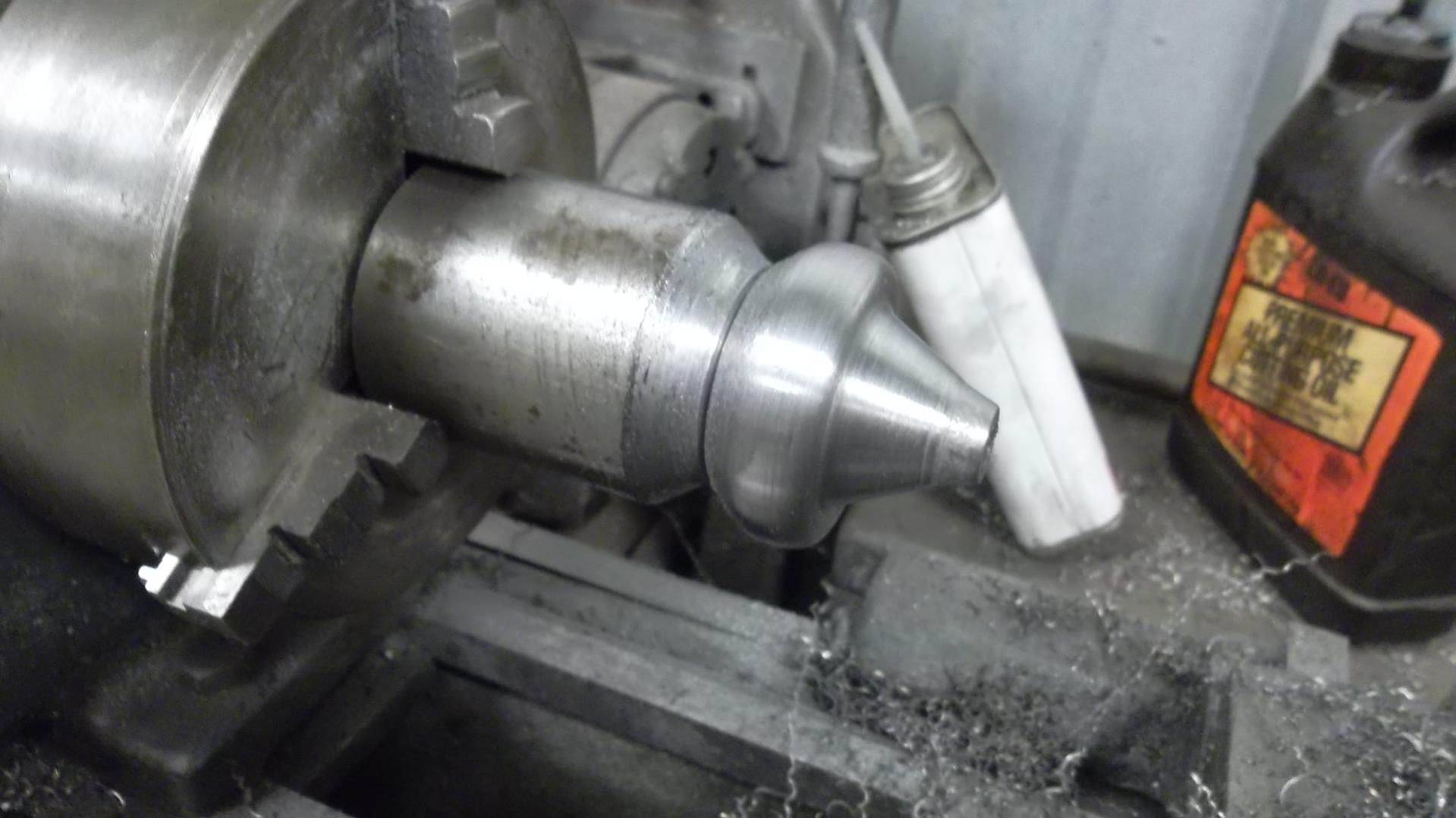

    Tonight I chucked a chunk of steel up in the lathe. I made a shift knob for myself, took awhile but I like it. I also welded the original shift handle to the t-5
    mgtstumpy likes this.

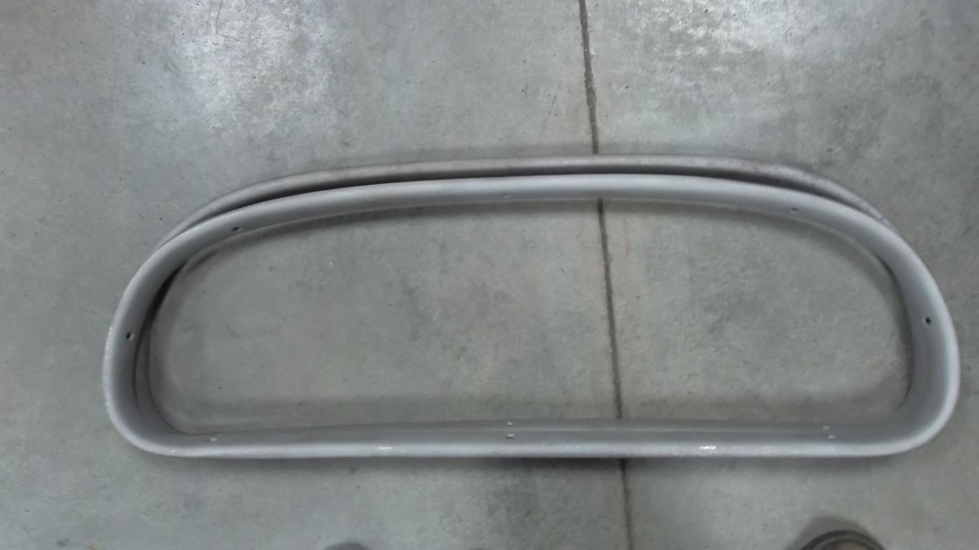

    I thought the coupe molding was a little thinner than a sedan molding, to
    allow clearance for the gl*** to roll down. I know the coupe moldings have
    slots for rubber bumpers.
  16. Fomocokid
    Joined: Aug 1, 2009
    Posts: 573
    Fomocokid
    from Rapid City
    Here is the difference from the coup to sedan. The larger one is coupe. The coupe does have slots for rubber bumpers but the 2 moldings have the same width I measured it to make sure it wouldnt affect the window

    Heres a better pic of the shift knob. I buffed it. The last 2 nights I worked on the drain pan for the back window. I had to replace the entire bottom of it. It is welded into the car and done now

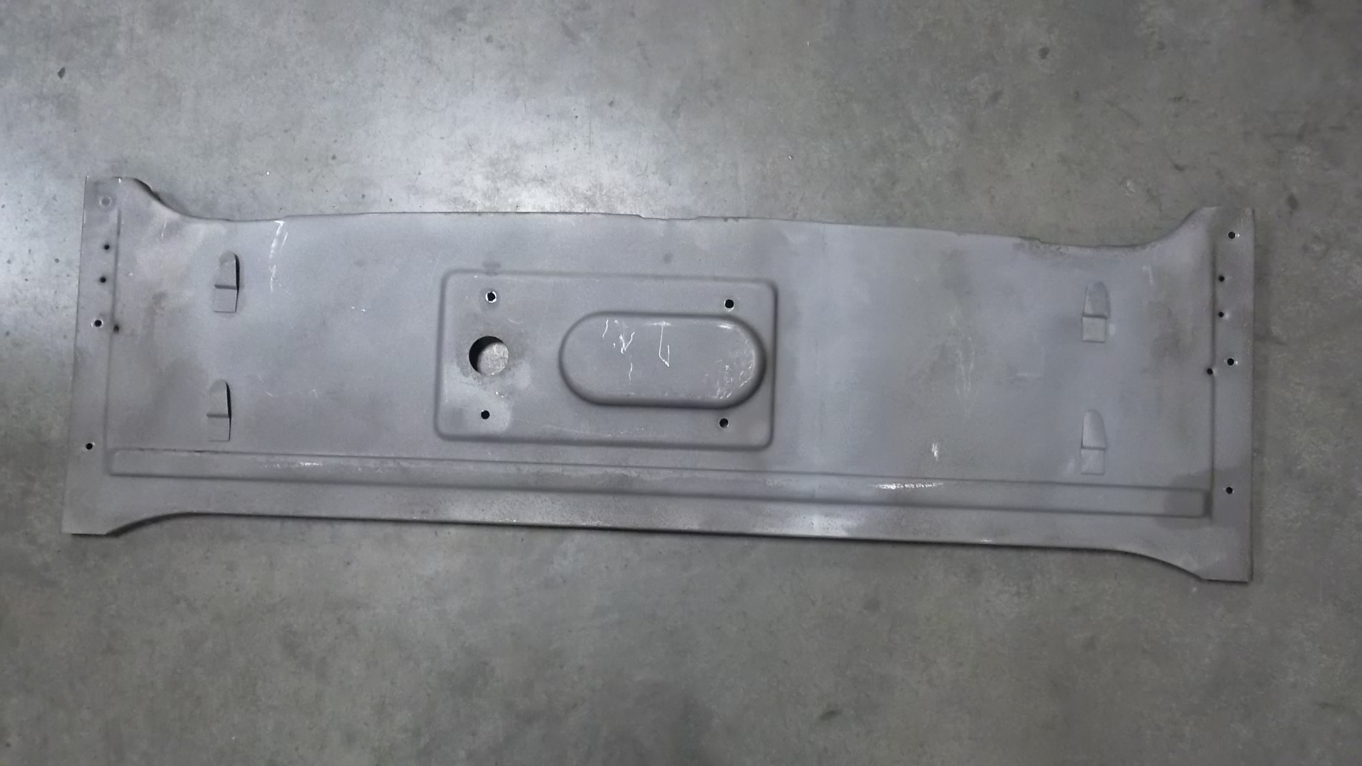

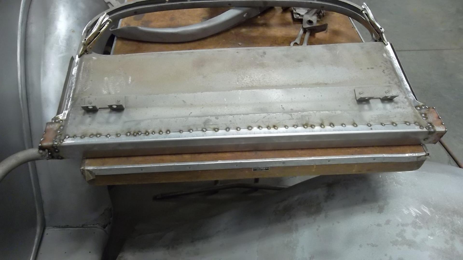

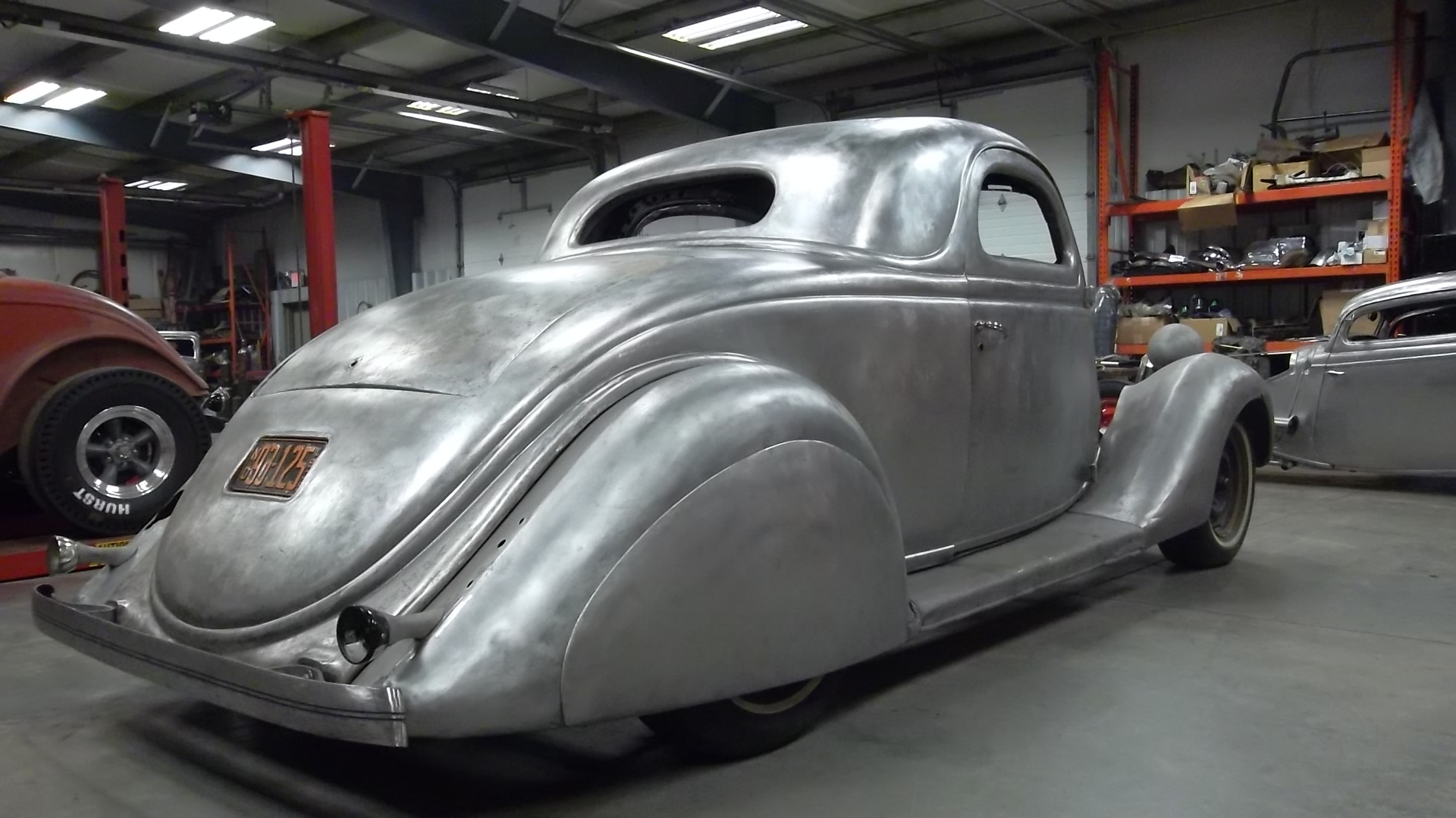

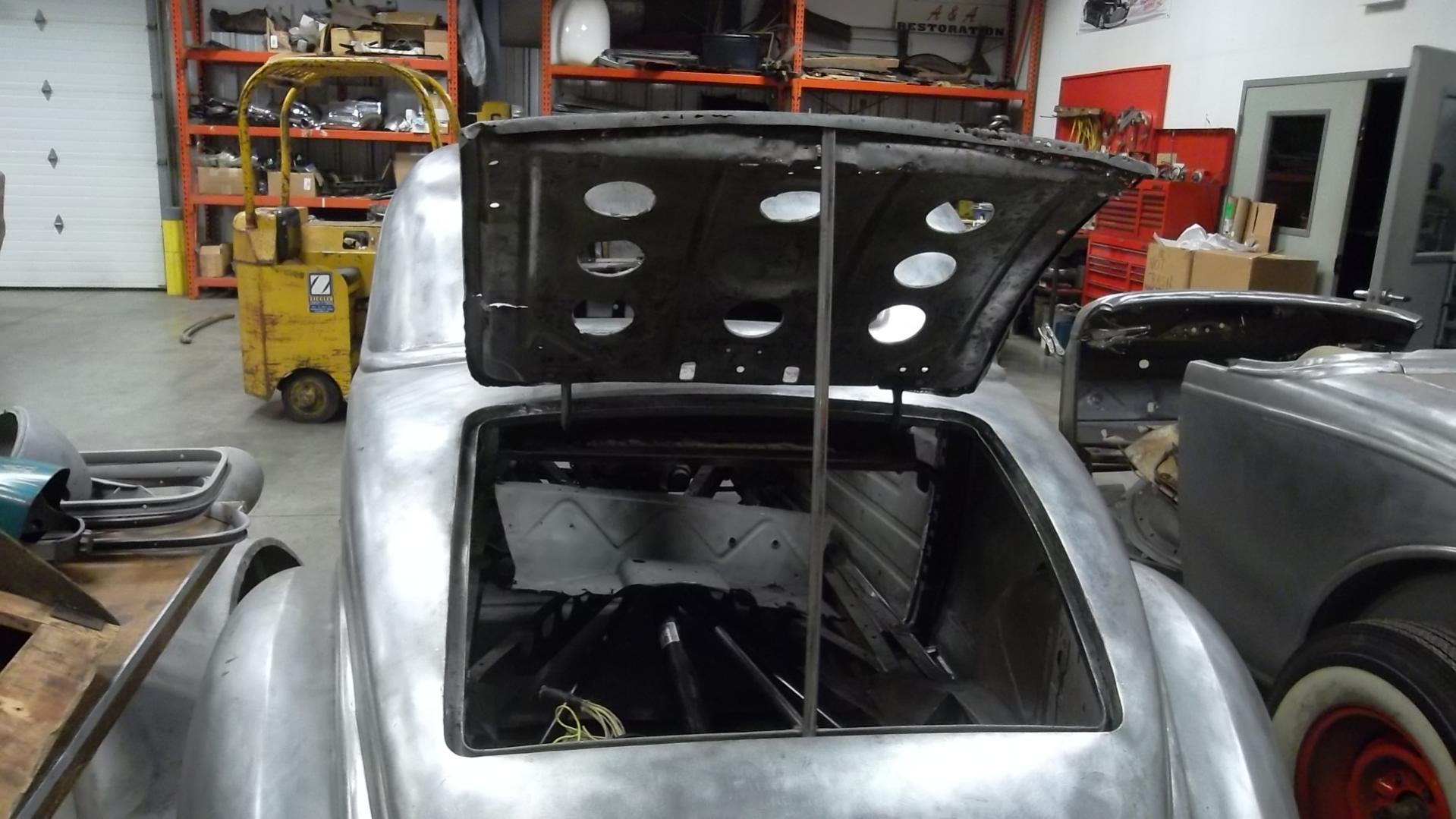

    Started on the trunk lid tonight. Got the hinges straightened out and bolted to the inner. I will start on the inner tomorrow

    No I didnt work much longer. The hinge point isnt attached to the gutter yet its just sitting there

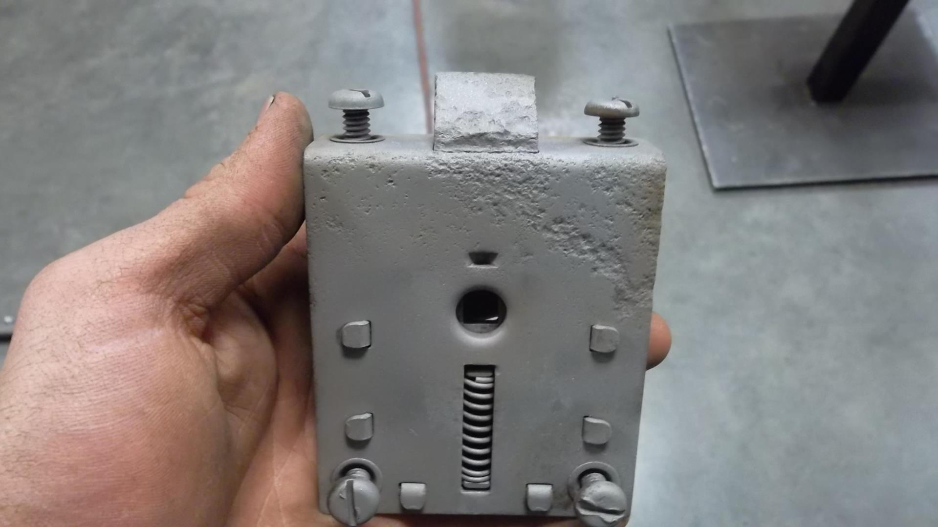

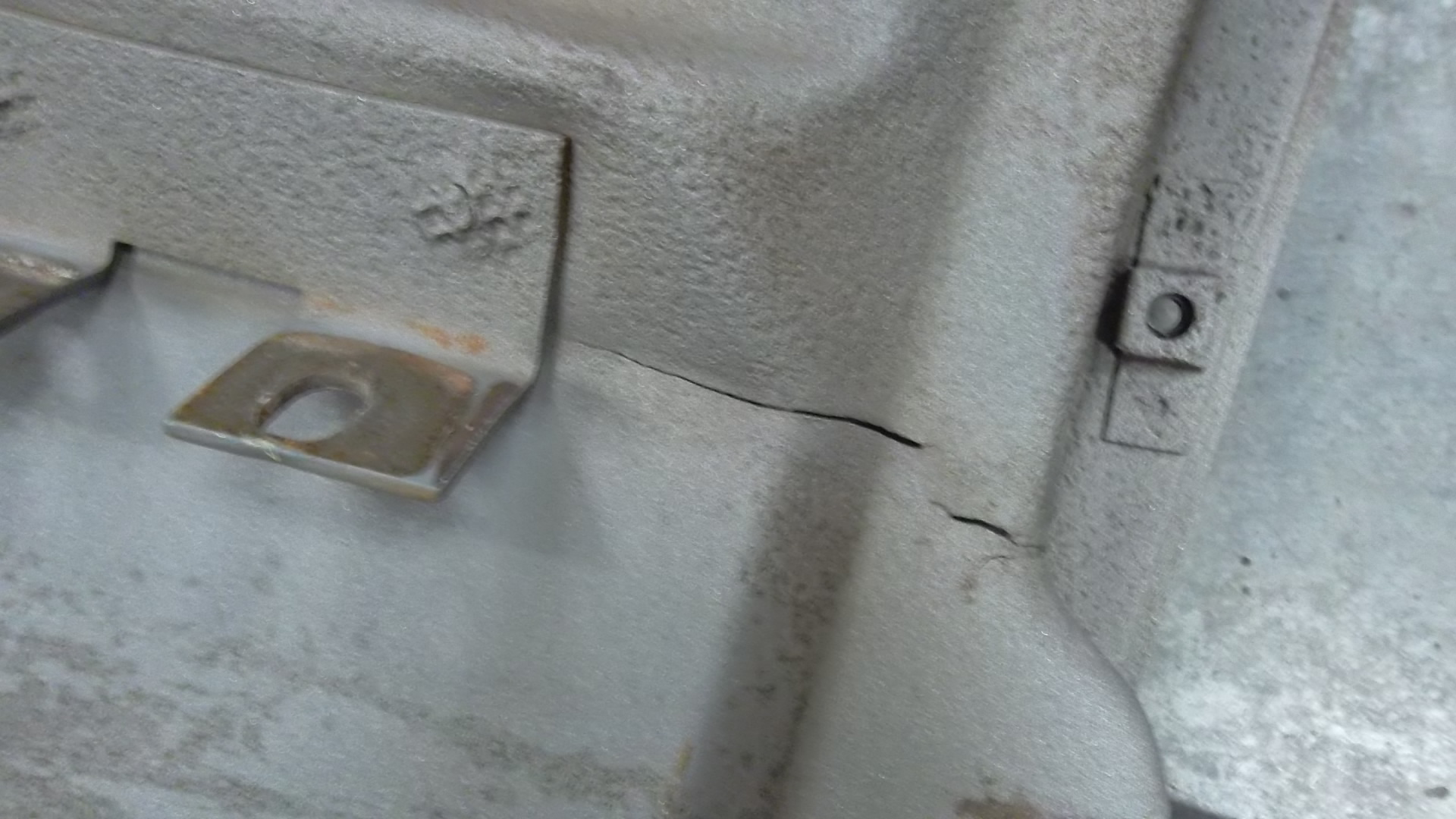

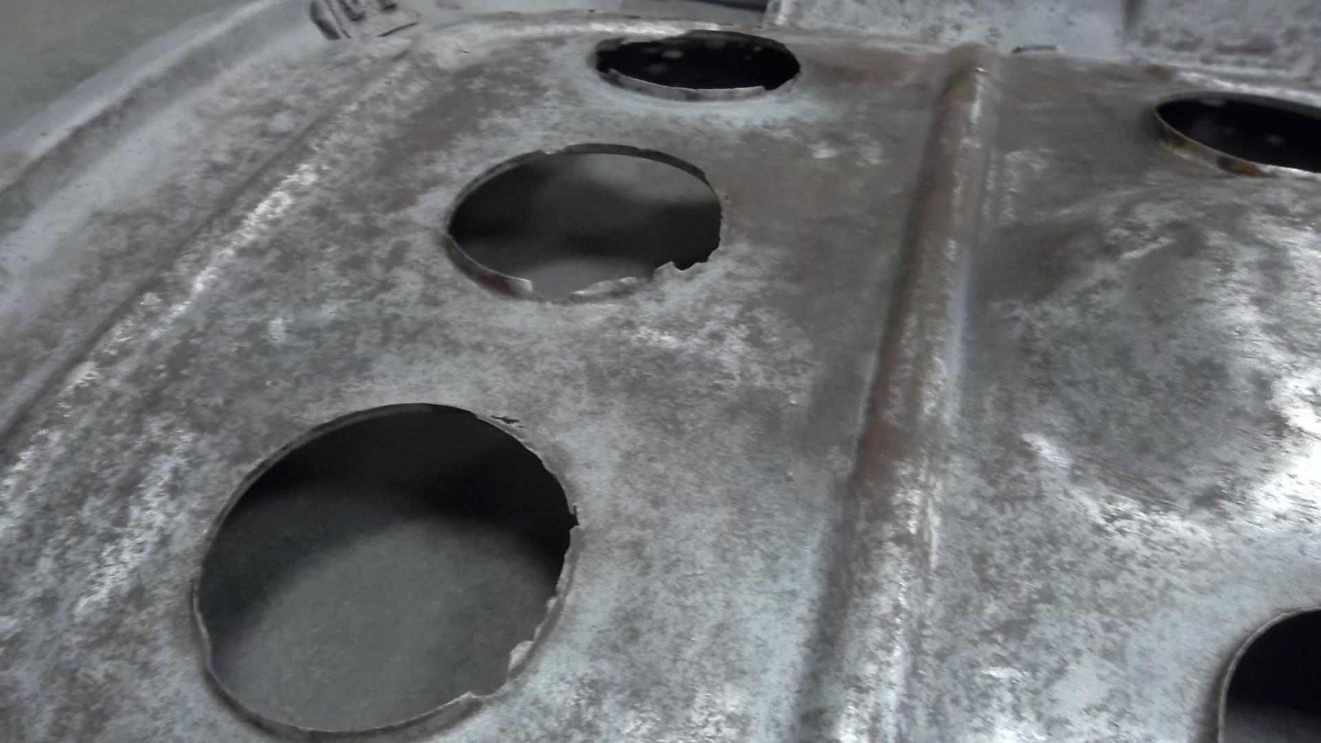

    I got the trunk hinges mounted to the body. I rebuilt the trunk latch. I made a new surround for the decklid inner and got it tacked on. I also did a bunch of straightenin on the inner and repaired the cracks

    nice! what gauge material di you use for the driprails in the trunk?
