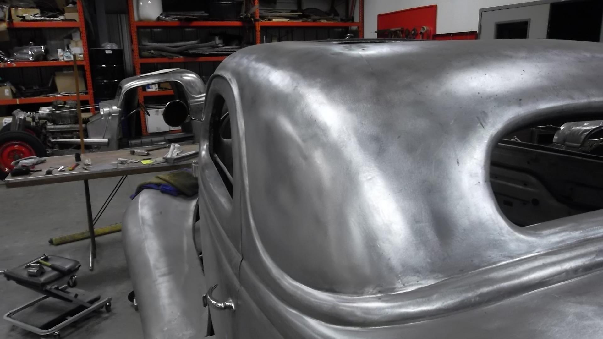

    Both repair look good....Jim
  2. Fomocokid
    Joined: Aug 1, 2009
    Posts: 573
    Fomocokid
    from Rapid City
    I used 18 gauge

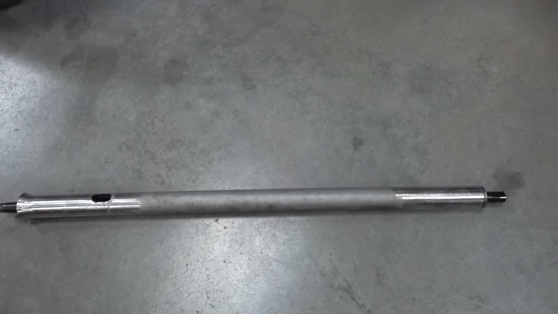

  3. Fomocokid
    Joined: Aug 1, 2009
    Posts: 573
    Fomocokid
    from Rapid City

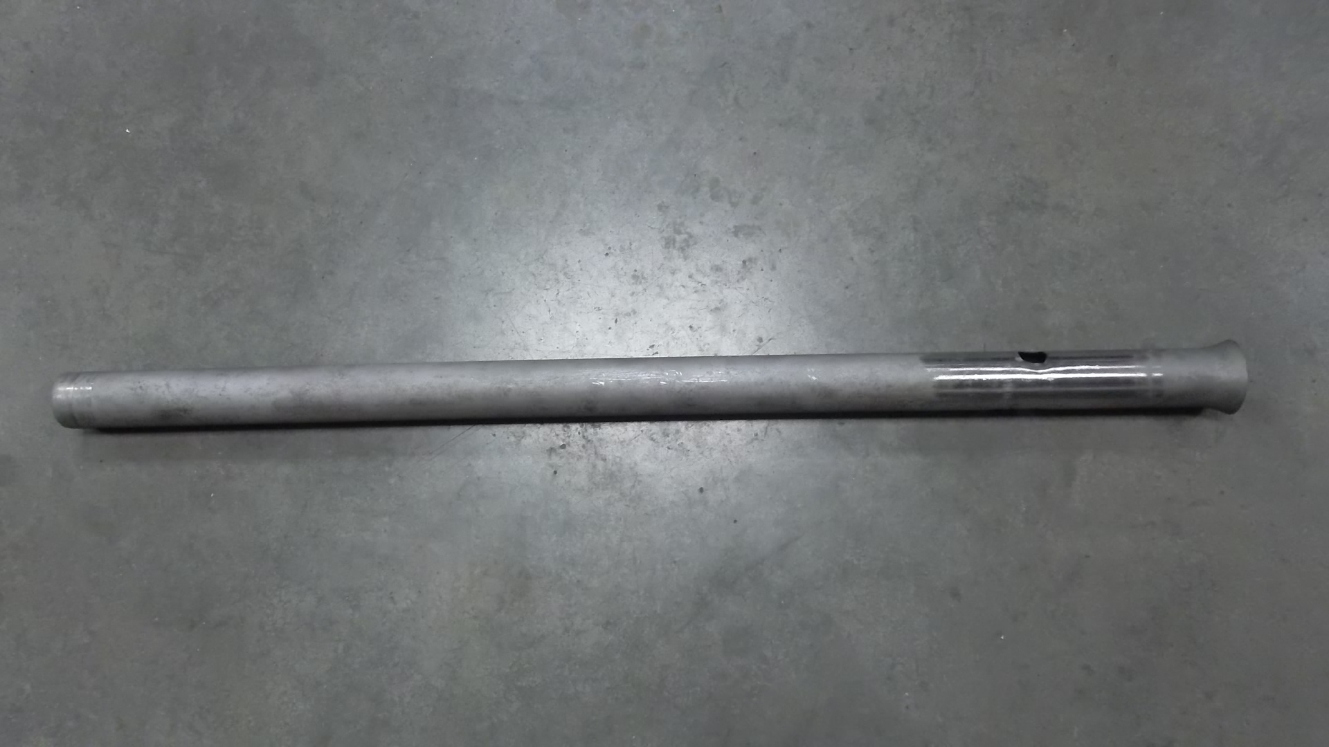

    I shortened the steering column tube between the steering wheel and the column drop. This put the steering wheel where I think it should be

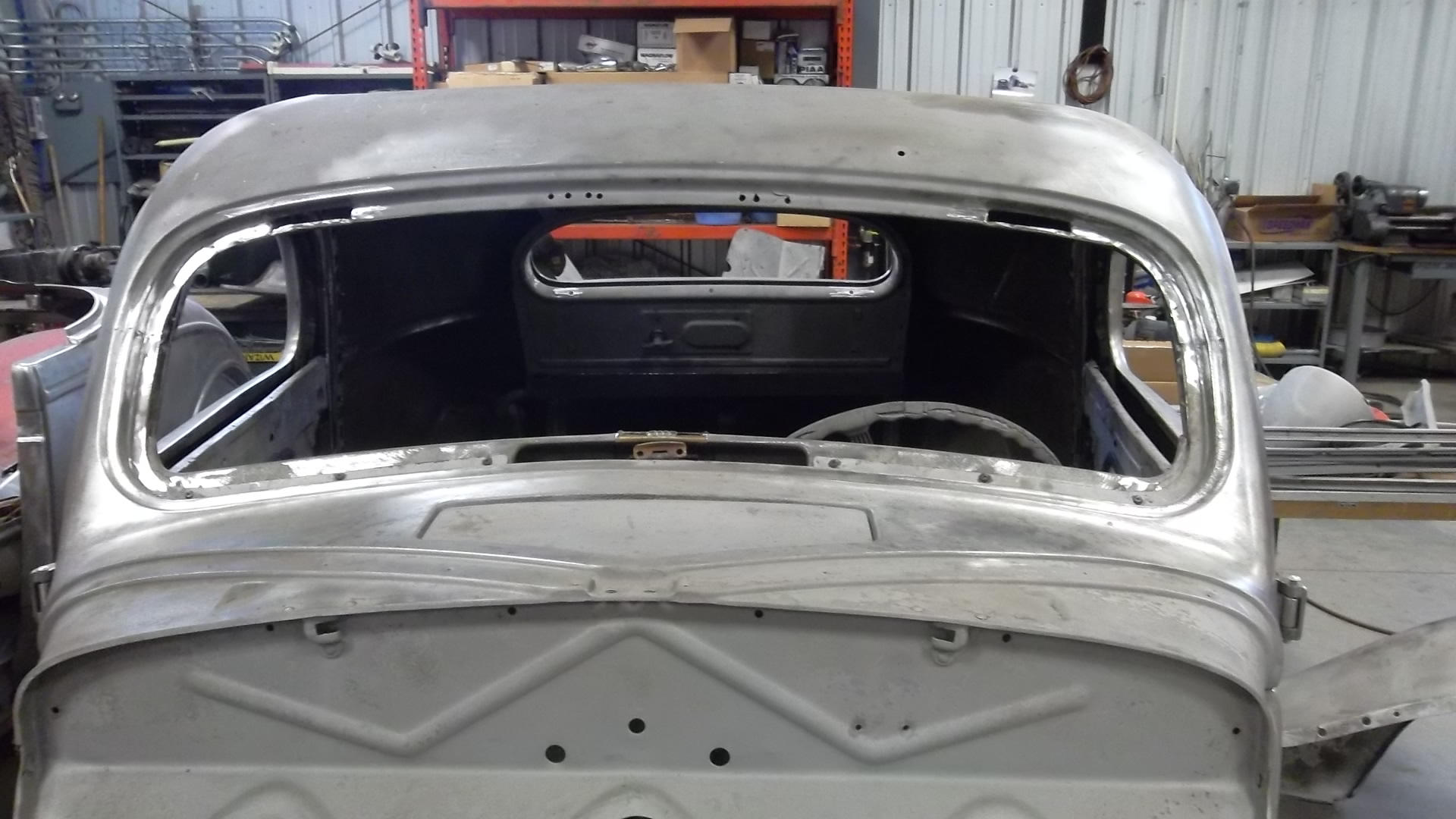

    I worked on the steering column a little more yesturday. This is what it will look like. I just have to finish the guts of it now

    Looks cool, will look better with floors and a seat!!!!:)

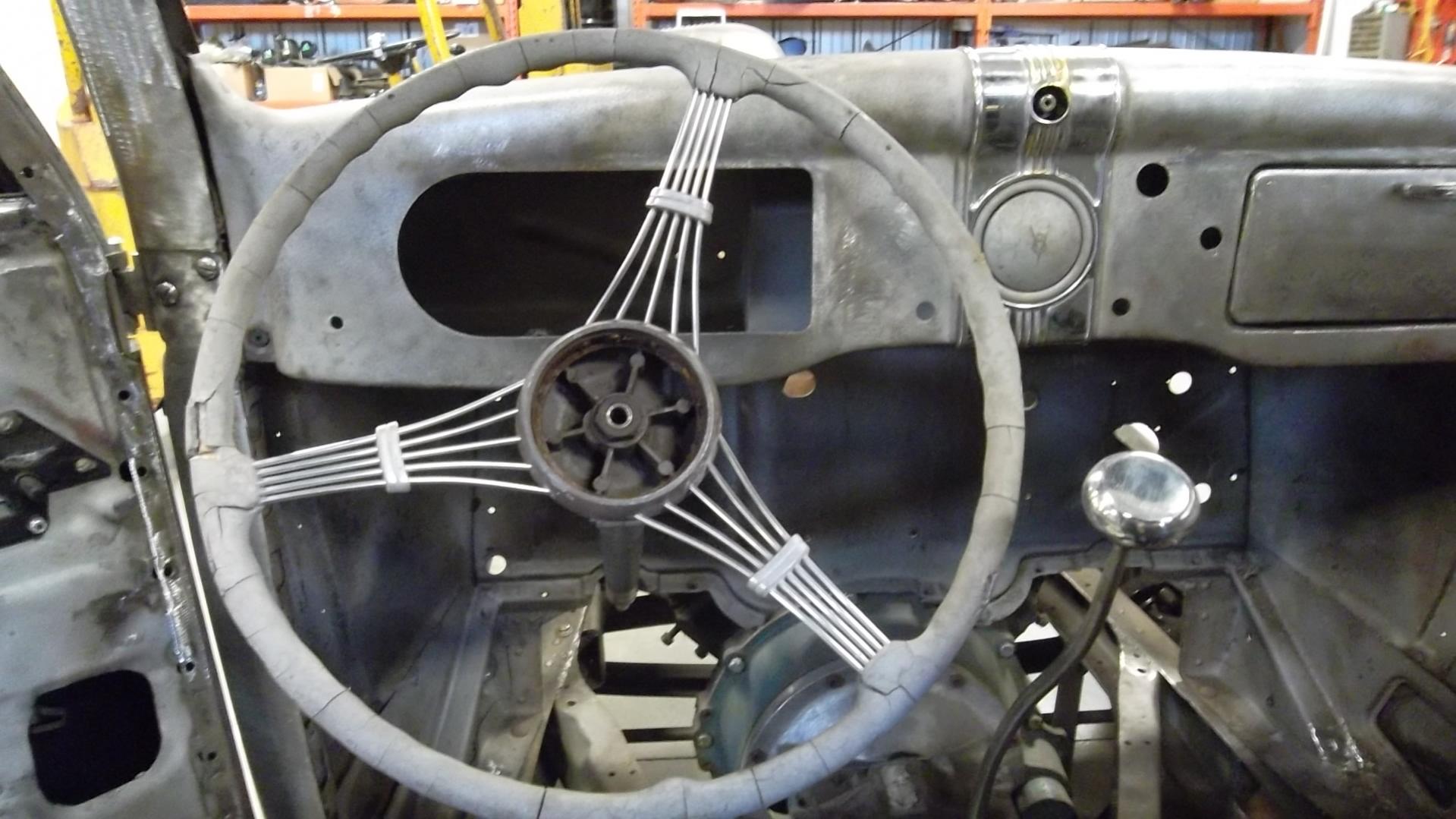

  7. oldman2
    Joined: Sep 9, 2010
    Posts: 2,373
    oldman2
    Steering wheel looks good, are you going to epoxy repair the wheel, or have someone else repair??...Jim
  8. Fomocokid
    Joined: Aug 1, 2009
    Posts: 573
    Fomocokid
    from Rapid City
    I plan on trying to fix it myself. There is very few things on this car that I will let other people do

  10. rusty rocket
    Joined: Oct 30, 2011
    Posts: 5,397
    rusty rocket
    Kellan, your not obsessive- compulsive are you? Just kiddin I love to do as much as I can myself, but I know my limits. You make me jealous kid.
  11. Fomocokid
    Joined: Aug 1, 2009
    Posts: 573
    Fomocokid
    from Rapid City

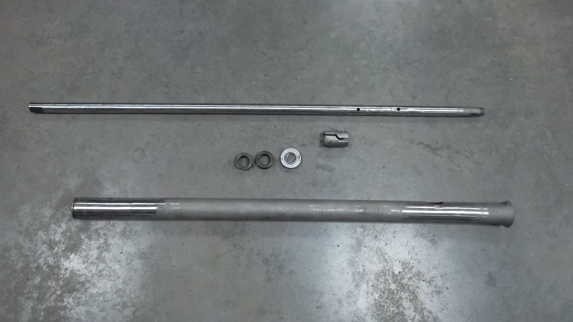

    I finished the steering column tonight. I put a bearing in both ends of it. i took my steering box apart and cleaned it up.
    mgtstumpy likes this.
  12. oldman2
    Joined: Sep 9, 2010
    Posts: 2,373
    oldman2
    Did column originally come with bearings or bushings?....Jim
  13. Fomocokid
    Joined: Aug 1, 2009
    Posts: 573
    Fomocokid
    from Rapid City
    It had a bushing up at the top and the bottom went straight into the steering box so it had a bearing in there

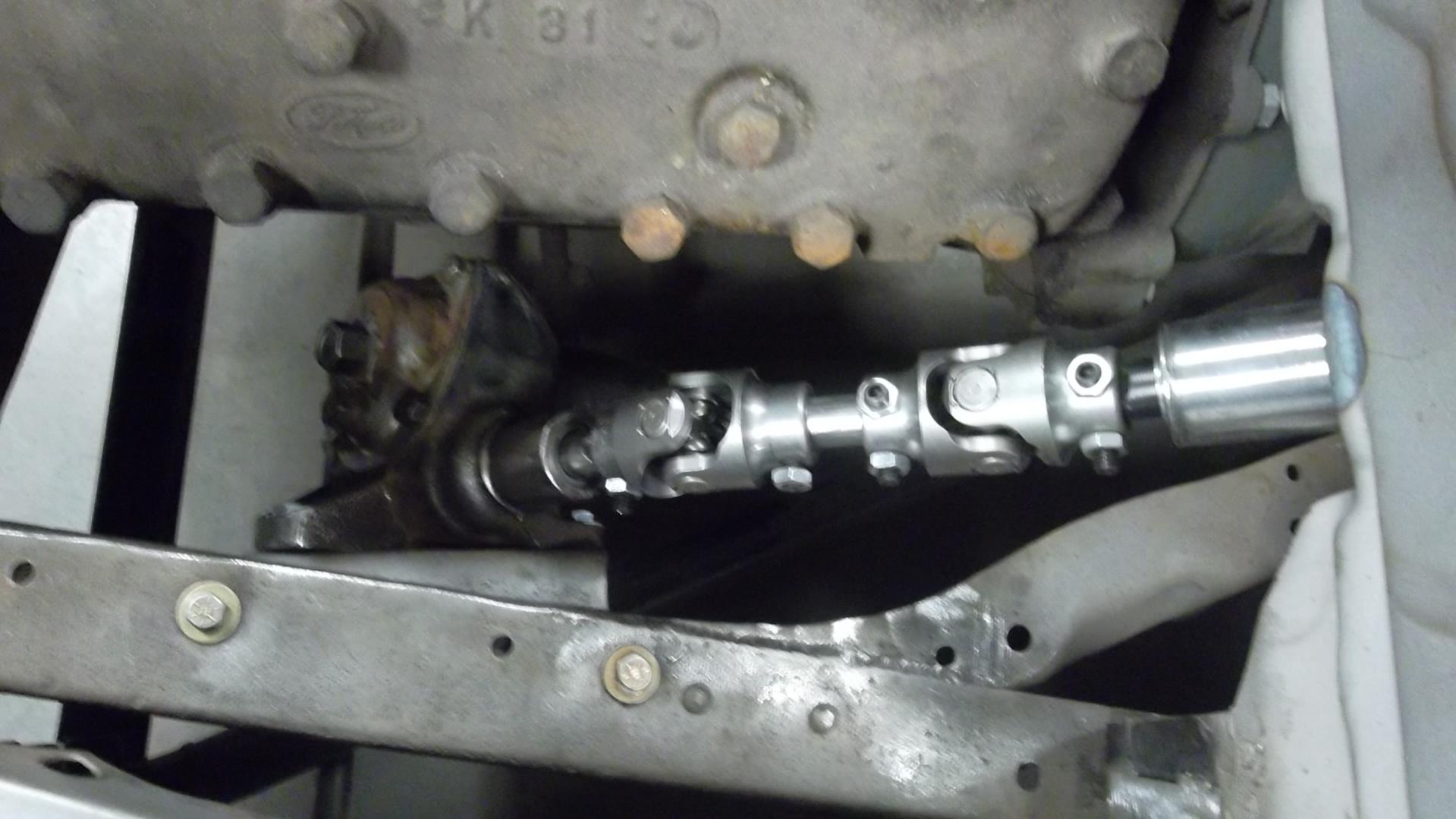

    I ***embled the box last night and put it in the car. I did smooth the casting out a little but I didnt go over board.

    Did you weld the D shaft on or mill them? I know how you felt about Grandpa, nice touch.

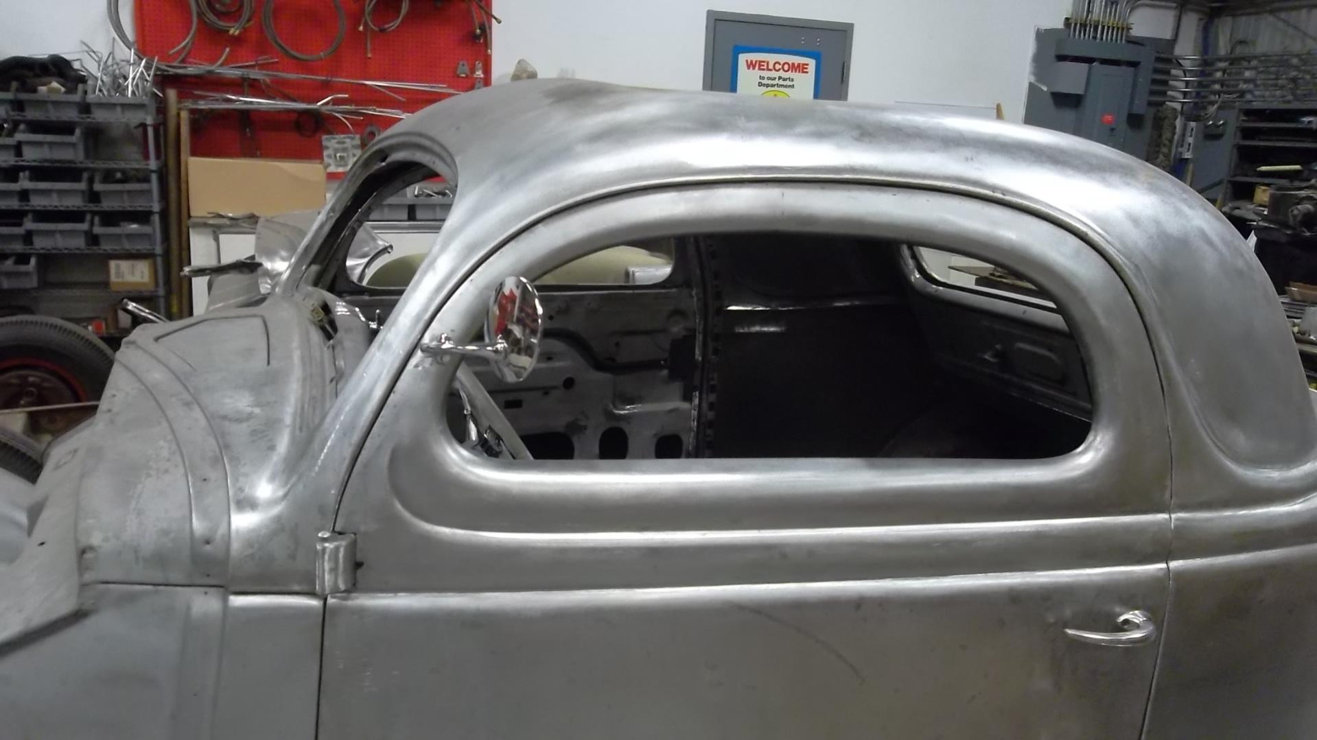

    When you said "gap the top of the door" What are you doing to get the gap so nice compaired to where it was after the chop?

    I welded them on. Used the lathe to keep it straight
    I weld on the edge to build it up. where it is a big gap I weld some 1/8 inch stap on. As you tack it you can pull it around the curve. Then I grind it till I get the gap I want. It's a very time consuming process

    I finished filling the cracks on the steering wheel. I mounted my mirror. I also had to come up with a way to mount the center of the steering wheel, but I figured it out.
