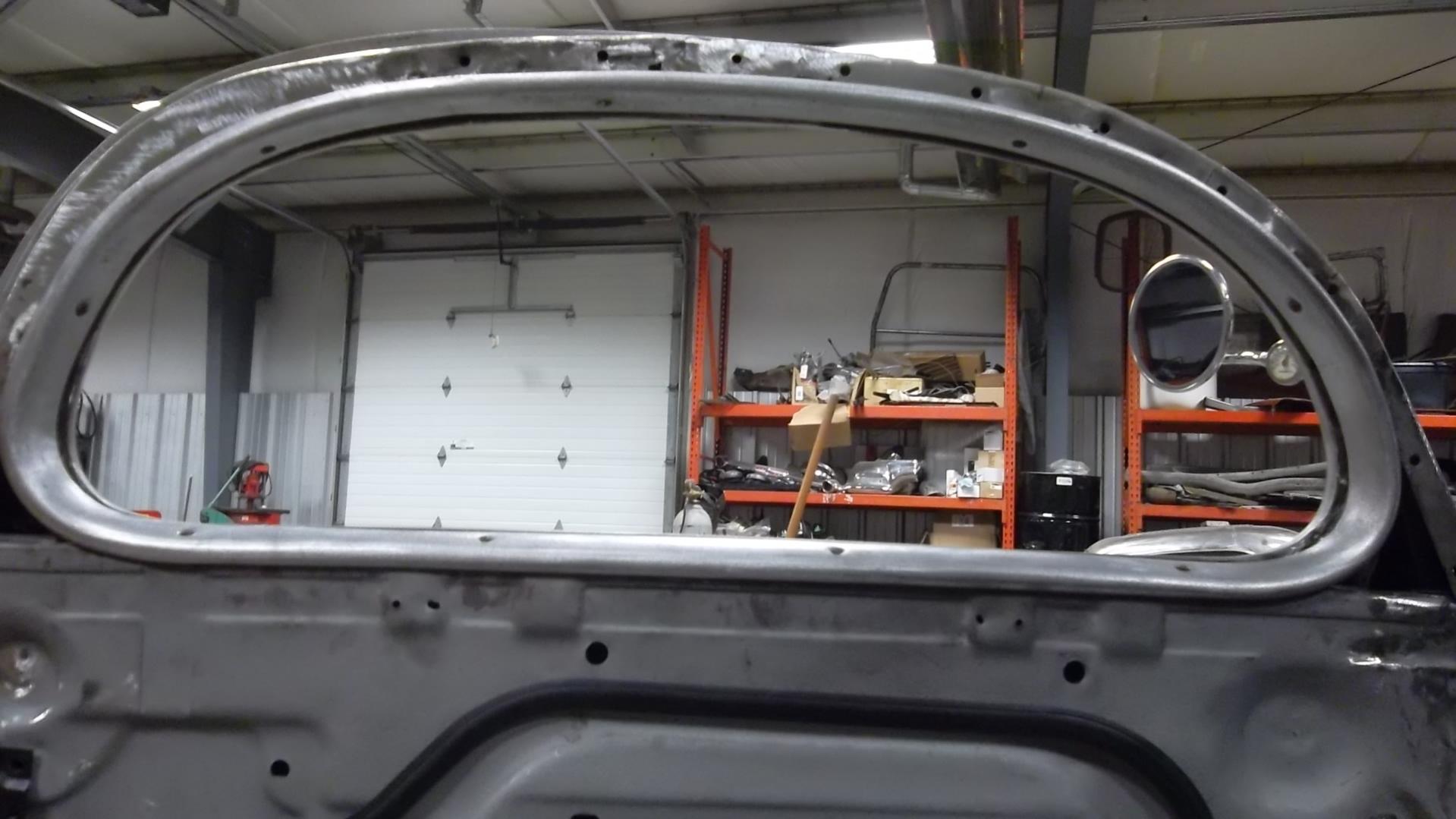

    I decided to make my garnish moldings out of some 2-door and 4-door sedan moldings. This way I can sell the original 3 window moldings for some more fundage. I got the driver's side done today

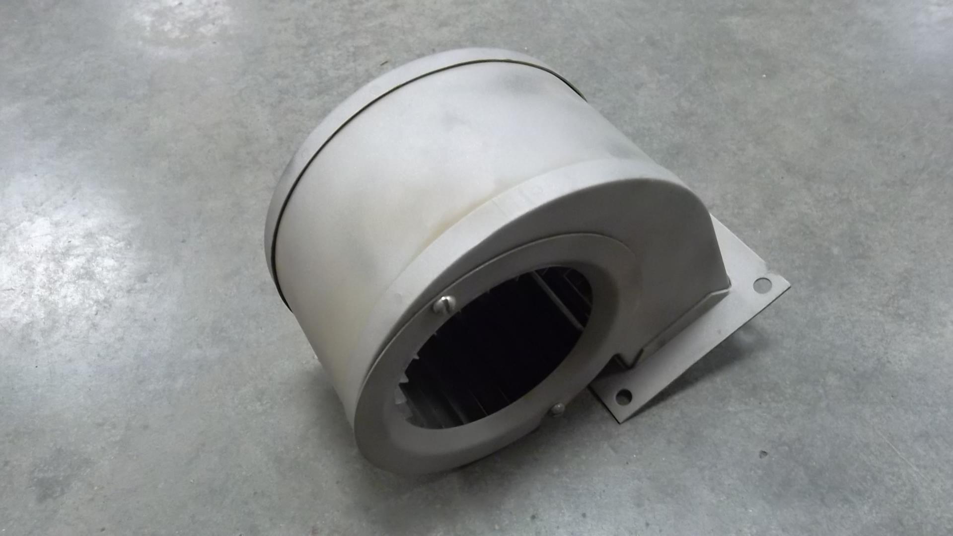

    I got my steering wheel back with some primer and guide coat on it. I got a squirrel cage for free. I knocked it apart because I wanted the motor to mount on the opposite side. I welded it back together with a corner weld instead of there being an overlap. I then made an adapter to mount it to the heater

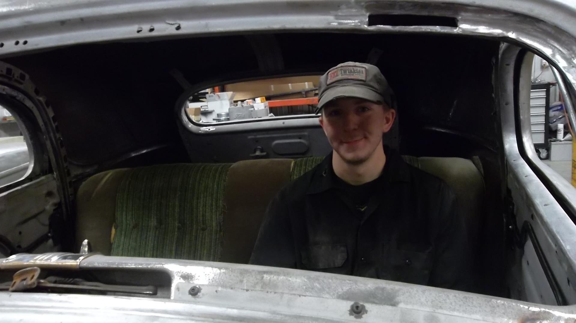

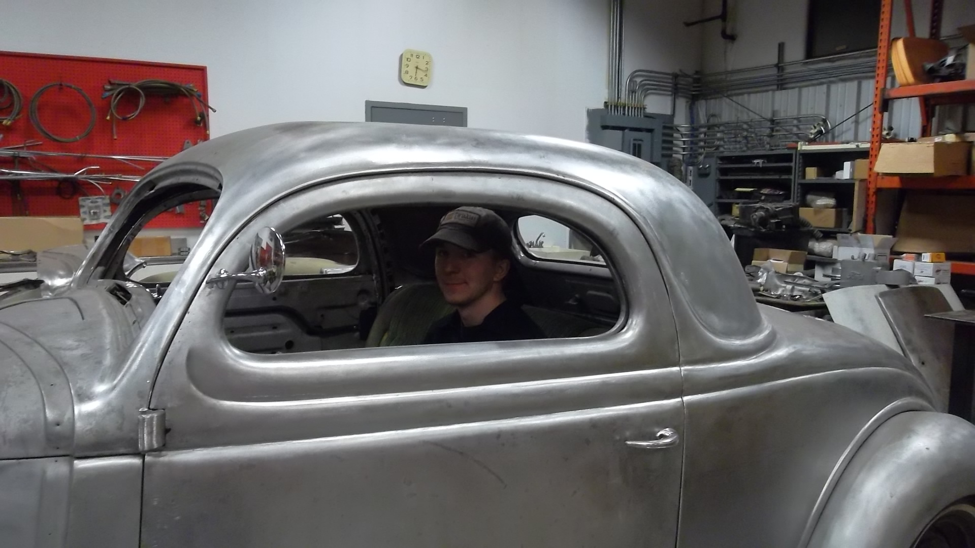

    My parents brought my seat down last night so I finally got to sit in my car!

  11. oldman2
    Joined: Sep 9, 2010
    Posts: 2,373
    oldman2
    Did you make any engine sounds, or just sit there smilin'......Jim

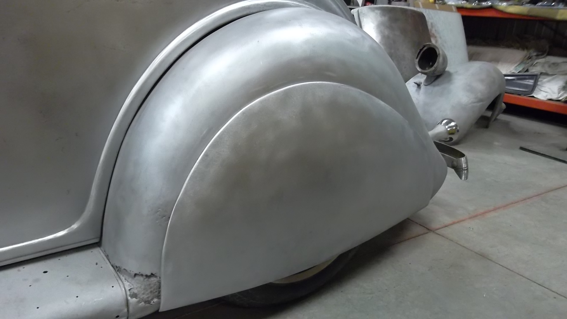

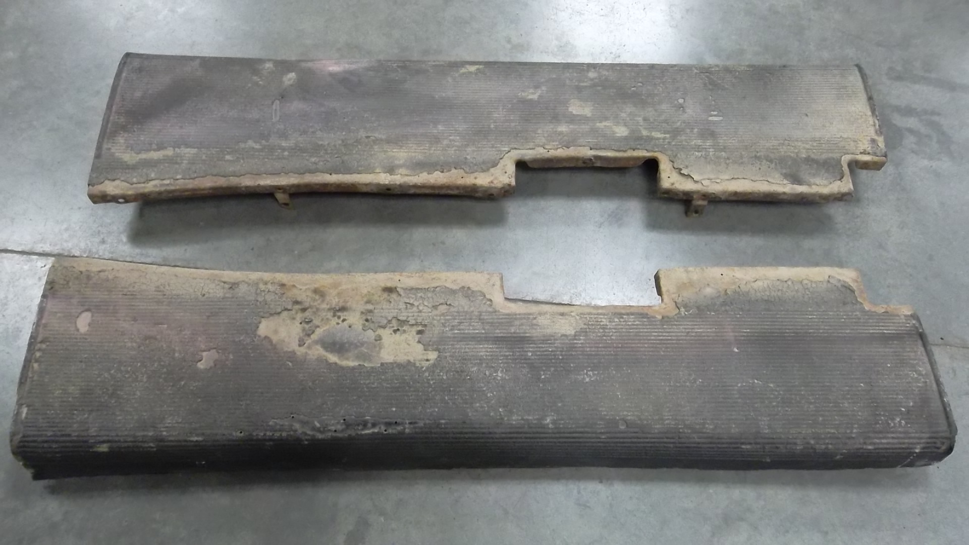

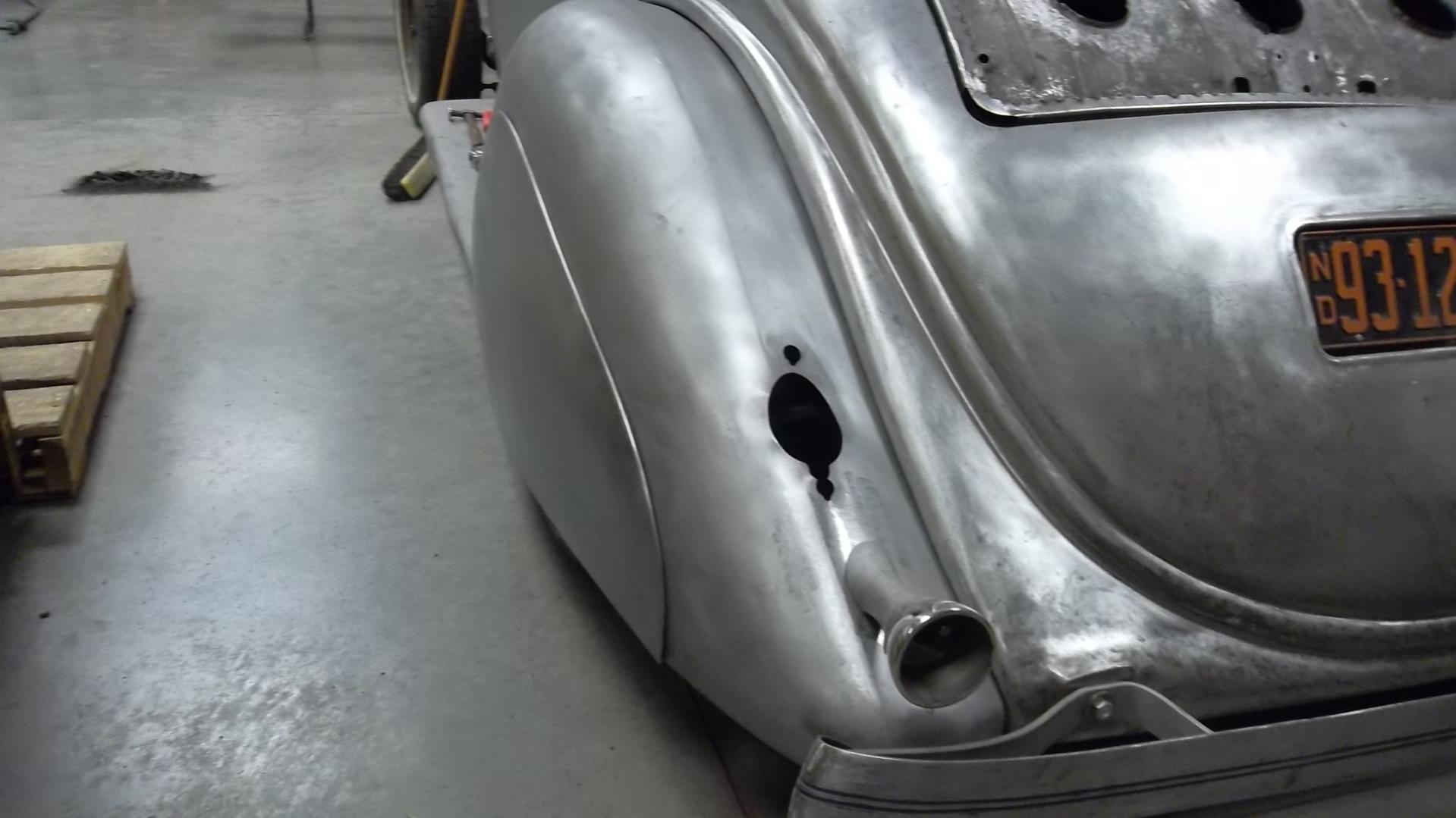

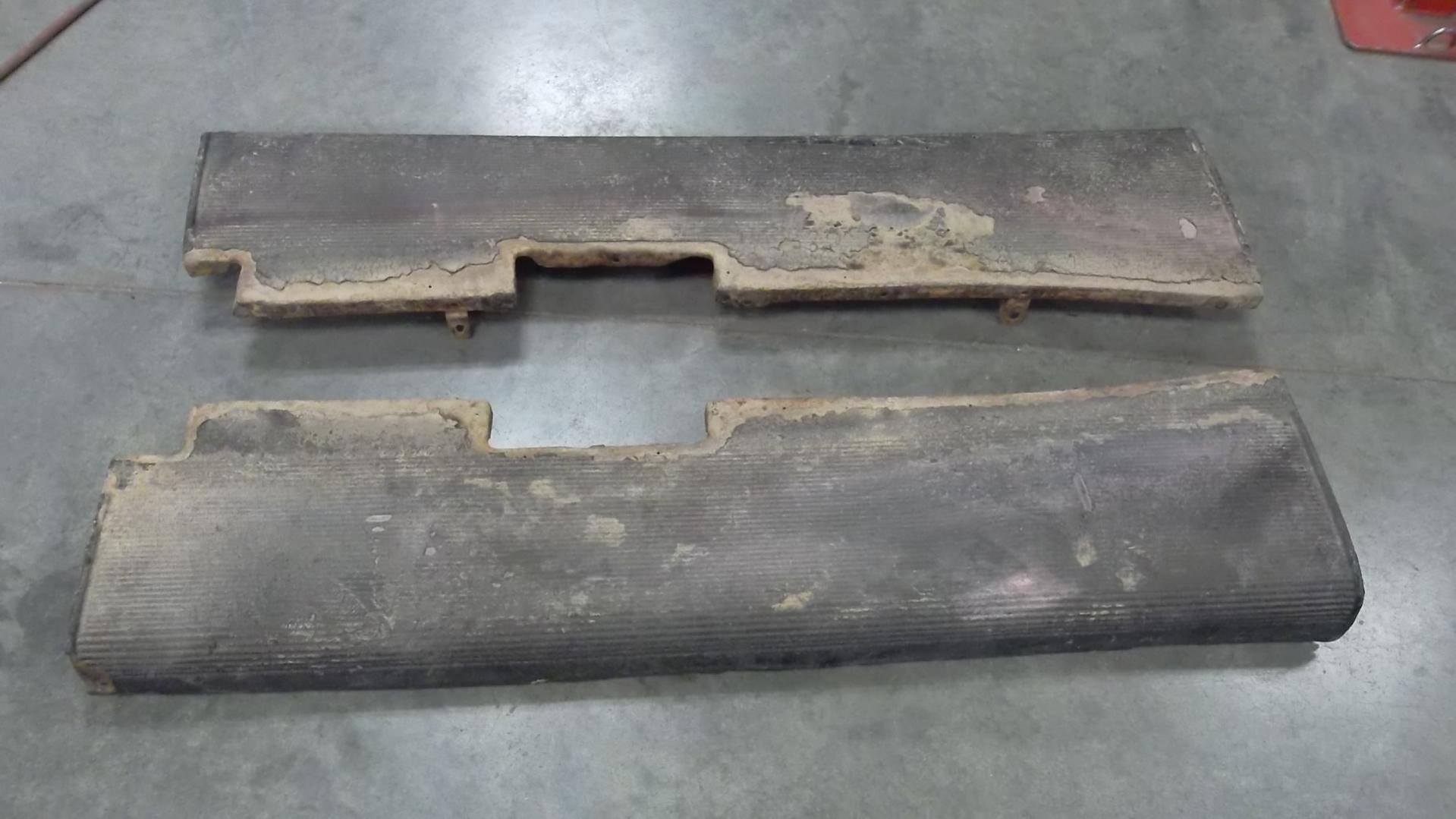

    Well heres what Ive been up to. I cleaned the primer off of the drivers fenderskirt. I then made the bottom mounts for it. This side wasnt as far off as the other side. I made the piece to re-radius it and welded it in. I still have to work the weld, sorry no pics of this yet. I traded some spare parts for a better set of running boards. I also bought my tires. Coker cl***ic radials. 6.00 16 for the front and 6.50 16 for the rear. I am going to have the wheels powder coated soon. I will be running 16X4 front and 16X5 for the rear.

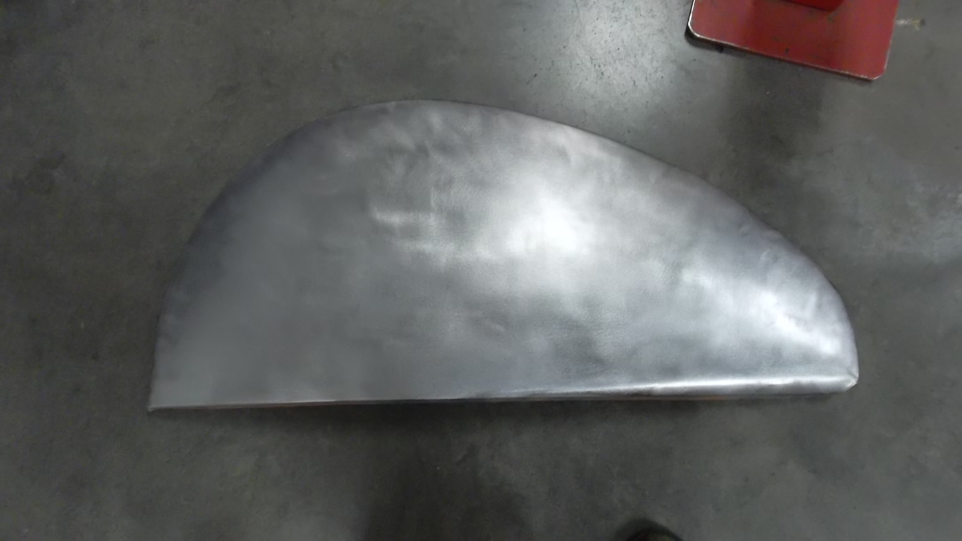

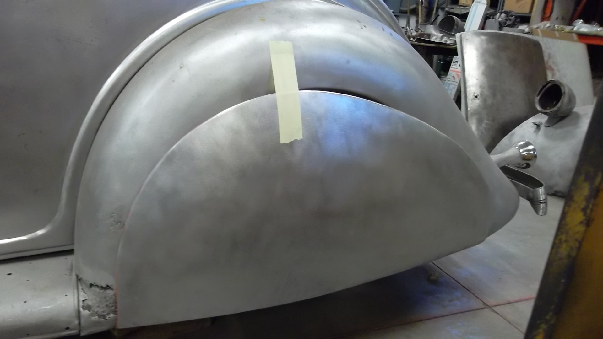

    Finally got some time and finished the skirt and the mounts for it

    Skirts look good and fit great....Jim
