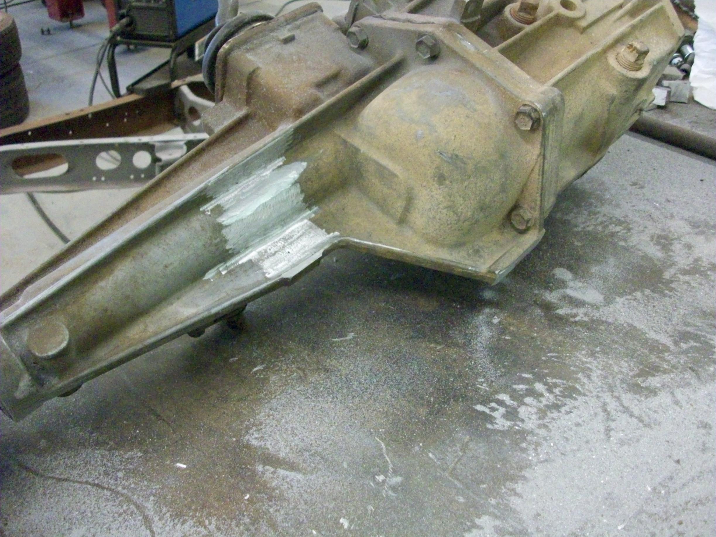

    I put my front end together today. I had to take my spindles to work so that I could ream the bushings. It all went together fairly well and I am happy with it.

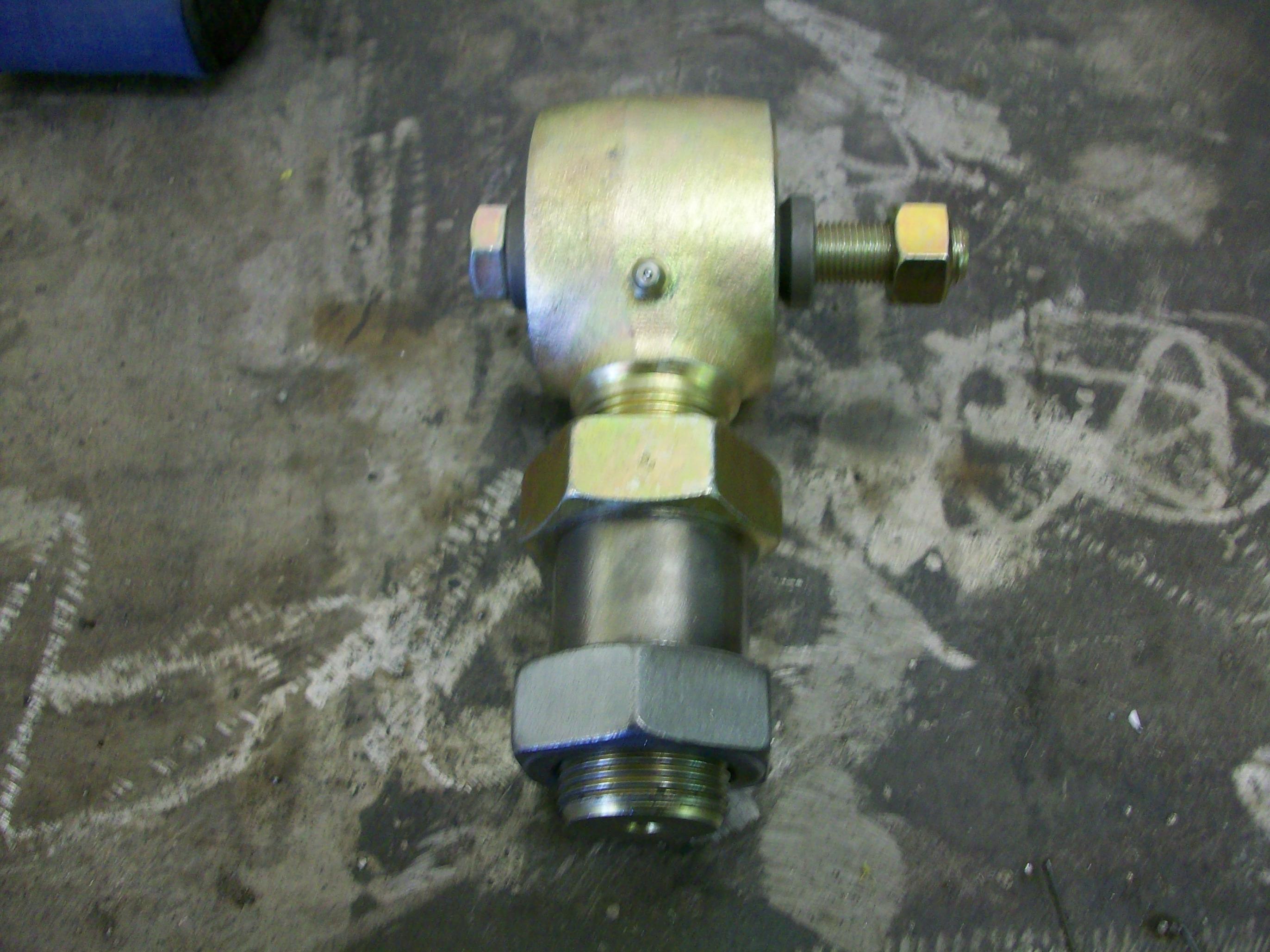

    Today I worked on the mount for my johnny joint. I started with one of the nuts and welded a piece of pipe onto it. I then made a washer with a hole saw. I then got a piece of pipe that fit over the nut and welded the washer to it. Next I welded the nut with the pipe to the frame. I then welded the larger pipe over the top. I have to thank my teacher for helping me with ideas. I think it turned out good.

    Your johnny joint turned out great. It even looks better in person...

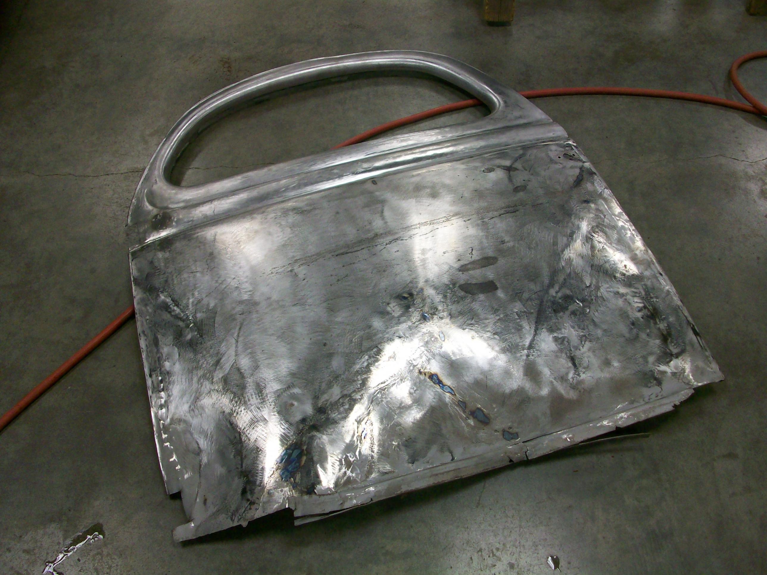

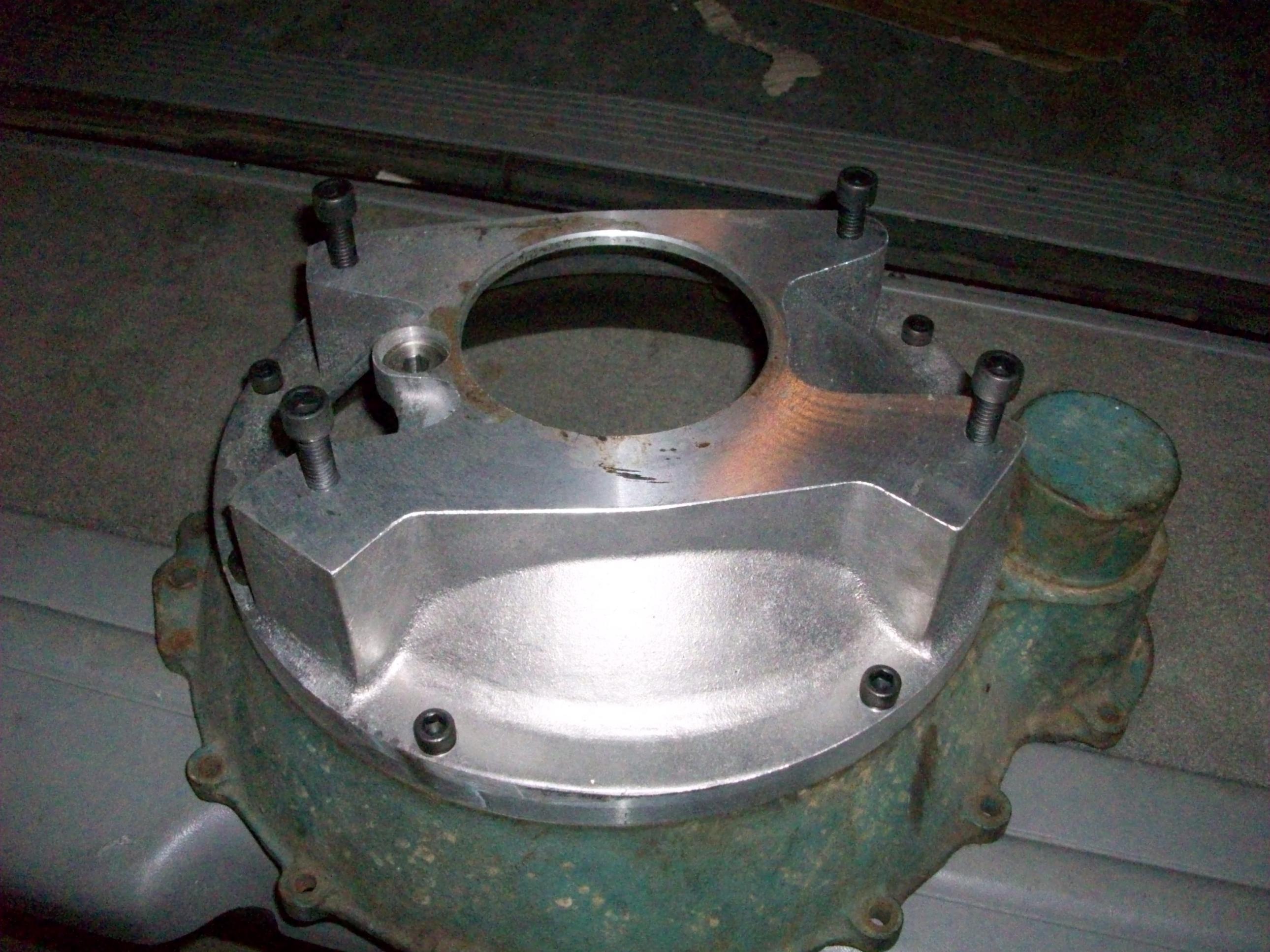

    Last monday I finished making the top of the rear wishbone brackets and then I tacked them on. I have been working on the drivers side door every once in awhile after work. it is starting to look better. Over Thanksgiving I took my transmission adapter out of my pickup. So now I can put the engine and trans in and then set my pinion angle before welding everything up.

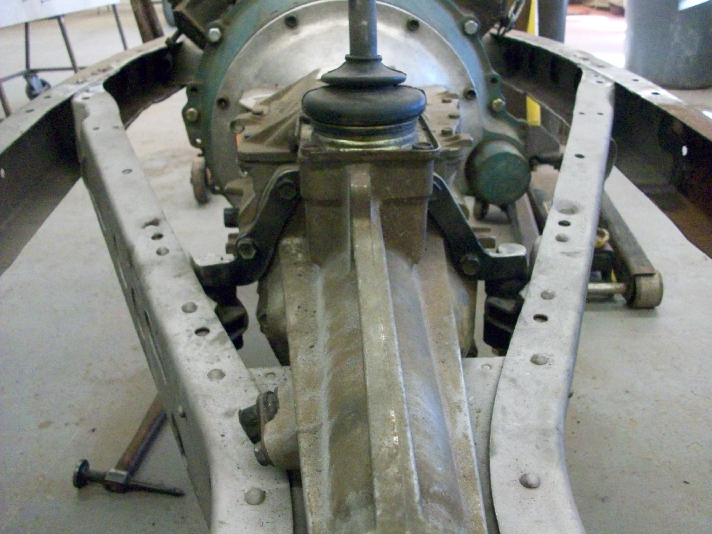

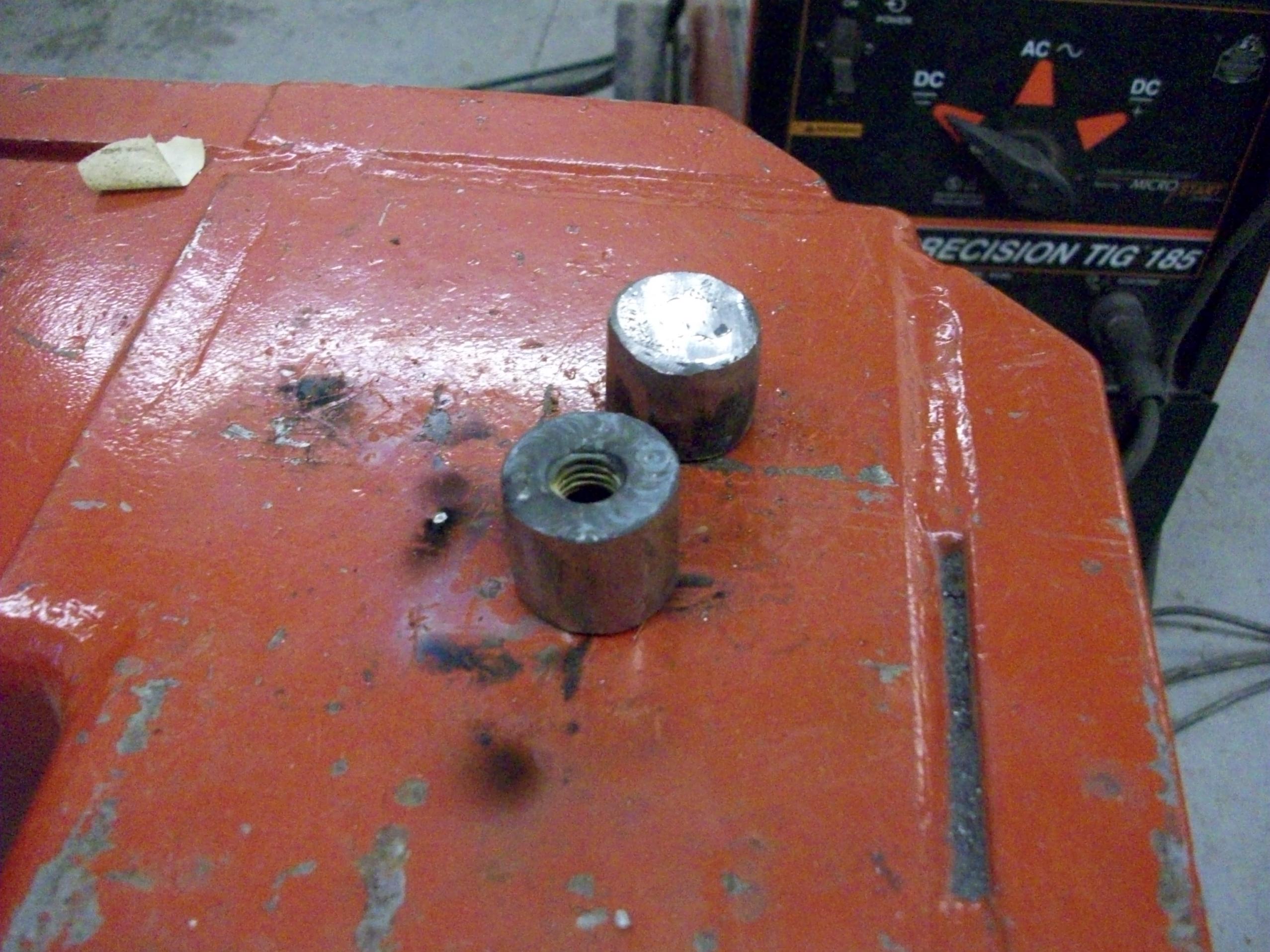

    I cut the mount off of the transmission and smoothed it out. I made 2 bungs out of some tube and some nuts. I bolted the bungs to the original trans mounts on the frame and then I made some brackets that bolt to the tailshaft. I then welded the brackets to the bungs. The mount is isolated on top and bottom of the bolt with 1" thick rubber. I also got started on the panhard bar, I just have to finish welding up the bracket.

    Nice work on the trans mount and the axle, Fomocokid.
    The 39 bones are not strong enough on their own to locate the rear axle. Will you be adding some sort of triangulation or torque rod to help??

    The rear mount looks good, but that drivers door still looks like ****. If I remember you were doing the inner structure and than going to reskin the outside, and of course you have new bottom patch panels

    They are '35 bones and yes I plan on adding a third link, but I'm not sure how I want to do it yet.
