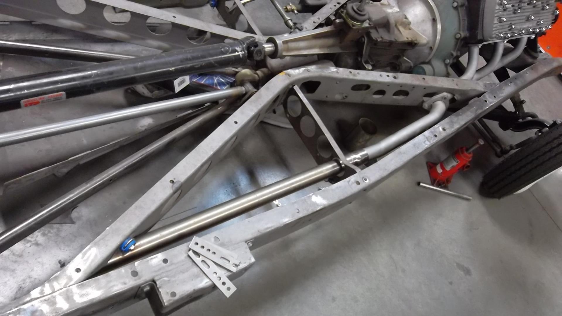

    Friday I decided to pull the car all apart so that I could step the back of the frame for more suspension travel. I borrowed a friend's frame bench. Saturday morning I put the frame up on the bench. I made a pattern of what I wanted the frame to do. I then used 4X2 tubing and made all the pieces. I made some backing plates to go in the corners for extra support. I plug welded the plates into the tubing and proceded to weld the tubing together. I then cut the frame rails and fit the new rails and tacked them into place. I welded it all up and then welded the steering box mount in. I then took the frame off the bench and put the suspension and engine back in.

    Wow, that was a lot of work, it looks great, and I'm sure you will enjoy the extra clearance in the rear axle area...Jim

    Wont be any lower than before just did it for clearance. Just wanna be dragging *** without banging ***.

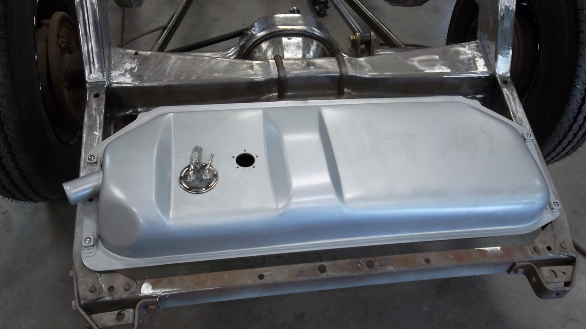

    Tonight I moved the fill neck on the gas tank from the side to the top
