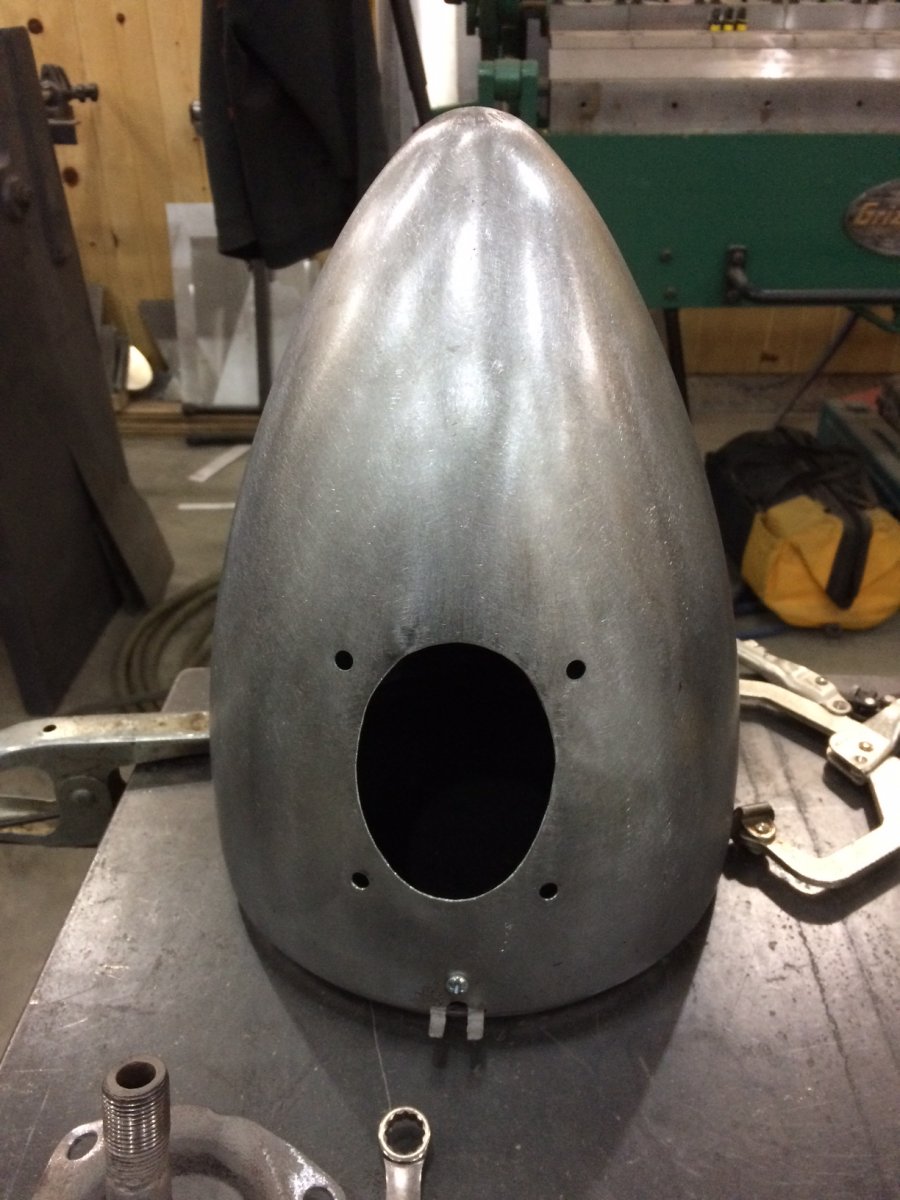

    Its been a long time since I made any progress on this car. I now have some motivation again. I found some nice Packard headlights with the trim on the top. I did not like the Packard lenses though, so I decided to combine the Ford headlights and the Packard headlights. The Ford trim ring is about 3/16" larger than the Packard bucket, so I cut the front of a Ford bucket off and blended it into the Packard bucket. I had to fab up a patch for the bottom of the Packard bucket to close up the larger mounting hole. I then installed the Ford mounting plate and stud allowing the new headlight to mount to the factory Ford stands that are already chopped. At this point I finally got the car back into the shop. It had plenty of rust on it as its been in cold storage. Stay tuned progress will be steady again. IMG_4747.JPG IMG_4820.JPG IMG_4843.JPG IMG_4844.JPG IMG_4845.JPG IMG_4846.JPG IMG_4847.JPG IMG_4903.JPG
