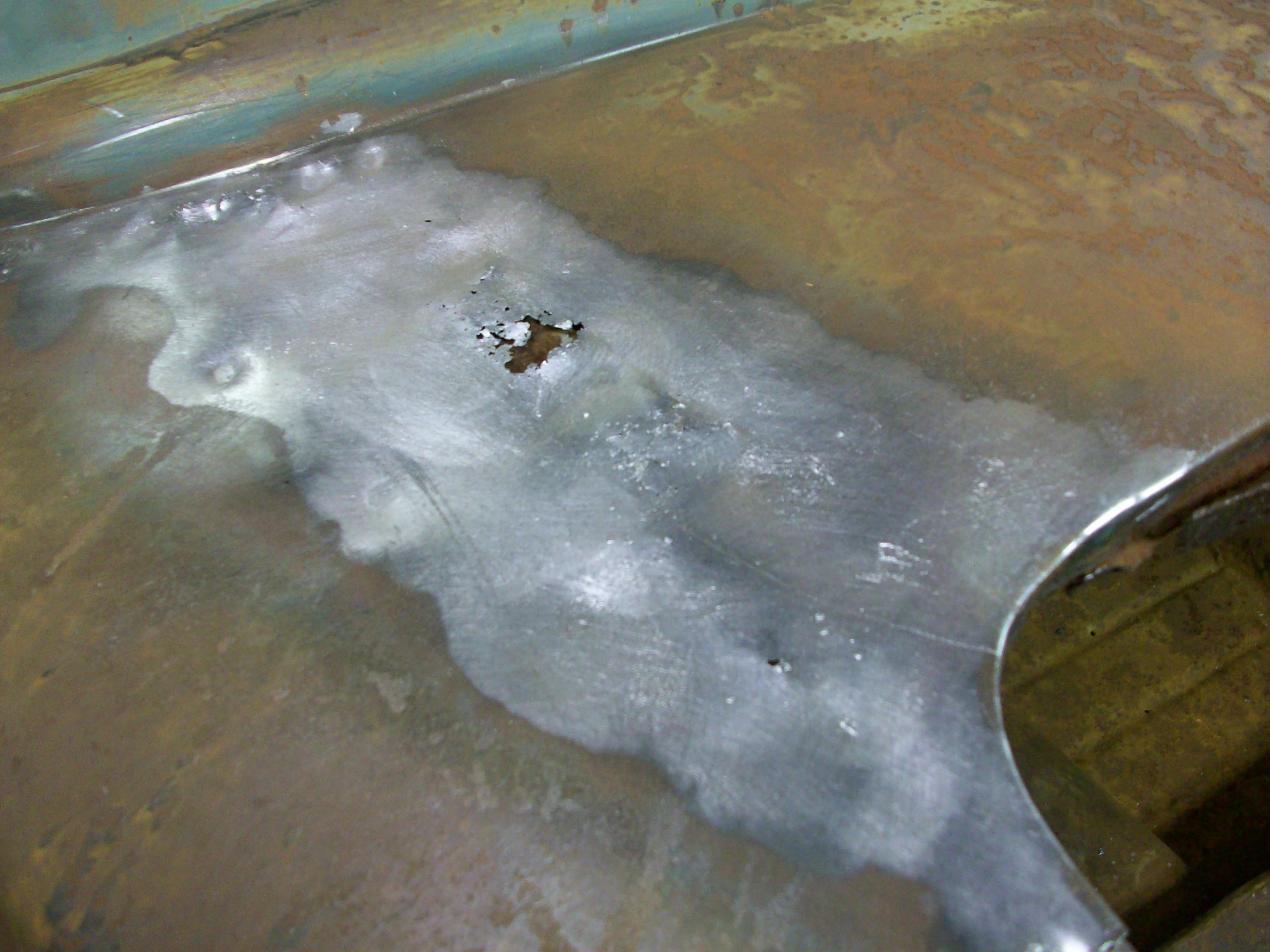

    Today I got the inner and outer of the decklid cleaned up fairly well. The skin isn't too bad it just needs a few rust holes filled and some minor dents taken out. The inner structure is a little rougher. It has a lot more rust and dents to repair. The inner stucture and the skin do fit in the trunk opening fairly well. I will have to make all new trunk gutters due to some farmer goober welds.
    mgtstumpy likes this.

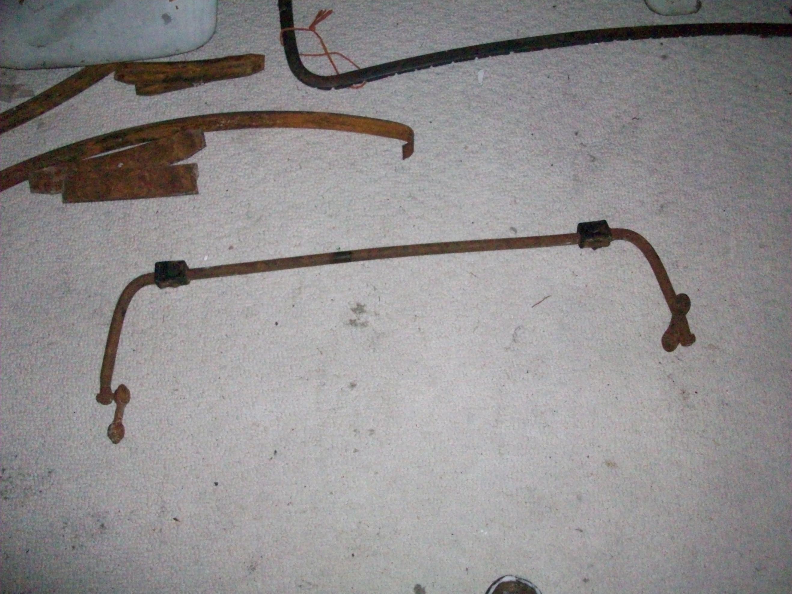

    Picked up a '40 Ford sway bar today. Jamie is finally happy now.

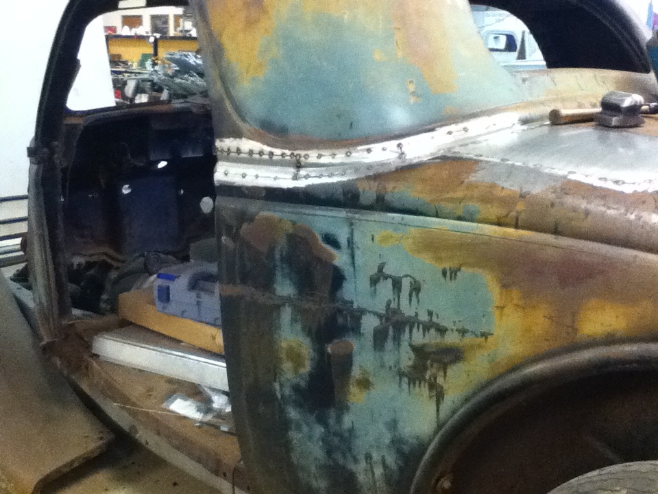

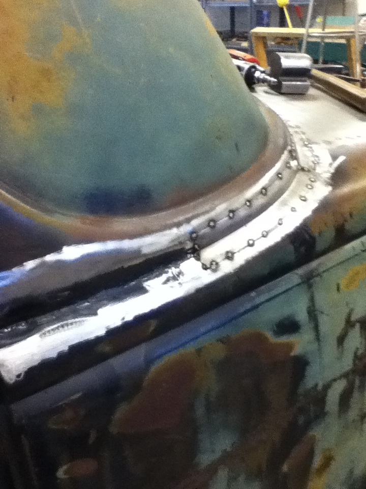

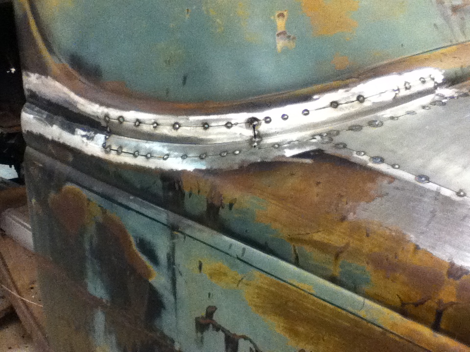

    Fomocokid
    from Rapid City
    The factory seam between the roof and the decklid opening was rusted out and there was a stress crack along the beltline on both sides. Today I started to patch those issues. I have the drivers side tacked together. I would have taken more pics but my camera died hopefully tomorrow I can get more pics.

    I got all of the pieces tacked in on the drivers side beltline and I got started on the p***enger side today.

    Very nice work on the patch panels. Once your done they will never know it had a problem.
