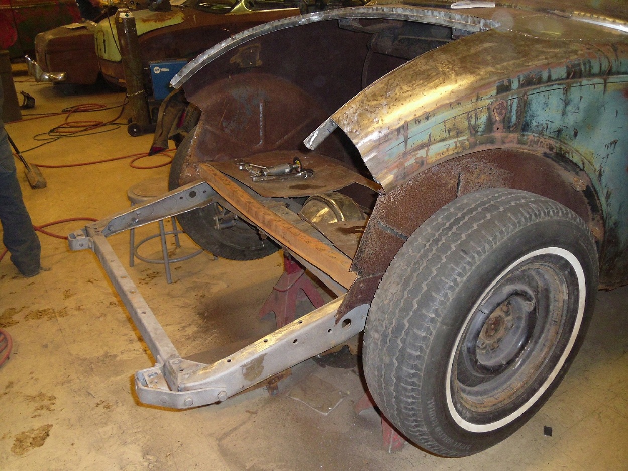

    Today I finished making the beltline pieces for the p***enger side and I got them all tacked in.

    from Rapid City
    I will be putting a whole new floor in, new rockers, quarter patch on p***enger side, cowl patches, decklid inner structure and the doors will need plenty of attention too.

    from Rapid City
    I patched the 2 bottom corners of the decklid opening where there was stress cracks. I also mad a patch for the bottom edge of the decklid opening.

    from Rapid City
    I got the panel below the trunk tacked in today.

    from Rapid City
    Today I got the trunk gutter tacked in. I'm fairly happy with it. The backend is coming along now.

    from Rapid City
    Today I cut the rear tailpan off. It will make it easier to straighten and now I can clean up the supports behind it. It will also make it easier to do a frenched in license plate. I started to clean it up some and take some of the dents out.
