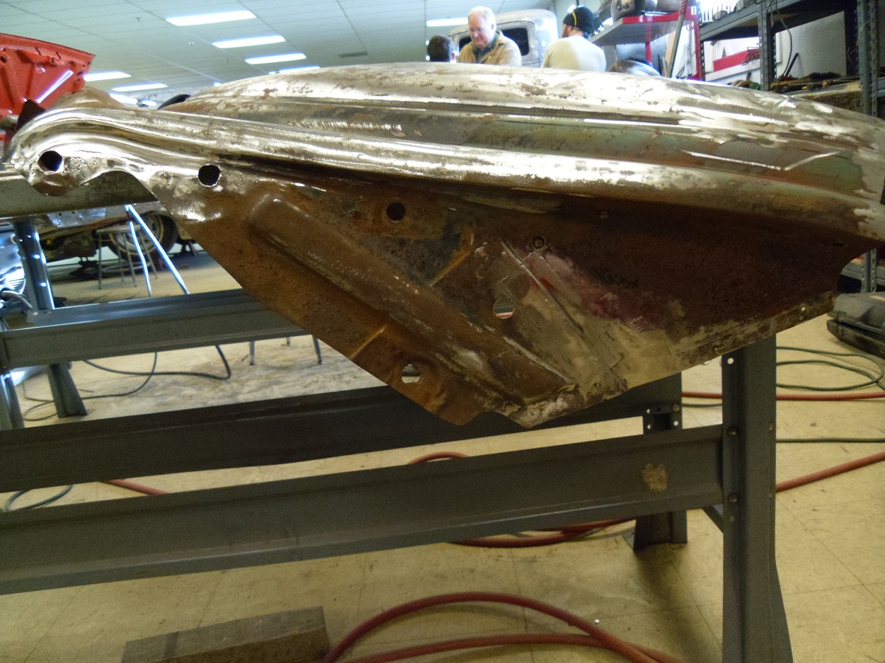

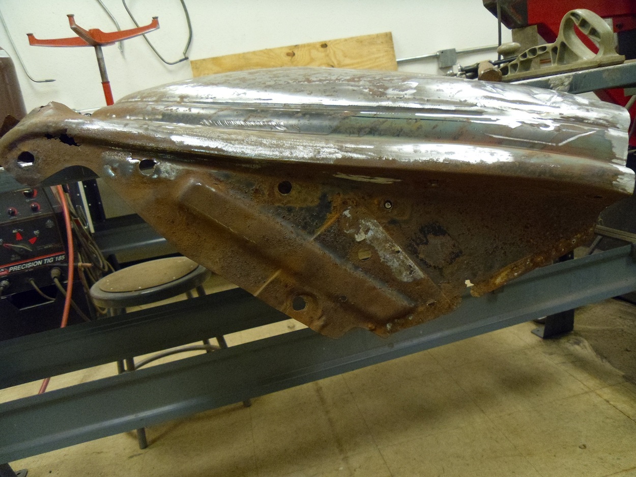

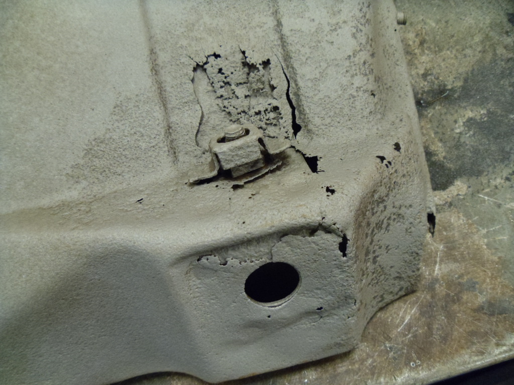

    I've been helping Curt out with the chop on his model A off and on the past couple of days so my progress has been slow on my car. I have been slowly patching rust on the tailpan.

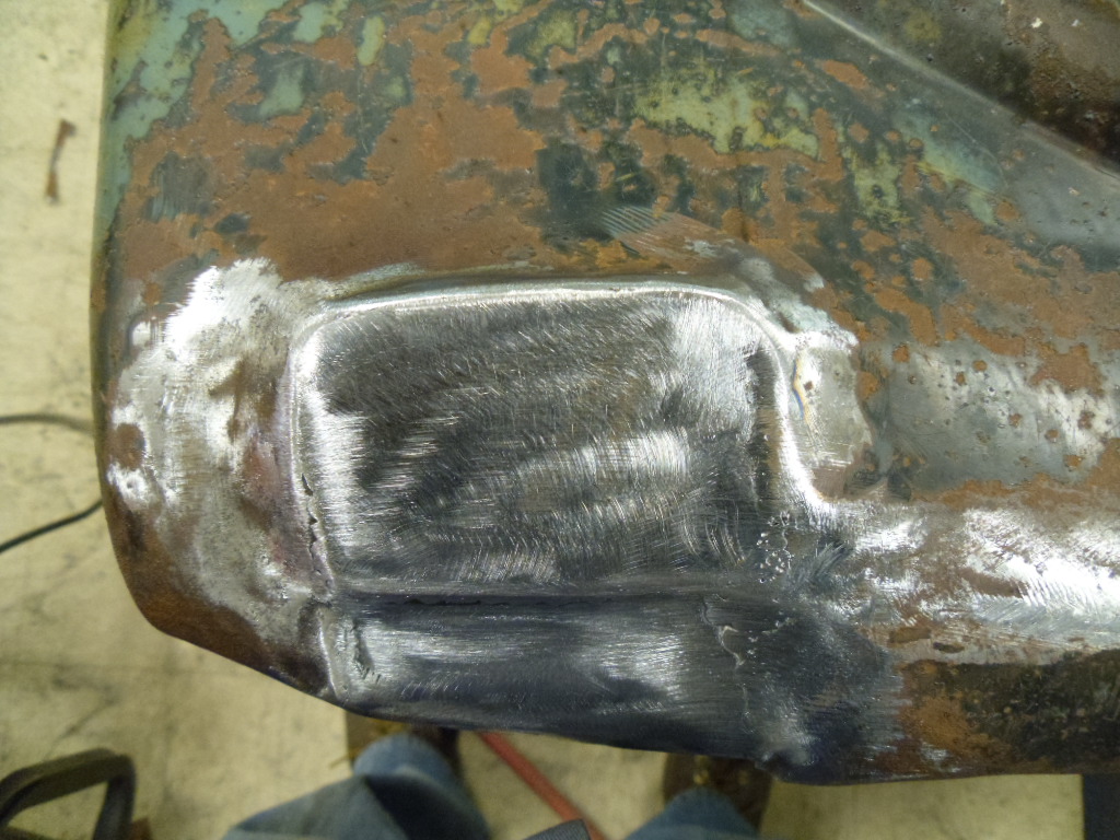

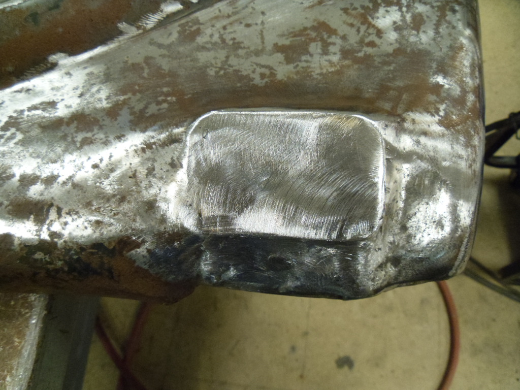

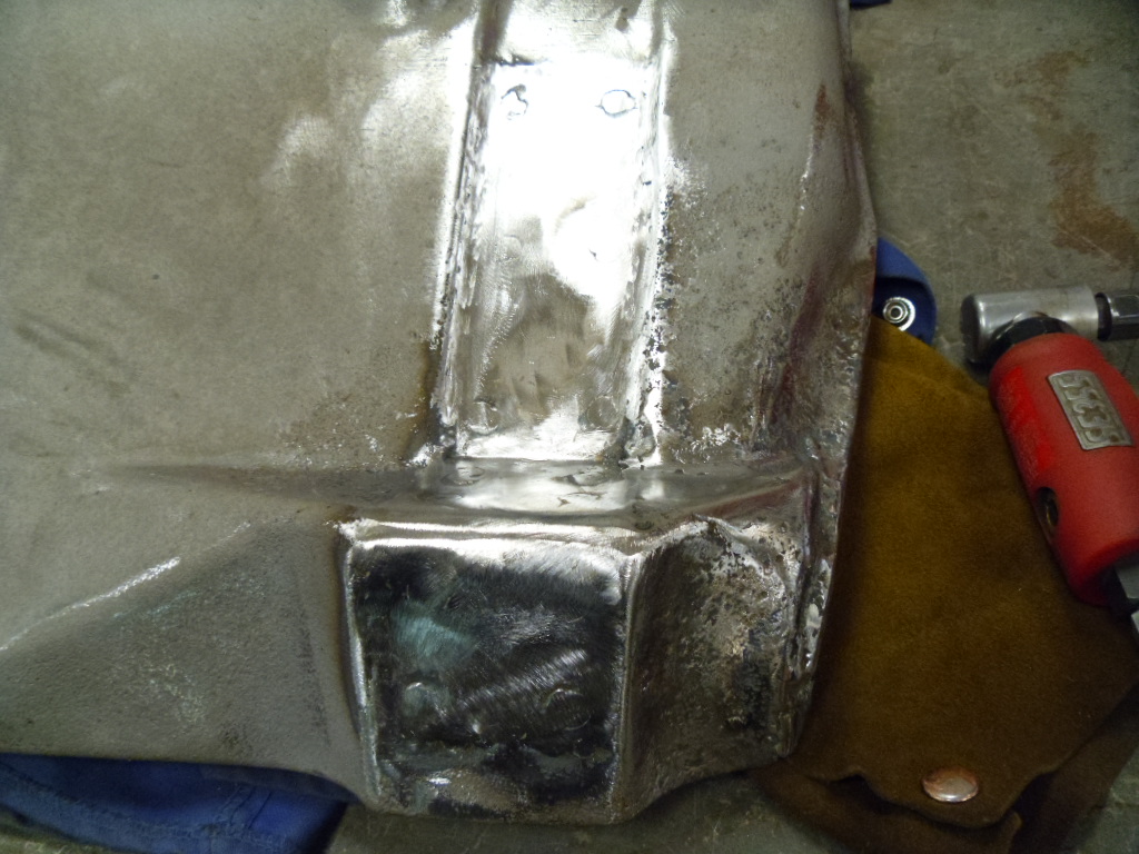

    Ok here is a couple updates on the car. I fixed the tailpan where the bumper bolts up to it.

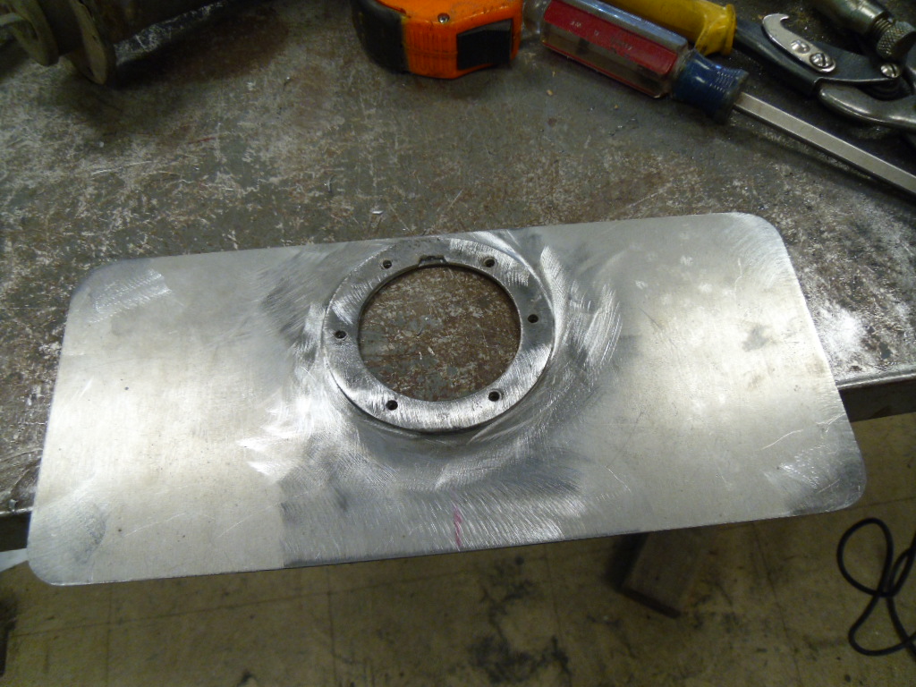

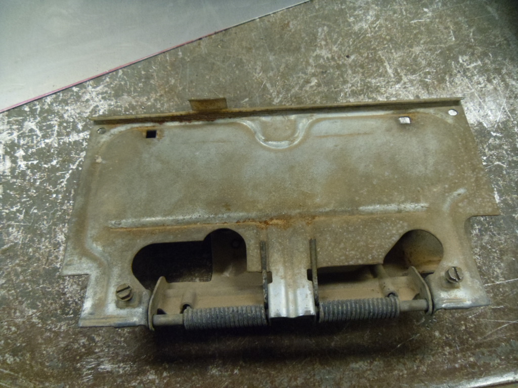

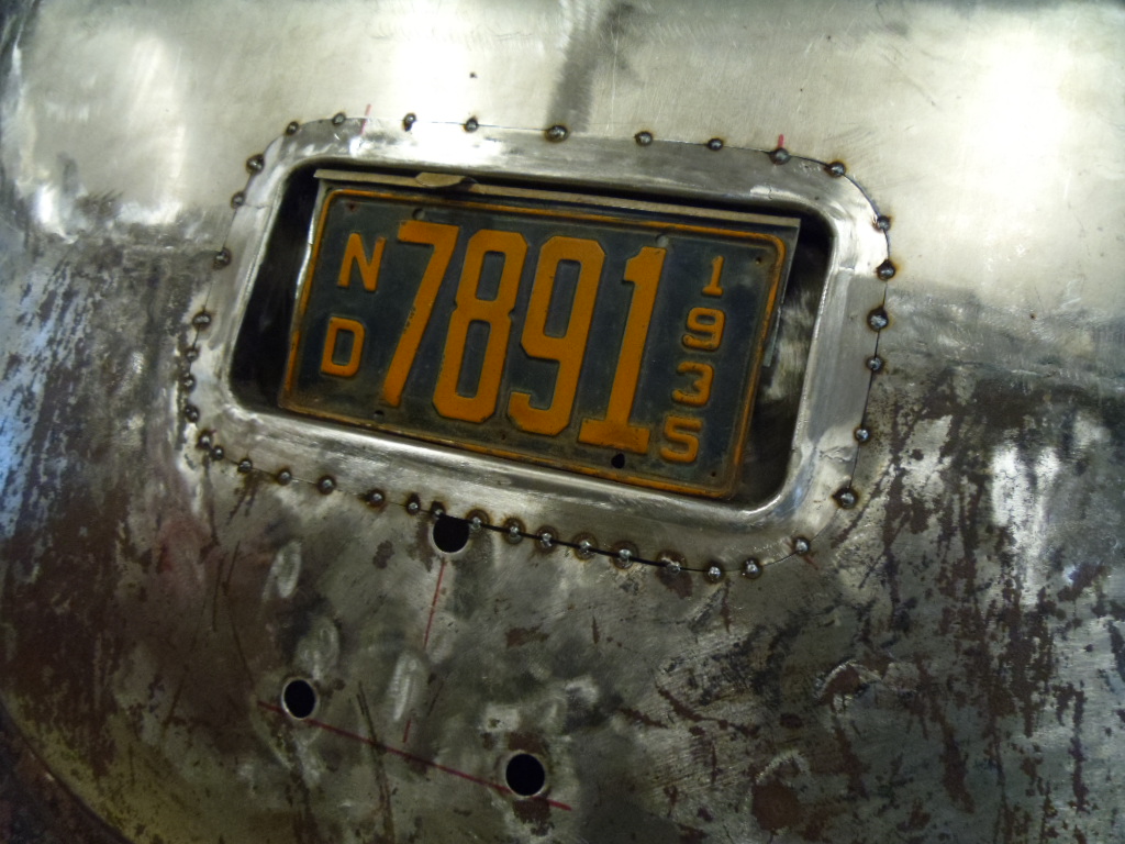

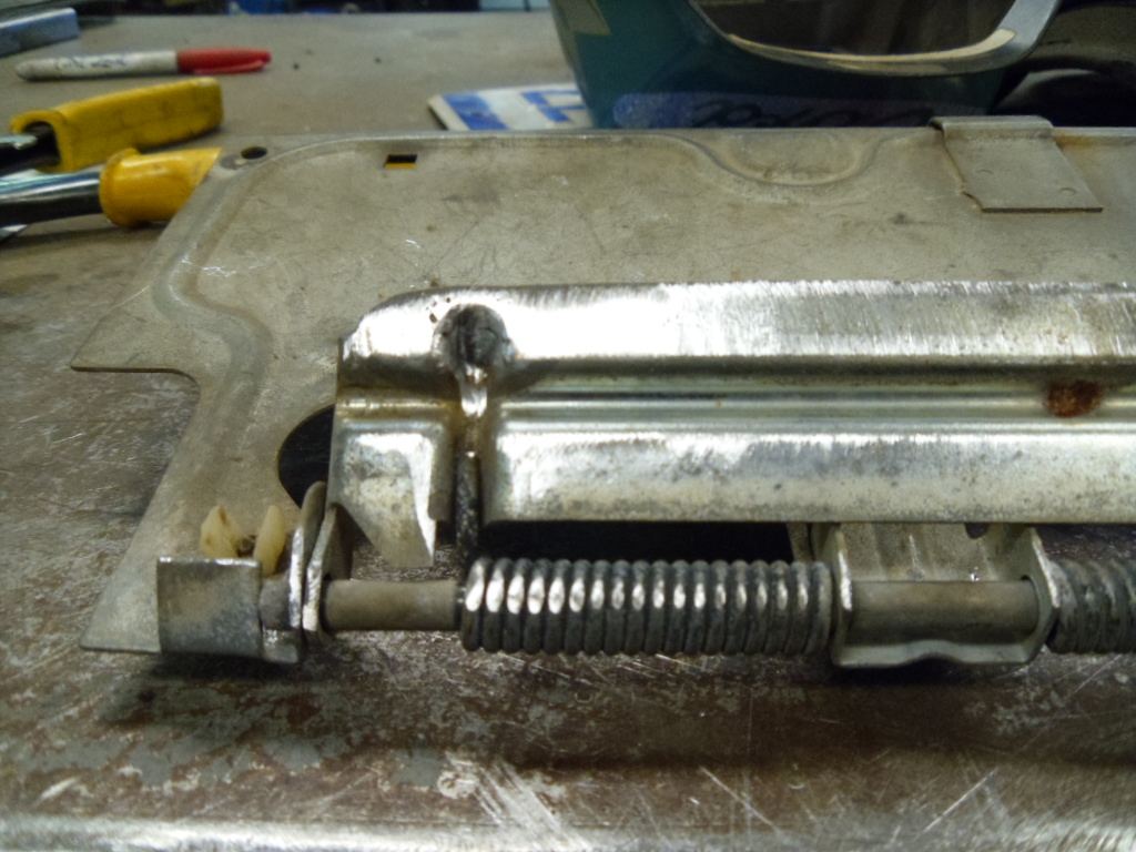

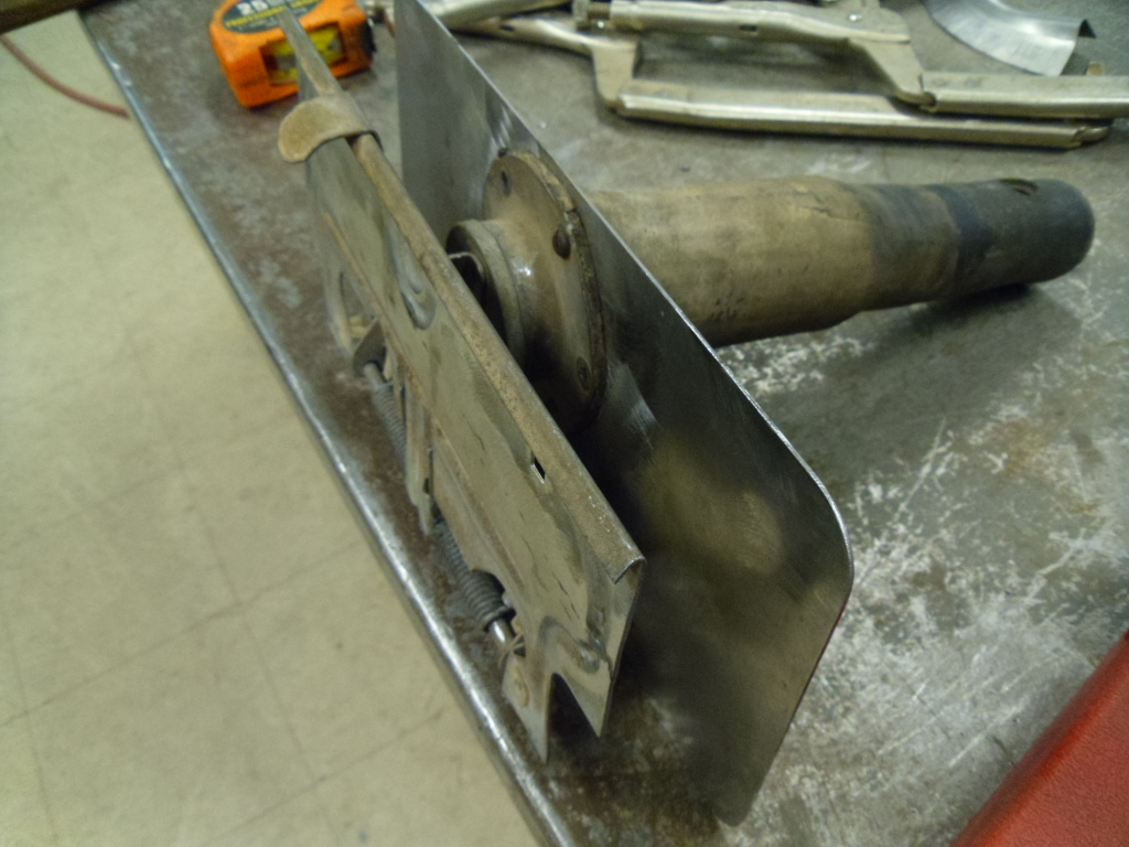

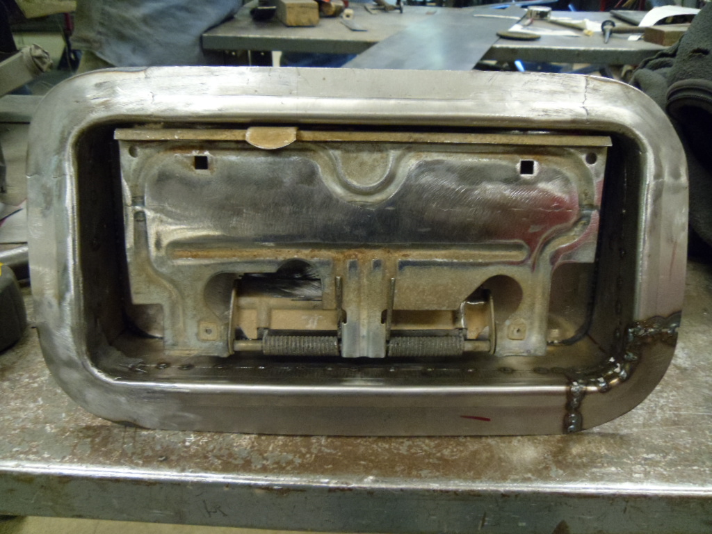

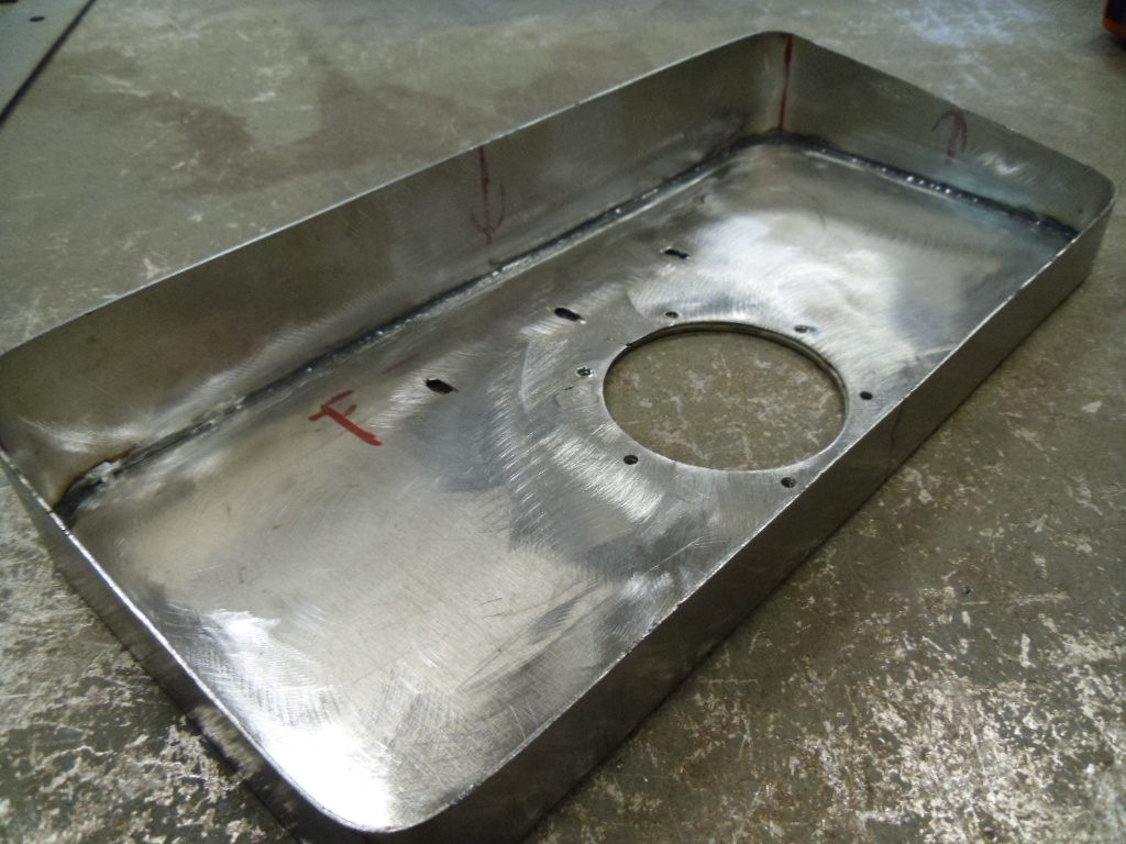

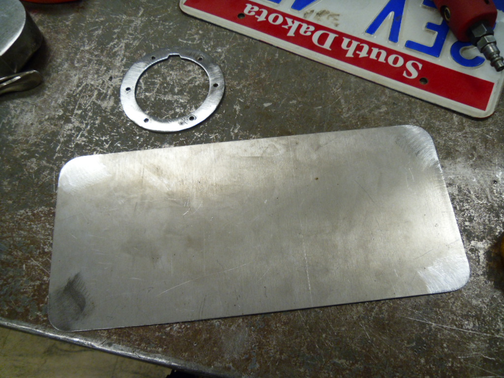

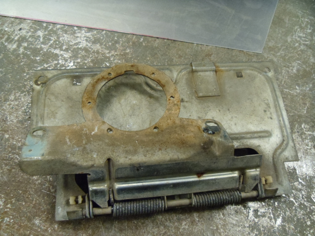

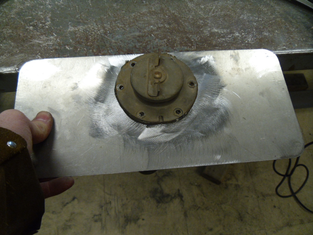

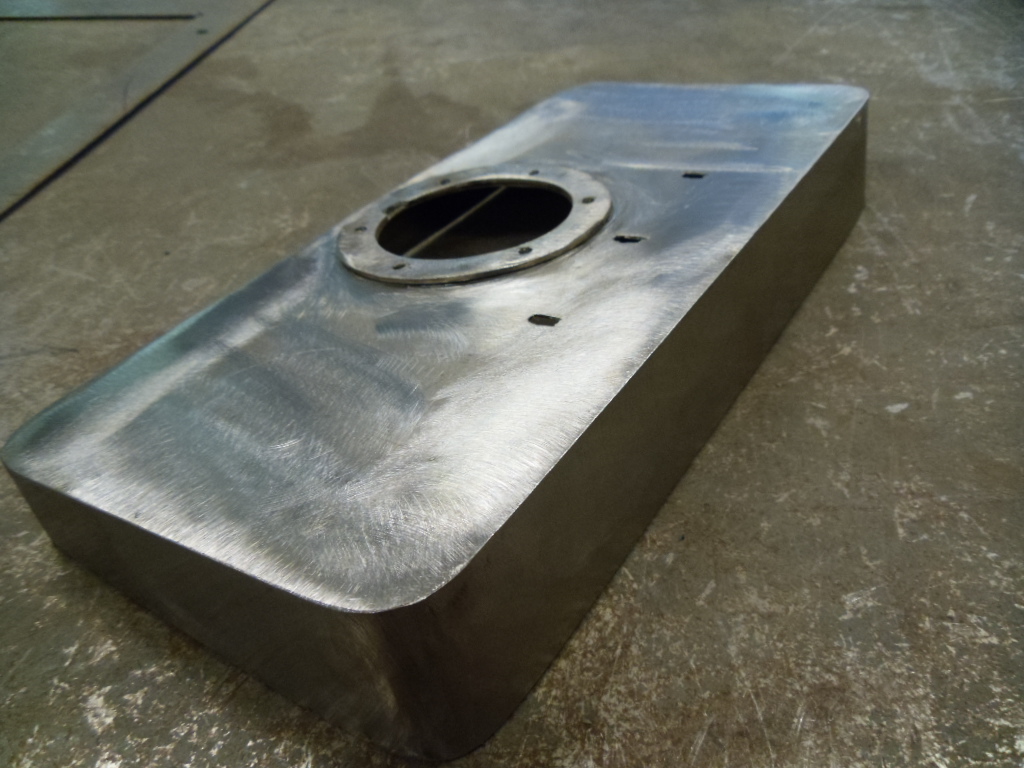

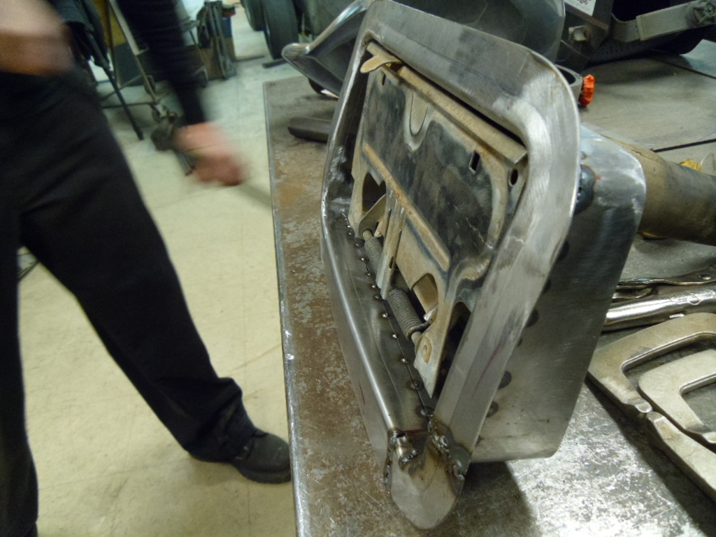

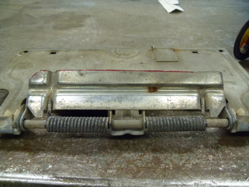

    Lately I have been working on the frenched license plate. I am doing a swinging door with the gas filler behind it. Here is what I did. I got the swinging door from Jamie in some trades we did. The first 2 pics are before I did anything to it. First I cut the back mount for the gas filler off. Then there was a bead that ended no where so I put a finished end on that. I then sectioned the plate mount 1 inch for the old plate to fit. Next I made the back plate of the frenched box. I then cut a hole for the filler and I plug welded the mounting ring on to it. Next I made a new bracket for the swinging door. I then made and welded the sides of the box to the bottom. I wanted a slight rolled edge on the body around the license plat so I rolled a bead, bent it into a 90, shrunk the edge so it would match the curve of the tail pan and then welded it to the box. I ended up making the corners separate

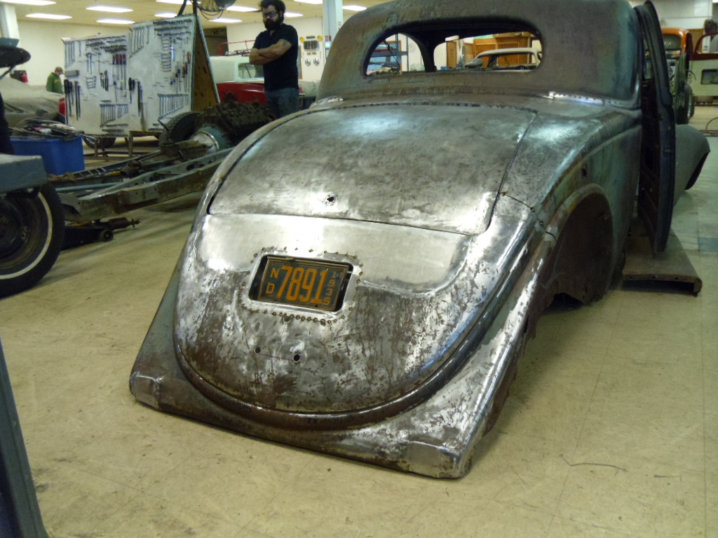

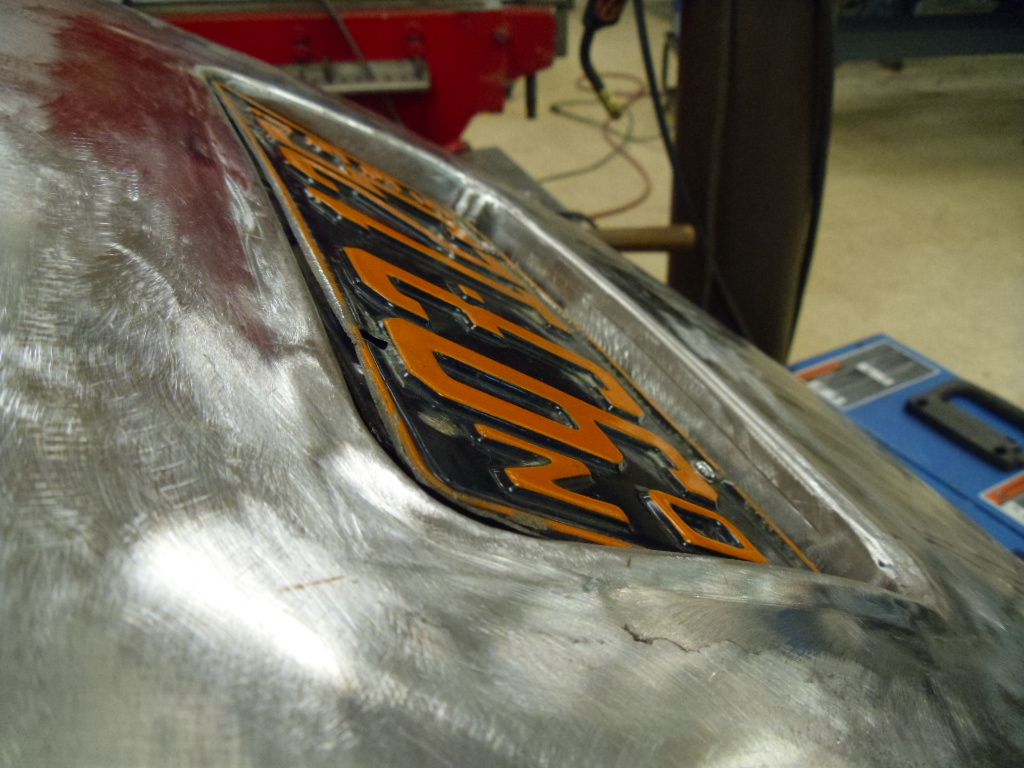

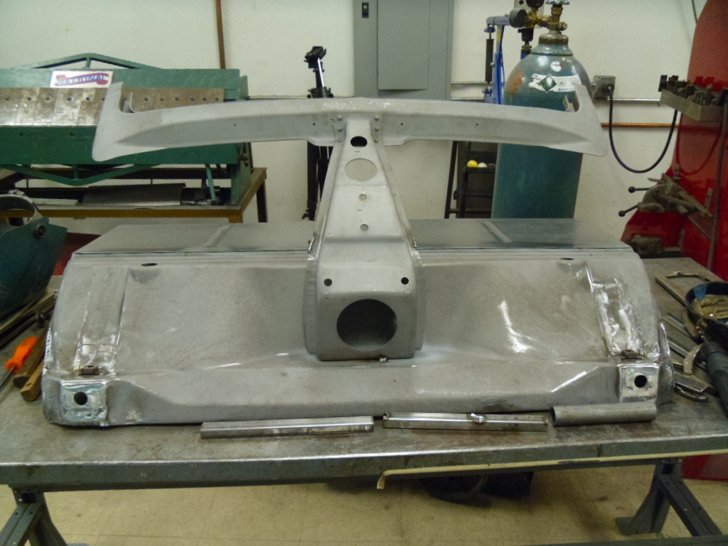

    And here it is taked into the tailpan. The school is having an open house this weekend so I just tacked it in and then I took the body off of the frame to show that off. I then tacked the tailpan onto the body.

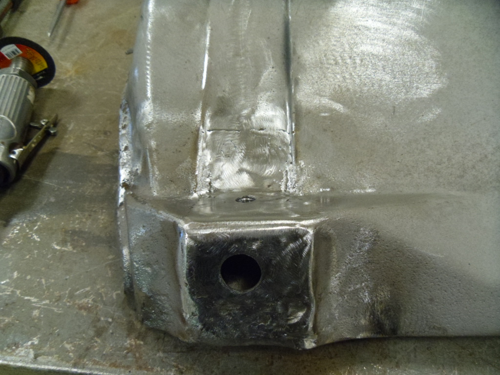

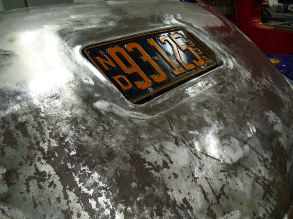

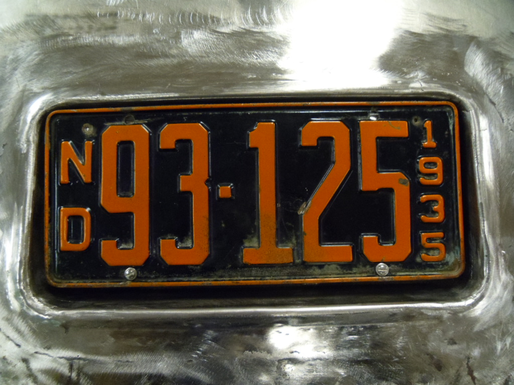

    I got a license plate that is the right size now (in ND a year of manufacture plate must have at least 5 digits). I got the frenched box welded in and I pluged the spare tire holes.

    Thanks Tom. I cut the top of the license plate holder off, so I could move the plate up higher. Now I have clearance to open the door.

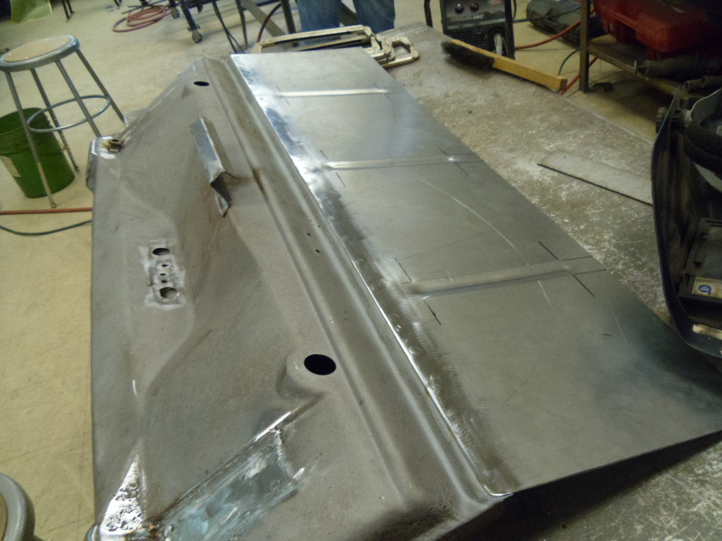

    I repaired the rust on the inner support of the tailpan.

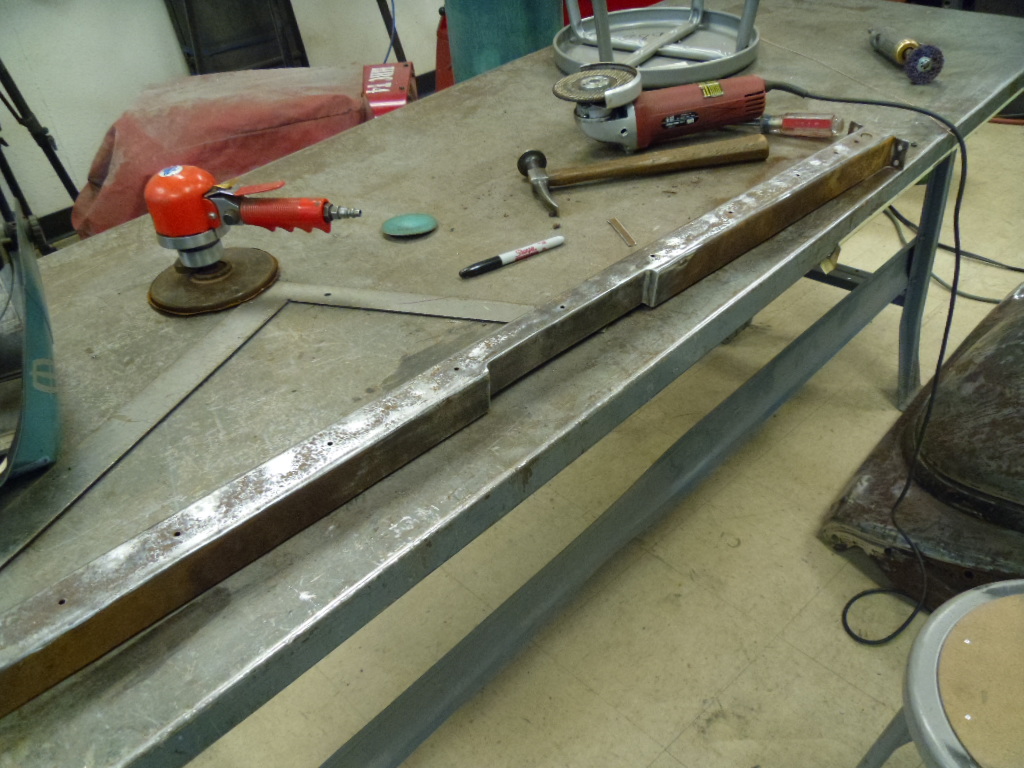

    I fixed all of the cage nuts that were shot. I then made a new floor piece that is part of the tail support. I spot welded that on and then I welded the bottom gutter back on on.

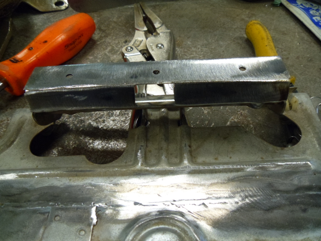

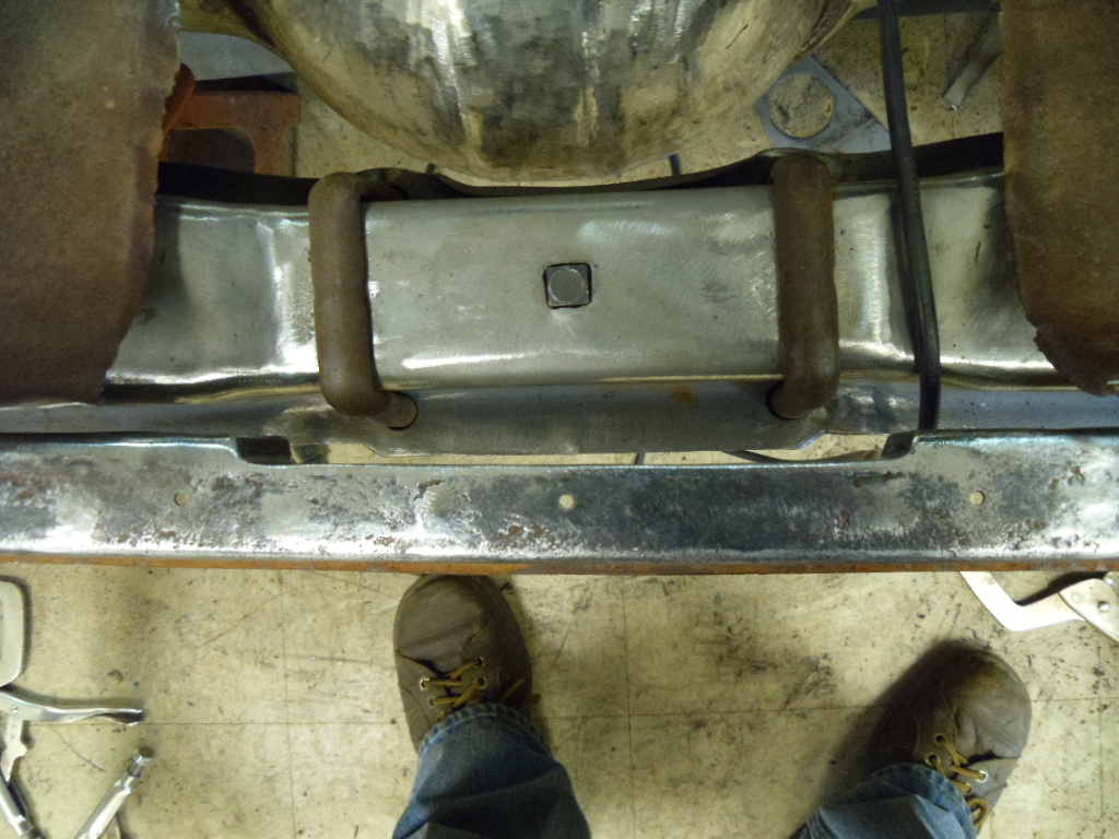

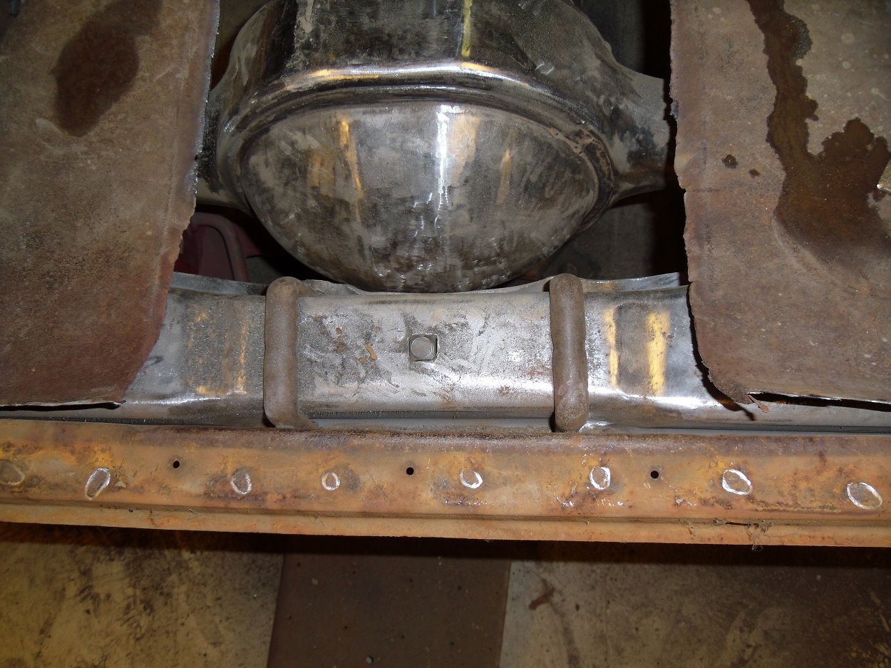

    Today I took the cross brace for the floor out. With the rear crossmember flatened out I didnt have any clearance around the U-bolts. I made a recess on the cross brace and got it spot welded back in.
    mgtstumpy likes this.
