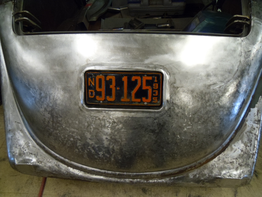

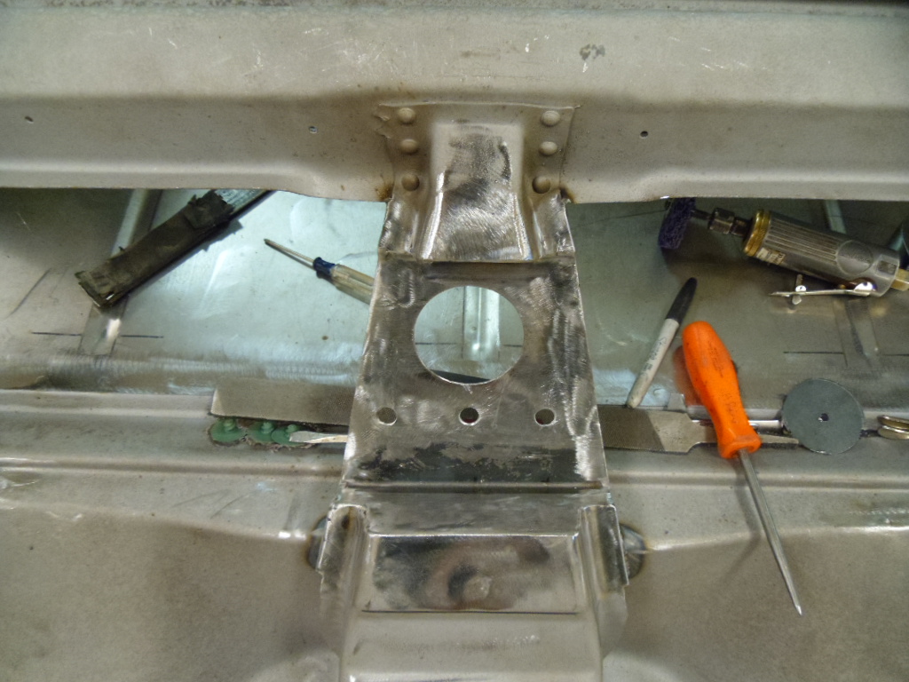

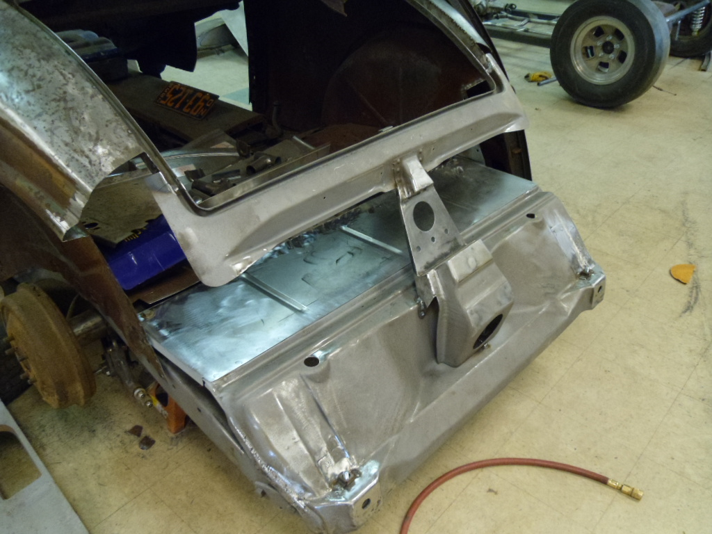

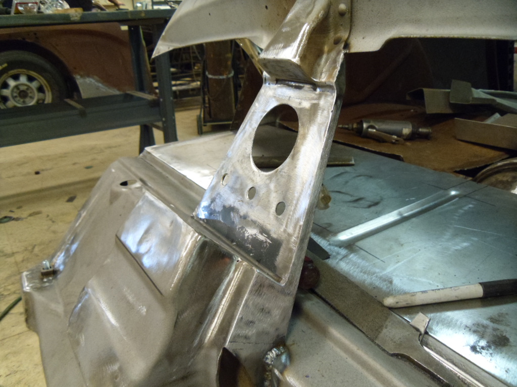

    I finished modifying the inner brace for the tailpan today. I had to make a recess for the license plate. On Saturday I took my tailpan down to work and my boss helped me do some pick and file work. About another 4 hours of pick and file and it should be done. I test fit the tailpan back on today to make sure everything was going to work ok.

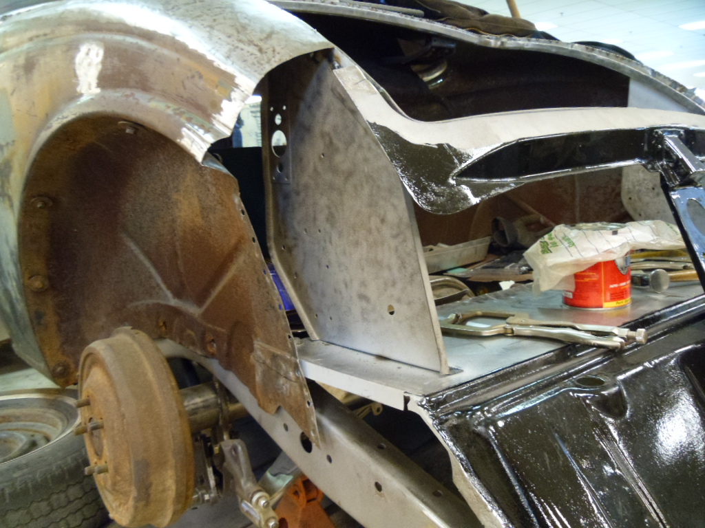

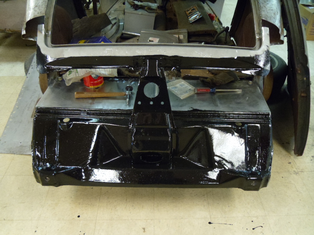

    I got the inner tail stucture welded back on today. I also put some POR on it to prevent it from rusting again

    Have you tryed the Eastwood stuff?
    if you havent it is more user friendly than the POR and dries much faster you can also thin it a tad and spray it! the other down side to POR is if you put it on steel and have to go back and weld in that area its real hard to weld even if you grind it good. just my .02

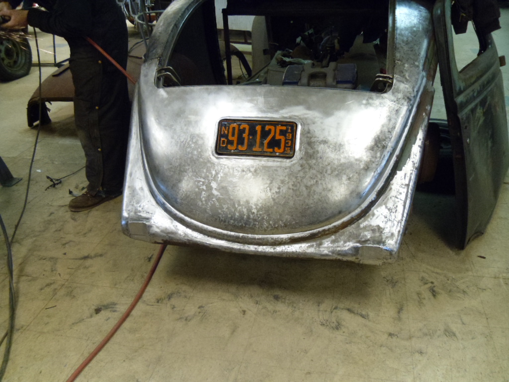

    I put the side braces back in today and I finished picking dents on the skin. If all goes to plan the tailpan will be back on the car tomorrow!

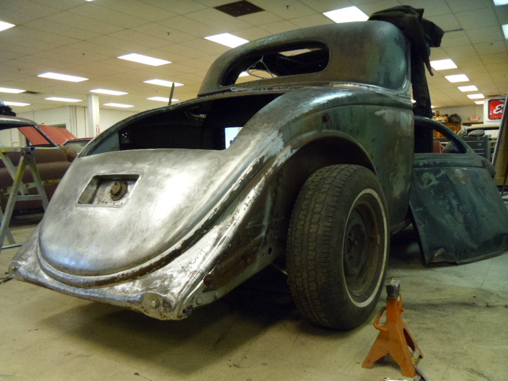

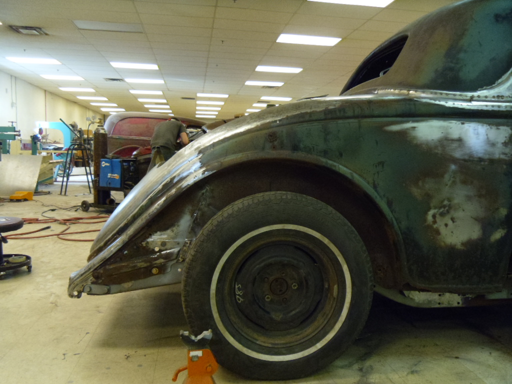

    The tailpan is back on the car! I still need to work the welds a little bit though. next I will weld the gutter in.
