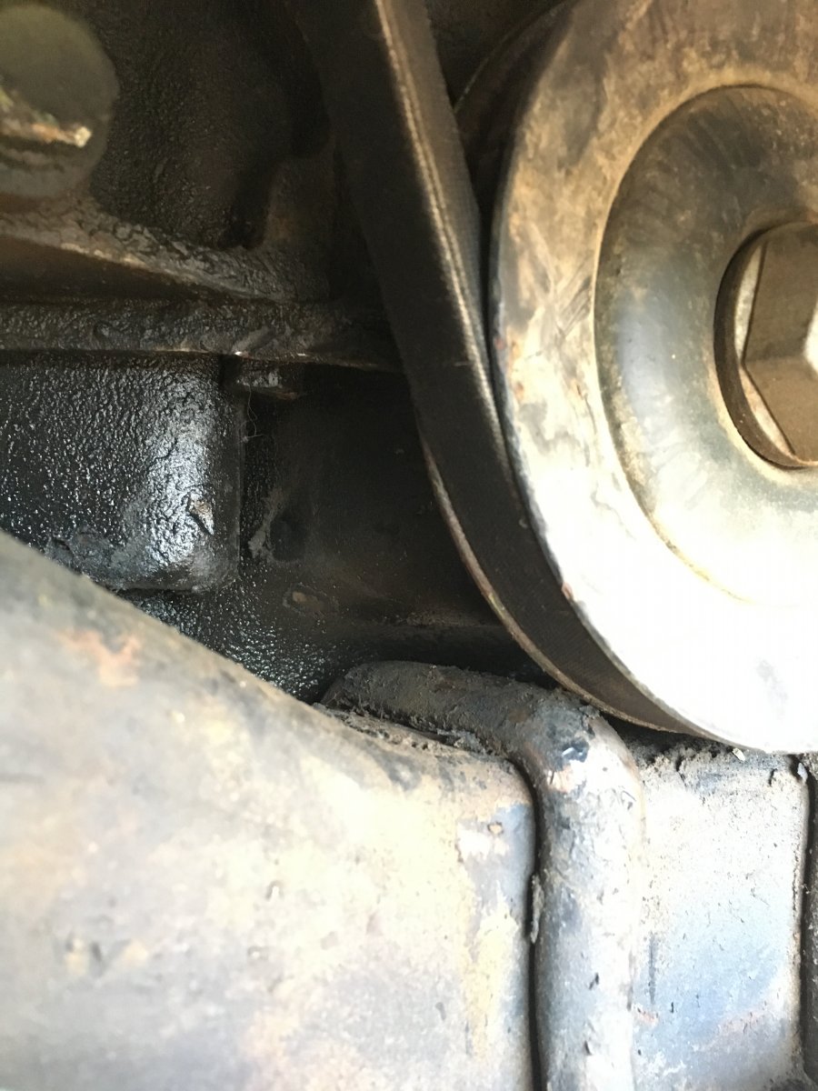

    Hey fellas,
    First, how do I remove the crank pulley? I need to replace the Ubolts holding the springs. Also, will I be able to remove the u bolts once the pulley is gone? It seems that it's a really tight fit for them to come out. It seems like they will hit the block where the oil pan attaches.
    Thanks,
    George

    Instead of removing the pulley, I'd rather take the front mount bolts out and jack the front of the engine up a bit. The U-bolts will tip to the side some once the nuts are off. Probably check the condition of the mount rubbers too, they may have flattened out as that looks closer than normal.

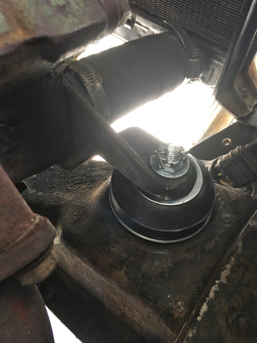

    Got everything replaced thanks for the help guys! It's crazy how much room there is once the new motor mounts are in. IMG_9833.JPG IMG_9832.JPG

    It looked like the old mounts were so bad that the balancer/pulley rubbed on them.....glad it worked out well for you
