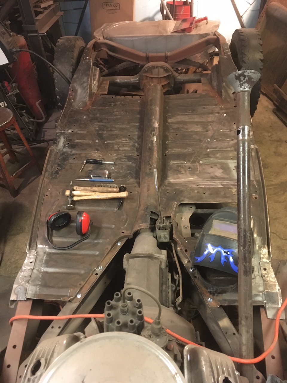

    So, im tearing into this 35 coupe after having the shell blasted and primed, so i know exactly where the rot is. Got patch/repair panels and a complete floor from ems. Patch panels seem pretty good. Then i started laying out the floor panels. The original floor looks like its wrapped over the ch***is, down the sides then picks up on the body mounts etc. The ems floor wont be wide enough to do that . Do you guys just weld the floor to the body or mount the floor to the ch***is then attach the body to the ch***is? I was going to do the body repairs then brace and lift the shell off the ch***is ? Sorry if these sound like dumb questions but i gotta get this right. Im guessing there probably isnt a right or a wrong way, but you guys have done this loads more times than i. Pics for attention as i probably havnt explained myself very well. 20180527_134335.jpg 20180527_134316.jpg 20180527_134305.jpg 20180527_134254.jpg

    What your talking about over the sides are subrail.
    Need to get a new set of subrails, they'll complete the equation.

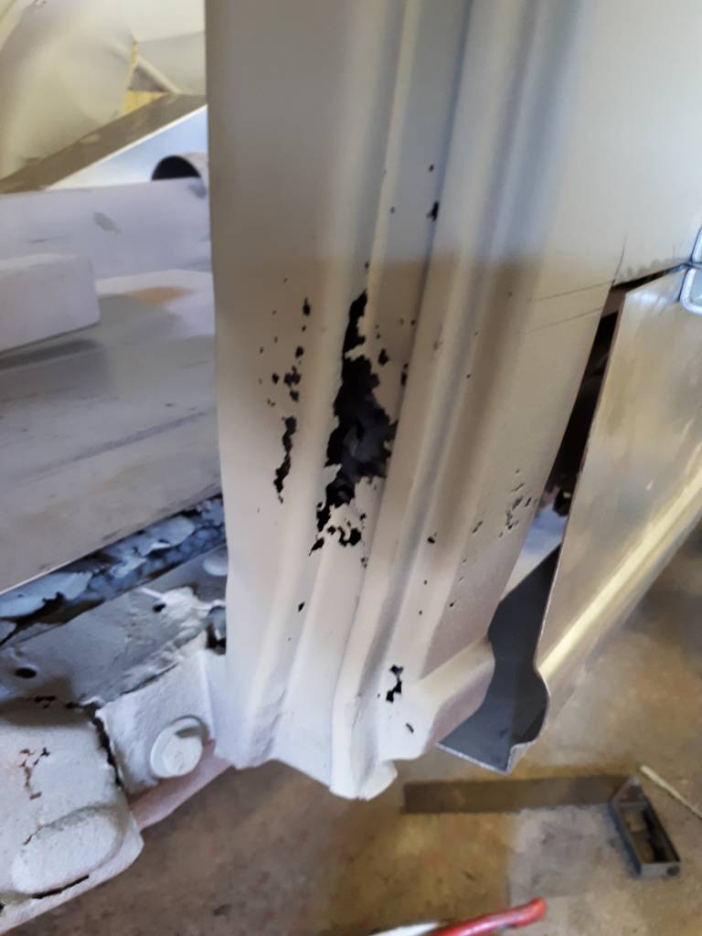

    On a side note. Are you sure the lower rear quarter repair panels are correct? They look short to me. The ones I got curled just round the b pillar and welded in where the door closes.
  13. Gurt74
    Joined: Nov 30, 2017
    Posts: 37
    Gurt74
    Hi Bob. Yes I've cut it short because I've got to do a repair on the door pillar and didn't want to lose the belt line reference. 20180528_160022.jpg
