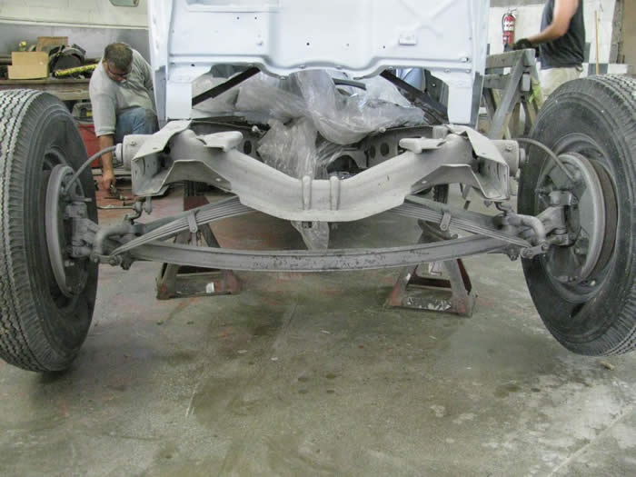

    Gday Guys,
    After some advice on my 35 3 window coupe front suspension. To me it seems to have been really beefed up for some reason, does anyone know if there was a reason this might have been done.
    Photos show, the front spring has 13 leafs instead of the standard 12,
    The front crossmember has a thick plate bolted to the underside and another to the top of the crossmember and the ibeam has had the the back of the ibeam welded solid.
    Any advice would be appreciated.
    Thanks 20191027_210312.jpeg 20191027_210342.jpeg 20191027_210404.jpeg 20191027_210421.jpeg 20191027_210428.jpeg 20191027_210503.jpeg
    Sent from my SM-G975F using The H.A.M.B. mobile app
  2. lothiandon1940
    Joined: May 24, 2007
    Posts: 32,597
    lothiandon1940
    Some sort of crude repair after an accident?
    LOU WELLS likes this.
  3. DRCA
    Joined: Jun 7, 2014
    Posts: 39
    DRCA
    Maybe a former moonshine hauler.,....
    Just Gary and lothiandon1940 like this.
  4. LOU WELLS
    Joined: Jan 24, 2010
    Posts: 3,666
    LOU WELLS
    from IDAHO
    Dirt Track Racer?..
    lothiandon1940 likes this.
  5. sdroadster
    Joined: Jul 27, 2006
    Posts: 449
    sdroadster
    I vote for crude repair.
  6. alchemy
    Joined: Sep 27, 2002
    Posts: 22,831
    alchemy
    Cool to speculate about, but not really good for a street car. At the very least, remove all the extra leaves from the spring.
  7. rare 50
    Joined: May 27, 2012
    Posts: 26
    rare 50
    from Australia
    I have a new reverse eye spring and dropped I beam to install, just thought it strange that it was so beefed up especially with the extra leaf in the spring.
    I think it will drop significantly when i install the new front end.
    Thanks
  8. Boneyard51
    Joined: Dec 10, 2017
    Posts: 6,781
    Boneyard51
    That’s the beauty of the leaf spring! It can be made lighter or stronger by the addition or subtraction of leafs. At some point someone wanted a stronger spring!
    Bones
  9. 302GMC
    Joined: Dec 15, 2005
    Posts: 8,523
    302GMC
    from Idaho
    Probably got worked/driven hard, and both crossmembers broke. Very common on Fords.
  10. I’m guessing that’s the wrong spring
    Or someone flattened it to lower it but then added blocks and leaves to get it back up.
