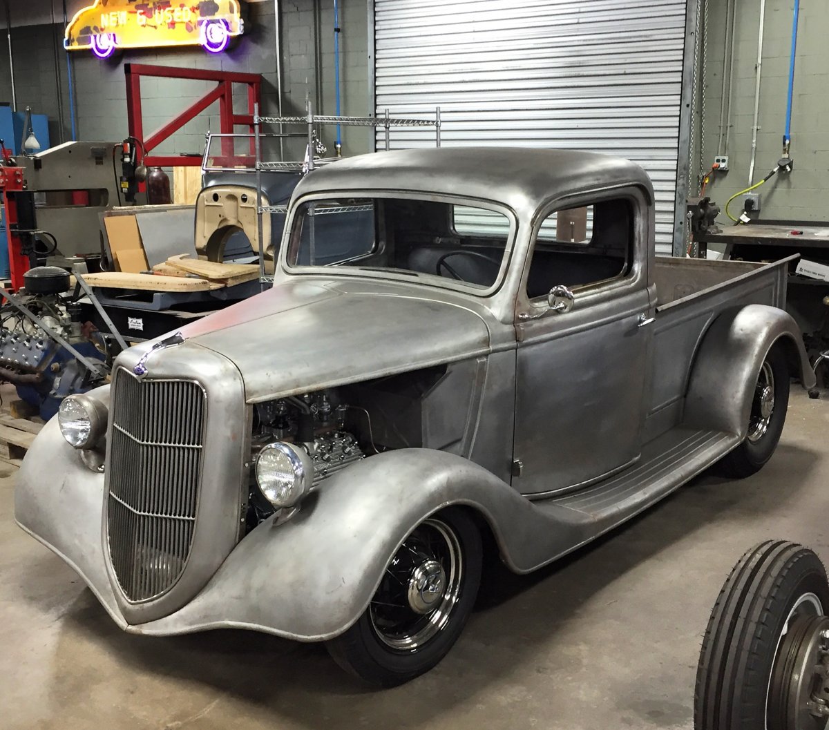

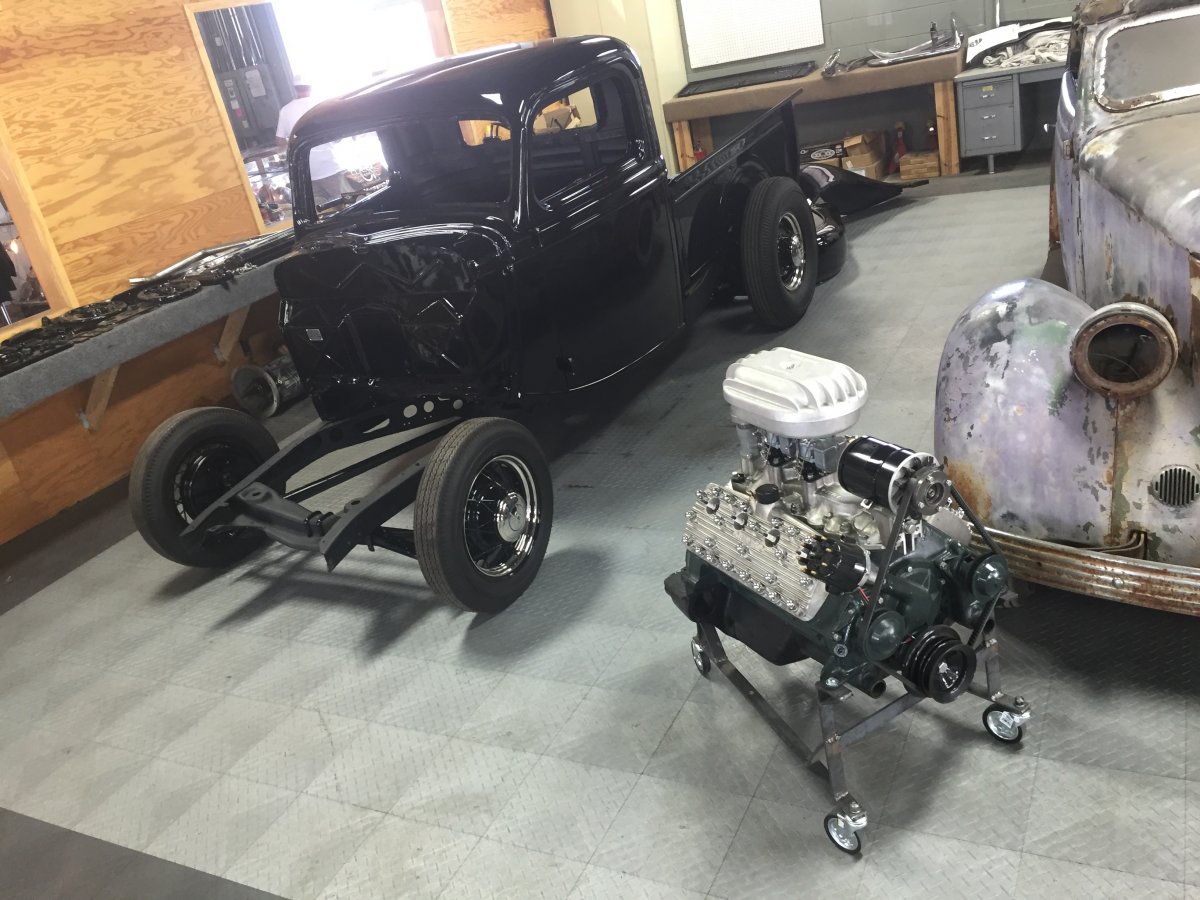

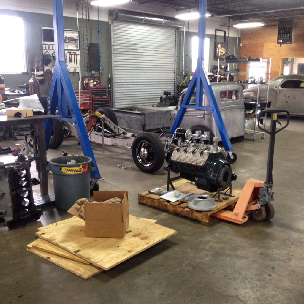

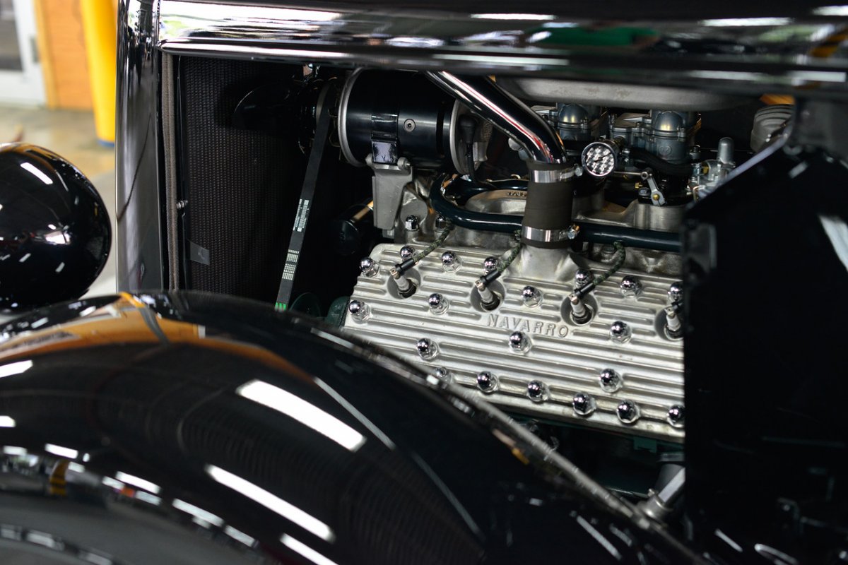

    Just a small one. The H&H flatty showed up. French block decked out in new Navarro garb with a pair of 97's on top. I blew the truck apart Thursday and got the T5 bolted up to the new engine and installed in the ch***is. Now I'll get the clutch linkage and brake lines done, fuel line, and exhaust. We're going un-muffled on this one and the pipes will go all the way out back. We bought a pair of cheap headers from Speedway but the driver's side won't work with the Vega steering box and oil dipstick, so I'll remake that one.

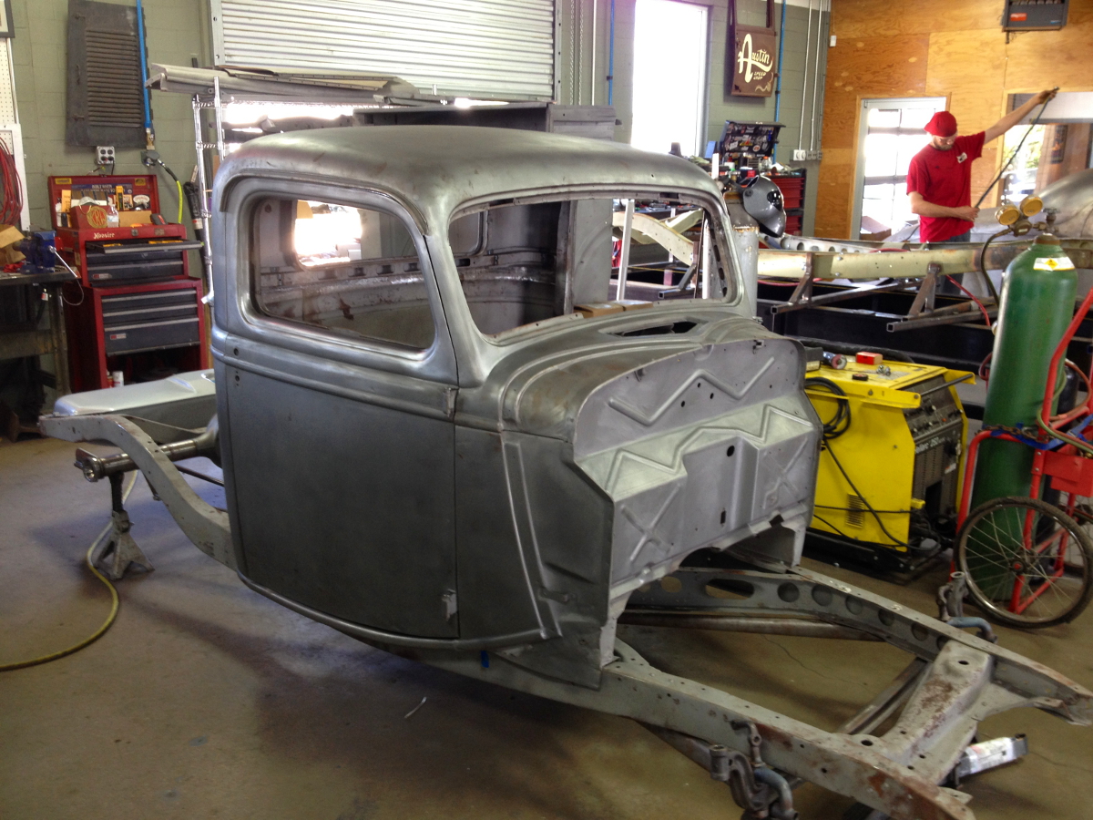

    Built a new drivers side header and all of the exhaust. Clutch linkage and pedal arm fitment done. The cab is back on and throttle linkage done. E-brake cables run. Steering linkage done. Firewall smoothed. Modified the stock plug wire looms to work with the new style distributor. Bed is back on and tailgate supports have been sorted. Brake and fuel lines done. Switched to a mechanical fuel pump. Radiator hoses fit. Battery tray made to sink the battery into the floor under the seat. Numerous other loose ends wrapped up. Started on final metal work, got the p***enger door gapped. We finally got our new door skin for the driver's door but it'll have to wait. Back on the Showtime '55 this week and pretty much until it's a running driving car to send off for interior.

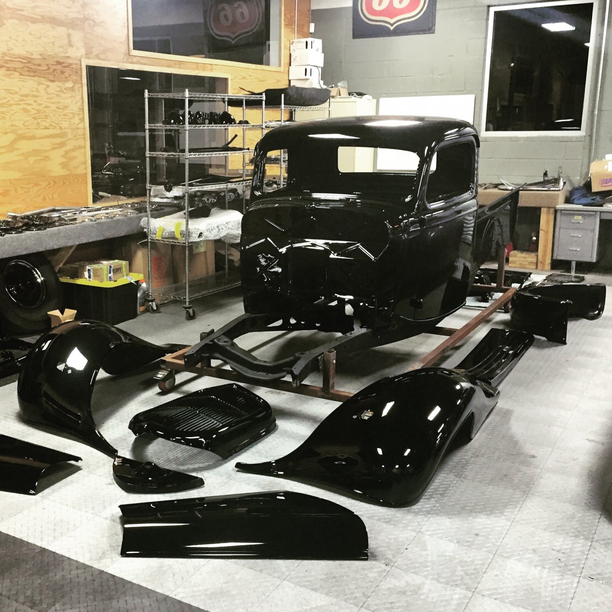

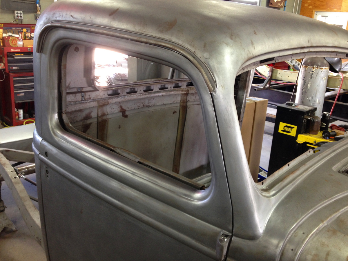

    We finished the metal work, set gaps, etc. had the truck fully ***embled and signed off on, then blew it apart for paint.
    It's been back from paint for a few weeks and re***embly will start this week.

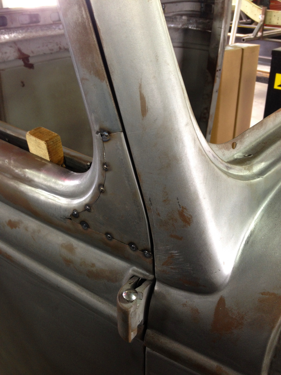

    Just curious how you attached the top hood pieces, when not using the side panels?

    I used dzus style fasteners attached to the body and grill shell with the receivers attached to the hood tops. I'll post some pictures when I get the hood back on.

    Officially started ***embly. Did a quick mock up of the suspension last week to get it on the ground for the Roundup weekend.

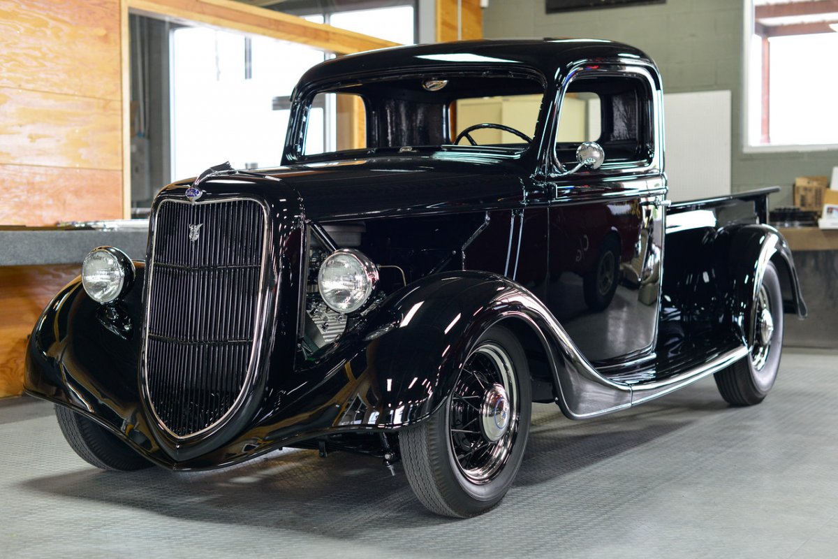

  13. Austin Speed Shop
    Joined: Jun 11, 2009
    Posts: 112
    Austin Speed Shop
    from Austin TX
    Hey Root, on page 3, post #66 there are some detailed shots of the latches.

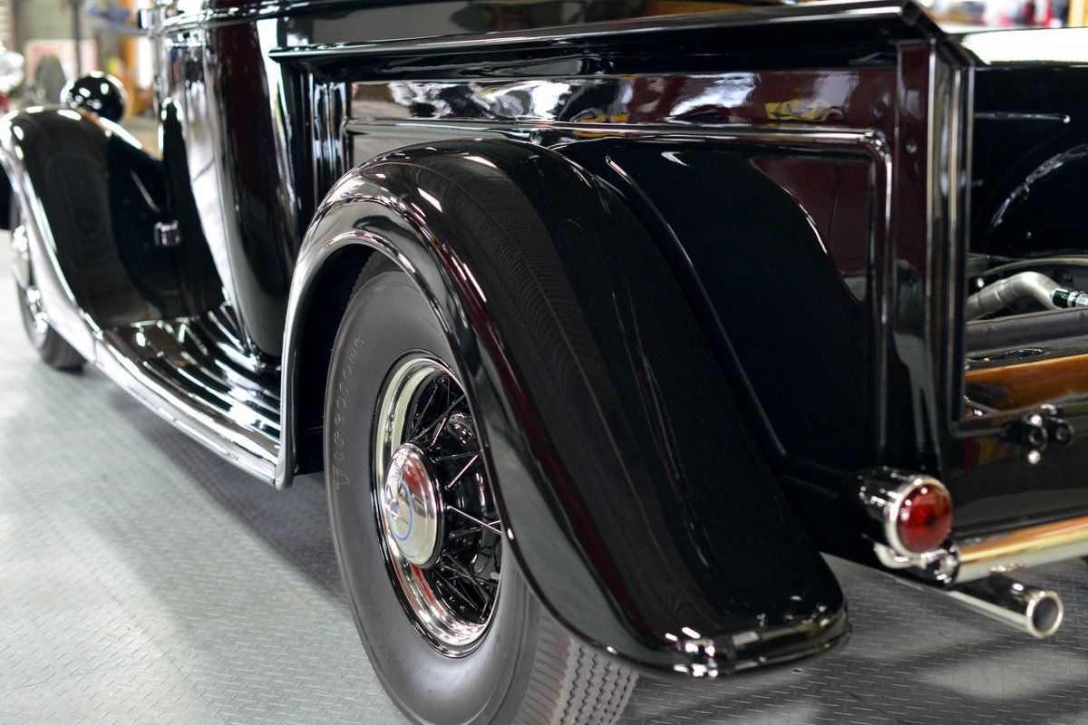

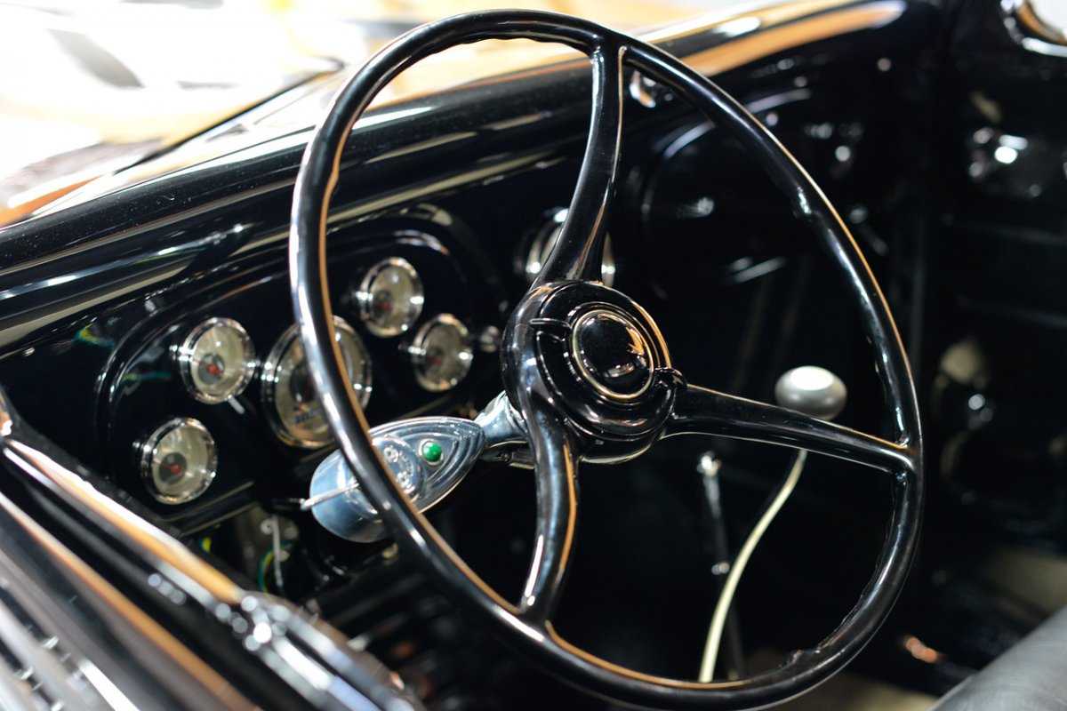

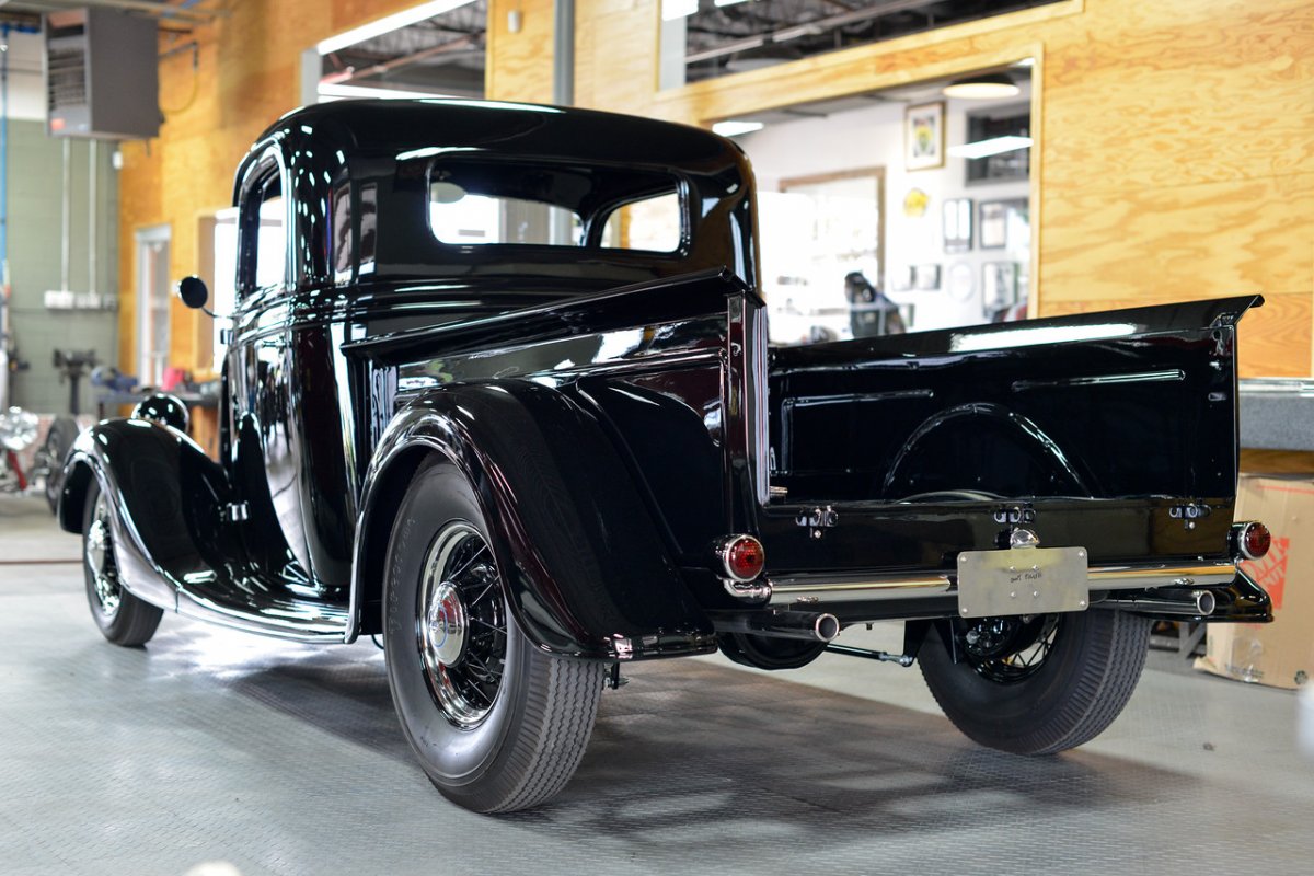

    The truck is mostly all together now! It's fully wired and we got her running and driving this week. All it lacks is gl***, then it's off to upholstery. The bed wood is still being finished by the trucks owner and should be ready just after upholstery. The wood, stainless strips, and tailgate should weigh the back down a little bit more to refine the stance.
    These shots were taken by our good friend Blake Burwell when he stopped by the shop yesterday

    Excellent workmanship! Is the color black or a very dark green?

  18. Killer... Love the tailgate treatment.

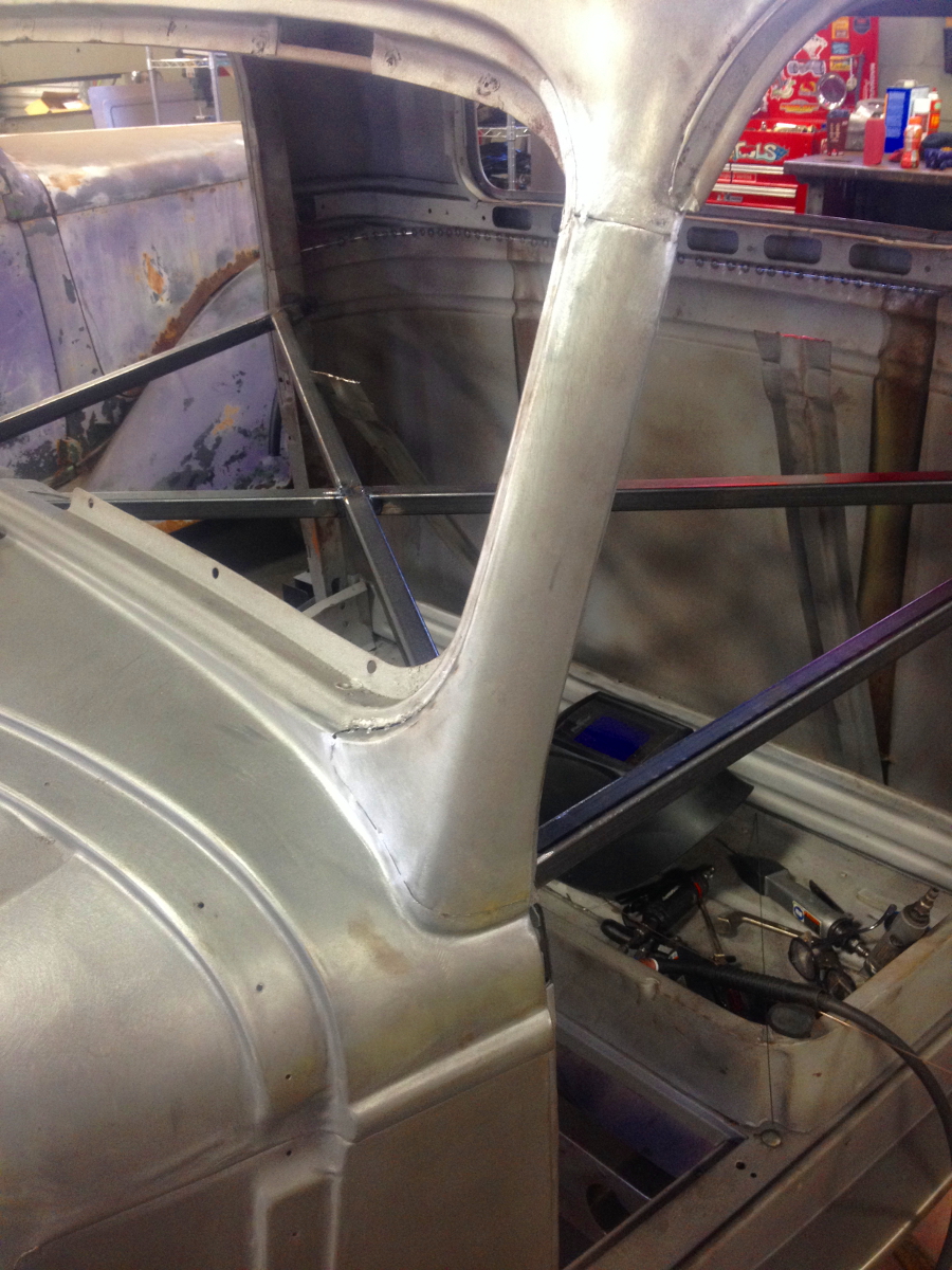

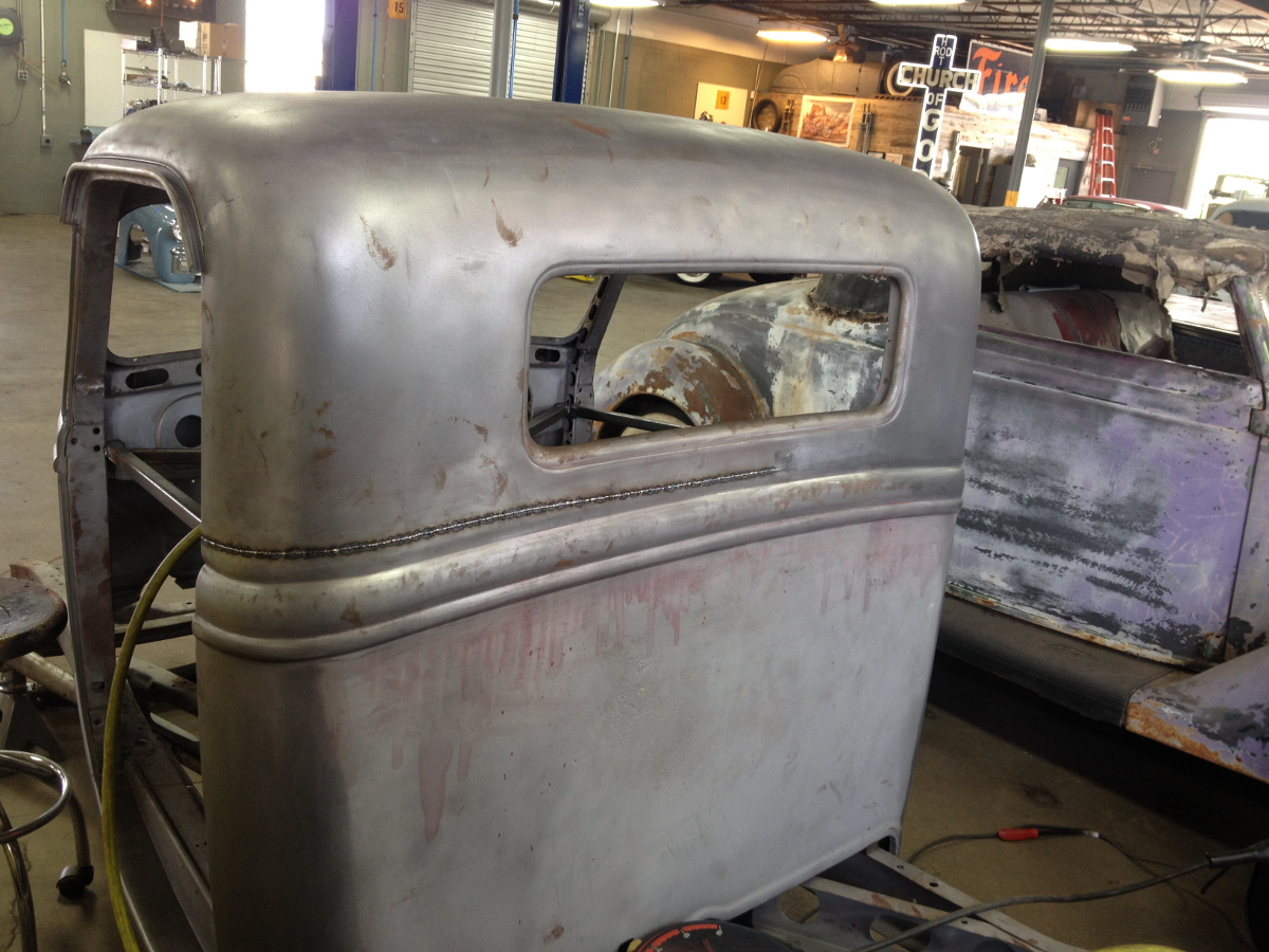

    This is the most ingenious way I have seen one chopped. Bravo my man! This is my favorite thread on the hamb.
