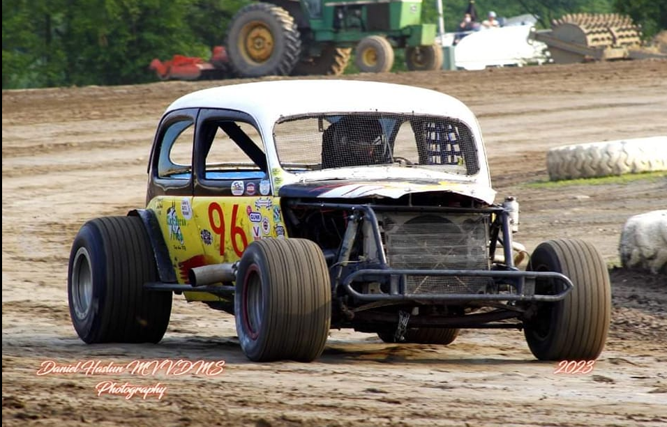

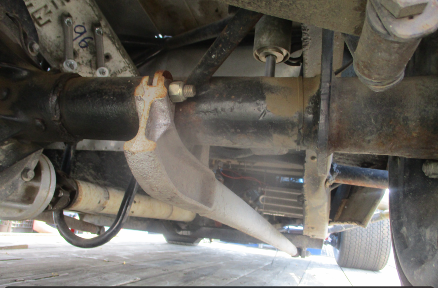

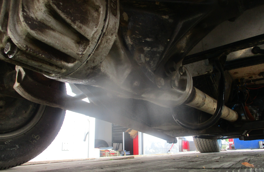

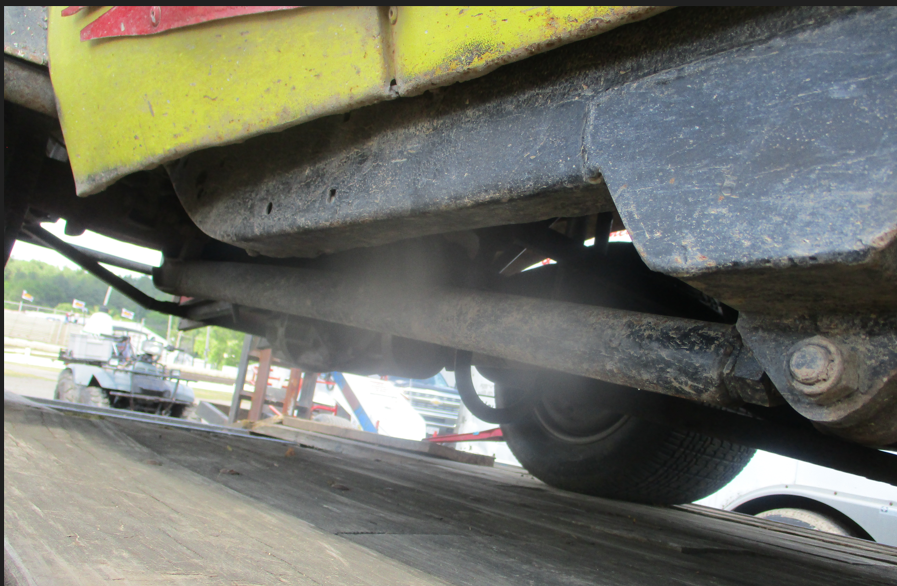

  8. This car has been running with the vintage stock car club I race with for 5 plus year and has been raced for 20 years or more.
    It has about a 400 H.P. Small Block Chevy, runs super soft super sticky 12"-13" wide tires.
    In fact many if not most early buggy spring stock cars ran open drive shaft floater rears or 10 spline floater Q.C.s and split bones.

  9. They look bent. I would add a torque arm for piece of mind
    seabeecmc likes this.

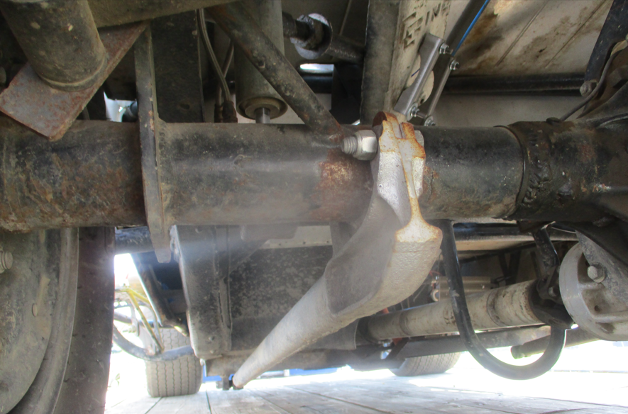

  14. I do have a rear end. It's just 5 hours away lol received_806994894548793.jpeg
