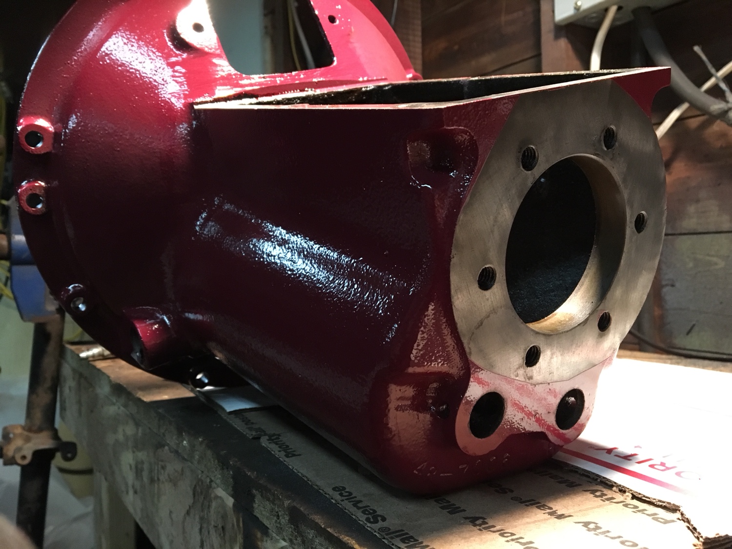

    Did a little work this weekend, mostly cleaning things up, garage included, but I did get my axle brackets finish welded and ready for powder coating. I’ve also been spending some time zinc plating hardware, but that’s not exciting to show.
    Also got the rest of the trans apart and ready for paint. Internals look really good.

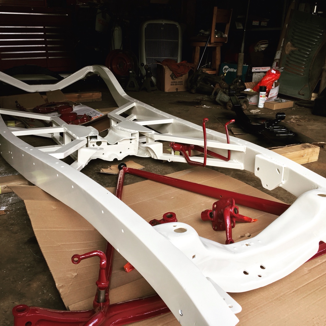

    Bantam, just got my frame done today. The final price of getting it sandblasted and powder coated was $250. Hope that helps your local ballpark. Tell 'em if they're too pricey you'll ship it to Detroit! :p

    I added tires to the front, and got the spring mostly hung along with perch bolts and most of the other front end parts. I’m sitting here waiting on parts to show up before I can do much more on the frame, and I’m sending the last bits for powder this week. She’s moving along steady.

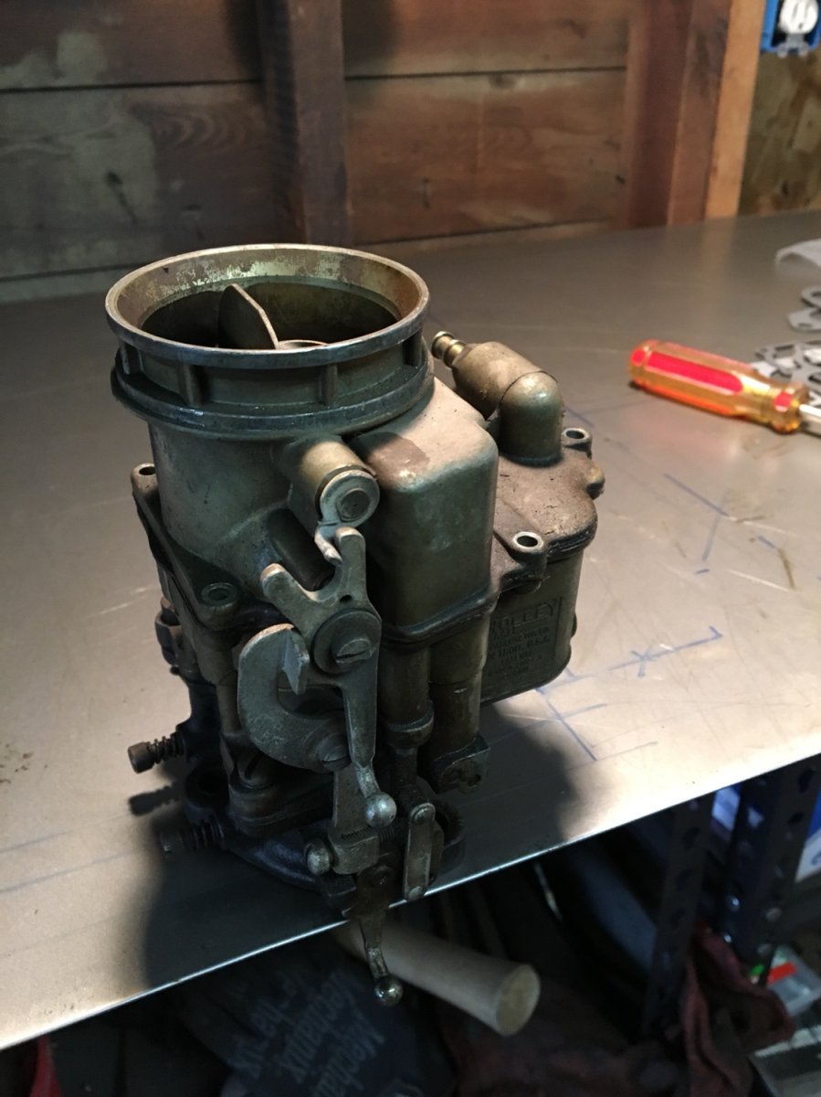

    Then I had to rebuild the 94 I had as the accelerator pump wasn’t squirting, but now she runs really well. Pulled her out of the garage under her own power even!

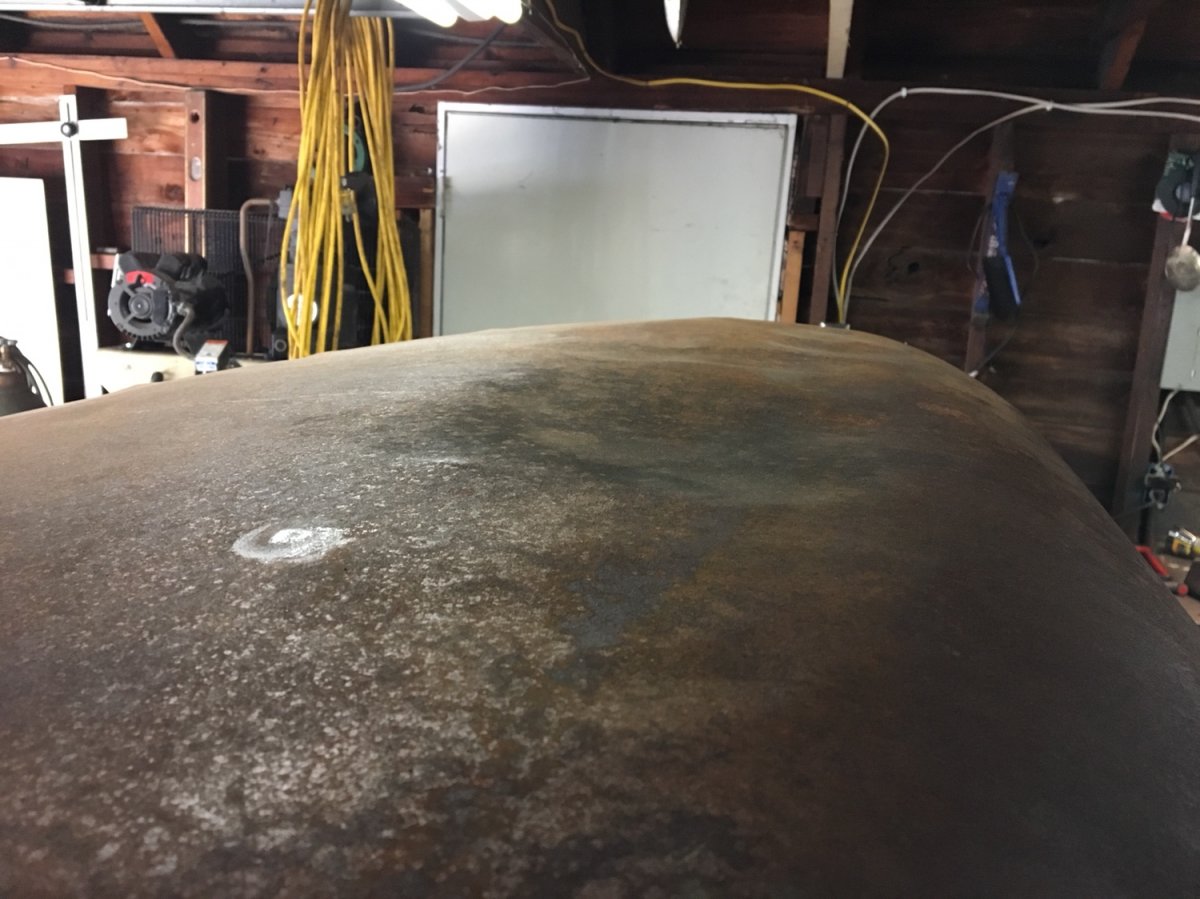

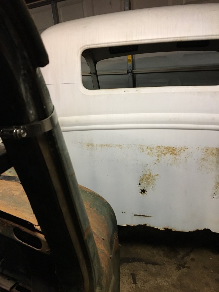

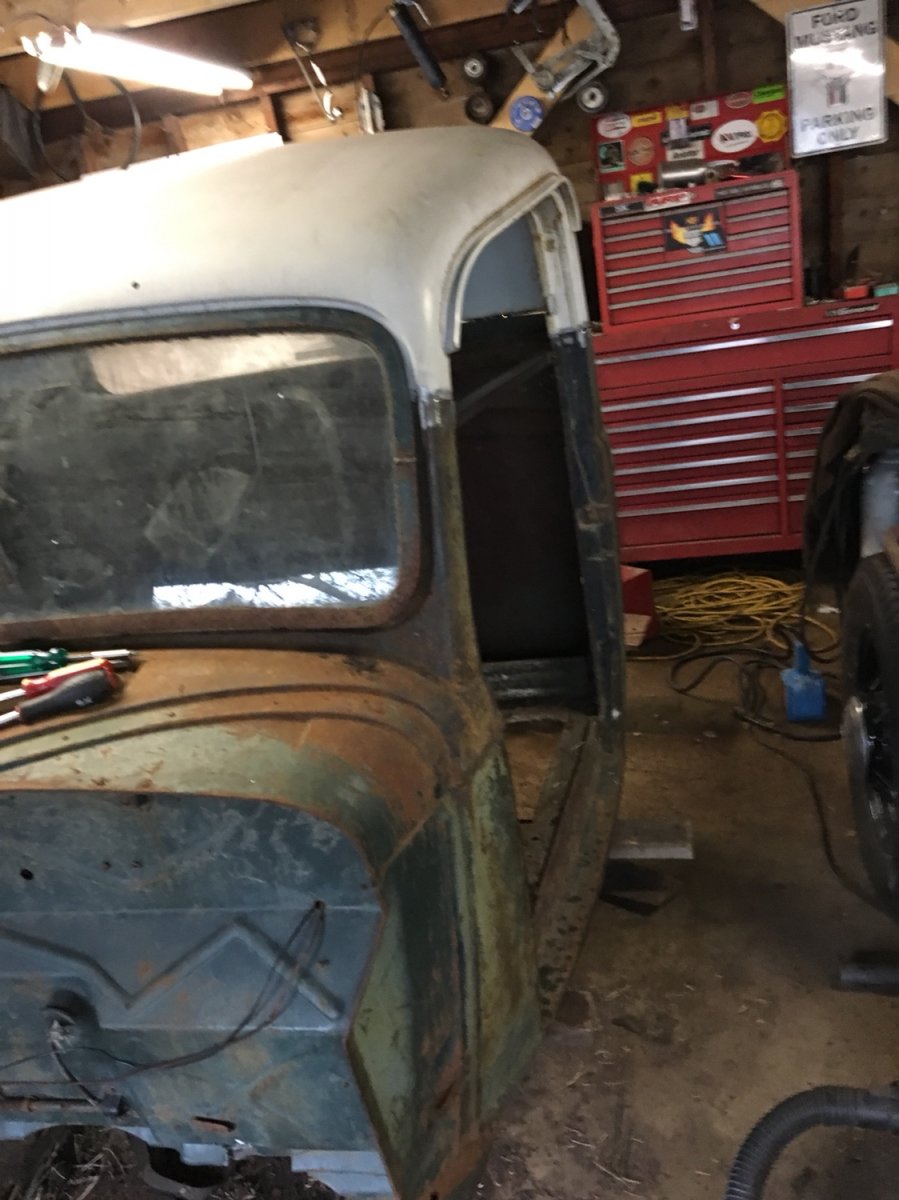

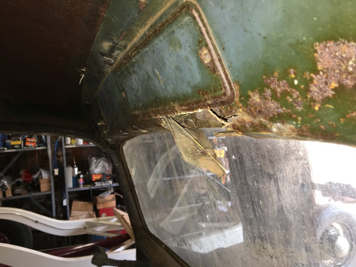

    Slight change in direction again. Decided to use parts from my other cab to patch this one when I pulled the windshield out and ran into more rust than expected. In the interest of time (it’s supposed to drive to Alaska in 3 months!) I cut the roof off rather than weld a bunch of individual patch panels. Much welding to follow, but much less fabrication.
    IMG_0472.JPG IMG_0474.JPG IMG_0475.JPG IMG_0477.JPG IMG_0478.JPG IMG_0479.JPG IMG_0484.JPG
    Oh, and while I had the white roof off, I repaired the one bad spot on the header panel.
