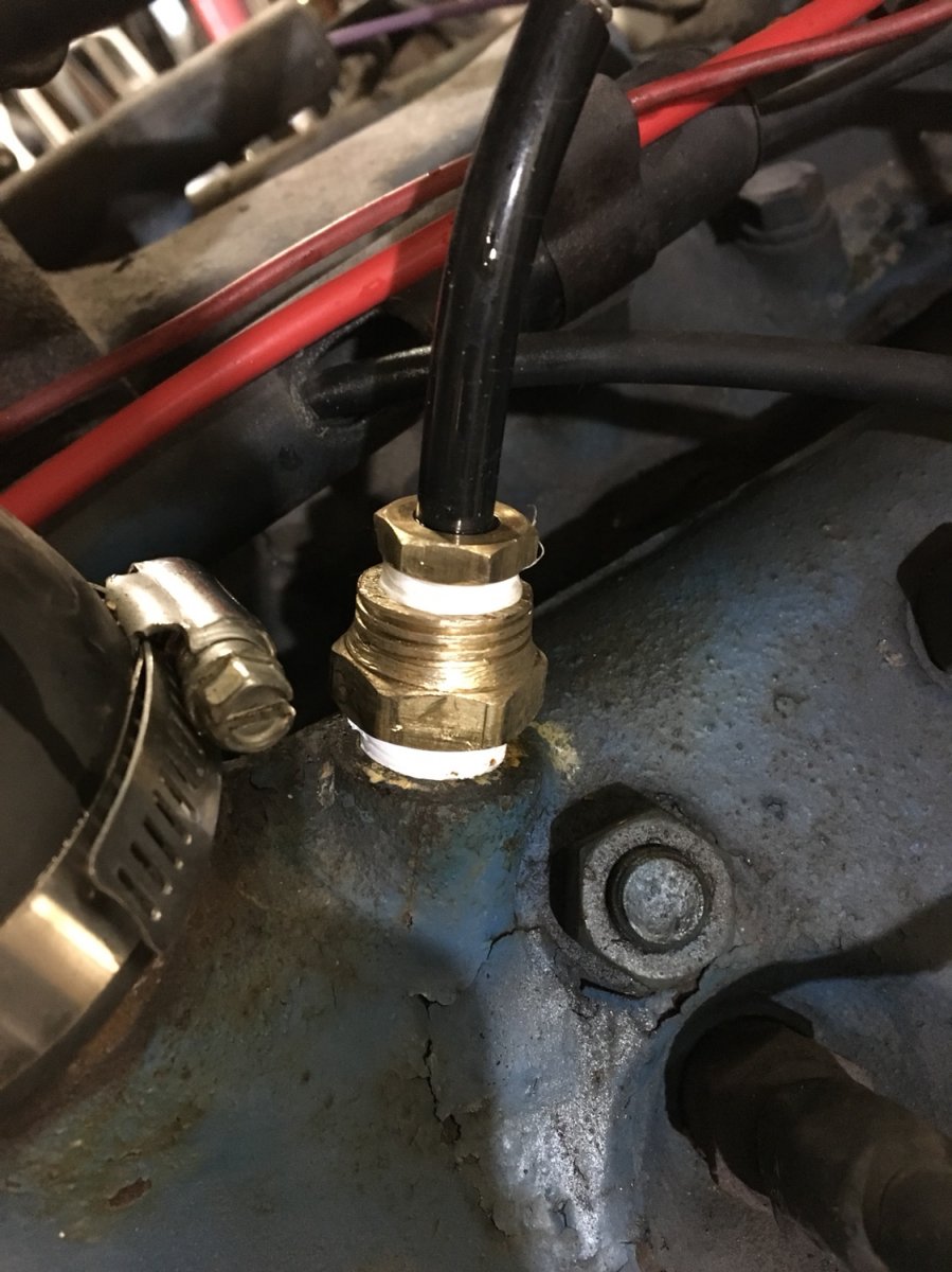

    Morning folks, little update. I’ve been busy doing lots of things, but not much that looks impressive. Things like wiring and running lines... but I did make an adapter for my manual temp gauge for the 59a heads!
    If any of you are familiar (it was new to me) with the 59AB heads, then you know they have an electric sending unit and there isn’t a shoulder to seat a mechanical temp sender. Apparently there is a fitting specially made to make this work, but no one seems to have them. I started bay trying to use an old sender and modifying, but when that didn’t work I found that a plumbing fitting just needed some persuasion to work.

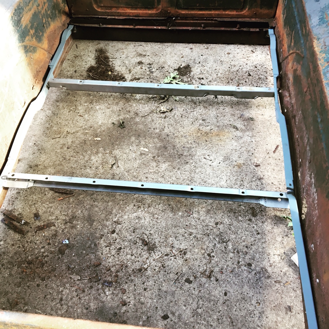

    Also did some work so I can mount the bed.

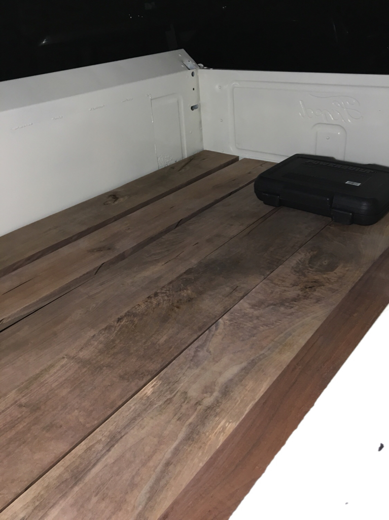

    Update with pics! Got some exhaust ran last night. Right side was easy, left not as much. It’s not quite as straight as I’d intended, must have moved finish welding it when I had it out, but it’s in! Which is important.
    Also got my bed wood cut and ready to install, just waiting on some mounting strips that hopefully show up today. It’s black walnut that I locally sourced, and I plan on finishing it with some linseed oil so it’s easy to repair when it gets scratched inevitably.

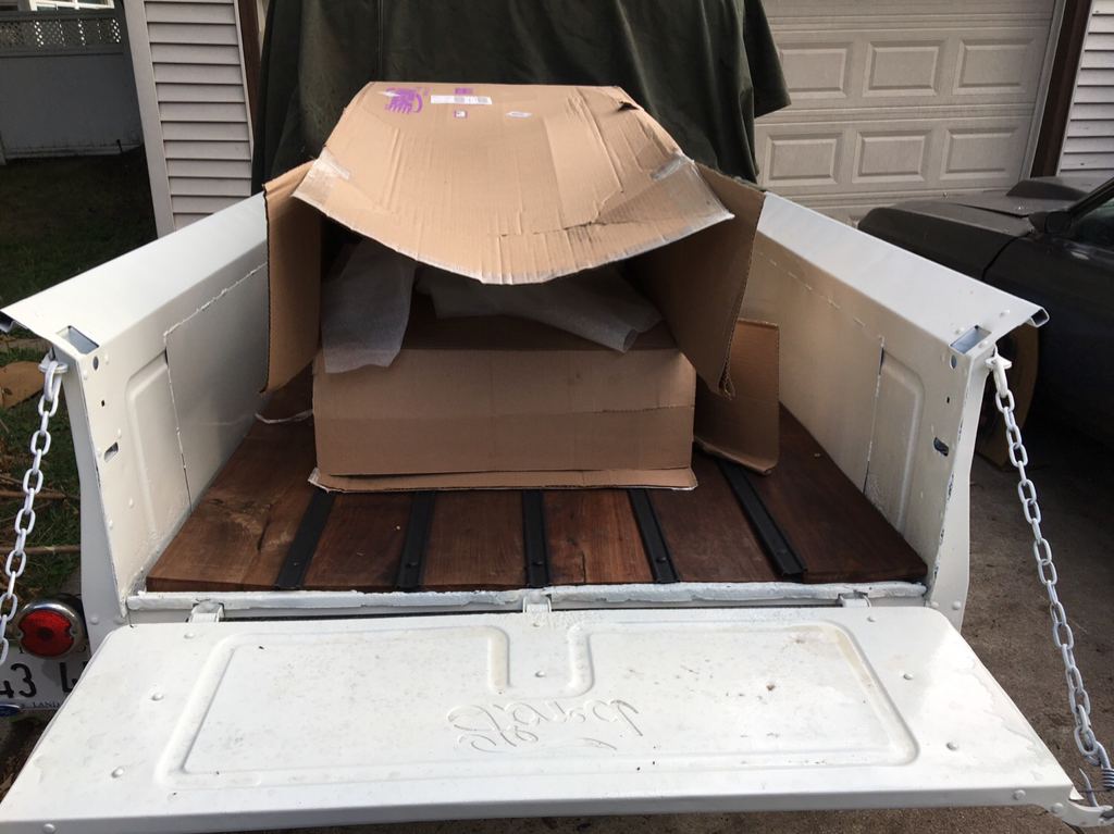

    Update! With pics even.
    Went to NC last Saturday to pick up some sheet metal. Guy had a bunch of 35-37 trucks he parted out over the years. Not much left, but I got a pair of fenders that needed less work than mine for a good price, and a few other odds and ends that will help, namely a trans cover. I got all that prepped and primed this weekend, paint today or tomorrow.
    [​IMG][​IMG]
    Not show worthy, but good enough for Alaska. I also got the bed wood oiled and partially installed. I’m running thicker wood than most must be, because the steel runner bolt kit bolts were way too short! But I got her figured and just need to get under it to install washers and nuts.
    Found an old lead repair in one of the fenders where they all crack, but forgot to get pics. It’s always interesting seeing “original” repairs.

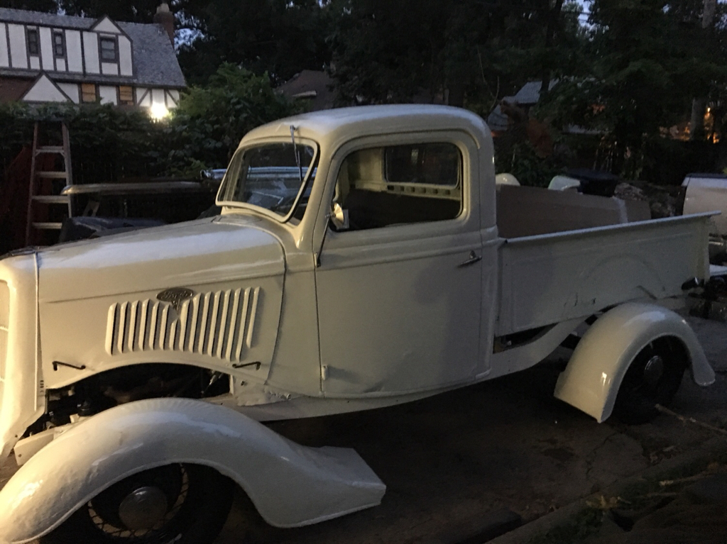

    More updates! Painted fenders and got them quasi located in the general vicinity of the truck. Mounting up today hopefully.
    Not my best work, but they’ll do for now.
    mgtstumpy likes this.
