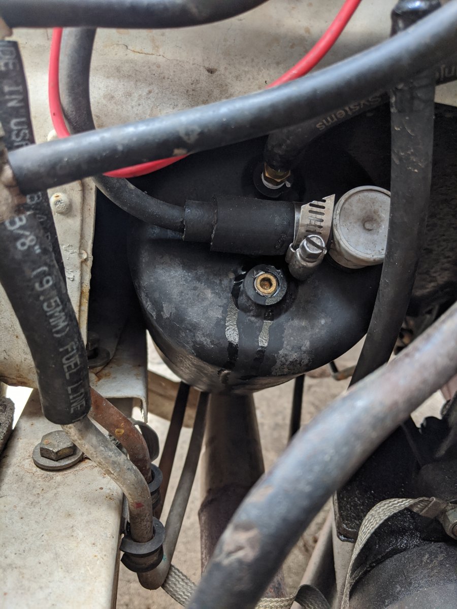

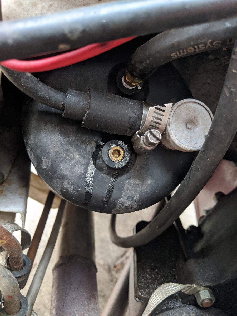

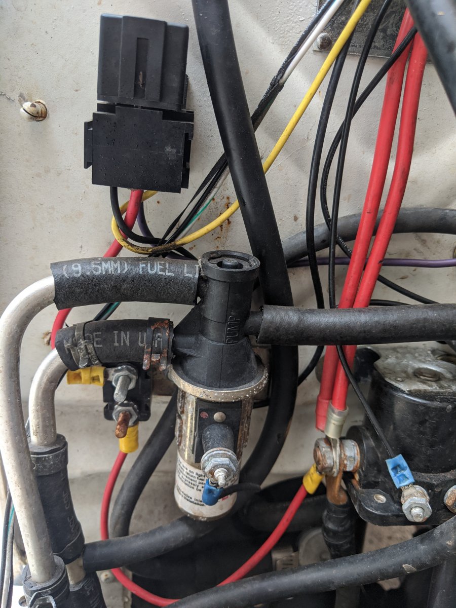

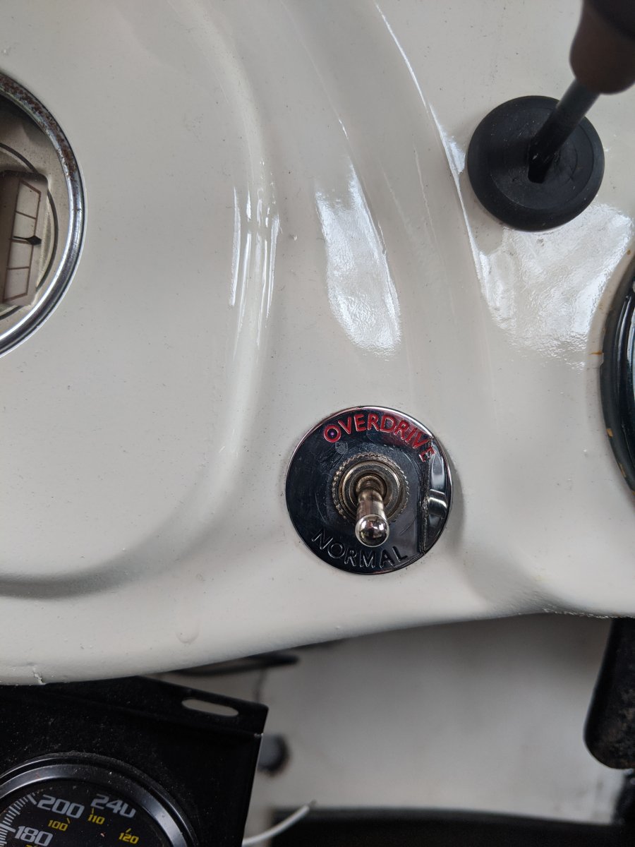

    Pardon the dirt on these, I drive the old gal every chance I get.
    I used an overdrive escutcheon from an MG for the electric toggle switch on the dash. This actuates the vacuum switch for on/off.
    Speedometer rectifier (not really sure what this is called, I call it a rectifier because that's what it does in my mind...), also vacuum driven off the same switch.
    Here's the vacuum switch. It's a generic fuel tank selector valve that's used as a replacement in motor homes and Ford trucks with dual tanks.
    This is a vacuum reservoir that helps with faster shifting. The actuator under the bed is pretty big, so having some extra volume helps quite a bit.

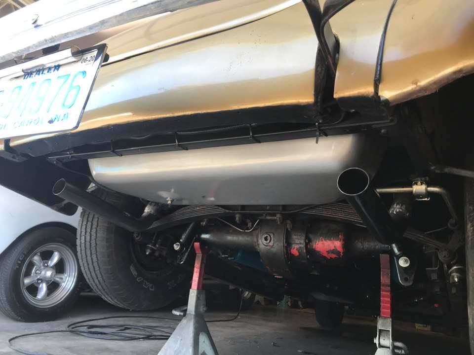

    Underside - I rebuilt this whole thing, came out of a '46 something or other, probably Lincoln. Had been sitting under a house in Tennessee for decades, so I had to replace the axles due to corrosion, and one of the spring hangers was rusted beyond salvage, so I modified the whole thing to use '35/36 radius rods. Had to widen the gap on the radius rod mounting points a bit, but nothing a cut-off wheel and welder couldn't fix. I believe I had to move them 3/8" further apart, so my wheelbase is now roughly 3/16" narrower in case anyone's doing the math.
    Better shot of the actuator in the rear. I'd really like to change this to manual at some point, just because I like the idea, but realistically this hasn't given me any problems. I probably have 5,000+ miles on it at this point with no complaints.

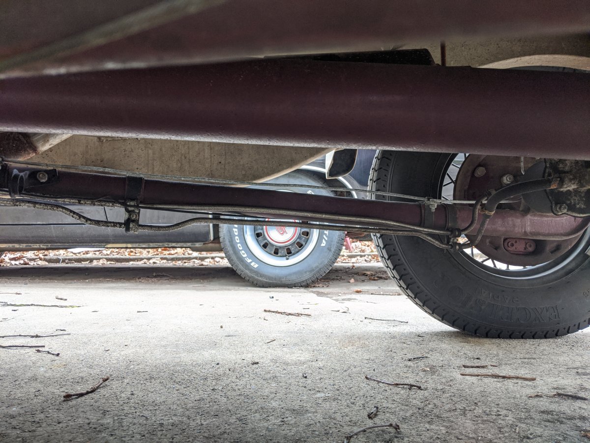

    This last one shows how I routed the lines. I fabbed up some band clamps to go around the radius rods, using some 1/8" rubber as a buffer material, all so I didn't have to drill holes in the rods. I liked the look when done too. Man do I need to clean this thing...
    There you go @MIKE STEWART - that's the whole setup!
