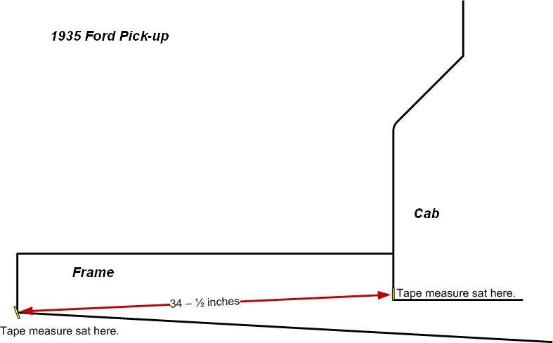

    I took several measurements that I thought would help you. Let me know if there is one you need that is not here. Just remember my grill, radiator etc have all been off in the past so the measurements may not be to factory specs LOL
    First measurement is from the bottom of the cowl (hangs over frame) to the frame end at the bottom.
    This one is shows from the center of the cowl to the lower edge of the radiator at the shell.
    This one is from the center of the radiator bolt to the center of the motor mount
    From the top of the frame rail down to the bottom of the radiator leg where the bolt goes through ...
    This shows the frame end to the radiator bolt center ....
    Here is from the front edge of the radiator to the grill ... about 4-3/4 inches EDIT DUH! IGNORE THIS ONE HA
    This one shows from the cowl edge to the first hole. I see the hole in your photo ... mine is taken from the driver side.
    Here is from the top of the frame going up the cowl (metal you show in your pic) to the rivets in mine ...
    These next photos show measurements from the bottom of the cab back to where the kick up starts on the frame. Ignore the running board as it is not 35 ford. Measurements are from the bottom inner corner of the cab corner where it begins to turn up beside the frame. (forgot this picture)
    this one is from the dust cover bolt on to straight across to the cab. Note mine is bent slightly.
    From the cab corner to two holes in my frame just befroe the bed starts .. you may not have these?
    This should keep you busy for a while!

  10. Steel 35
    Joined: Oct 31, 2010
    Posts: 31
    Steel 35
    The measurement from mount to support is not straight forward because there is a height change and I hope it is given in Wescotts pages. The cab height in that location to the original frame is easy if you still want it.
  11. Boryca
    Joined: Jul 18, 2011
    Posts: 716
    Boryca
    from Detroit
    Steel - I'll take all the measurements I can get! I did notice the height change on that radiator support, and from Damon's measurements it appears to be about an inch and a half different.
    Thanks,
    Mike

  13. Steel 35
    Posts: 31
    Steel 35
    I looked again through polyfrieds pictures and there is one but here is mine as well.
