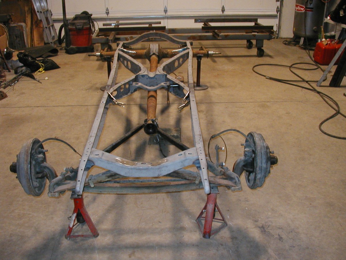

  7. This may be sorta what your looking for. It's not a lot of work to make it fit the A rails. I bolted in the 39 pedal unit, no problem. To get location right I got it to the point of everything in place prior to welding it to the Rails. Sat my body on over everything then slid the X member so that my pedals were in the right place in the Toe Board. I also took a vertical cut right behind the center section to raise it up and loose some of the arc built into that section to help with several things. Then I had to modify the saddle to give the T.T. clearance. Other than Time it's a walk in the Park.
    P.S. I have posted these photos at least 20 times over the years. I'm surprised no one seems to find them using the Search menu.

    thanks for the responses. Mr pist n broke, yes i have seen your pics many times in all the threads i find searching. nice job for sure. you mention you cut the rear legs to flatten out the curve, not the front too to keep the center section all flat and inline? and also, surprised that the torque tube tunnel needed mods, as thats another reason to go with the idea in the first place, that is, you get pedal mounts, trans mounts, and tube tunnel if all locations can be used as is
  9. I wanted the Top of the X legs parallel to the top of the Model A rails. This created some interference, I cured that. If you've read or seen much of my stuff than you know I have a disclaimer in that "I don't think like Normal people". I don't buy Kits and I can't follow Instructions so I tend to just do things that work for what I need. So far So good. I also won't have an Oil Pan hanging below the I Beam, That was part of why I raised the center of X member. I also had a specific place I wanted my Exhaust to be when done being my Channeled Roadster will also be full fendered. It ended up being a big Math issue to work through. I think I got there. The Jury is still out.
    rusty valley likes this.
  10. Just to be clear I did not cut the rear legs off. I took a cut out of the bottom flange and sliced up to the bottom of the top flange. If you look close right behind the center saddle where it's flange is on the bottom flange you will notice a line into the center of the first big hole. That's where I raised the center up and welded it back together. This is in the Bottom photo of the three I posted. It's really not as confusing as it may sound. Hope this helps ya.
