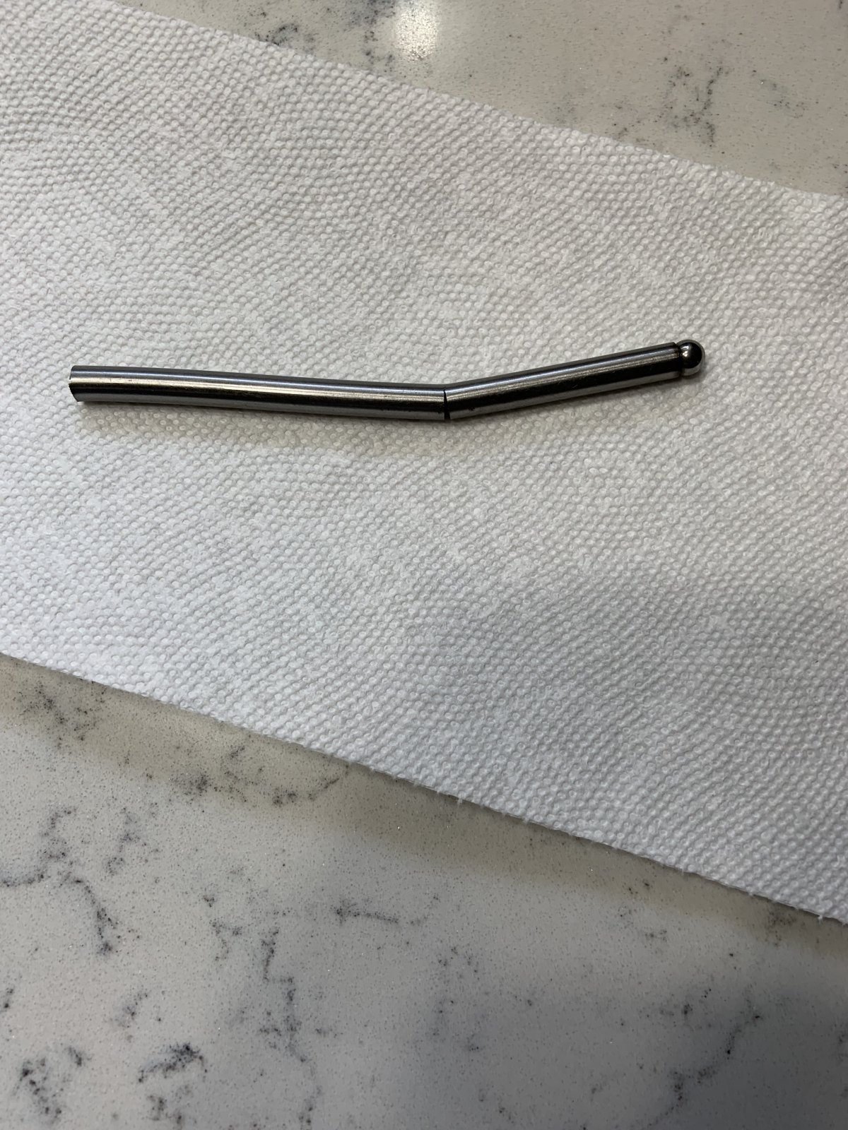

    Thanks for the part numbers. Went up to Clark County Speed to see my buddy @oj, picked up the pushrods. Got a magnetic probe at Harbor Freight and was able pull out the pushrod. But as you can see the ball broke off and it could have gone anywhere it’s so small. I guess I’ll have to pull the intake anyway. It might be in the pan but who knows !

    Nothing came out of the drain plug, not surprising. Pulled the intake, found it down next to the dizzy drive shaft. Using two magnetic probes and my wife waiting to grab it. I was able to lift it out. Yay !!
    It would have done damage as it was riding on ghe dizzy shaft. Consider my self lucky

    Distributor shaft down where it engages with the drive( the forked shaft). It was resting against the distributor shaft, would have ground up slowly.

    The tip of the valve looks to be a little banged up, try to dress up those edges. Also look at the rocker arm, those cylinder heads use “guided” rockers, there are ribs on the rockers to hold it inline with the valve stem. If it’s chewed up you might consider replacing it.

    Sorry it the mounting bolts on the inside of the valve cover the the breather goes on. No bracket, just the bolt head hit the rocker and I think locked it up somehow

    I think it was riding against the distributor shaft cause it has witness marks on the side near the end.
    Whatever happened, it’s out now :)
