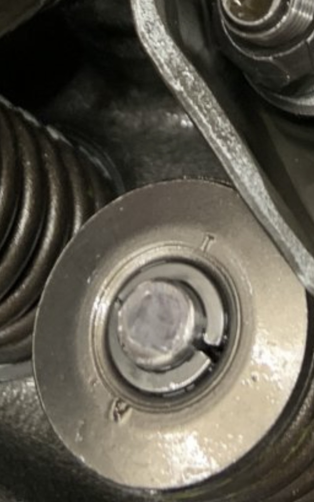

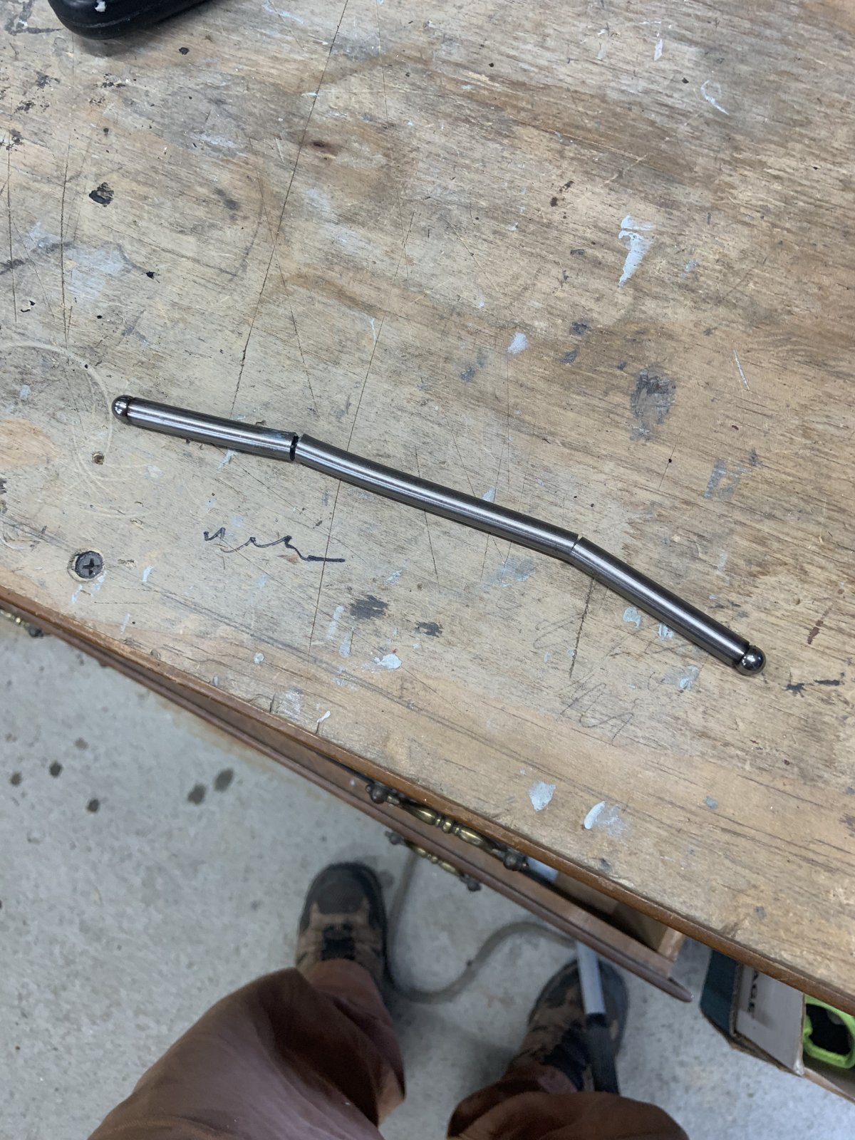

    Thats a lot of abuse, since the intake is off how about pulling the lifter for a looksee at it and the cam lobe. Odd that the pushrod broke and in more than 1 place. All this from a screw holding a breather, is it a stamped steel cover that would flex or a cast aluminum thats more rigid?

    Thanks Oj, it’s aluminum cast. Changing all the pushrods with ones I got from you. Don’t trust them now. I’ll take a look at the cam too ;)

    That push rod looks like it has been through a garbage disposal. Stuck valve?

    Update, pulled the lifter, looks fine. Looked with a flashlight at the cam, it looked fine as well. Dressed the end of the valve as well. Intake is reinstalled, torqued. Thanks everyone for your advice, pretty straightforward from here :)

    I was thinking the same thing. Have seen plenty of bent pushrods, but have not seen one snap like that in two places. Looks like a brittle failure. I guess those pushrods are hardened and perhaps not tempered as much as the ones I use.

    Yeah Harv ! That’s why I replaced all of them.

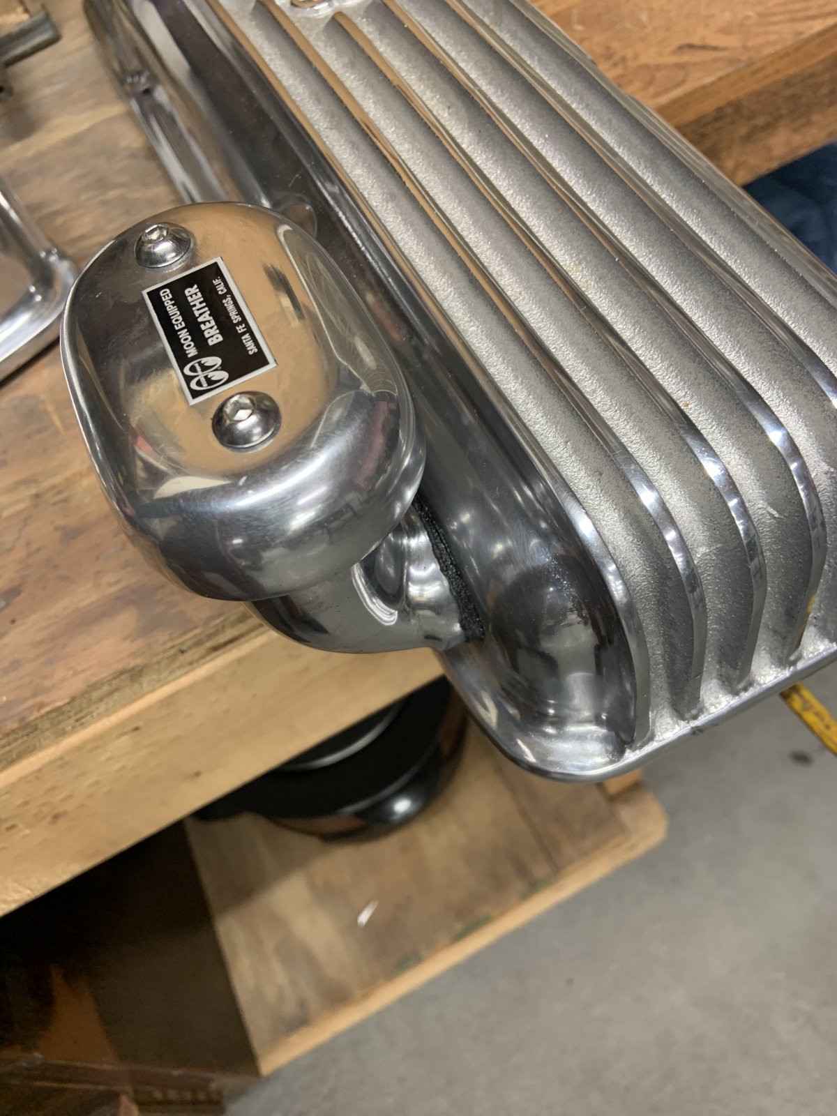

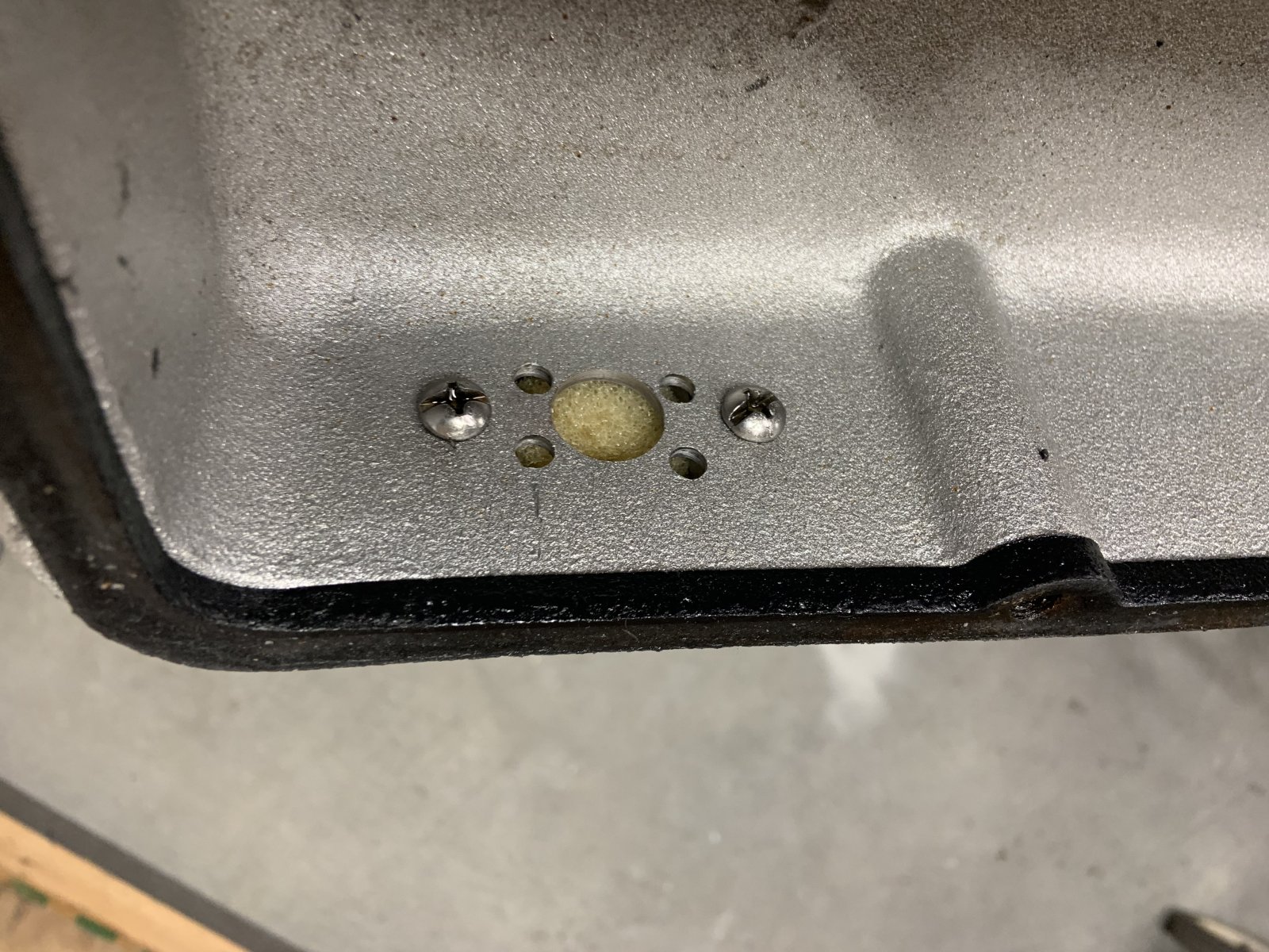

    Don’t think I mentioned a bracket, but it was the head of the machine screw holding the breather. C4126A9E-08C3-4D08-BAC6-E27F5C37B0EA.jpeg 6E055154-5B89-4A64-A1C3-6A372EE4B7F9.jpeg

    Bad luck, or thought there was enough clearance. A flat head machine screw with and sunken Allen head would have made it I guess.

    I was fixing something that wasn’t broken, there was really no need for the lock washer I added over the winter that pushed the head into harms way. It wasn’t even loose !! :rolleyes:
