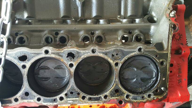

    Also I should add, car was getting hot. Water jackets all junked up. Radiator needs rodded to be safe.
  25. Jason147
    Joined: Nov 5, 2014
    Posts: 138
    Jason147
    Block

    If you keep pistons, looks like they are 8.5:1 with 76 cc head so don't go wild on cam. 64cc heads give you 9.7 which is pushing it on pump gas.

  29. Mannnn that's a lot of carbon for 7,000 miles. I've got one here with well over 100 and no where near that carbon.
    The 624 heads are junk. The vortec heads and their small Cc combustion chambers on the dished pistons will work quite well.
    The vortec engines have about 9.4:1 stock and run just fine on that cheap blend of corn and camel piss. You'll not see 9.7 with 64cc unless there is flat top piston. Even that shouldn't be a problem for pump gas with tight quench at 0.040.
    The detonation problem comes on strong with the 0.010 short rebuilder pistons designed for zero decked blocks running in a non decked block and 0.040 head gasket. That stacks up to a 0.070 or more quench. The slightest bit of compression and it will detonate. The big quench is mul***udes more conducive to detonation than a bump in compression.
    I'm running 10.4 on 91 pump gas without any trouble. I might try 89 too see how it does. Its a bit smaller bore though with steel shim head gaskets.
