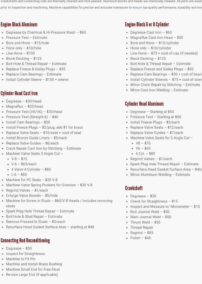

    Machine shop prices

    Prices at that machine shop are cheaper than I am, so I'd say pretty decent prices.

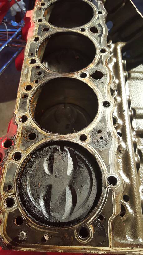

    Time to pull pistons. Check out water jackets

    Water jackets don't look all that bad to me. Looks like the engine had steel shim head gaskets.
