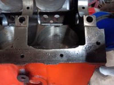

    I just bought a 350 when I tore it down I found that there was a piece broke off on the bottom of one of the cylinders. I was wondering if this is going to affect being bored and rebuilt?

    Looks pretty thin to me …. If your planning on a bore I’d have the shop sonic test for thickness….may be a coreshift block. Has it been bored before ?

    I would be just as interested in what looks like some fairly deep pits further up the bore. Cavitation damage perhaps, or just debris and a weird camera angle playing with shadows? Probably looking at a sleeve in that hole either way.

    Won't hurt a thing , dress the possible sharp edges with a die grinder , you'll be fine

    yup, I've run a block like that...
    And I think the other stuff in the bores is just dirt/debrish that hasn't been wiped off.

    Yup, I have clearanced Harley cylinders that much for stroker wheels.

    a reminder to be careful when dis***embling a motor.....last guy likely tried to drive a rod/piston out without noticing it was hung up on the bore....

    Like others said ,
    Round off , Carbide / file .
    Check for crack ,if Non build it
