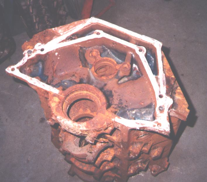

  24. Flat Ernie
    Joined: Jun 5, 2002
    Posts: 8,406
    Flat Ernie
    Tech Editor
    Accuracy not important here, eh? Already corrected - only FE had split head.
    The 351C uses the same bellhousing as the SBF - measurement between top two bolts is around 5" (and a little bit). The 351M uses the same bellhousing as 429/460 and the measurement is around 7" (and a little bit).
  25. George
    Joined: Jan 1, 2005
    Posts: 8,062
    George
    Some '73 400s (same block as 351M) had the SBF bell pattern.

  27. hotroddon
    Joined: Sep 22, 2007
    Posts: 28,240
    hotroddon
    that is true, there were some ******* 400M's in 1973. Tall deck 400M block mated to FMX trans with casting number D3AE. Sometimes refered to as the 400FMX. Pretty rare
  28. Flat Ernie
    Joined: Jun 5, 2002
    Posts: 8,406
    Flat Ernie
    Tech Editor
    I hate it when other people leave out info like this & here I did it myself!! :D Yep, they exist - never seen one in the flesh & to my knowledge, they were all 400s, not 351M, but here's a pic (stolen from the HAMB somewhere):
    They are rare...
  29. hotroddon
    Posts: 28,240
    hotroddon
    Yep, all 400's cuz the 351M didn't come out until 75 and those were 73 only
