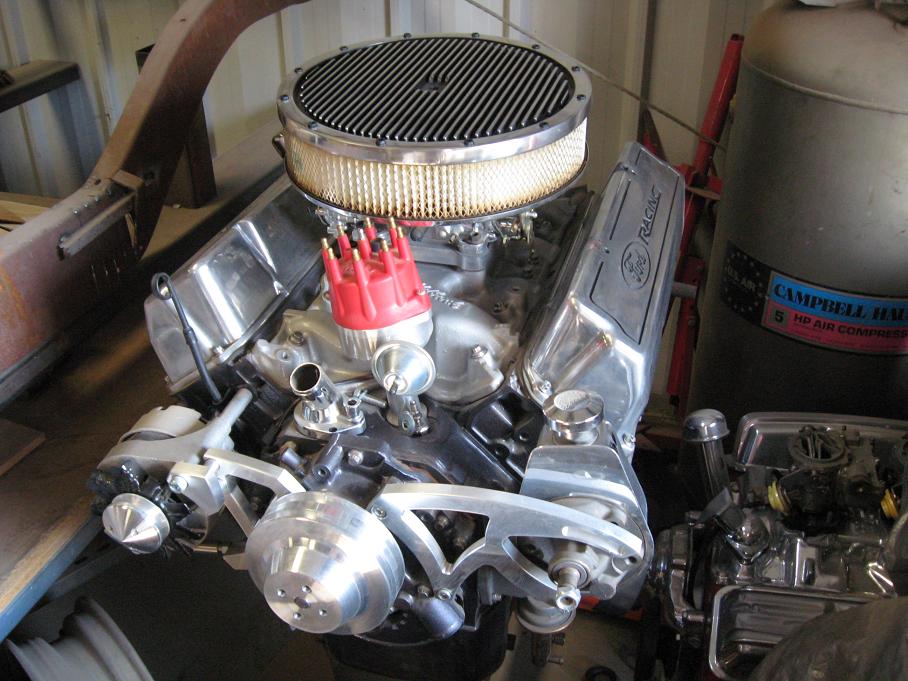

  21. HEMI32
    Joined: Sep 6, 2006
    Posts: 8,699
    HEMI32
    I'm with George ...
    Here's some pics of the 351C4V that was destined for our '32 Ford Roadster (with a full hood):

  23. Flat Ernie
    Joined: Jun 5, 2002
    Posts: 8,406
    Flat Ernie
    Tech Editor
    Yes, but that's a 351W. :D

  27. HEMI32
    Joined: Sep 6, 2006
    Posts: 8,699
    HEMI32
    Yeah ... I know it's a Windsor (the Cleveland didn't come out until 1970) ... sorry for going O/T ... I only posted the pics of the '69 Shelby GT350 cuz' back in post #4, AnimalAin suggested going with a 351W.
