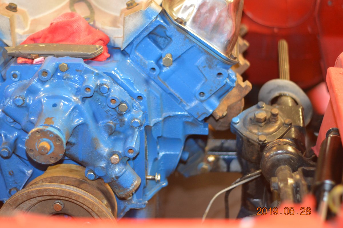

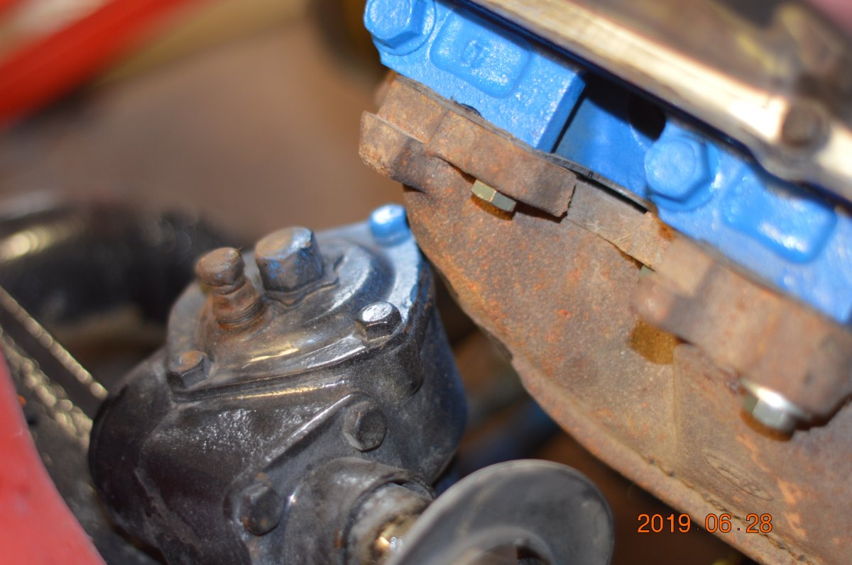

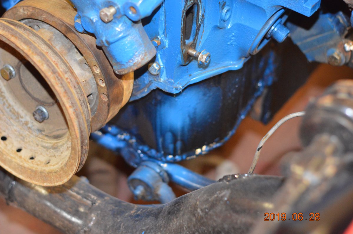

  25. birdman1
    Joined: Dec 6, 2012
    Posts: 1,683
    birdman1
    got the engine and c4 mounted on the ch***is, then sat the body back on the ch***is last week. 3 days to get all the body mount bolts and ruber cushions in. The oil pan was a lot to build, but was the cheep way out for me. The oil pan to drag-link clearance is all of 3/4". the heads are 1/2" from hitting the firewall. I used a stock cleveland right hand exhaust manifold and it clears fine. the left manifold will not work. I think a pickup or van with the 351m-400 may be what it needs. DSC_0050.JPG DSC_0039.JPG DSC_0041.JPG DSC_0040.JPG DSC_0044.JPG DSC_0043.JPG DSC_0050.JPG DSC_0039.JPG DSC_0041.JPG DSC_0040.JPG DSC_0044.JPG DSC_0043.JPG DSC_0050.JPG DSC_0039.JPG DSC_0041.JPG

    There was, years ago, a resto shop in Houston Texas than put a lot of 351's in the early birds, I don't recall what manifolds they used but it has been done a lot. Try Ford Barn, might be some help there. Does the pan hit when you turn the wheels lock to lock? Can you raise the engine to get some manifold clearance?

    Take a bit off the steering box cover with a die grinder and use RTV sealant instead of a gasket.
    The engine will torque away from the steering box anyway.

  30. birdman1
    Joined: Dec 6, 2012
    Posts: 1,683
    birdman1
    the cleveland has 2 barrel heads(all I had) flat top pistons, and a fairly hot hydraulic cam..560" lift, 235*. hope it works with the stock converter. I will do some more grinding at the gearbox. i can't raise the engine because trans is hitting floor now. and i don't want to move it ahead so grinding is only alternative. Have not checked pan clearance at full turn yet. thanks for the idea. I sure want to drive it this summer!
