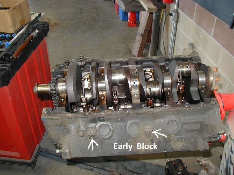

  9. HOT40ROD
    Joined: Jun 16, 2006
    Posts: 961
    HOT40ROD
    from Easton, Pa
    Some of the early M engine have the same mount as the Cleveland. The other have a 3 bolt mount.
    Look at the side of the block if there are two bosses sticking straight down you have the early engine. 302 w/35 cleveland style. If there is one bolt hole high on the block and two down near the pan then it is the later style block. On the later block pictures the #1 are the motor mount bolts
    If you have the early block the 351 C mounts will work
