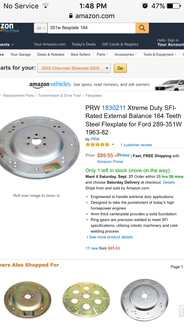

    Supposedly the 164 tooth for C4 Trans with 28 imbalance will work. I ordered this one, we will see.

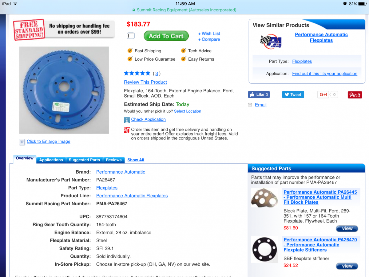

    Did some looking and I've seen a PERFORMANCE AUTOMATIC part# 26467 come up a couple places. Summit has it for almost $185. Description from CJ Pony Parts reads "1965 to 1980 28 oz balance 289/302/351w mustang with an AOD transmission." But they sell it for a few bucks more. It sounds right, but I have no personal knowledge of this company, or part.

  10. If you go to Summit Racing and do a search for Ford flexplates, when you use the various 'filters' i.e. select Ford/Windsor/351/28 oz/AOD trans, four flexplates come up. These ARE NOT the same as the 'generic' C4/C6 flexplates (and cost more) so there is obviously something different about them. And even these have some 'notes' on them about torque convertors, so you really need to know what convertor you have specifically...

  16. Ordered this one too.
    Soon I'll have them both in my hands and compare.

  17. Here's the update and closing.
    The performance automatic 26467 is the correct flex plate if you need a AOD Trans to a 351w.
    Yep it's 185.00
    It matched up in every way and when installed solved the problem.
    When compared to the other one (prw) I ordered from Amazon,,,,
    it's 164 tooth 28 ounce for C4
    First off, the plate is stamped from thicker material, almost 2 times so it was considerably heavier.
    The offset of the two, the Prw was almost 1/8 less- so that would move the converter closer to the crank, but the thickness difference would move the converter bacteria towards the Trans. Finishes out that the converter is very slightly more towards the crank.
    All of The bolt holes in the PRW would need to be opened up a few thousandths so the crank bolts and converter studs would go thru.
    The oval holes were not present, you'd only need to cut one hole for the converter drain plug clearance but you'd need 3 more holes to maintain the balance equilibrium.
    So I'd say that particular version of a C4 plate was not the same as a AOD.
