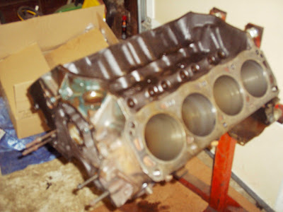

    I have a 1977 351w and want to build this for low RPM torque and I want dual quads on a tunnel ram (just because). What would be a good choice for pistons, cam, ect.. Any Ideas??
    Im taking it to the machine shop for a hot dip and a bore, Im not doing the bore untill I have an idea which way to go.
