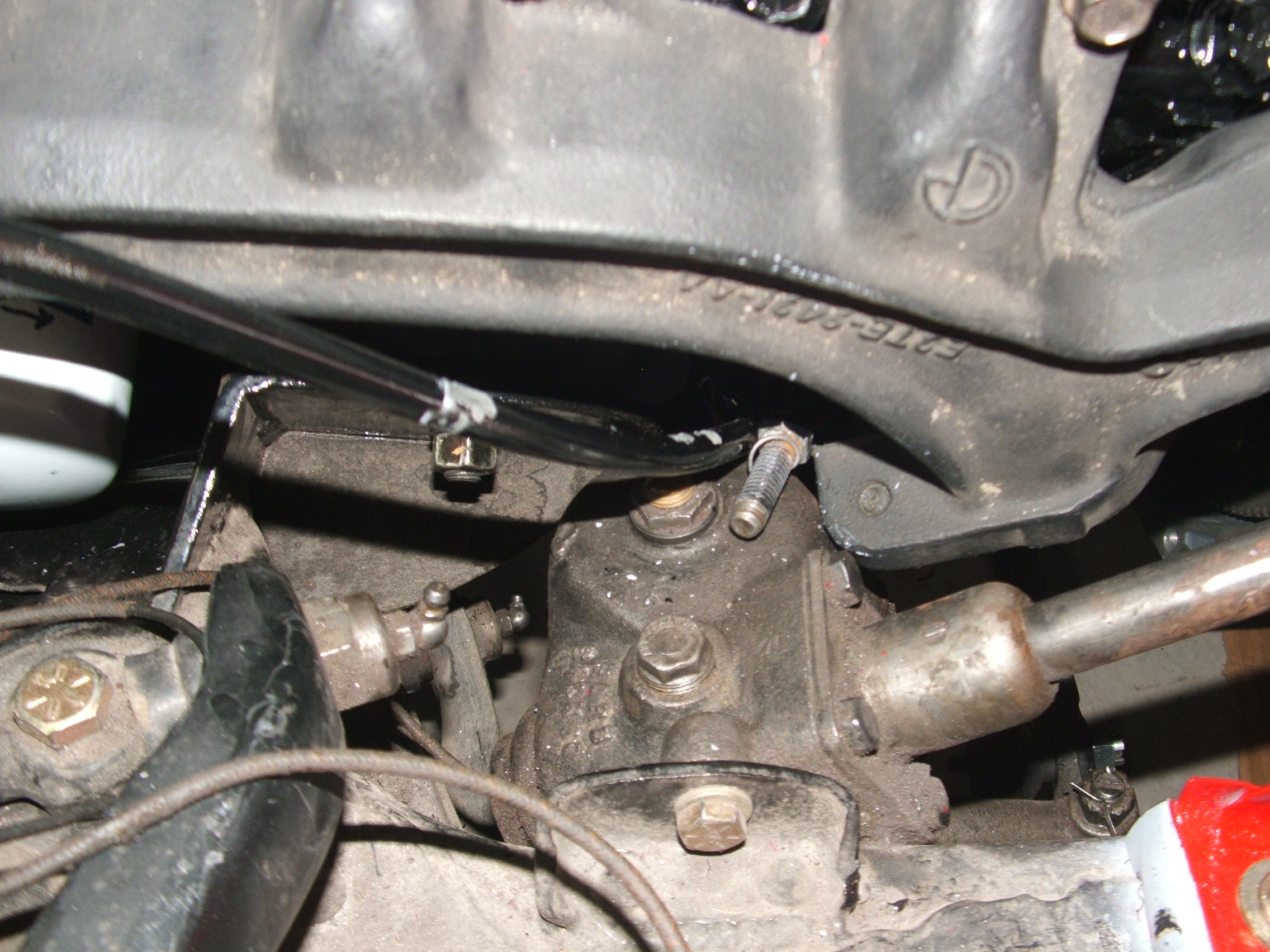

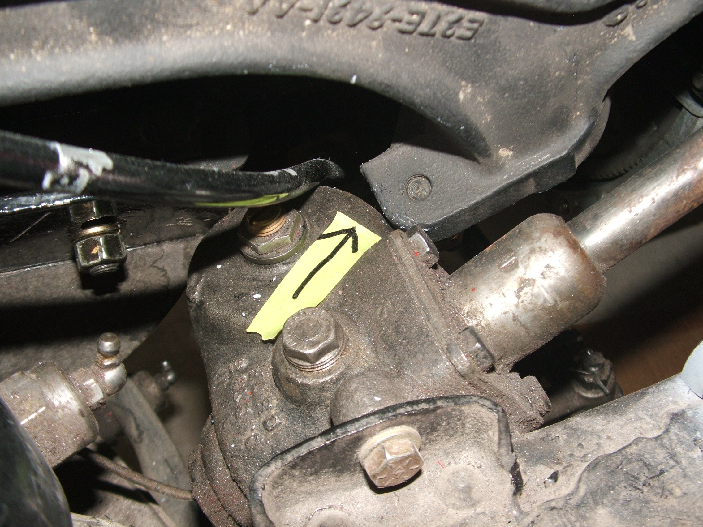

  14. Fat47
    Joined: Nov 10, 2007
    Posts: 1,600
    Fat47
    Pist-n-Broke: Here are a couple of pictures of the clearance problem between the steering box and the exhaust manifold. While it doesn't look it, there is about a 1/16 of an inch between the two. I can grind down the manifold between the steering box and the bolt that holds the exhaust pipe about 3/8 of an inch which would give me a quarter inch total gap. The engine shouldn't rock from front to back but will side to side. I think the gap should be enough. Opinions welcome.
    osage orange likes this.
  15. I wouldn't be afraid to remove some material in that spot. If I remember right that manifold is extra thick at the head flange. You could also remove .100 there and draw the manifold closer to the block without any issues to the manifold. Something else I'd do if heat on the box is an issue. Remove the actual gear lube in the steering box and pack it with John Deere Cornhead grease instead. It withstands heat better than gear lube. If you try different manifolds to move the outlet forward the stock spin on filter will be an issue as is. Are you aware of this stock Ford item? It lets you move the filter from strait out to horizontal.
  16. Yep, grind on that puppy. Take another 1/8" angle cut off that corner and you should be fine. That's the truck manifold I mentioned to look for, it's been a long time but the early '70s full-size car manifold might offer a bit more room but would probably be pretty hard to find these days. I used the car manifolds for a 351W into a '56 sedan, had all kinds of room.
    osage orange and Pist-n-Broke like this.
