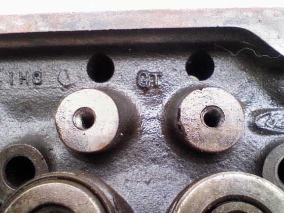

    So I say, bolt those on and enjoy them... I have a set in my garage... If you want, I could post pictures of one after I have my coffee... Just let me know!! :)

    Here we go..... The combustion chamber volume on these heads are around 65cc... Intake valve dia. is 1.84" same a chevy 305 4-bbl head.. Exhaust valve dia. is 1.54".. Intake ports are way bigger than a standard 302 head.. The exhaust ports are oval shaped on these and have no emission bumps in them to restrict exhaust flow.... These heads along with the B-303 roller cam from Ford Motorsports were the hot setup in the early '90's for a small block Ford... These GT-40 heads have "GT" casted into them for easy id... Sorry I didn't take a close up of the combustion chambers... I knew I forgot something... DOH! :(

    I also forgot to mention that these heads are as cast with no porting done to them.. I bought the bare castings new sealed in the boxes and the guy threw in the valve gear for free! Very cool! :D:D:D All I had to do was assemble them and bolt them on... Had it all done in a weekend along with a cam swap!

    Thanks guys for all the input. Thanks for the pic Deuces.
