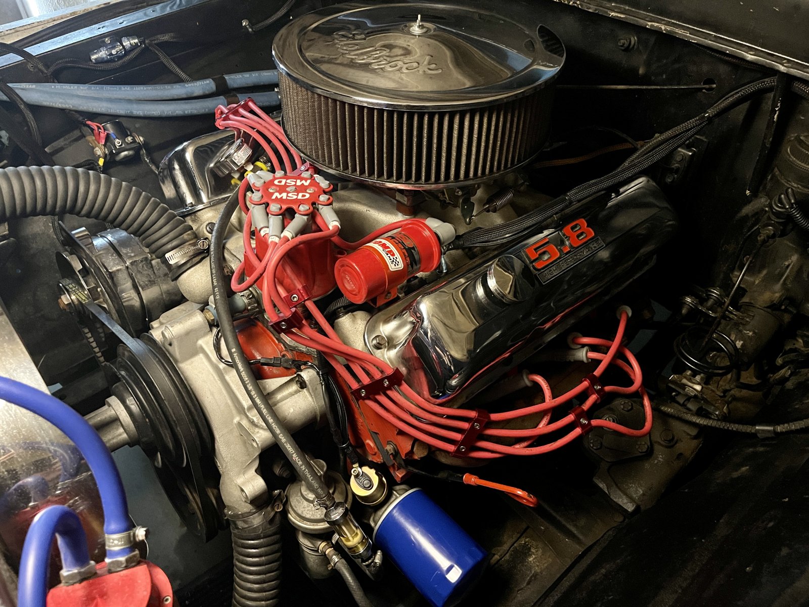

    I just rebuilt my 352FE, mild comp cam, stock heads, Edelbrock performer air and fuel, msd 6AL ignition & Distriibutor, but basically stock.
    Sold the truck, Got it back 8 months latter. Runs bad…..
    “ thanks man, it had maybe 500 miles….”
    Checked timing ground up, started fresh, remarked balancer, re-installed distributor, removed valve covers. Fired up, and wasn’t getting oil to the valves? Had a steady knock from #8 (stethoscoped it), spark plugs tells a story of flooding (black soot), compression check says 60-75psi on all pistons!?!? (Test done warm, wide open, no spark plugs) . Ignition p***ed all electric tests (box to plugs on meter). Next I camera scoped the pistons and they look like there running rich and dry on oil. My oil pressure is on gauge and checks out. Motor doesn’t run hot….. any help would be great.I’m at a loss with out pulling a 500 mile motor and gutting it. Everyone I talked to is baffled. Could it be a clog? I know the oils sensor is before the filter. Maybe a slipped bearing also? But that wouldn’t explain the other issues…. The main oiling comes from the middle bearing as I understand, those cylinders are not knocking. It seams to be just #8. It has a Rough idle and “knocks like a drunk girl at 2am on a Saturday night…..”
    Thanks for any advice, I really am not in a location I cam pull the motor…..

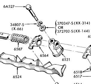

    Make sure the correct bolt is in the rocker arm ***embly. It allows oil to the rocker shafts.
  7. Jeff Norwell
    Joined: Aug 20, 2003
    Posts: 15,526
    Jeff Norwell
    MODERATOR

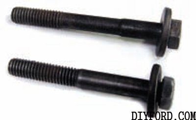

    Agreed..... these bolts can be mixed up and loss of oiling is the result..... It may not be your issue. but worth a quick look.
    FE - Rocker Shaft Hold Down Bolts - ILL.jpg FE - Rocker Shaft Hold Down Bolts.jpg

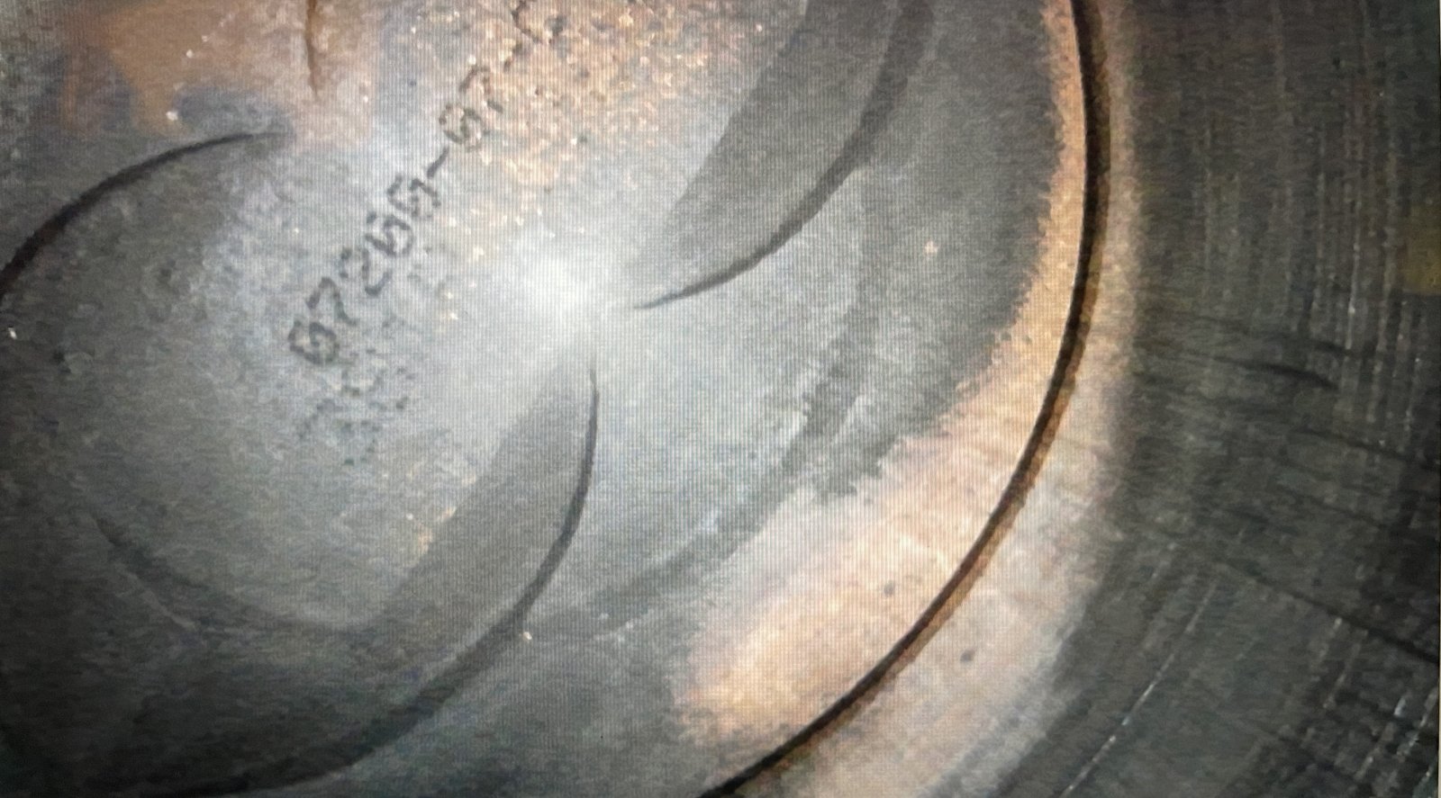

    The picture you posted shows piston scuff marks on the cylinder walls, most likely from the carb dumping fuel into the cylinders. If all the cylinders have these scuff marks, it would explain the low compression, it also means your engine is done.

    Carbon On #8 piston????? I sure would check post #7 Each bank oils from a different cam bearing

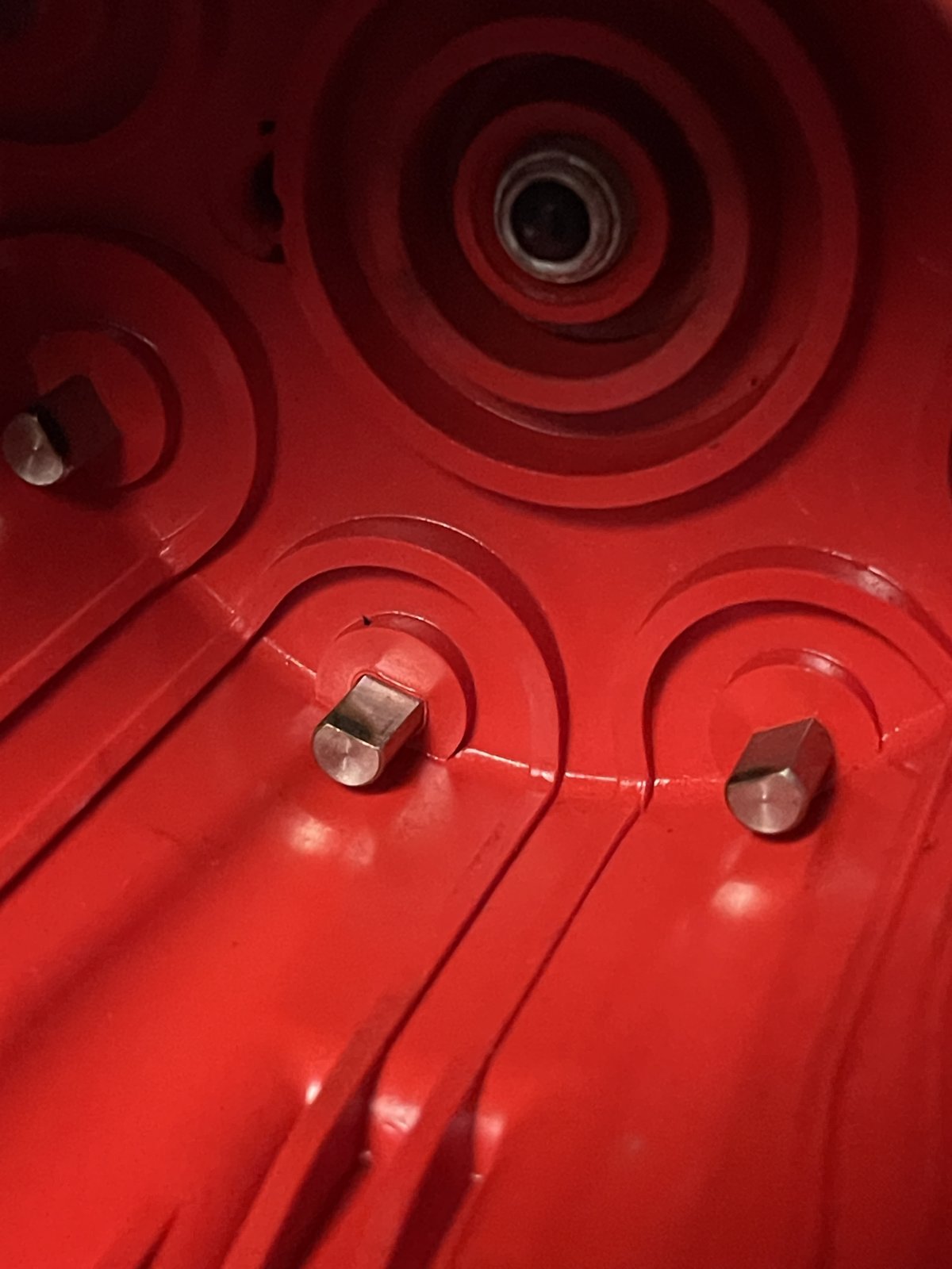

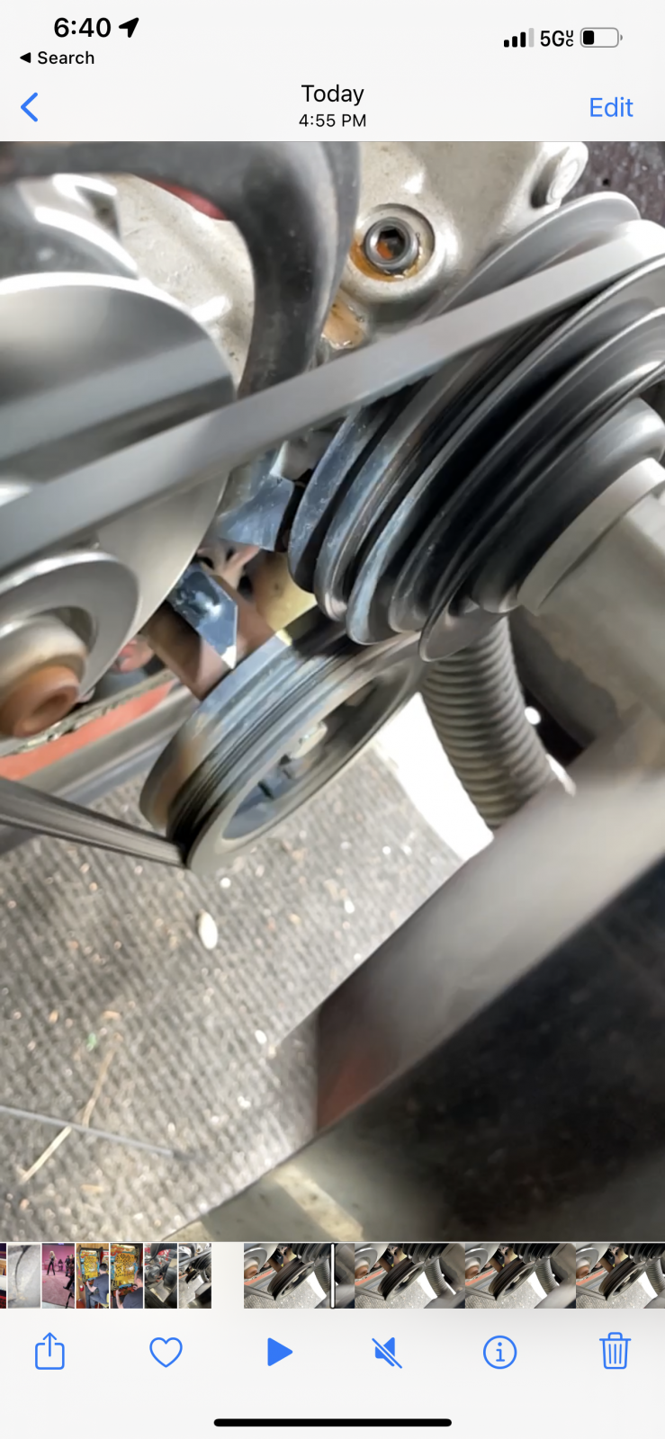

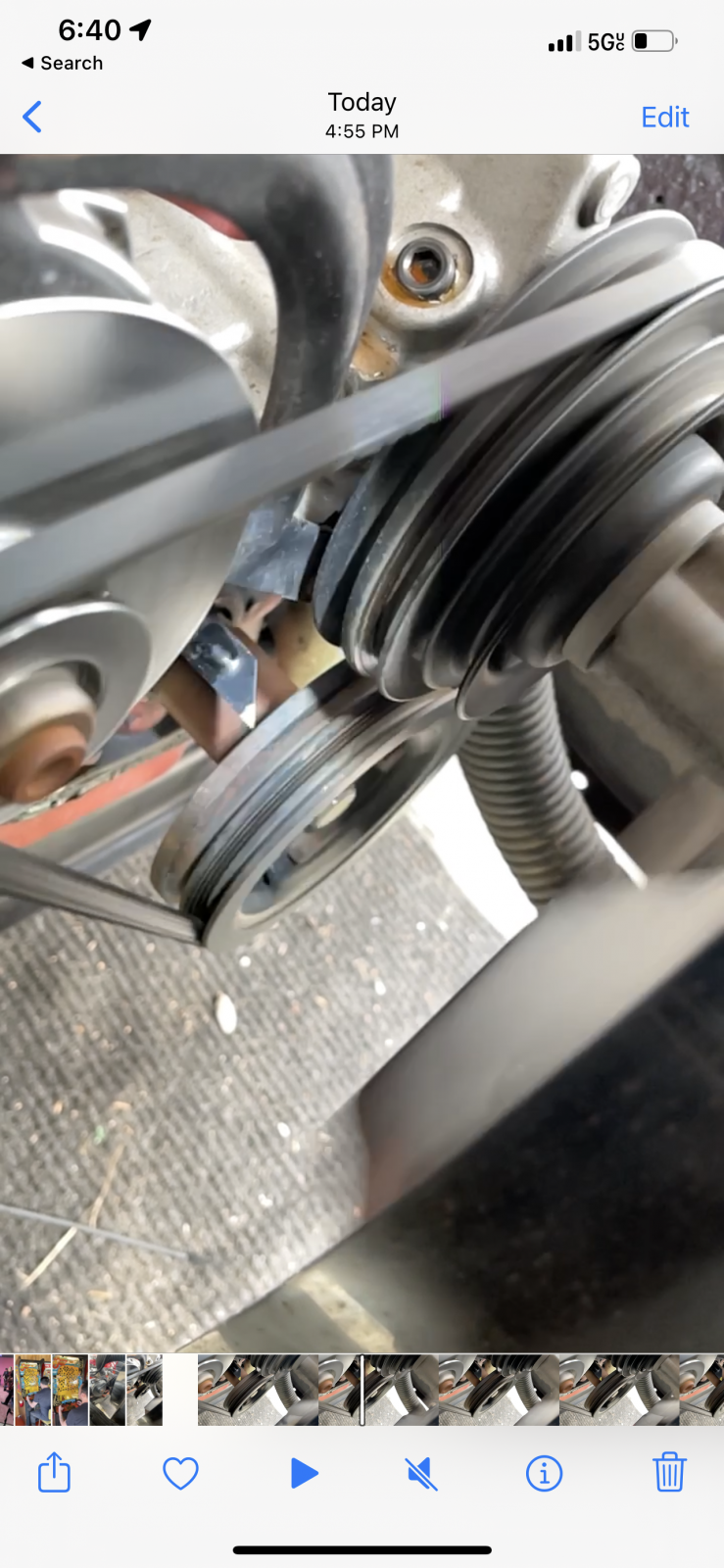

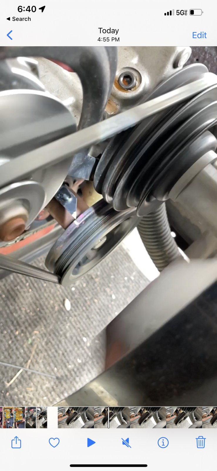

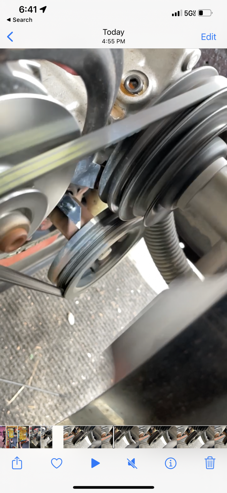

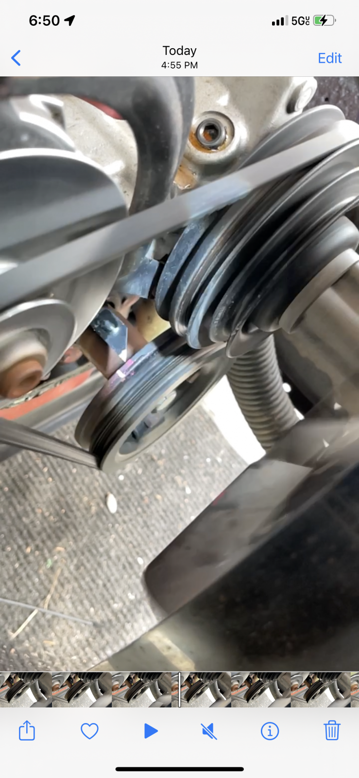

    9C1EB2EC-0801-431C-9A6E-40C6C440825B.png C470A5B7-0362-49CB-970C-265182CBDF59.png E11FC5DA-FFBE-4940-A374-96C14F7B1C91.png 598DF94C-DAA5-41B0-A944-6813F5CA409E.png 50D7B7E7-66C8-40F7-B640-B8D9A0F78014.png 9C1EB2EC-0801-431C-9A6E-40C6C440825B.png 9C1EB2EC-0801-431C-9A6E-40C6C440825B.png
    here we go kids!!
    Soaked and soft spun motor with oil in pistons over two days, pulled distributor and put it back to out of box specs (springs and limiters). Removed oil and still getting around 60psi on pressure test. Did a full re-wire and contact cleaning to confirm that wasn’t an issue. Cleaned and gapped my cold plugs to 0.35. Replaced my coil and checked it with a multi-meter.
    Put my edelbrock carb to first fire settings. Confirmed TDC with a cylinder tool to check balancer marks. Built a oil primer tool using two screw gun long tips (the ones that have a sleeve to keep screws on the tip and a 1/4” Allen tip) reversed the pump to remove clogs. Drained all oil, checked for metal and it was clean. Refilled all oils, Put everything back to TDC, add 10°. Primed the bowls, connected my MSD box and…..
    Bang! It fired…
    Rough idle, knocking still…
    Timing light shows it moving so dramatic I can barely tell where it’s at. There are moments the light and timing mark are on point or showing close to….
    I have checked everything…. Is there a chance there timing chain or msd box could be the problem?
    The fact it knocks even at idle (sounds like the #8 area)
    Is baffling. Oiling has been ruled out. I Primed motor with covers off…..
    Here are some pics from idle, fyi it is also firing (timing light) with no timing marks in sight.
    White mark is TDC 0° and The pinkish mark is 9°.
    I have video in slo-mo with timing light.
    Email me joshlinkey@mac.com and I’ll send it.
    I’m out of ideas……

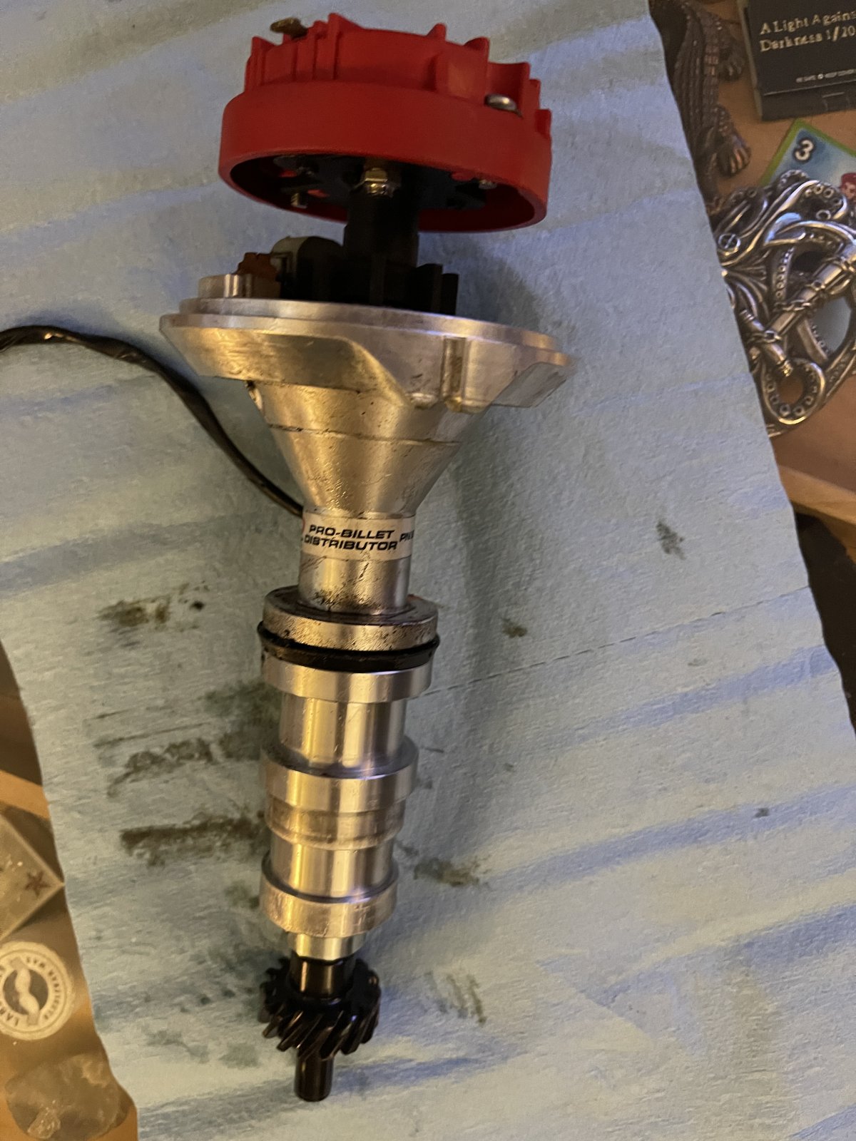

    I just pulled the distributor and I’m Gona lock out the mechanical timing just to remove another variable….
    I did notice cap points are a bit cooked…

  29. Firing order correct ? Distributor 180 out ?
    Check the distributor closely . Had a broken shaft on a 390 one time , engine would idle fine , but wouldn't rev took a long time to figuire it out .only discovered it as I pulled the distributor and happened to notice the rotor didnt turn immediately as you reversed the shaft .
