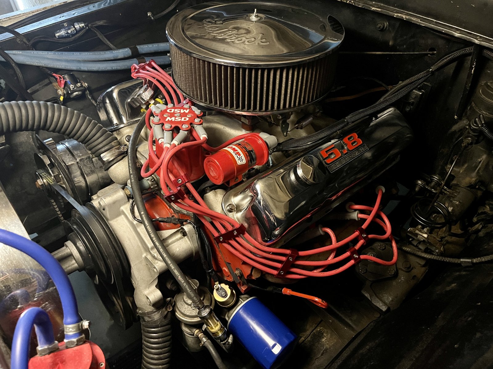

    If the magnetic pic up is bad could it be sending bad signals or is the msd box many F’d? Why would it fire with no timing marks in site? Check my photo grabs of it running… these photos where screen shots of a video while idling
    I did meter the mag pick up, cap, coil

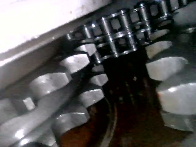

    9ECF6680-DB23-42C0-88FF-A34B91944BBA.jpeg Just checked timing chain, it’s got some slack but still on the marks (double chain “comp”) has anyone had an MSD 6AL send misfire??? I’m about to get a junkyard points distributor and try that. Ideally I’d like to put my box on some ones motor with same box and see if that’s it? . Anyone know a test other that can be done on the box at idle??
    I was able to push the chain in and out slightly after rocking it hand crank to TDC …. Marks on my Amazon 20$ Endoscope look good. I’ll pull the cover tonight or in the am. I saw the thread about valves… going there next but would that make the spark dance like that?? I can’t figure that out

    No, a valve train problem would not cause "jumping on the timing light". It could cause some of the other symptoms you described. I.e. low compression, knocking noise, erratic idle. One of the symptoms is low compression. The 2 main areas that cause low compression is piston ring wear, and/or valves not sealing. One way to isolate whether it's the rings or the valves is to apply some oil into the cylinders, which if the low compression is due to bad rings the oil can temporarily seal the chamber and cause an increase in compression. You said you applied the oil to the cylinders and it did not result in an increase is compression, indicating the problem could be the valves. Noise in the top end could be interference between the valves and the pistons. I'm just putting together the symptoms you described, and to me they're indicating a potential problem with the valves. As far as timing issues, I don't know what to tell you. Slop in the timing chain could potentially cause that. That could also result in the chain jumping teeth on the cam gear, resulting in a change in cam timing, possibly resulting in valve/piston interference. I don't know, I'm just saying what the symptoms are pointing toward to me and where I would be looking.
