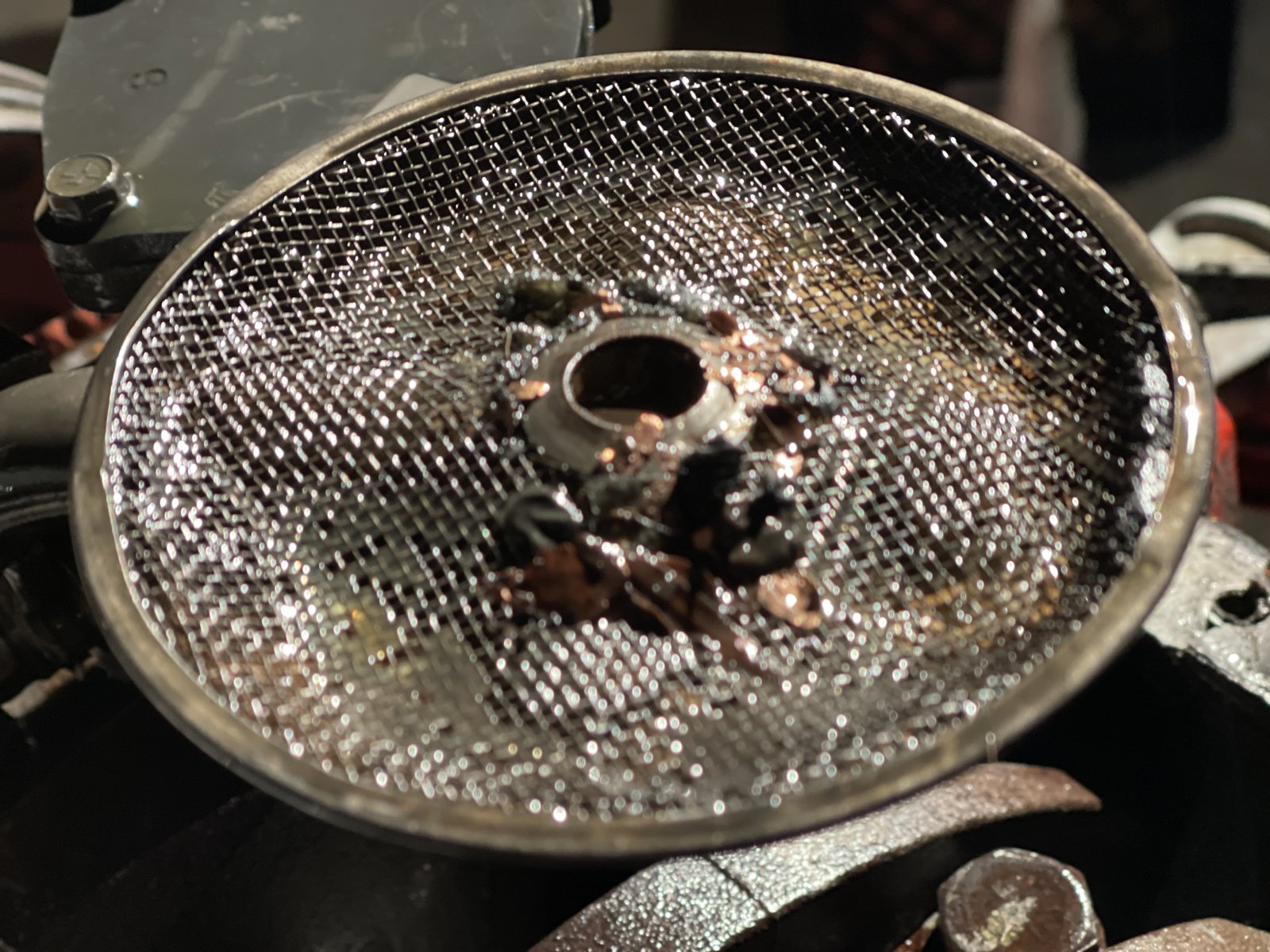

  12. linkeyGrip
    Joined: Mar 9, 2022
    Posts: 20
    linkeyGrip
    Motor is toast….. spun 5 bearings…. Crank is done…. Total roadkill….. 1204A47D-EED5-4E79-9840-5C7852CCC3C9.jpeg

  14. RmK57
    Joined: Dec 31, 2008
    Posts: 3,289
    RmK57
    Bummer. Salvage what you can and move on. Lots of FE's still out there.
