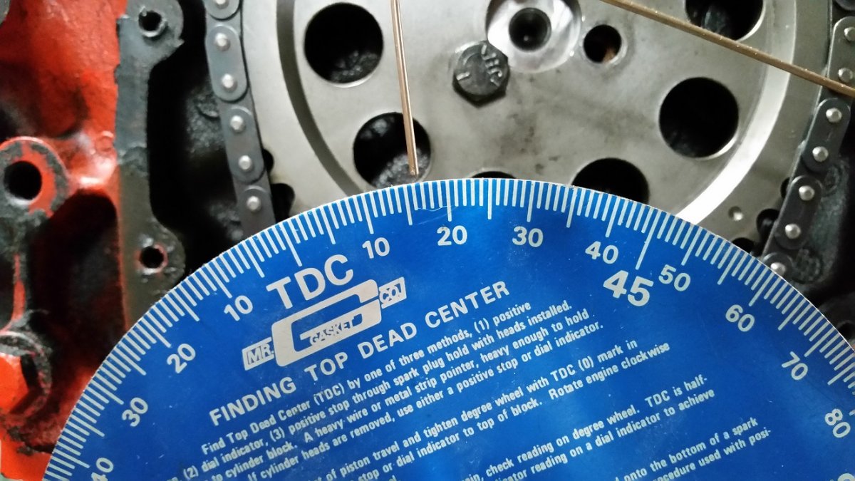

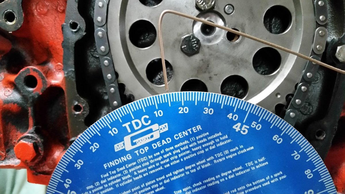

    Installed the cam and timing chain as well. Set it up 2 degrees retarded.

    2 deg retarded?
  9. Yea, my reasoning for that is to hopefully bleed off a little bit more cylinder pressure, but then again I don't know if 2 degrees will make any appreciable difference. Although, Hot Rod magazine did do a Hemi build a while ago that had more compression and a smaller cam, so we'll see. I haven't put the front cover on yet, so it isn't final.

    By the time the chain stretches you should be around 4 to 6 retard.

  18. Just called Crane Cams and had a chat about cam timing. They said that it is probably a good idea to run it at -2 just to be a little safer, and that it will barely affect the power band.
  19. George
    Joined: Jan 1, 2005
    Posts: 8,040
    George
    "Saltflats" finished up my question. New timing chains typically stretch 2 deg, more or less.
    tartar_sammich likes this.
  20. Do you mean after initially retarding it 2 degrees or installing it straight up? I still haven't decided what to roll with yet, but I'll probably be putting the front cover on for good either tomorrow or Friday.

  22. So do you think I'd be better off installing it straight up?

    Straight up is what I would do! Gary

    I would start from piston to valve clearance and work from there.
    Being from -2 or from 0 knowing a chain will stretch.
  25. I'll see if I can get a hold of a checker spring either tomorrow or Friday, then I'll change one out and see what kind of shape we're in. Do you know about how many miles it takes before a chain starts to stretch like that?

    Not sure it is as how many miles it is as much as how close you want to run when it slacks.

    New chains stretch about 2 deg when new & then settle down for about 90K.
