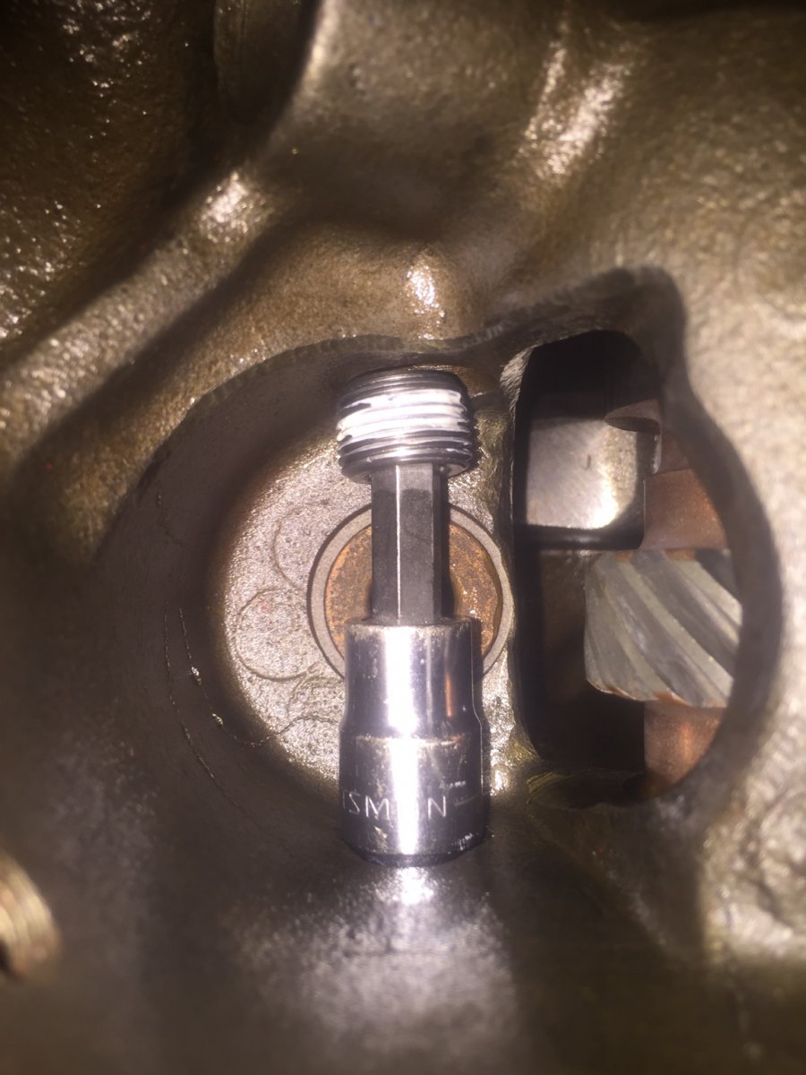

    Put the oil pump pickup and pan on tonight. Had to use two bolts instead of studs in one place because we lost a couple, but we've got some more somewhere.
    I also screwed in the plug that goes in front of the distributor shaft inside the block. This plug is super important, if you don't install it you will have little to no oil pressure.

    A common trick is to drill a .050 hole in the plug to help oil the cam/dizzy gears.

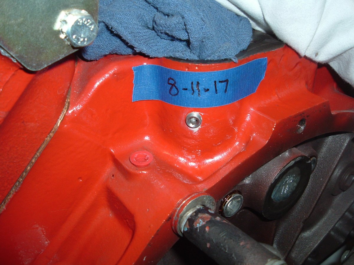

  4. [​IMG]
    Does anyone know what this hole is for in the rear of the block? It takes a 3/8 fine thread bolt so I'll see if I can find a plug for it, but I'm just curious.

    Certainly nothing oem related...
    You probably should have run an NPT tap in there so a normal pie plug would seal. A bit harder to do now.

  8. Is that hole making a cameo appearance in the lower left hand corner?
    It's got to be aftermarket oil transfer related somehow. It should be pipe thread,,,we'll probably used to be pipe thread.
  9. [​IMG]
    Yes that is the hole. Fastenal ended up having the size we needed but there is nothing to keep the plug from going all the way through. Might put a nut on it with red loc***e.

    Well......... There's more than one out there.... Goofy part is= 58 cast into block, with the A1 casting, BUT= 354 Chrysler. Zero numbers on the front valley rail. = Replacement block. Your not the only one! BTW- Hi Gary! 2003_0101ModelAParts0001.JPG

    Perhaps, and only that, there was auxiliary equipment that received oil pressure from the engine and this was the return line. When dealing with Industrial/AG equipment there are no rules.
