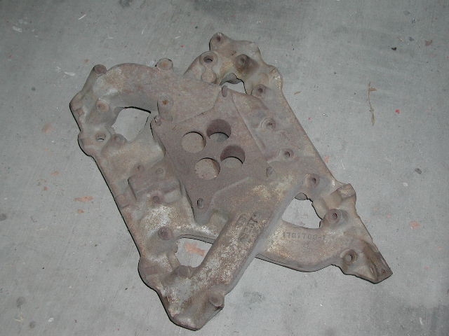

    True you can get a 354 4bbl intake that will bolt on the engine. Problem is the 354 engine uses a separate water crossover/thermostat manifold and the truck engine had the thermostat housing in the manifold. Intake won't work without adding water outlet pipes and make some sort of thermostat housing.

    Here is the manifold that you (and I) need but it came only on 1954 331 engines and they are impossible to find.
    This is what you will find on ebaY. It is a 354 4bbl manifold and bolts right up to you engine but has a couple problems. First you notice it has no thermostat housing. Second, the truck heads have tall heat crossover passages that this manifold won't cover. I had the same problem and was able to modify parts to make it work. Does take some effort though.
    The first thing I did was use a common carb adaptor plate to guide a hole saw to open the ports for a modern carb. the rest of the runners & ports are excellent design as good as any aftermarket manifold.
