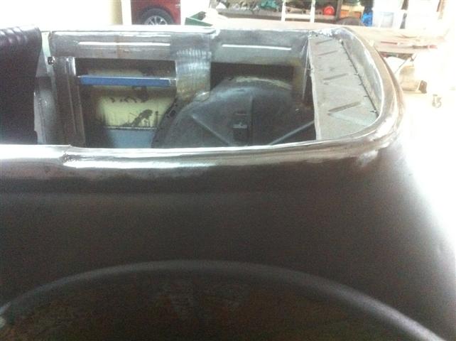

    Steeled out the rear tub last night.
    I have decided to put the parcel shelf from the sedan back in as it will give me more room in the boot as well as somewhere to latch the seat and mount seat belts anchors.
    I know that original phaetons did not have this, but I am not sure what was originally used to latch the back rest of the seat. I haven't seen an original one apart to have a look.

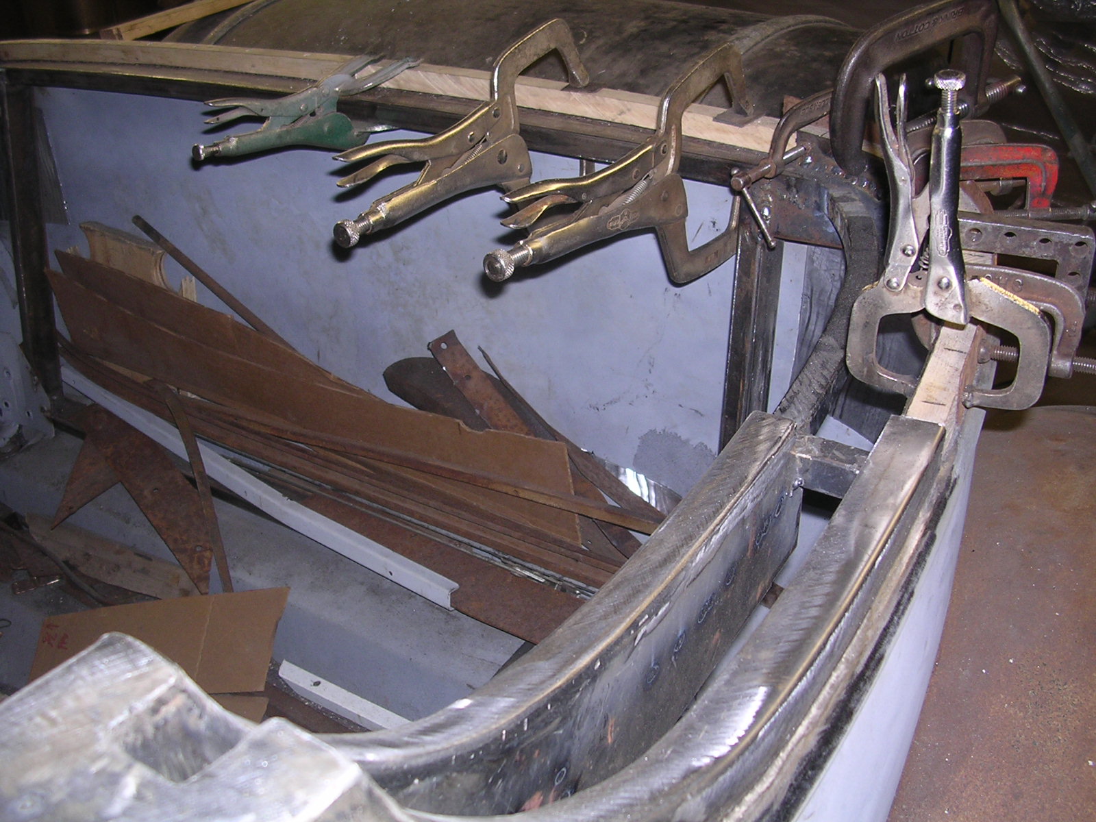

    Just wonder if you have enough built to try slamming a door to see if the quarter panel flexes a lot?
    I went nuts tring to get my 32 Nash 2dr conv sedan to feel solid. I have long doors and I went from mostly missing wood framing to steel. I had to build a double walled rear quarter frame just like it must have had in wood, because the folding top irons go in between. The car finally got solid when I put the last piece in. I was lucky, I guess.

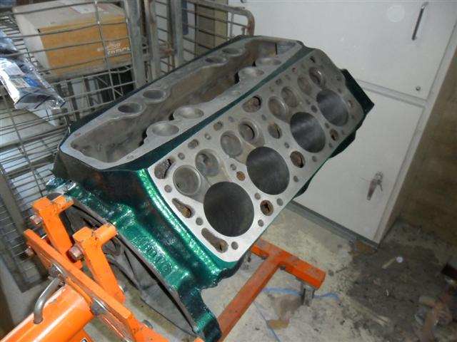

    Couple of photos of the engine for you. Engine is an 8cm Mercury.
    Found the engine in a barn about 2 hours from my place whilst buying some parts for my Customline.
    Engine has been completely rebuilt, bored 40 thou, crank ground, adjustable lifters and all the usual tricks to make it perform a bit better.
    Engine was built by Eric Worner, who races an old open wheel race car powered by a Flathead with a Riley four speed gearbox. Eric is the current holder of the Fastest Flathead trophy from the day of the drags held in Sydney. At age seventy he also one the trophy for fastest reaction time (0.00).
    I have decided to run the original mercury heads as I really like the painted look and everybody has finned heads now. Engine will also run single carb, although it is a 2 jet Rochester of a small block Chev. I am using an air cleaner of a 56 Customline that has been modified to fiit over a standard aftermarket air cleaner. Distributor is Mallory.
    I have modified a pressed steel bellhousing from a 49 Ford to mate a four speed gearbox from an aussie Ford Falcon.

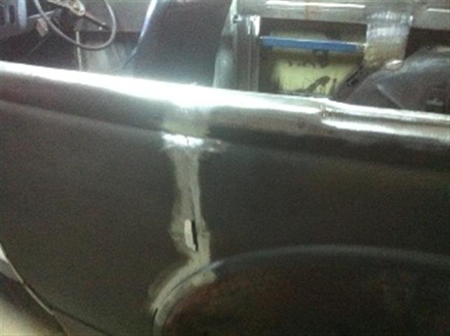

    Quick update. Finished off the top of Right hand rear quarter panel, finished the reveal in the top. also made the inner quarter section and welded that in.

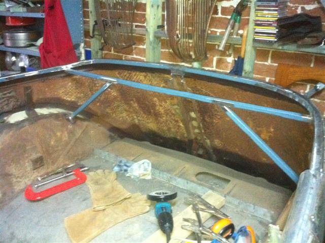

    Got back into it today. Boxed in the rear panel above the parcel tray, finished the reveal on the top of the L/H Quarter panel and started welding up the quarter.
    Also got some seats from an early Ford ****** 2 door a little while ago, so I made a mount for the seat with a storage box in it. Seats tilt forward to allow access to back seat.
