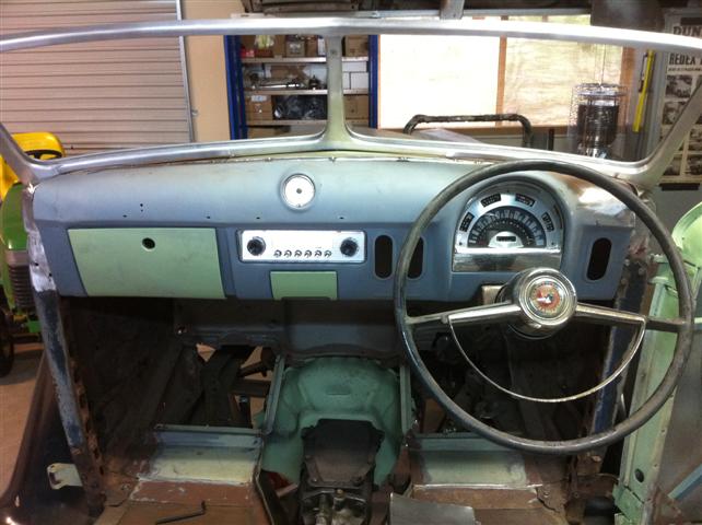

    Got back in the shed this afternoon, decided to fit the dash up as I have never actually had it all together or properly bolted in. Needed to fit up guages etc as I want to put some bracing behind dash (to support the cowl, as well as giving me something to mount fuse box, vents etc) and wanted to make sure it didn't foul on anything. The brace will also give me a frame to mount a cover under the dash to hide the wiring.
    Whilst I had it on there I modified the original Customline dash moulds and trial fitted them. I will continue the moulds around onto the doors. Made the section of mould for the door and mounted only to discover I am not happy with how the mould lines up on the door. Now need to recut the door and modify so that the mould sits right at the bottom of the door. Glad I tried this before finishing the L/H front door. Will also now definately move the Clock in the dash to the centre of the dash in line with the centre post on the windscreen. Now I know what this weeks projects are, but I must say I am really excited about how the dash looks in the car.

    The whole project looks fantastic... the dash looks very nice as ... very stylish.. despite the many years between the body and the dash it works really well.

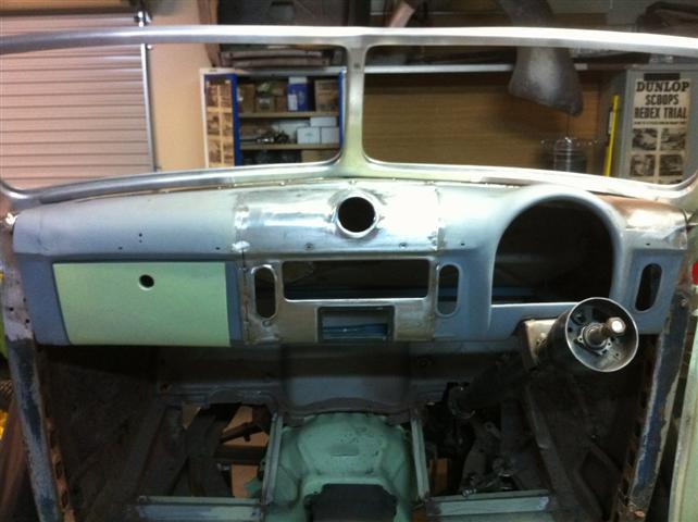

    Decided to change the dash around a bit. Although I love this dash in this car I couldn't live with the clock not being lined up with the centre bar in the windscreen. Just centering the clock would have looked weird because the radio and ash tray would still have been off centre. Had a spare left hand drive cusso dash from a previous project, cut the centre out of that and relocated everything. I only have it tacked in but I think it looks much better now. Put in a photo of previous as a comparison.

    Looks good - nice work on the tub. I agree about centring the clock, it looks better there.
    The cusso dashends are a nice touch too.

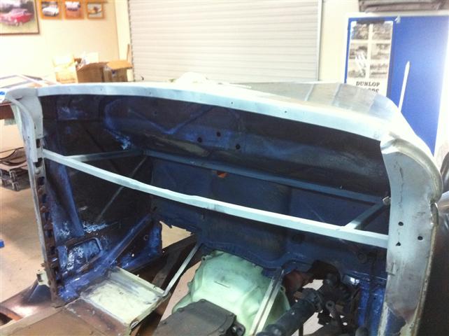

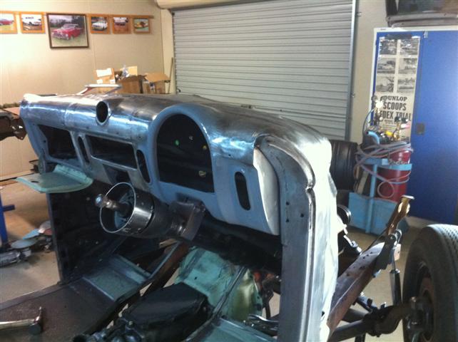

    Getting a bit done whilst on a couple of weeks holiday. Finished cleaning up the inside of the cowl and welding in the braces. This is were the plans with the dash changed. Decided to weld the dash into the car as I do not like all the lines where the door, dash and cowl meet. So the dash is now welded in. I originally wanted to bolt the dash in so that it would be easier to fit up, however there is so much room behind the dash this won't be an issue. I will be painting the back of the dash white as previously suggested. Also started stripping and cleaning the cowl, hope to finish all this and dss up ready for epoxy primer tomorrow.
