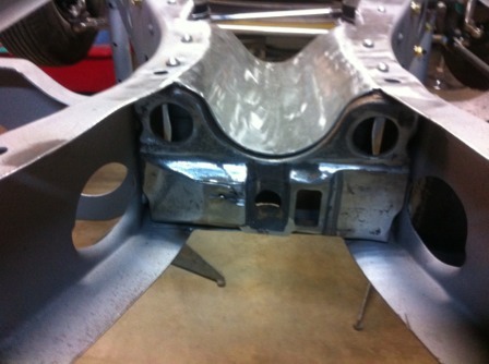

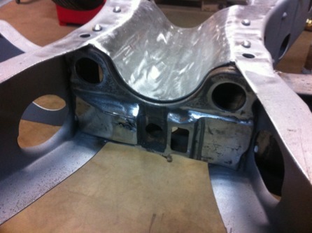

    Got a bit done today. Welded up the centre crossmember, filled all the unwanted holes on the bottom of the ch***is. Filled all the holes in the rear crossmember and trimmed it up for a more pleasing look, don't need u bolt and spring centre bolt holes as using Ch***is Engineering rear springs. Will finish filling holes in top of ch***is tomorrow then start setting up brake pedals and booster.

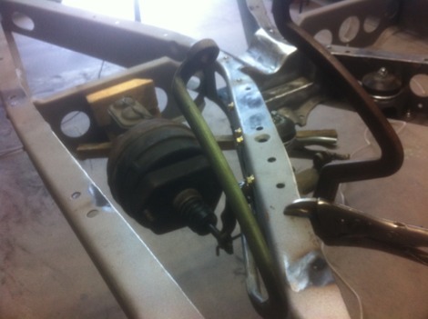

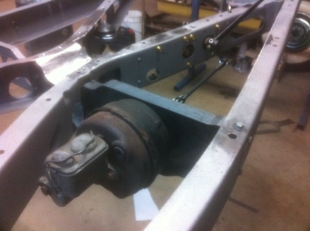

    Finally getting my brake booster sorted. Going to move it back 300mm and make a new crossmember to mount it. Also have to make a new pushrods for it. Rego requirements state that push rod needs to be made from 12mm rod. Got it all tack welded today. Need to do final alignment tomorrow and finish it all off.
  8. Blackroad
    Joined: May 18, 2007
    Posts: 290
    Blackroad
    from Sydney
    Didn't get it fully finished, but did get the crossmember bolted in and everything lined up properly. Had to redo the end of the pushrod to get the length right.

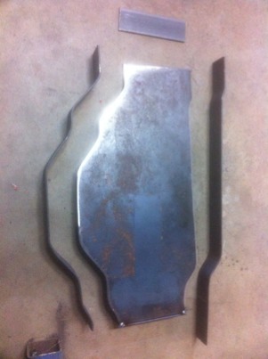

    Also today, had my 13 year old son in the shed working on his 30 roadster pickup. We will start a thread on this one soon as there is quite a story behind how he got it. Today he bolted the front and rear cross members in and made templates for the boxing plates. We cut the first plate out for him. Body will be channeled 4 inches and it will run a fatty and four speed as well. We are building it on a Chrysler ch***is as it has a natural kick up at the back to help get it down low.

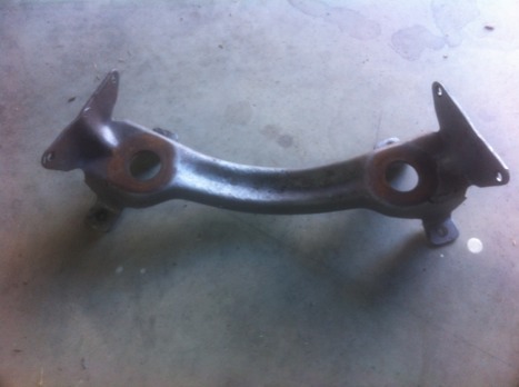

    Little bit more done tonight. Cut down the cast plate from the rear of the crossmember as I don't need the pivots for the clutch rods. Will look much neater.

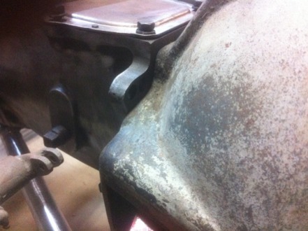

    Got the dummy engine and gearbox back in. Uncovered a problem where the gearbox is hitting the mount that I made, not allowing the engine to go right back. Have to fix that before making the other part of mount on box.

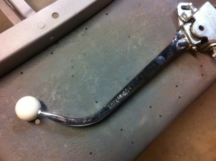

    Not real keen on the standard gear stick that comes with the single rail four speed. Plan to make one out of the original bottom section and the stick from an original Hurst shifter I got from a good mate. Love the Hurst shifter, NOS in box with the boot and all.

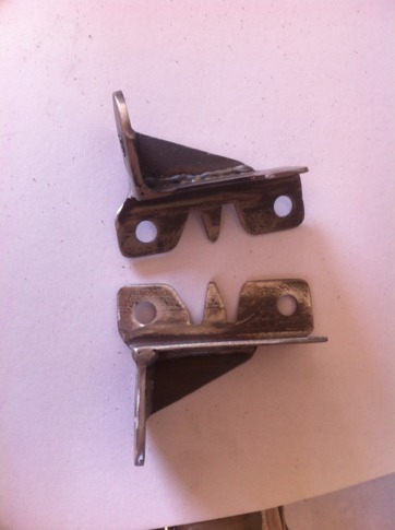

    Got the gearbox mounts finished off. Had to move the ch***is mounts back about 1/2 inch. Worked out nice.

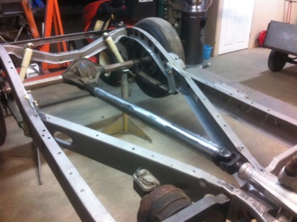

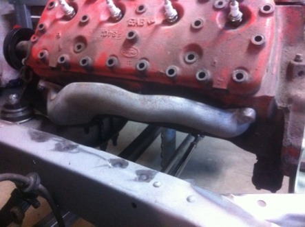

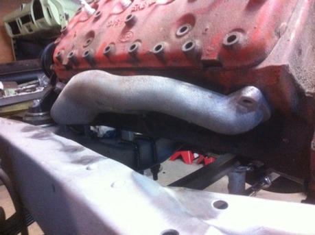

    Got the tail shaft cut down and bolted in. Also finished welding the brake rod. Next up it is time to start on exhaust. Have a set of English ford pilot manifolds that I may use. Not much room between engine and steering box to fit extractors.

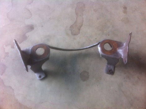

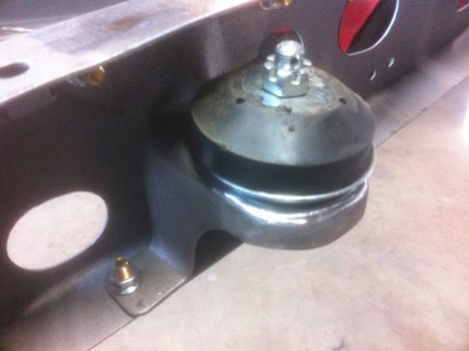

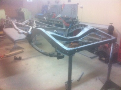

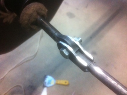

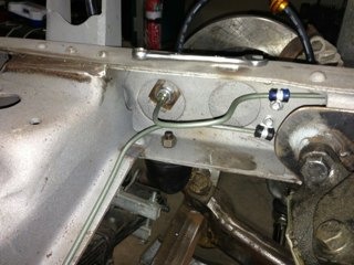

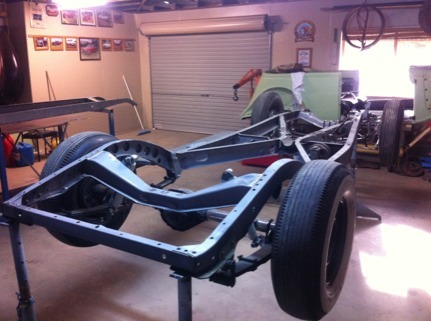

    Currently making up brake lines and clutch rod. Just about done, hoping to strip ch***is back down tonight ready to epoxy prime ch***is, then fit it all back up and put body back on to finish up trams tunnel etc. ImageUploadedByTJJ1359329289.490692.jpg ImageUploadedByTJJ1359329336.201123.jpg ImageUploadedByTJJ1359329369.068635.jpg ImageUploadedByTJJ1359329418.985271.jpg

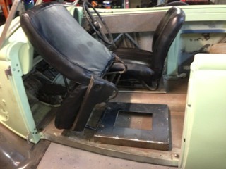

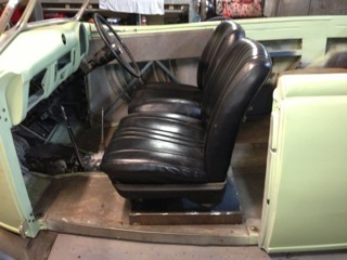

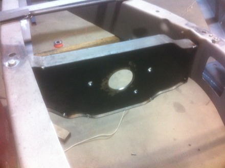

    ImageUploadedByTJJ1360493298.888753.jpg ImageUploadedByTJJ1360493317.838382.jpg ImageUploadedByTJJ1360493332.605285.jpg ImageUploadedByTJJ1360493372.321464.jpg ImageUploadedByTJJ1360493390.538434.jpg ImageUploadedByTJJ1360493402.171891.jpg ImageUploadedByTJJ1360493415.838798.jpg ImageUploadedByTJJ1360493430.088501.jpg got the body back on, no clearance between booster and floor, so cut out the floor and made a bubble and access lid for the master cylinder reservoir. Also made the p***enger seat base and mounted to floor through ch***is. Really happy with how front wheels sit in guards. Back needs to come down a couple of inches.
