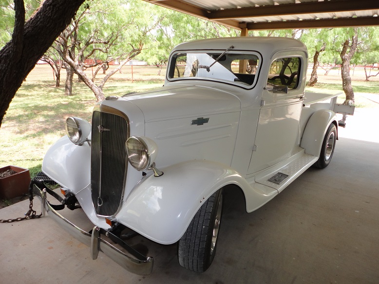

    Here's some encouragement. Been in the family since 1954. Will be for sale soon, I'm sad to say. Love the Thickstun. I'm going to run one on my 55 2 door.
