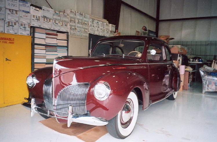

    The scoop will be needed, as well as trying to get the hot air out of the engine compartment. I am sure it will look great and be pretty much "invisible" when the car is painted and done.
    A late 40's kustom do however need bumpers. There are many nice ones to choose from, if the -37 Desoto looks weird now. Check out ones that follow the front profile or maybe shorten a -40 Lincoln to keep the shapes of the grille open.
  8. Kenneth31coupe
    Joined: Feb 24, 2010
    Posts: 670
    Kenneth31coupe
    from Sweden
    You beat me on that one J.B. That Lincoln bumper was exactly what come to my mind instead of nerf bars.No offense Kipp but I have to agree that an early kustom needs bumpers.

    I think Calori used '41 ford bumpers. Gotta give it to you, this is the best chop I've ever seen on a 35/36 five window. The front end turned out amazing also, can't wait to see more.
  16. Rikster
    Joined: Dec 10, 2004
    Posts: 5,795
    Rikster
    The Calori Ford uses a 1941 Ford bumper as Mats already mentioned.
    Also think about these.
    1940 Mercury, simple and elegant
    1940 Pontiac, similar as the 1940 Lincoln unit. Possibly easier to find and cheaper.
    1941 Oldsmobile, heavy and very Art Deco. Harry Westergard loved this one.
    1940 Cadillac, also heavy, but Cadillac parts are always good to use.
    1946 Ford bumper, heavy, but stylish and cl***ic.
  17. kippers 34
    Joined: Feb 7, 2009
    Posts: 1,038
    kippers 34
    Thanks Mats and Rikster. I had read that calori's bumpers were 41 and I thought not like any 41's that I have seen. After you guy's said 41 I looked more and found out that they are 41 ford super deluxe only. I have a line on a couple sets now.
