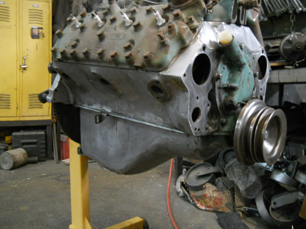

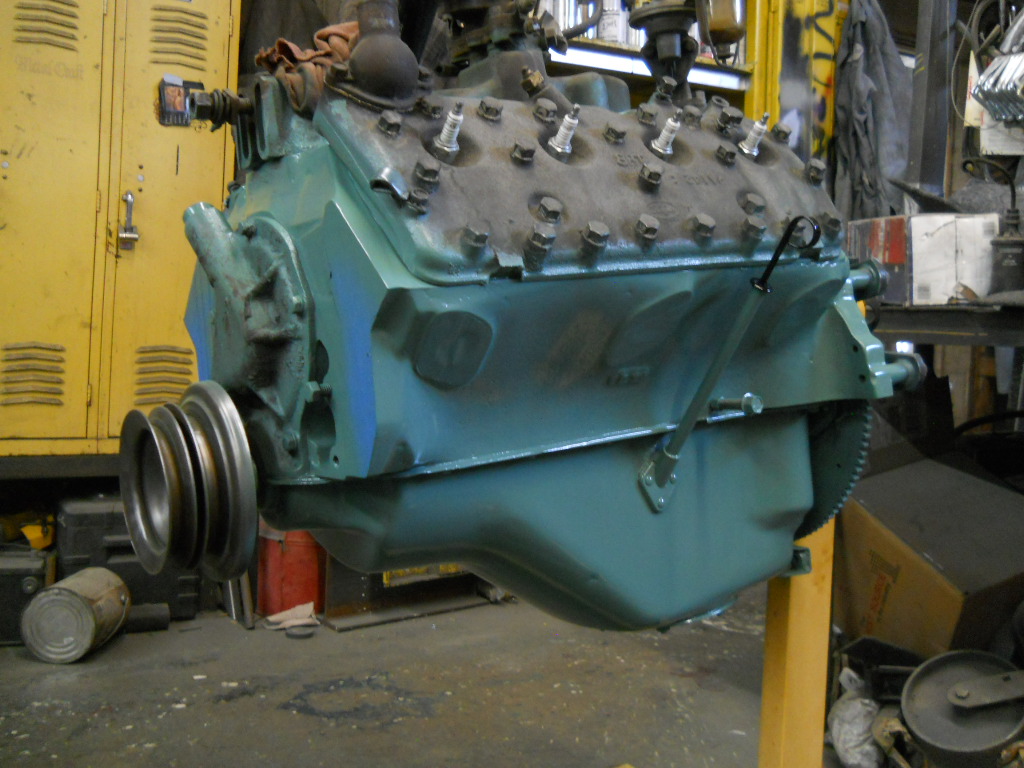

    After pulling the engine I spent an entire day sanding on the block I prepped and painted it. The heads , manifold and timing cover are off to be polished. They should be back this week then engine ***embly can begin.
