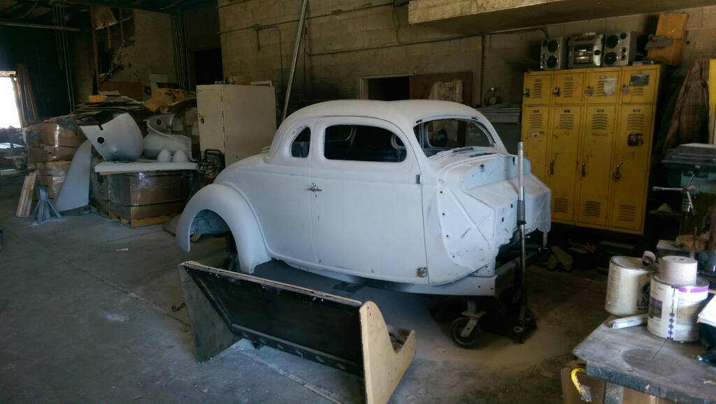

  8. kippers 34
    Joined: Feb 7, 2009
    Posts: 1,038
    kippers 34
    Sanded most of the pasanger side. Getting a little closer.
  9. daddio211
    Joined: Aug 26, 2008
    Posts: 6,012
    daddio211
    Coming to you LIVE from Kip's shop...
  10. lowcoe
    Joined: Jan 30, 2008
    Posts: 846
    lowcoe
    Sweet! Like the paint booth! Hand everybody a sanding block and get er done!

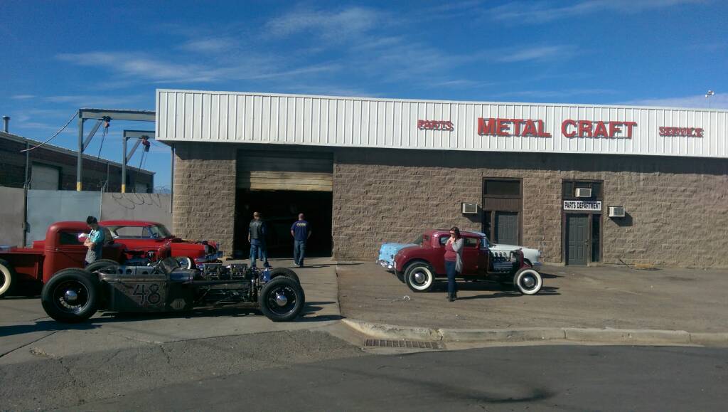

  12. Six Ball
    Joined: Oct 8, 2007
    Posts: 6,979
    Six Ball
    from Nevada
    OK, So at Bonneville in '08 we spent a few days parked next to these guys? We were the old drunks in the primed '53 pickup. The super charged Packard powered roadster is one of the best built cars I have seen on the road. The details blew me away!

  14. kippers 34
    Joined: Feb 7, 2009
    Posts: 1,038
    kippers 34
    I tried to get everyone sanding but had no takers on such a nice fall afternoon.

  15. kippers 34
    Joined: Feb 7, 2009
    Posts: 1,038
    kippers 34
    Thank KB. Gl*** is still one thing I am working on.
  16. kippers 34
    Joined: Feb 7, 2009
    Posts: 1,038
    kippers 34
    Brian's roadster is Bad *** with subtle details everywhere.
    daddio211 likes this.
