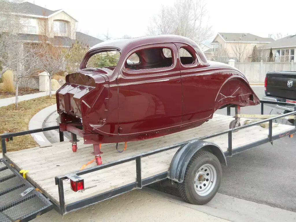

  7. The body and rear fenders are done being polished so I brought them home today. Here she is on the trailer waiting to be unloaded. And another safe in the garage. And the fenders sitting on the chassis. Brian is supposed to have the welding done on the cast aluminum grill on Wed then it can go to the chromer.
  8. The sides of the body are like a mirror!

    Beautiful! If it was mine it would already have a dozen dings in it.:(
